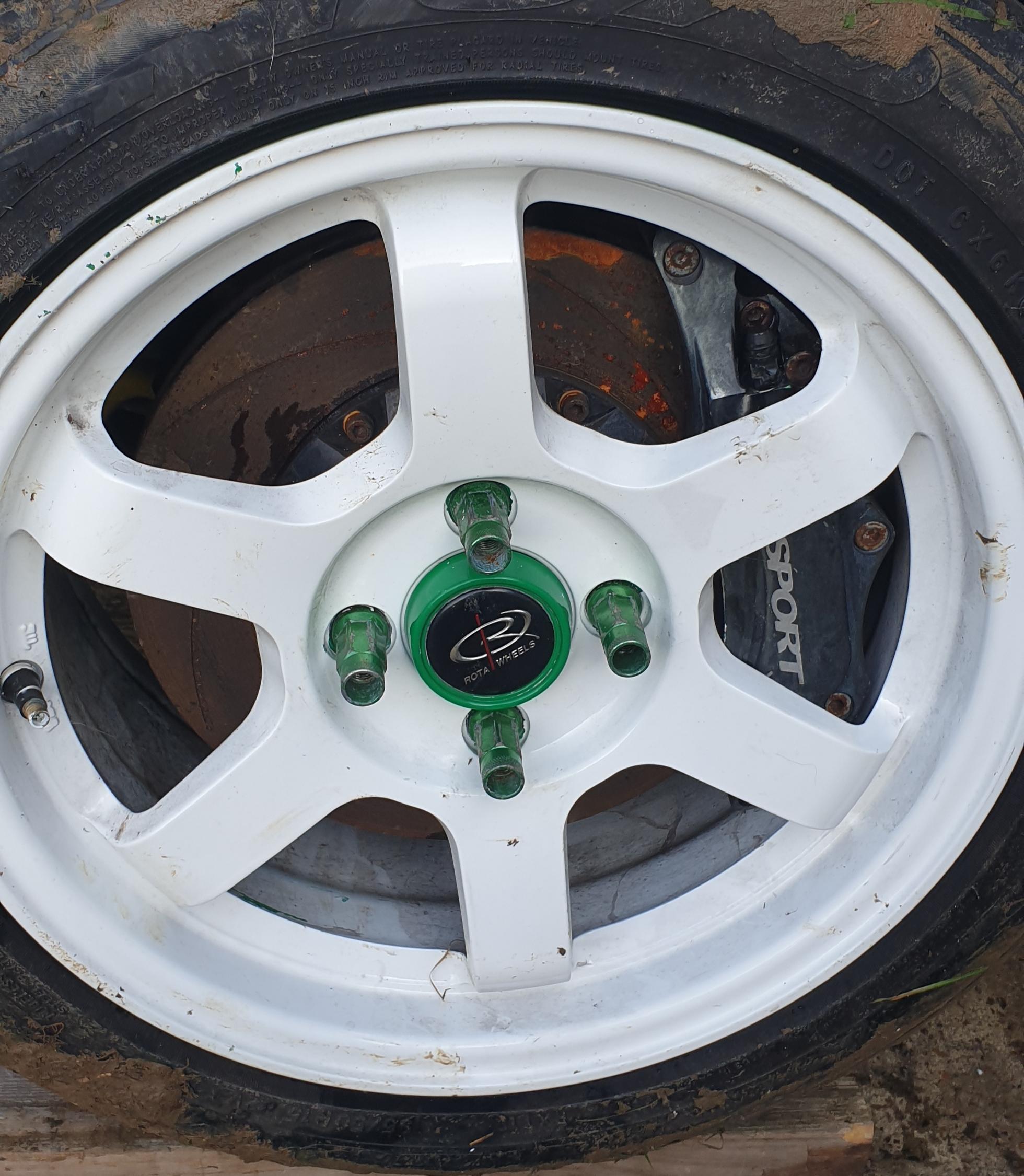

Extended wheel studs
I didnt realise they were this big lol and everyone said grids wont clear them. Bloody huge things, do you know your wheel specs?

I got told an et28 is needed to clear k sports, so yours must be around et48 without the spacers. I'm right on the edge of the std arches with a 10mm spacer and I've no idea what specs mine are either lol

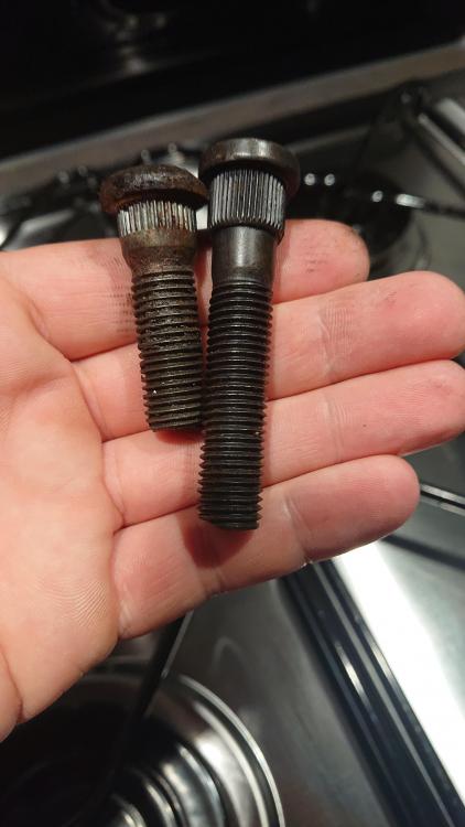

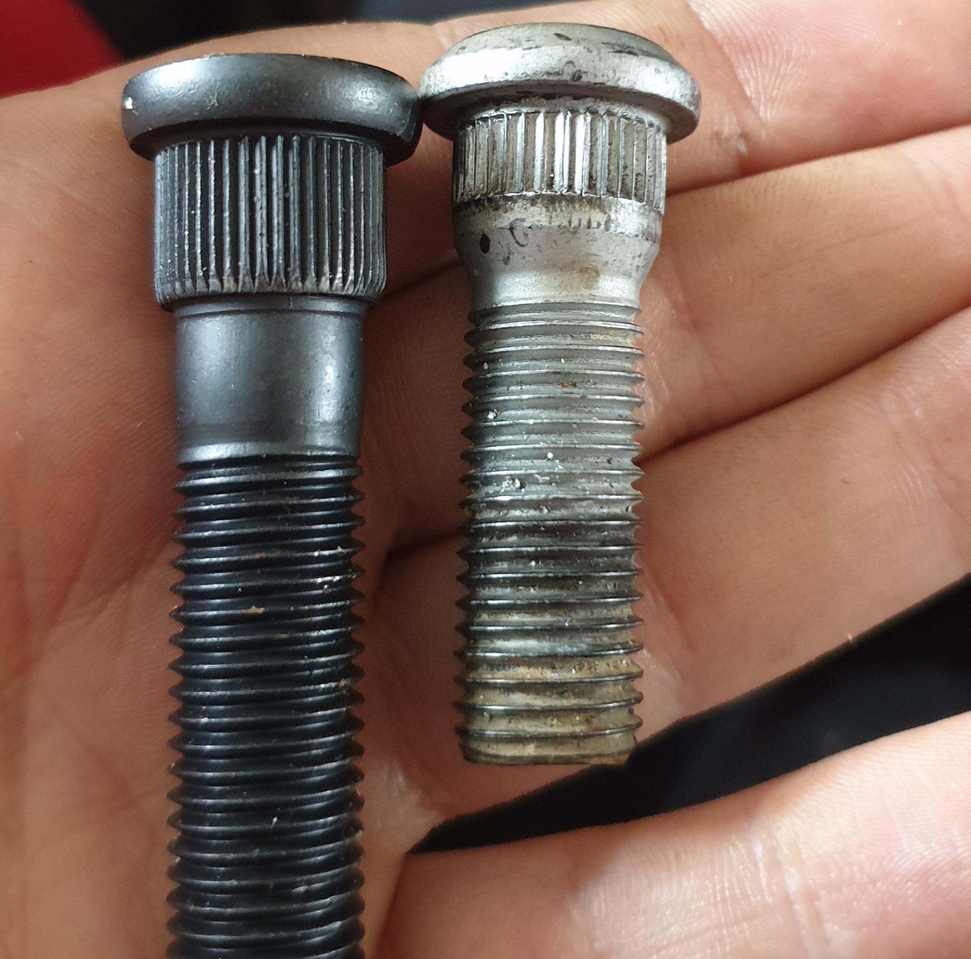

Well the fensport ones dont fit, the spline count is completely different and wont grip at all. So I'm still looking for anyone that has any info on extended studs pleeease

I can confirm, the Fensport ones I have on my Starlet. I guess I probably knackered the hubs putting them on. But they are solid. I will go to the garage later today put up a photo.
I will see if I have the stock ones lying around. Give me a few hours.

The evo arp ones that I had installed had a different spline count as well and they went in fine with some patience. Knurl diameter was almost spot on though. If the hubs get messed up you can always get a set off ebay.

On 12/7/2019 at 2:20 PM, Calum122 said:
@HedgeyGedgey What did you do in the end mate. The ones you got are exactly the same as mine and I've had no issues.
Gave up haha. Left the car in the naughty corner till spring now. I think I'm gonna try and tap them in, and then pull them through with some steel nuts I have. And then pray haha
