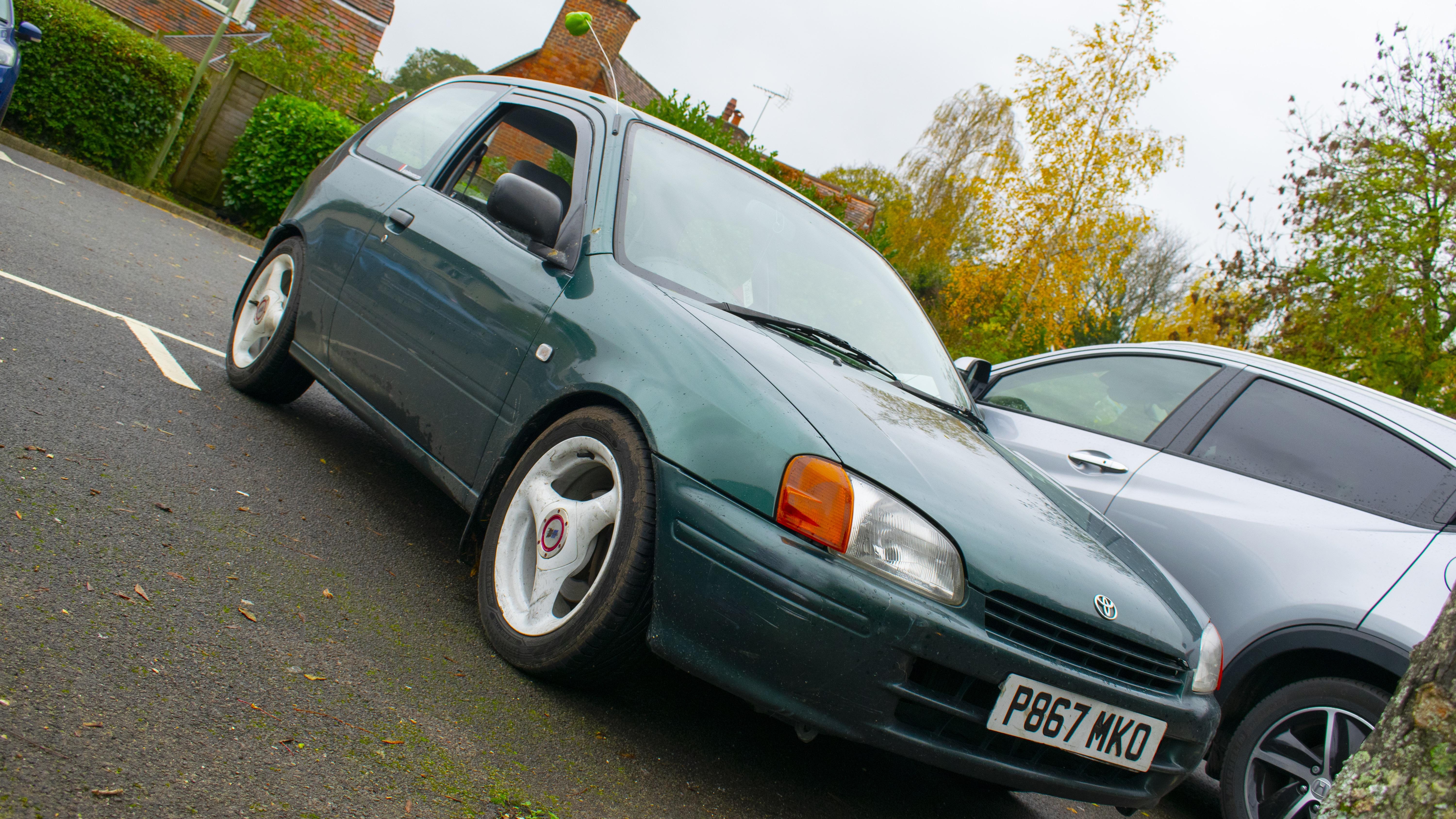

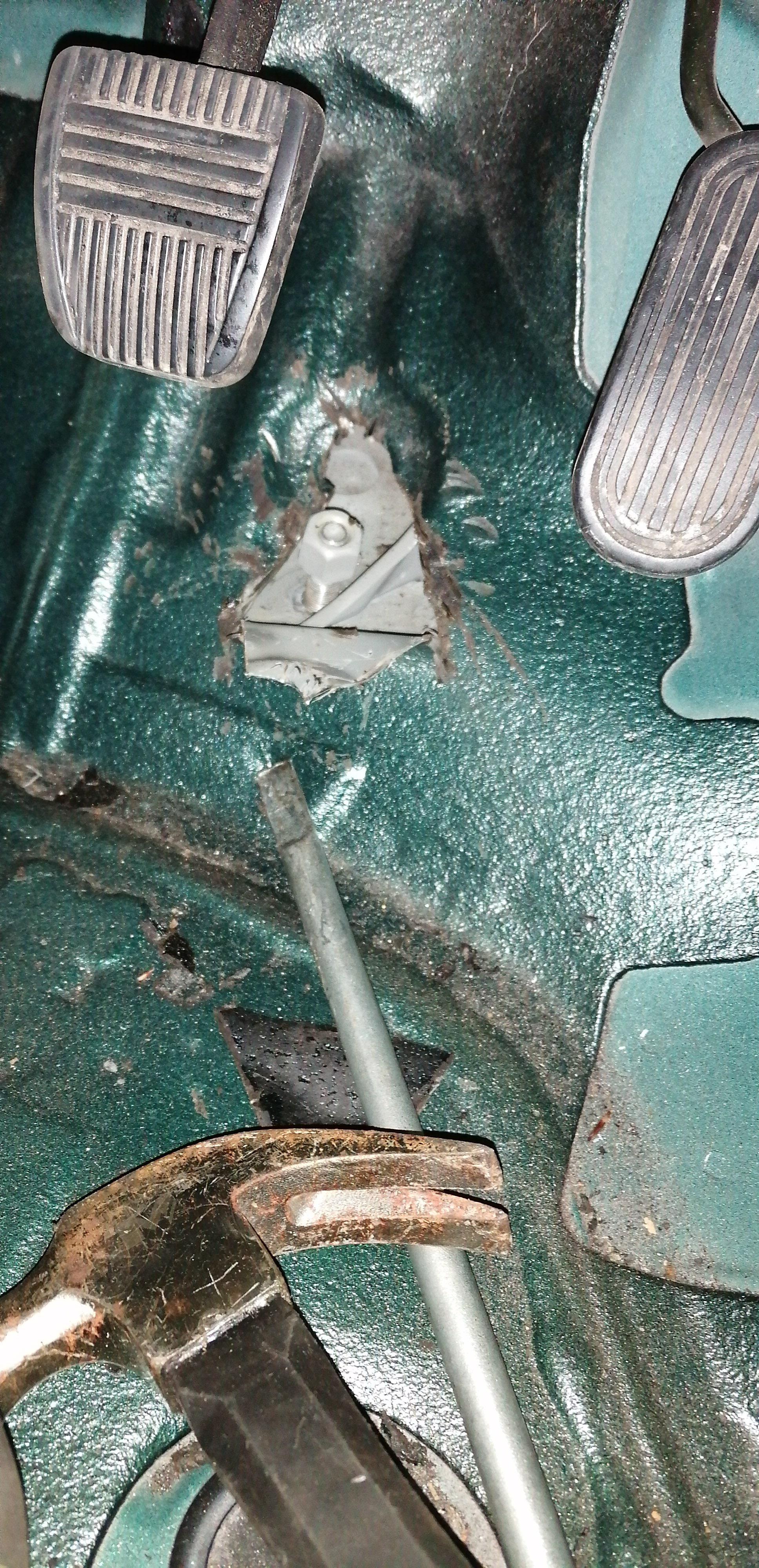

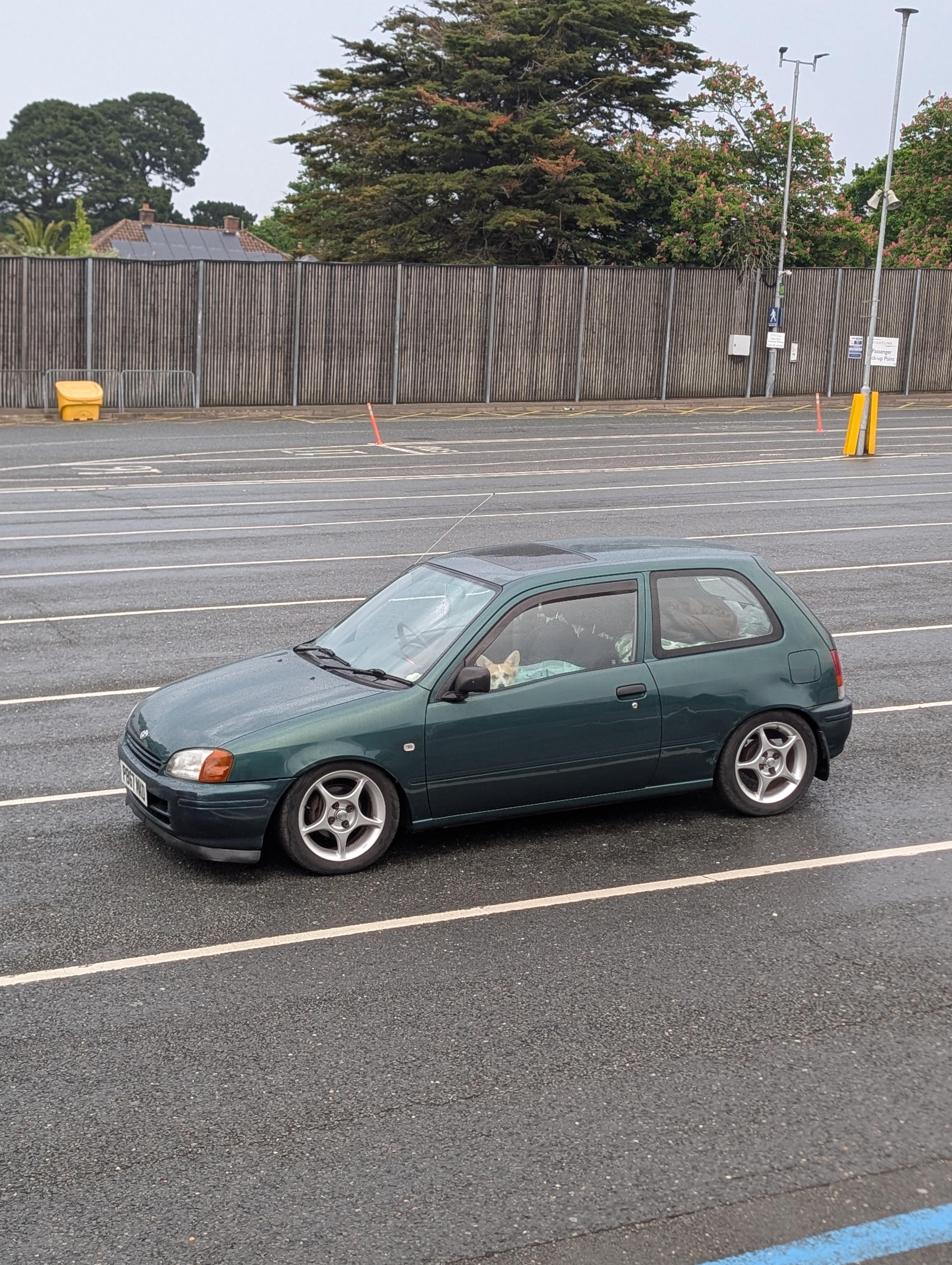

So yes I do have an update, I have now fitted some new white 3 spoke meshindo wheels which cost me £40, an ultra racing 4 point lower bar, front lip and I've not had a passenger seat now for the past few weeks due to removing it to fit the mr2 seats and my welder packed up as I was about to do it, so I just bolted the tabs onto the seats and I can confirm SW20 (mk2 mr2) seats fit a passenger side at least. I also fit an anti lift kit which was a fun one, so the captive nuts that the anti lift kit mounts too tend to snap and I had this happen one on either side so there's slight cuts in both footwells now.
Same thing happened to me fitting the anti lift kit. Would you have a picture off the 4 point brace fitted as I am thinking off getting one but hopping the exhaust ant going to be in the way.

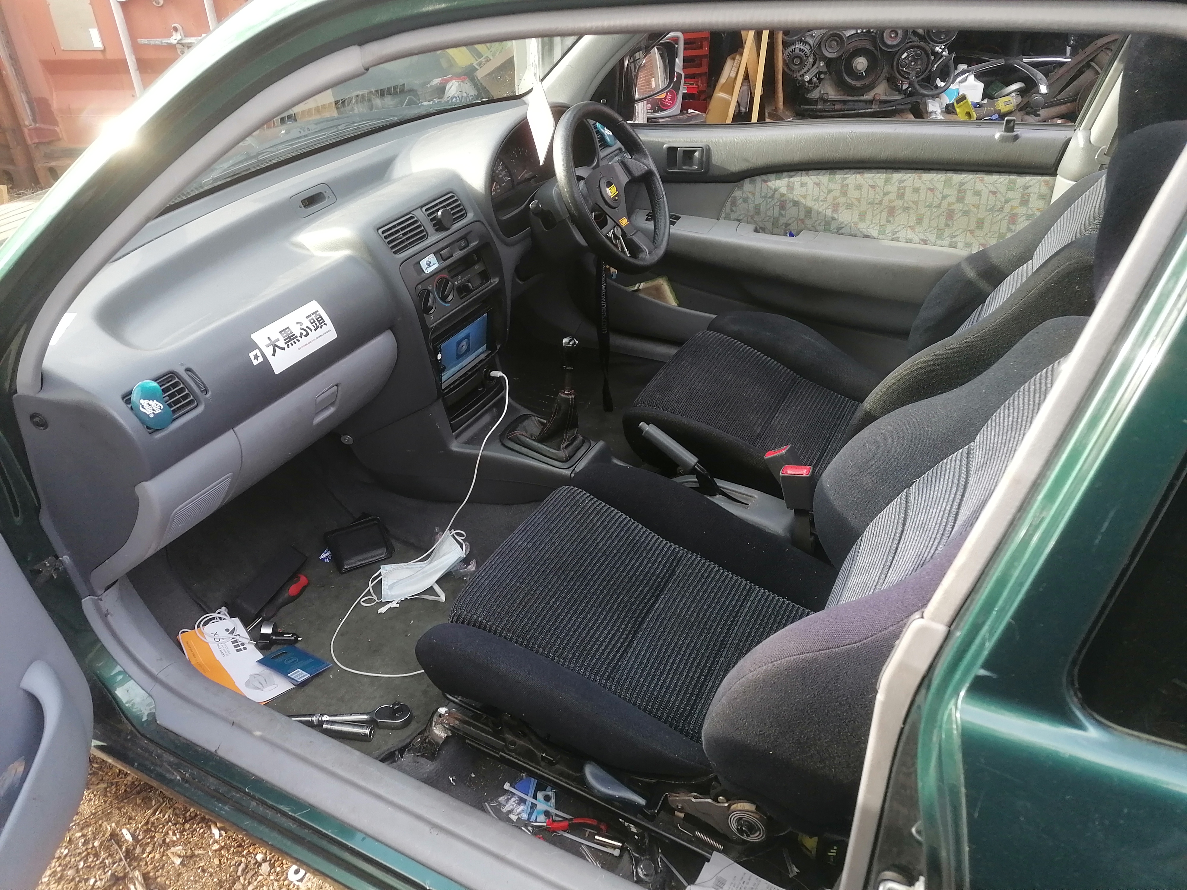

so a bit of an update, not much has been done on my starlet for a while. I fitted some MR2 seats which I got for free from a mate and now I've just gone and got some top spec fully adjustable MR2 seats and fitted them to my modified rails. I've ordered a gizfab adjustable panhard rod as it's cheaper then the best and from the looks of it it can be adjusted on the car unlike most of them. I've not really been putting money into my starlet as I've been putting all the money into my MK3 supra
Oh yeah also I've got a g6r gear boot fitted which I removed from the g6r when I pulled my gearbox out of it. All I want now interior is the glanza door cards and new carpets to match my glanza rear bench
