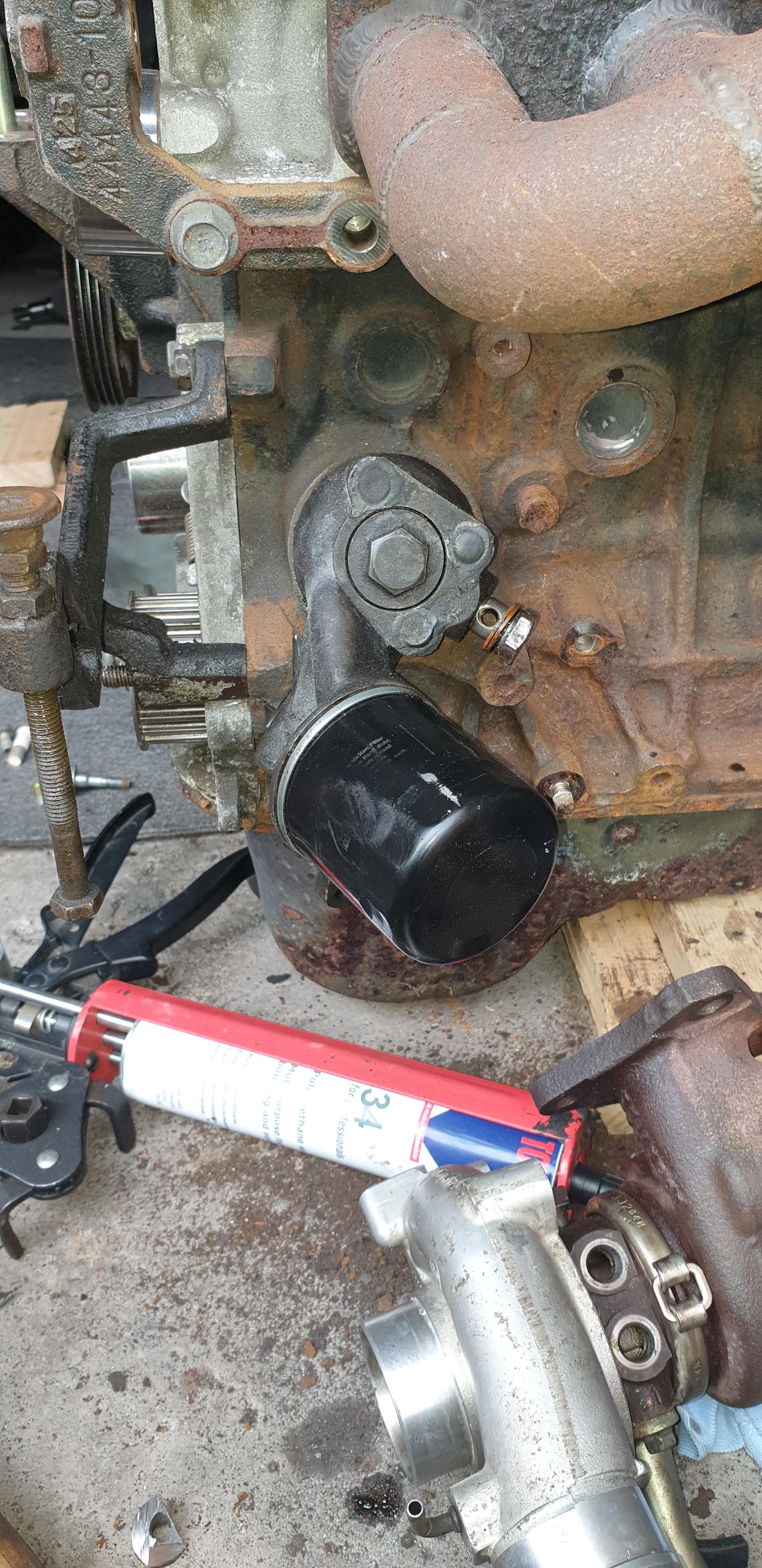

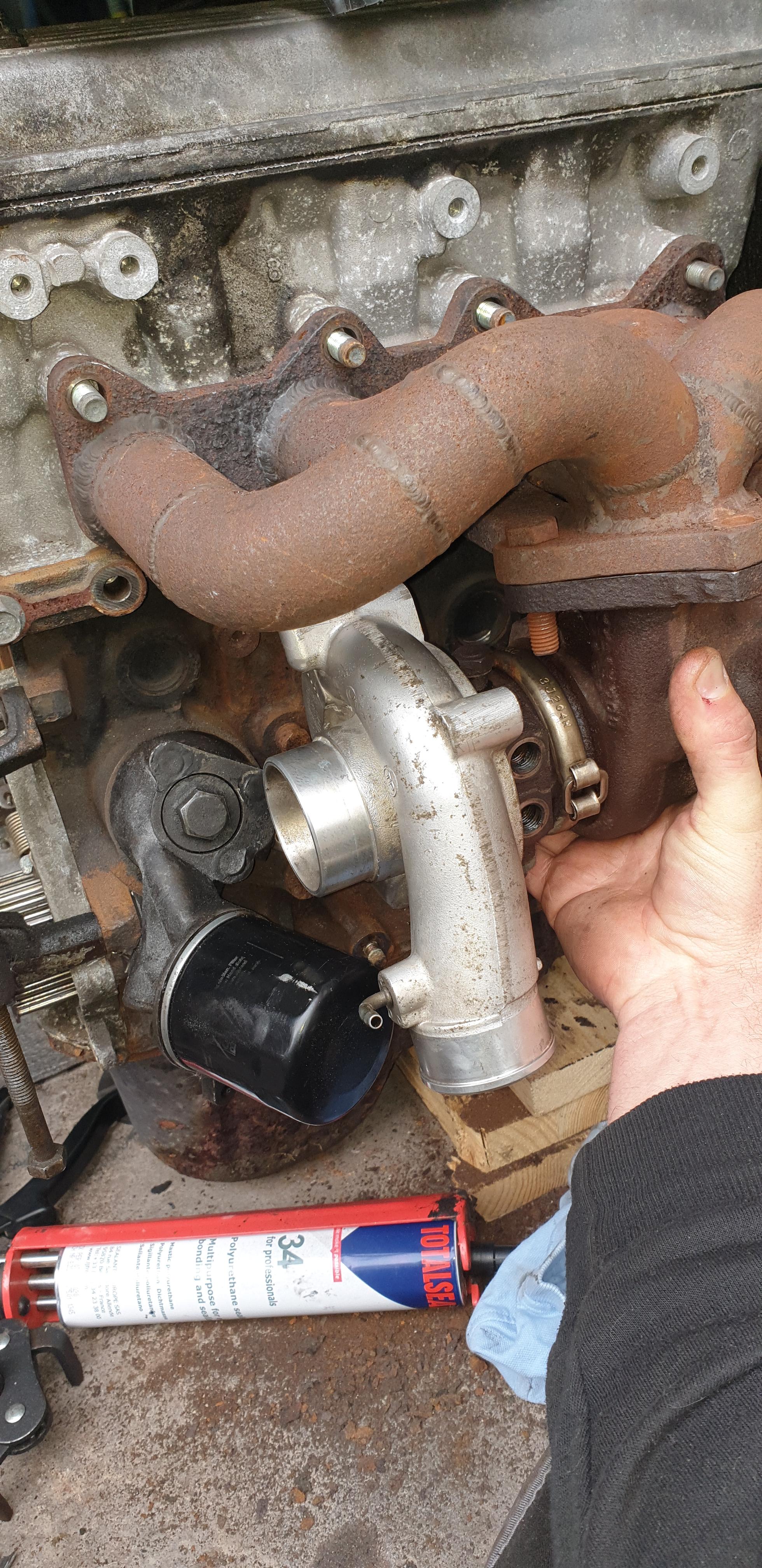

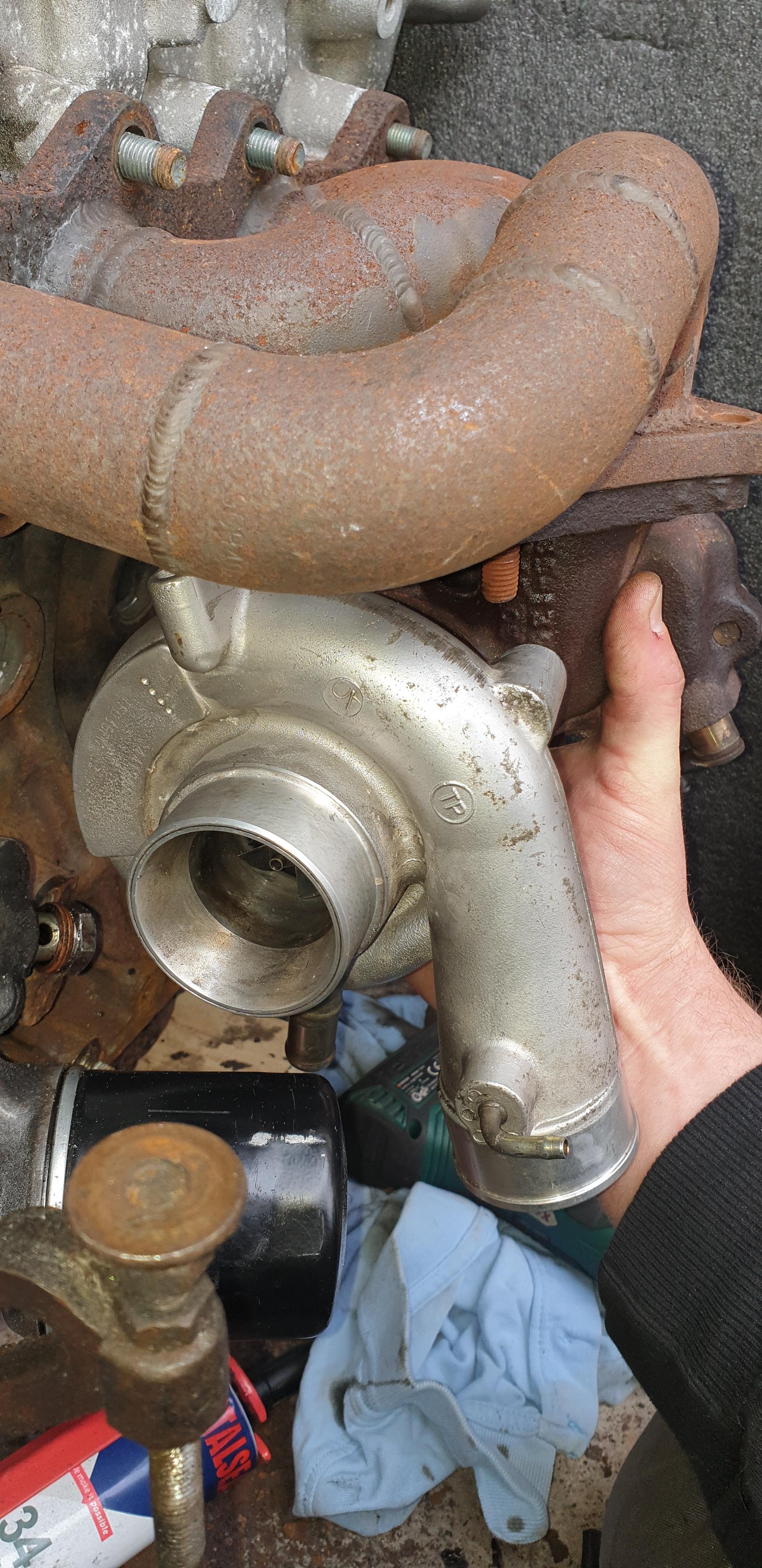

lukEp Posted April 28, 2020 Posted April 28, 2020 So I've been messing around and done this. Has anyone done it and successfully? I can't see it not working and makes it clearer for the compressor side to fit a decent filter. Quote
Sam44 Posted April 28, 2020 Posted April 28, 2020 What manifold and turbo is this?. The turbo is angled out more on my zisco manifold. I can't see anything wrong in doing this. There's just the port on the rear of the relocation housing to be mindful of. Quote
lukEp Posted April 28, 2020 Author Posted April 28, 2020 (edited) Wepr it's a power up kit I think. Its TF035 the port is still in the same area. It's only moved by 30-35° Edited April 28, 2020 by lukEp Quote
T-dog Posted April 28, 2020 Posted April 28, 2020 What you doing with the 3 location bolts , just sealed them up ? Quote
lukEp Posted April 28, 2020 Author Posted April 28, 2020 (edited) I've not used the 3 bolts for 5years and it's never leaked. It's a 5e so unless I drill and tap the block they don't have the 3 bolt holes anyway Edited April 28, 2020 by lukEp Quote
T-dog Posted April 29, 2020 Posted April 29, 2020 Ok mate that’s good to know for the future 👍🏼 Quote
gorganl2000 Posted April 29, 2020 Posted April 29, 2020 (edited) 19 hours ago, lukEp said: I've not used the 3 bolts for 5years and it's never leaked. It's a 5e so unless I drill and tap the block they don't have the 3 bolt holes anyway i've done the same on the 5Es since 2007/2008...never had a leak as well i'm not sure with regards to how things will work with the new angle/location you propose Edited April 29, 2020 by gorganl2000 Quote
