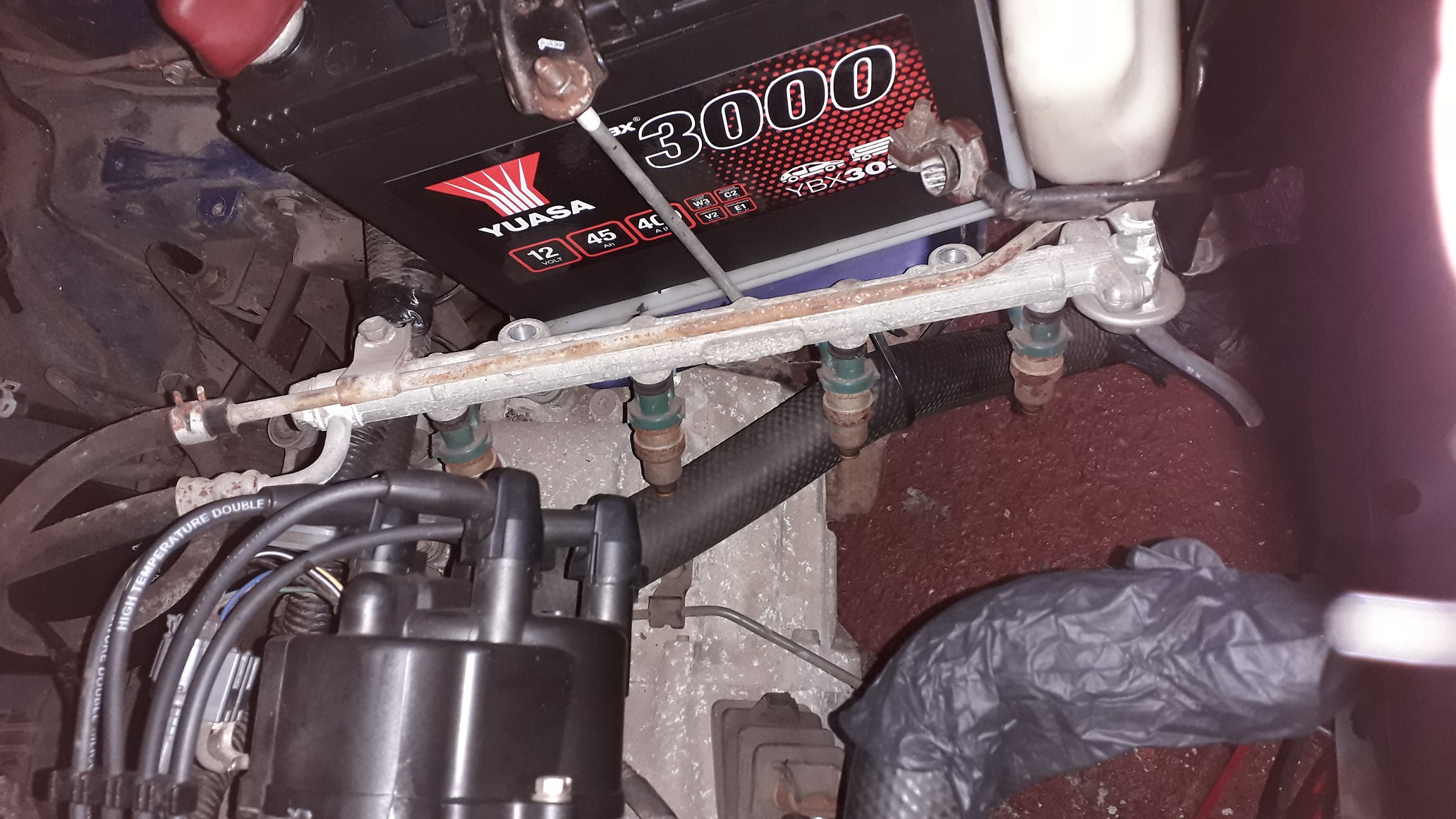

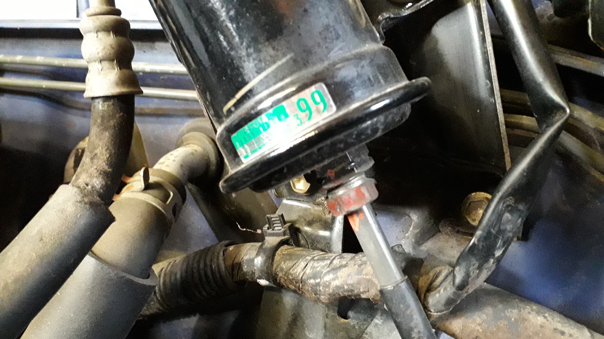

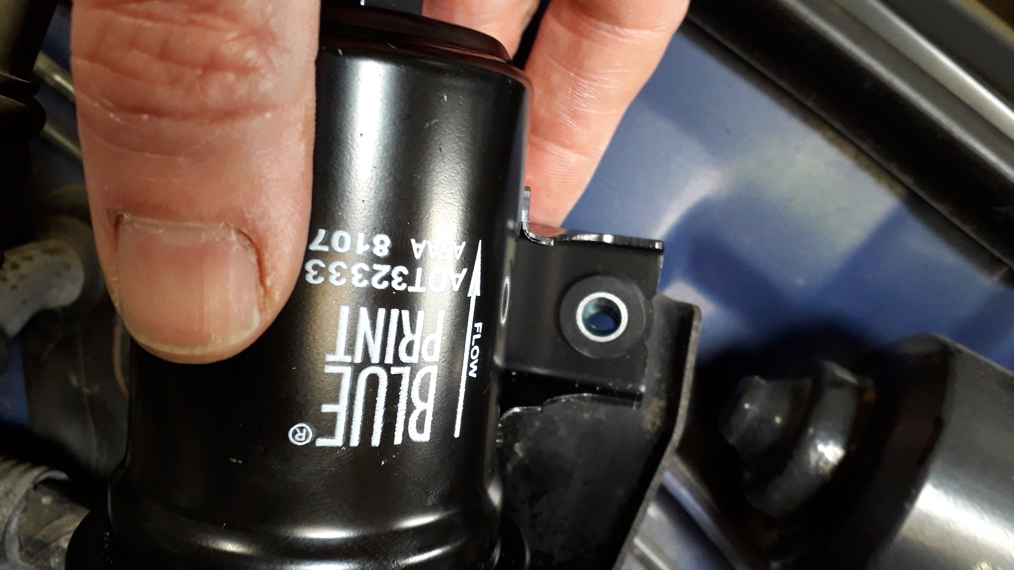

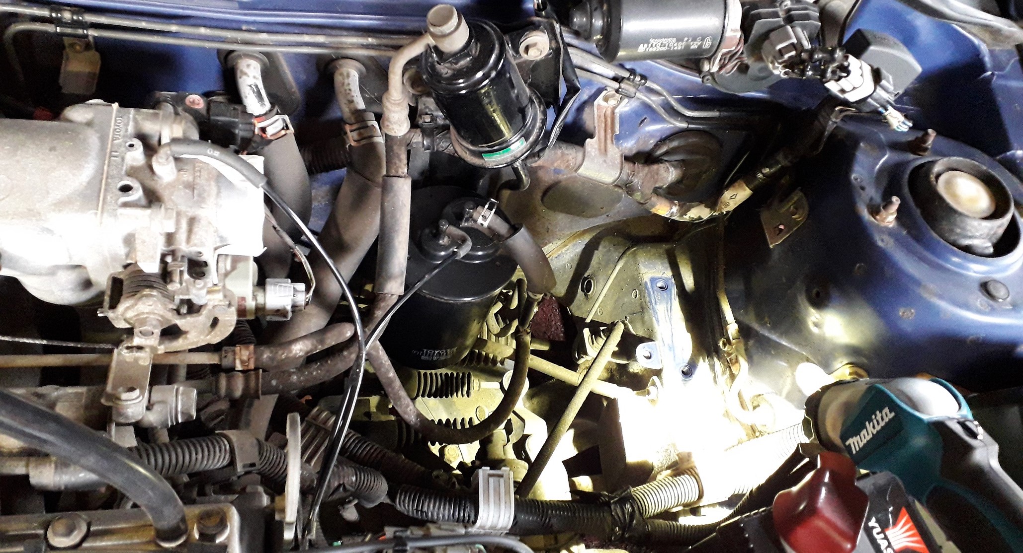

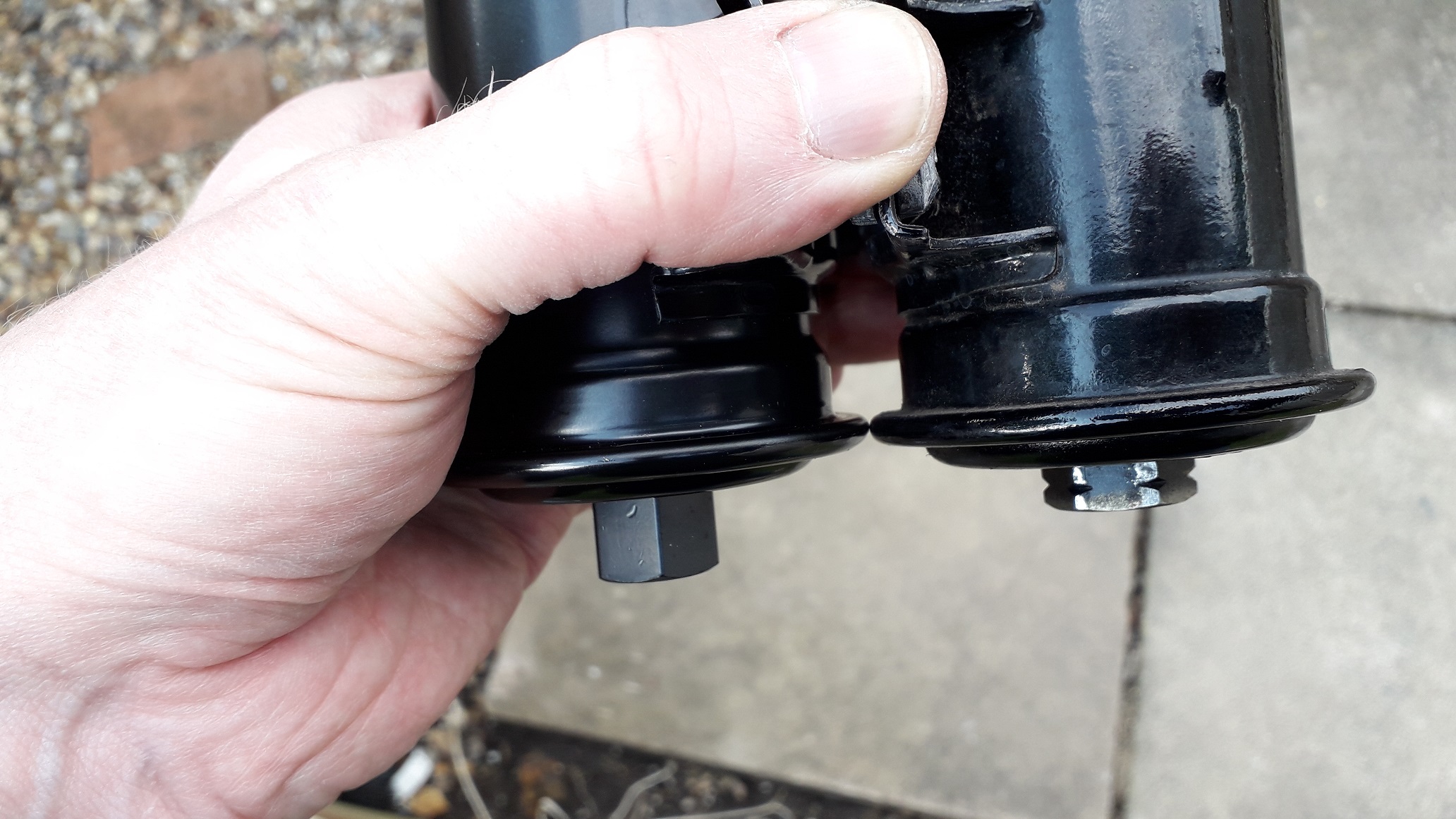

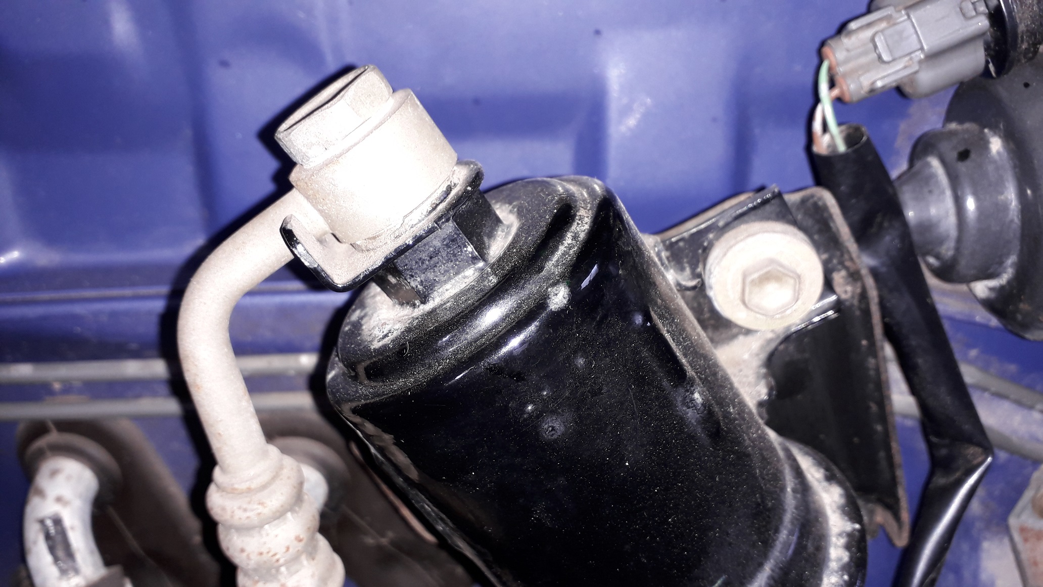

Claymore Posted March 8, 2021 Author Posted March 8, 2021 (edited) Poxy fucking fuel filter! Part 1. Decided to change the fuel filter as part of the "making things ready for turbo" part of the build. Bought a Blue print ADT 32333 as recommended for the EP91. First up I had to remove the upper and lower airbox and intake pipe for access, thankfully these aren't going back on and are now residing in the "Fuck it bucket". I also removed the Air intake temp. sensor from the upper air box, clipped it back onto the plug and tied it up for safe keeping. The car had sat for a week so the fuel pressure was non existent in the rail. First I undid the banjo bolt from the top hose connection using a spanner and a second on the hex part of the filter below to prevent the filter trying to turn. The lower connection is a flare fitting so I soaked it in wd40 for an hour and again I used the hex above the flare nut to hold the filter steady whilst I undid the flare nut with a brake pipe spanner to prevent rounding it off. It loosened off easily at first but soon became very stiff to turn, thankfully I managed to get it out without damaging anything. Removed the 2 x bolts holding the filter to the firewall bracket and the filter was off. Caught the petrol that came from the filter with rags and pan. Test fitted the filter to the pipe (didn't need to attach the flare nut yet) and it became apparent quite quickly that the filter is different enough to the Toyota item that it wouldn't fit without mods to either the feed pipe (no thanks) or modding the mount bracket. The filter is longer and the mounting holes don't line up with the bracket. 😡 Spot the difference 🤬 Made another contraption to seal the feed pipe temporarily. I have ordered a genuine item from Toyota (only £40) but it wont be here from Japan 'til the end of this month. Cheaper and quicker than Amayama too. Getting pissed off with the poor fit of aftermarket parts, atleast with o.e. parts they'll fit and you know the quality will be better. Edited March 8, 2021 by Claymore Quote

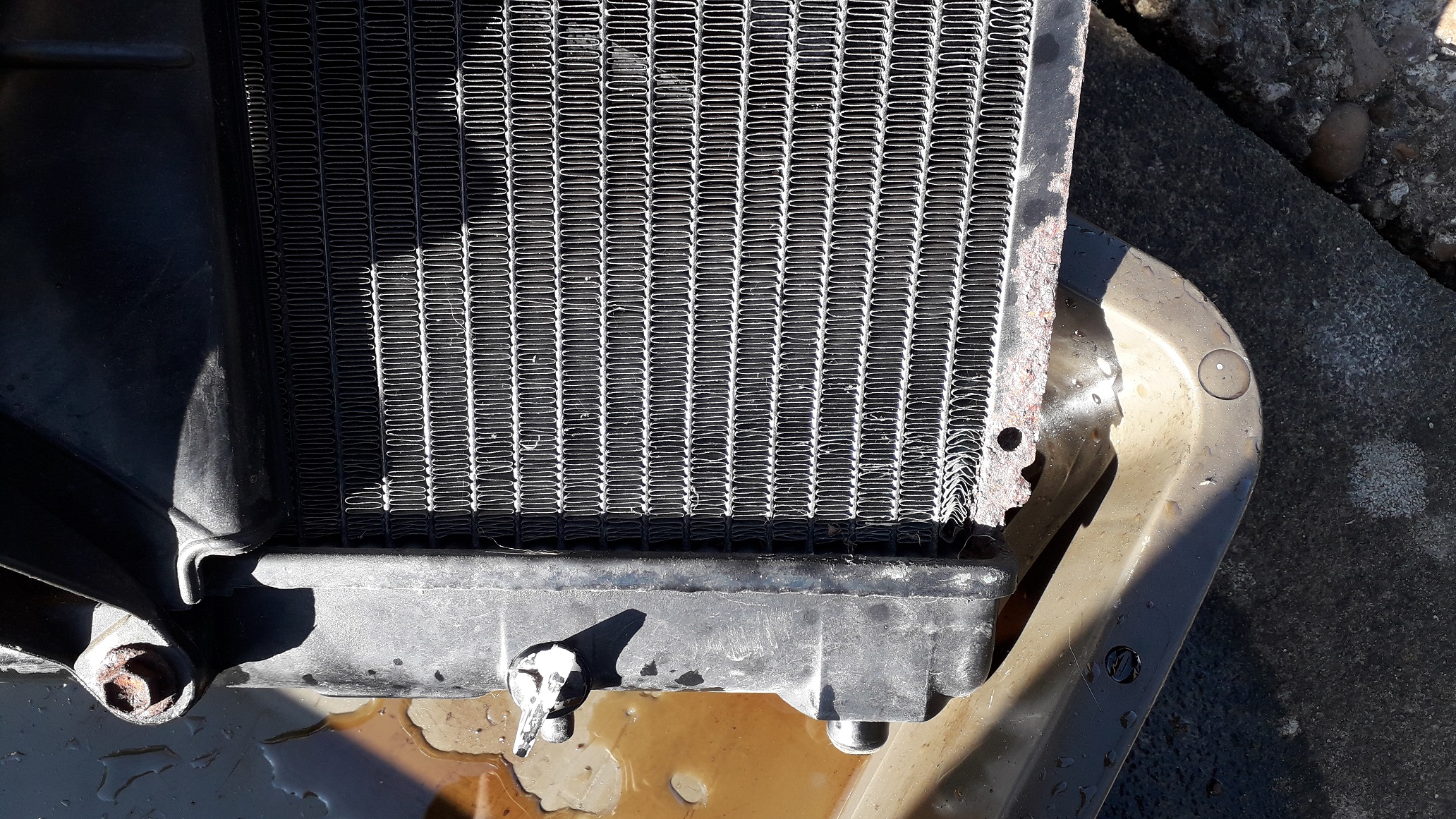

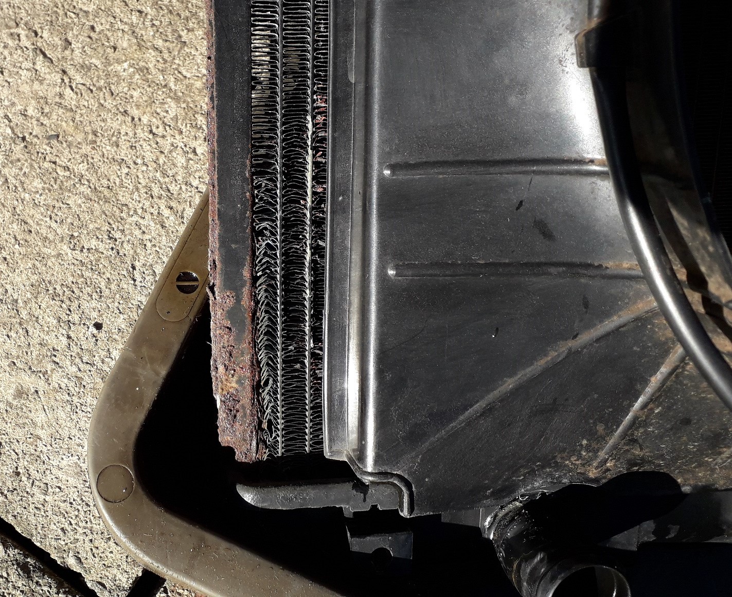

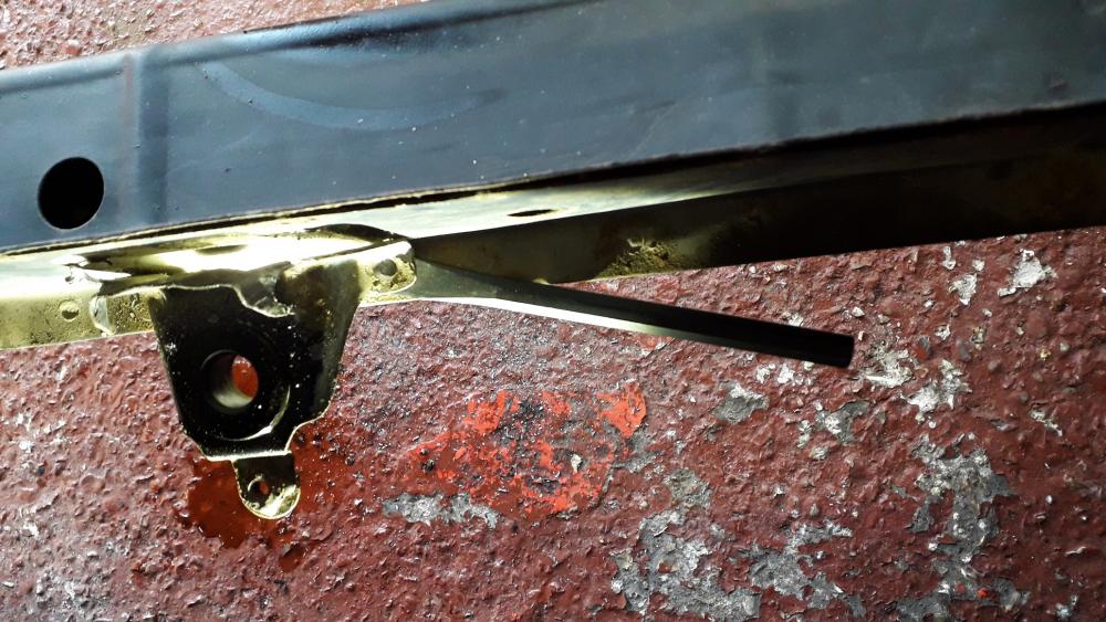

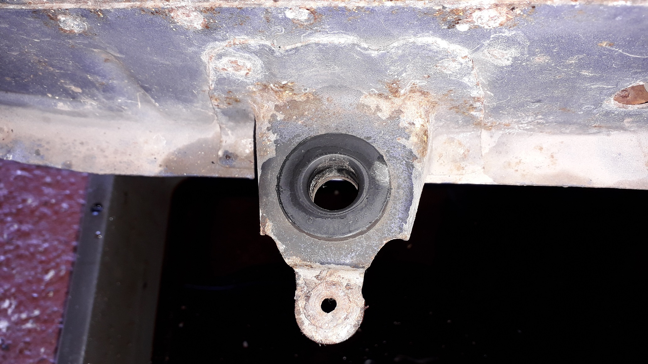

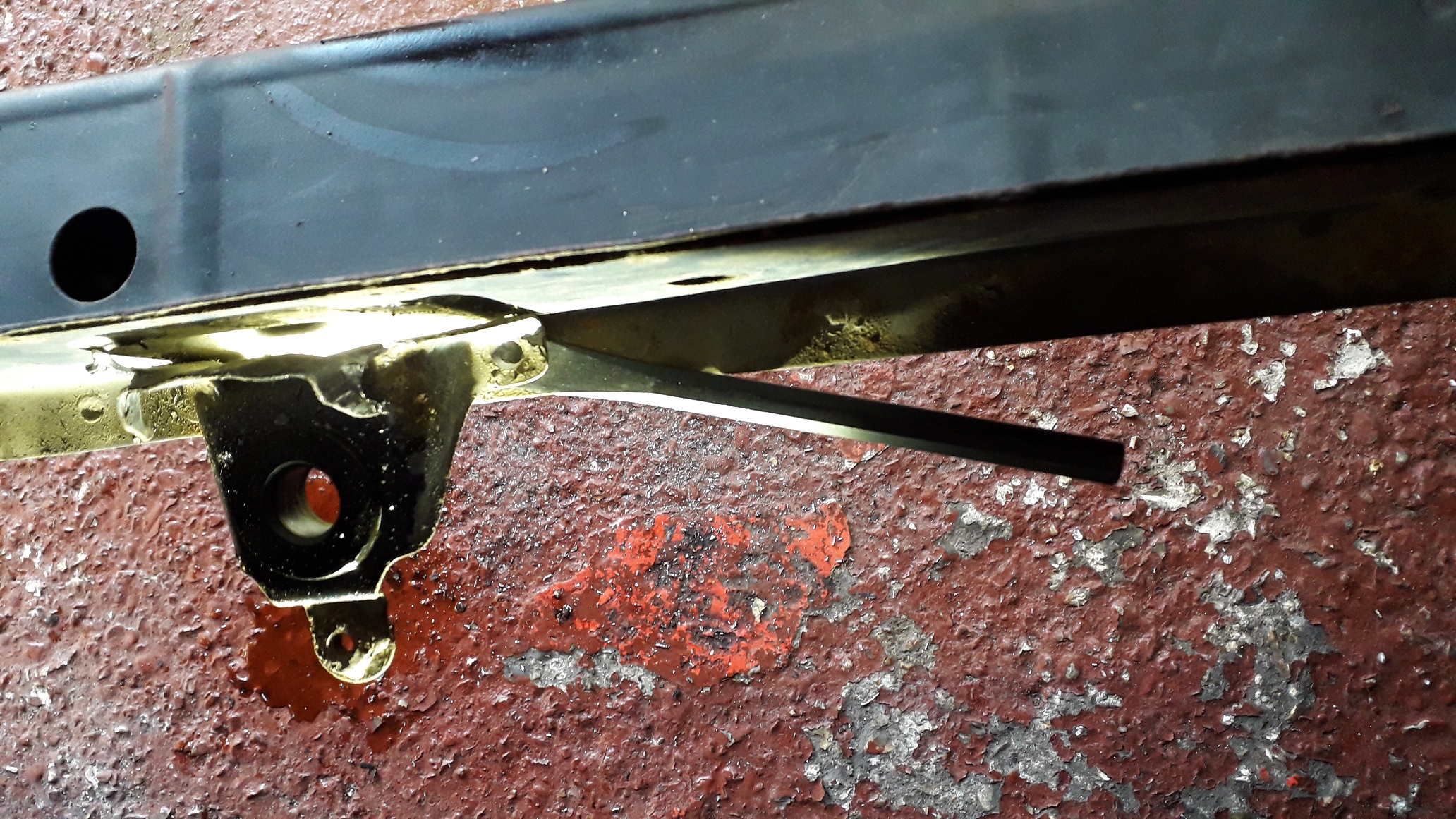

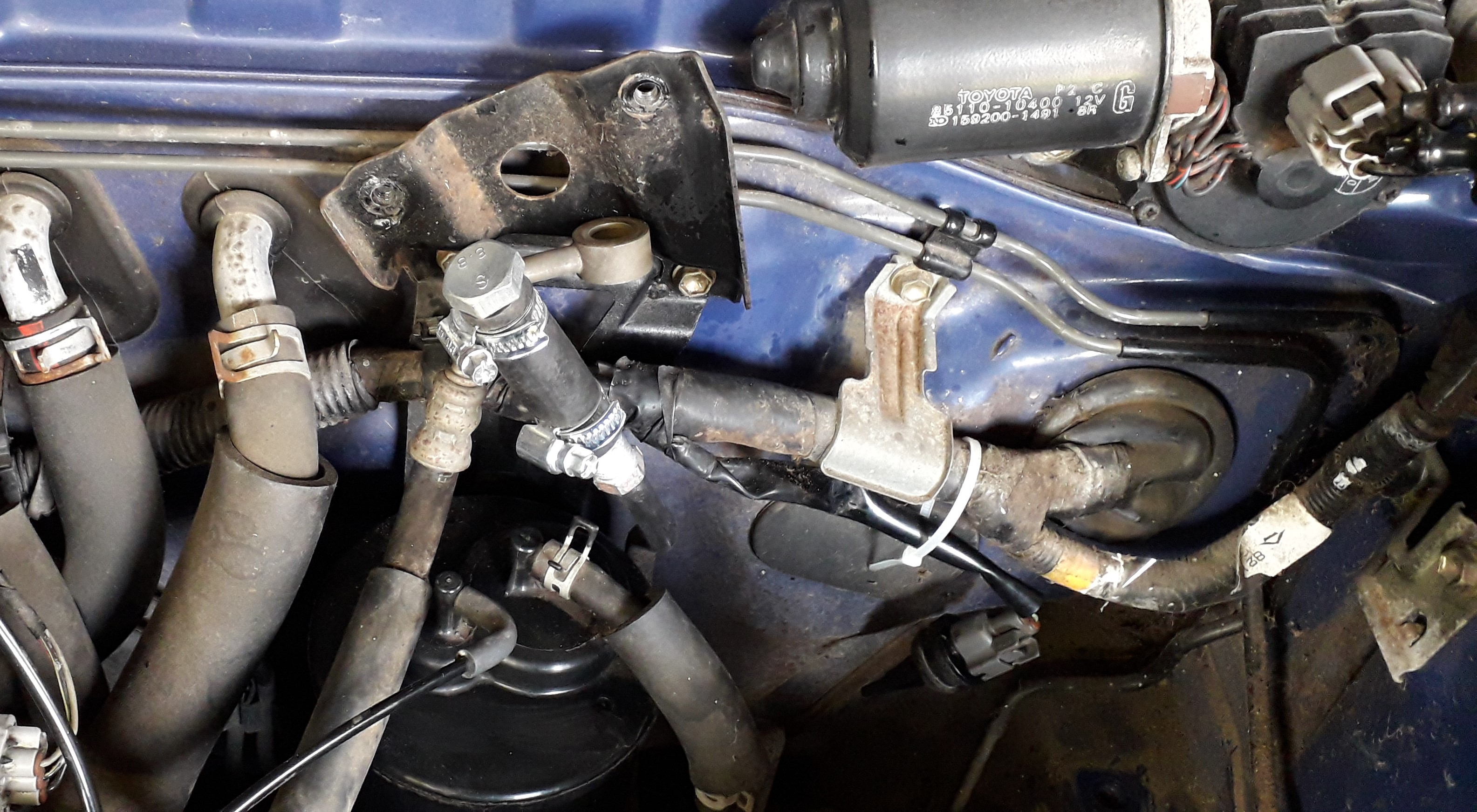

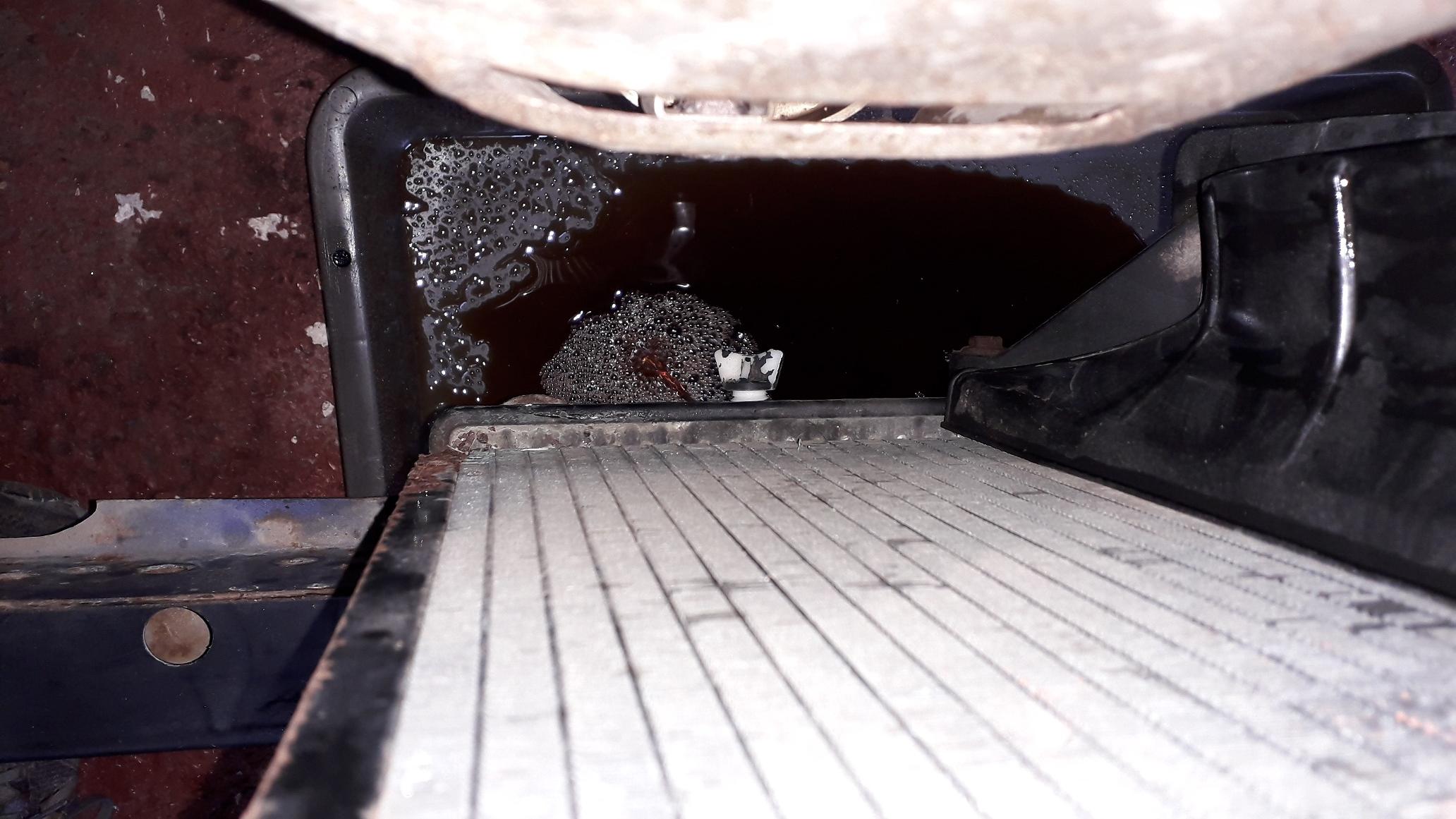

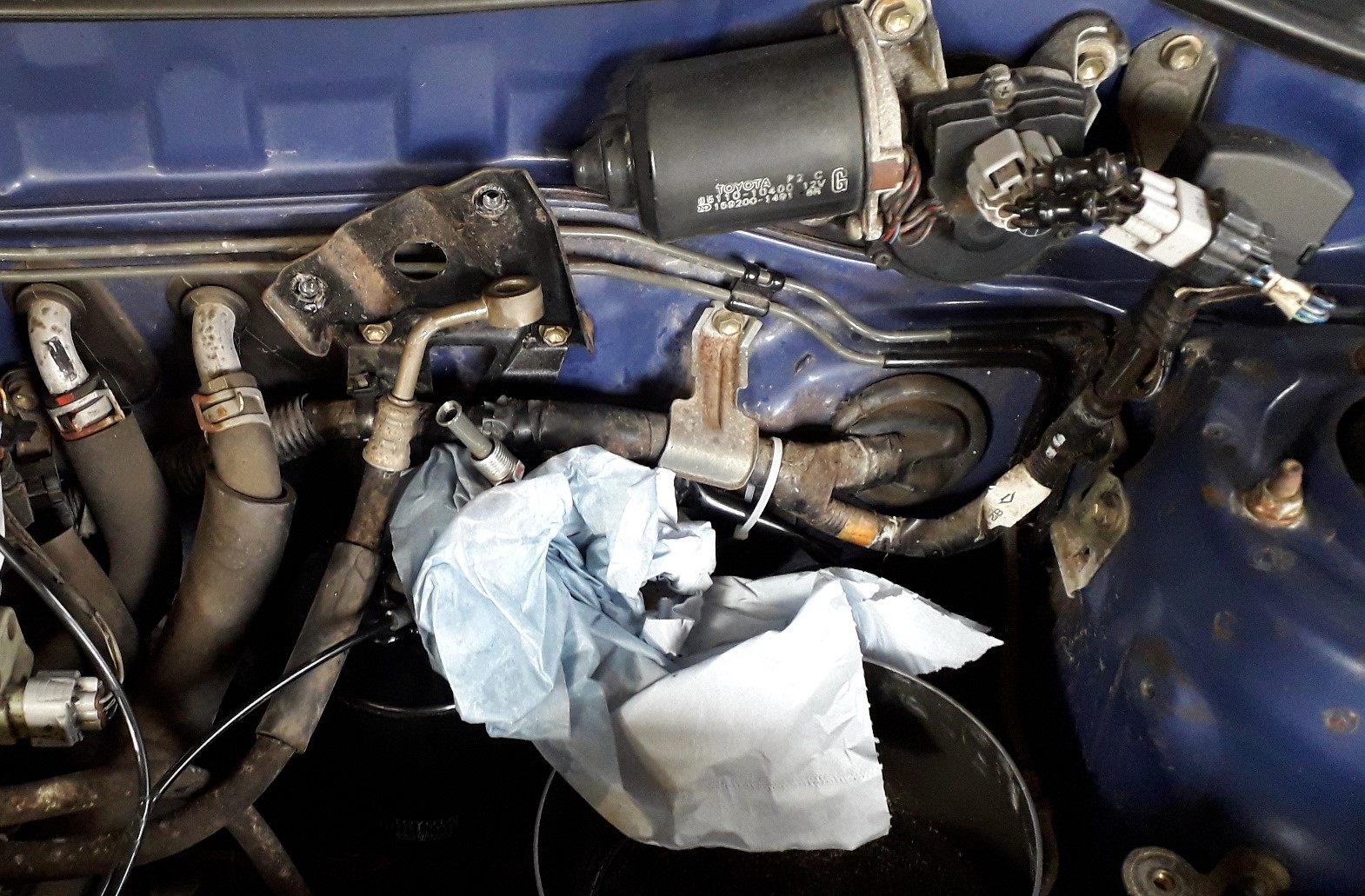

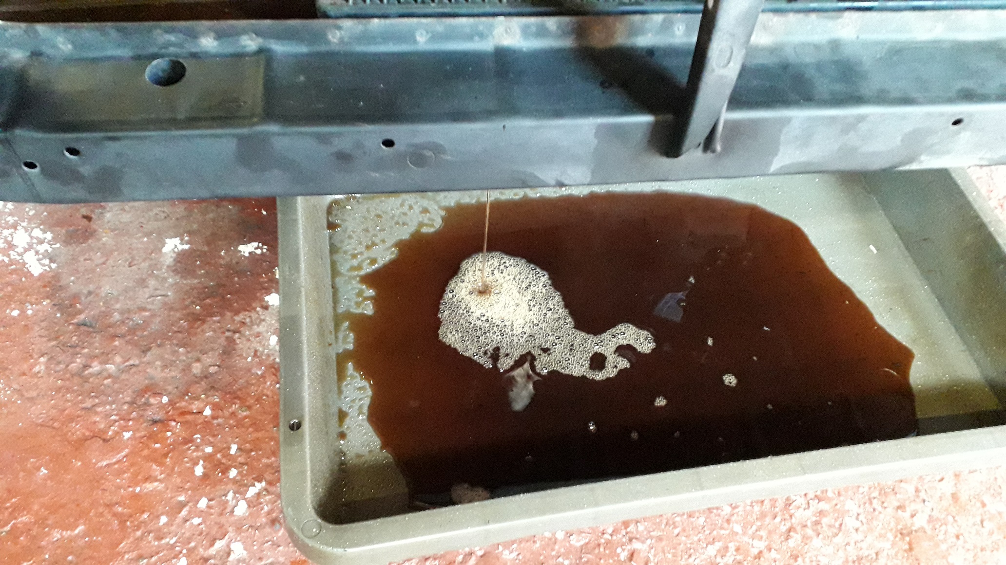

Claymore Posted March 9, 2021 Author Posted March 9, 2021 (edited) Decided to crack on with cooling system. https://www.youtube.com/watch?v=RpA2T589Y-A Used the petcock on the radiator to drain the coolant (cap off to help speed things up) and disconnected the upper and lower hose once drained. Stout pliers required to squeeze the spring hose clamps open. Coolant was well overdue for a change (5 years my arse!) Unbolted the top 2 clamps with a 10mm ratchet, disconnected the fan electrical plug and carefully lifted out the radiator and fan assembly. The radiator core was badly corroded on both sides and had begun to weep at a small section on the front. Edited March 8, 2022 by Claymore Quote

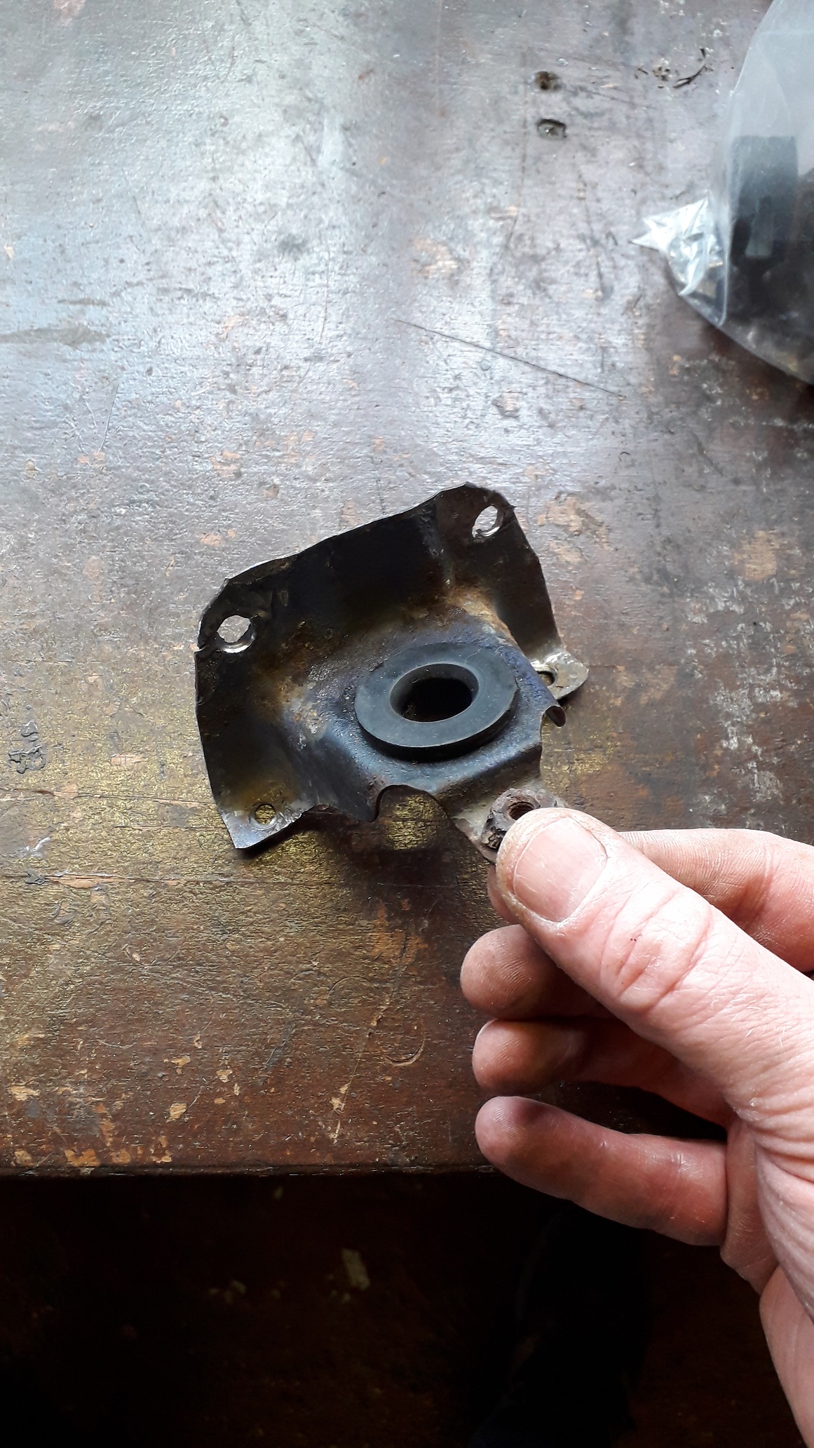

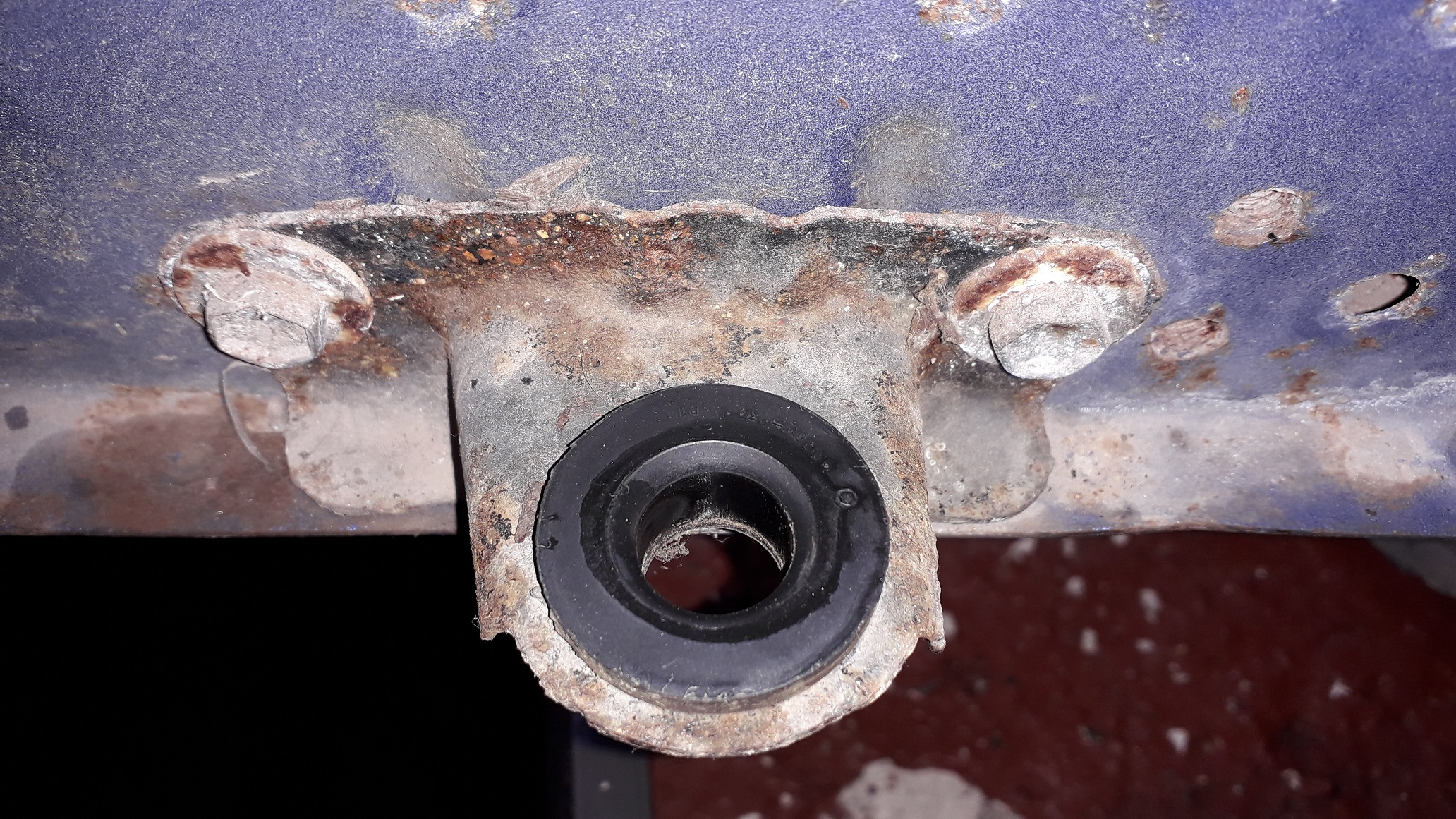

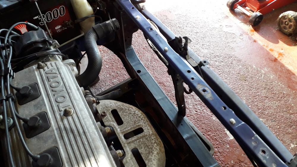

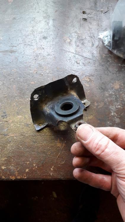

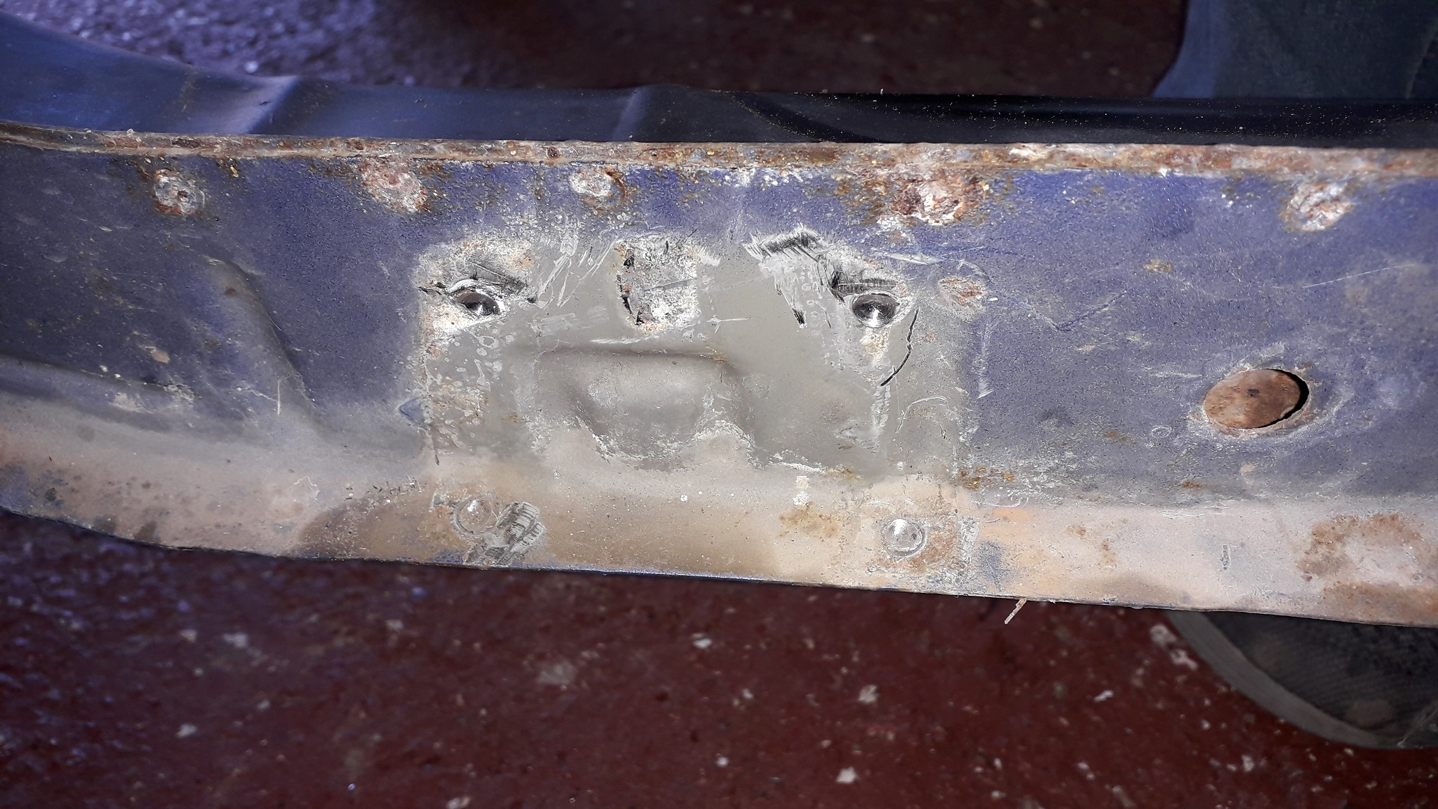

Claymore Posted March 9, 2021 Author Posted March 9, 2021 (edited) Next the mounting brackets needed to be removed. https://www.youtube.com/watch?v=RpA2T589Y-A The drivers side simply unbolts using a 12mm socket, not really in the way but saves a few grammes of weight I guess. Also leaves a couple of m 8 nut inserts available if required. The passenger side mount is in the way of the replacement radiator and must be removed. It is spot welded to the cross member in 4 places. 2 on the vertical face at the top and 2 on the horizontal lip. I don't have a spot weld drill (never really needed one) so I used and 8mm drill bit to drill part way through the top sheet and spot weld. The spot welds are approx. 5mm diameter and the 8mm bit is a shallow enough angle tip to remove enough material without making a hole right through. With the welds significantly weakened I used a cold chisel and hammer to split the last parts of the welds. Once removed, the remaining welds were dressed back with a sanding wheel on an angle grinder before priming to prevent corrosion. Bracket after removal to show spot weld locations. Also ground back the remaining 2 bolt shafts that snapped when removing the bumper. Edited March 8, 2022 by Claymore Quote

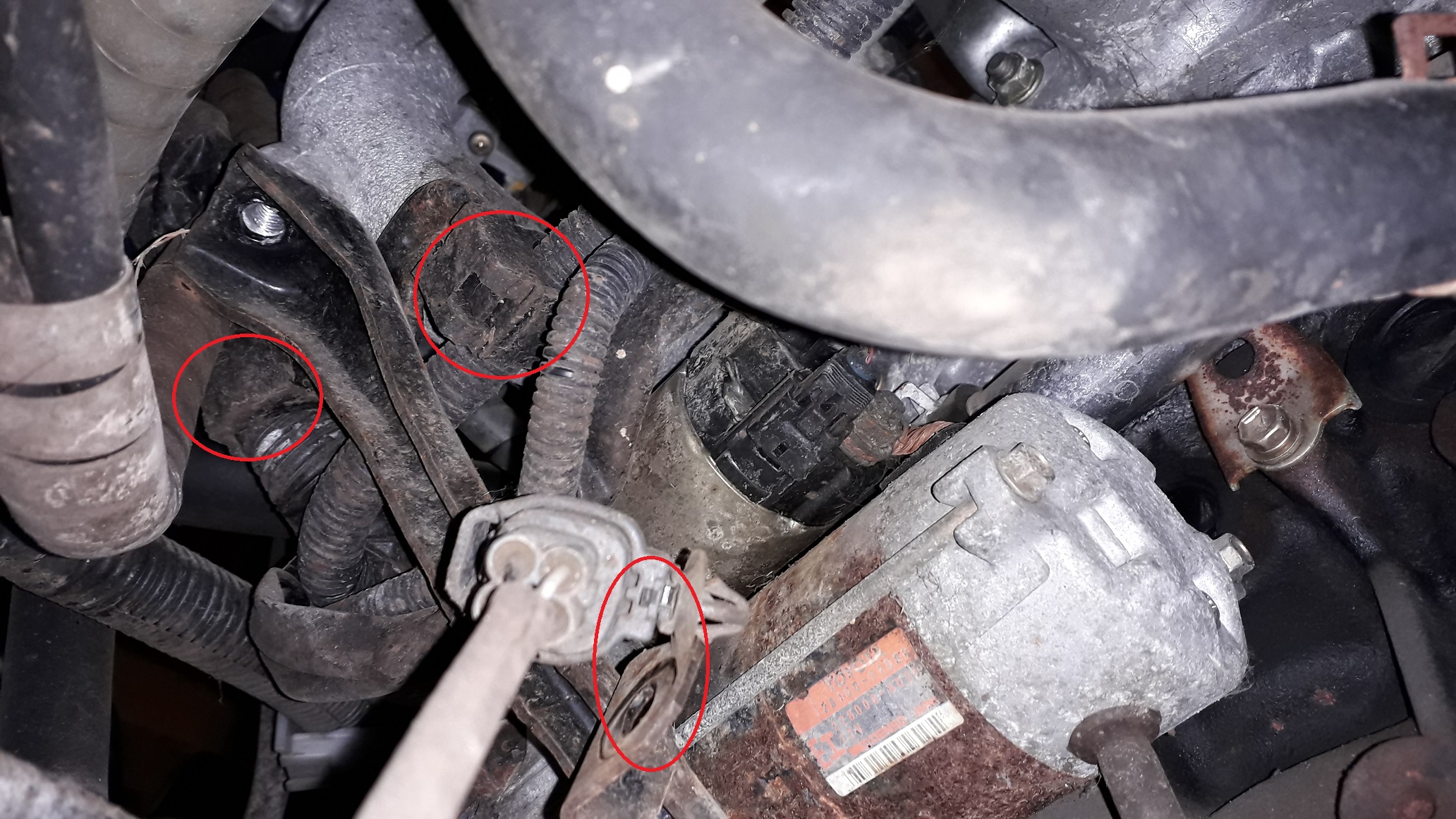

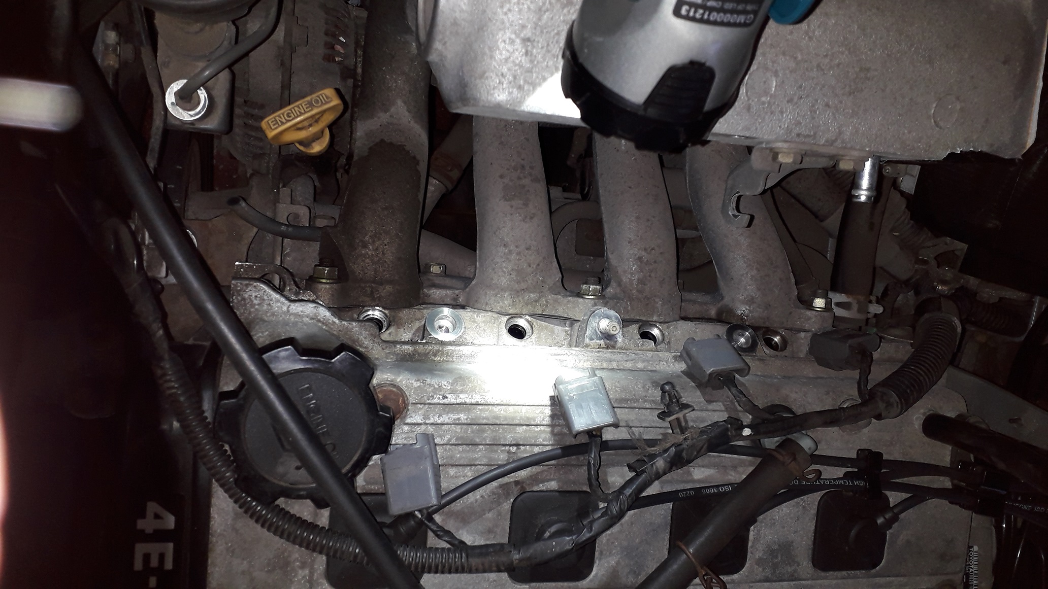

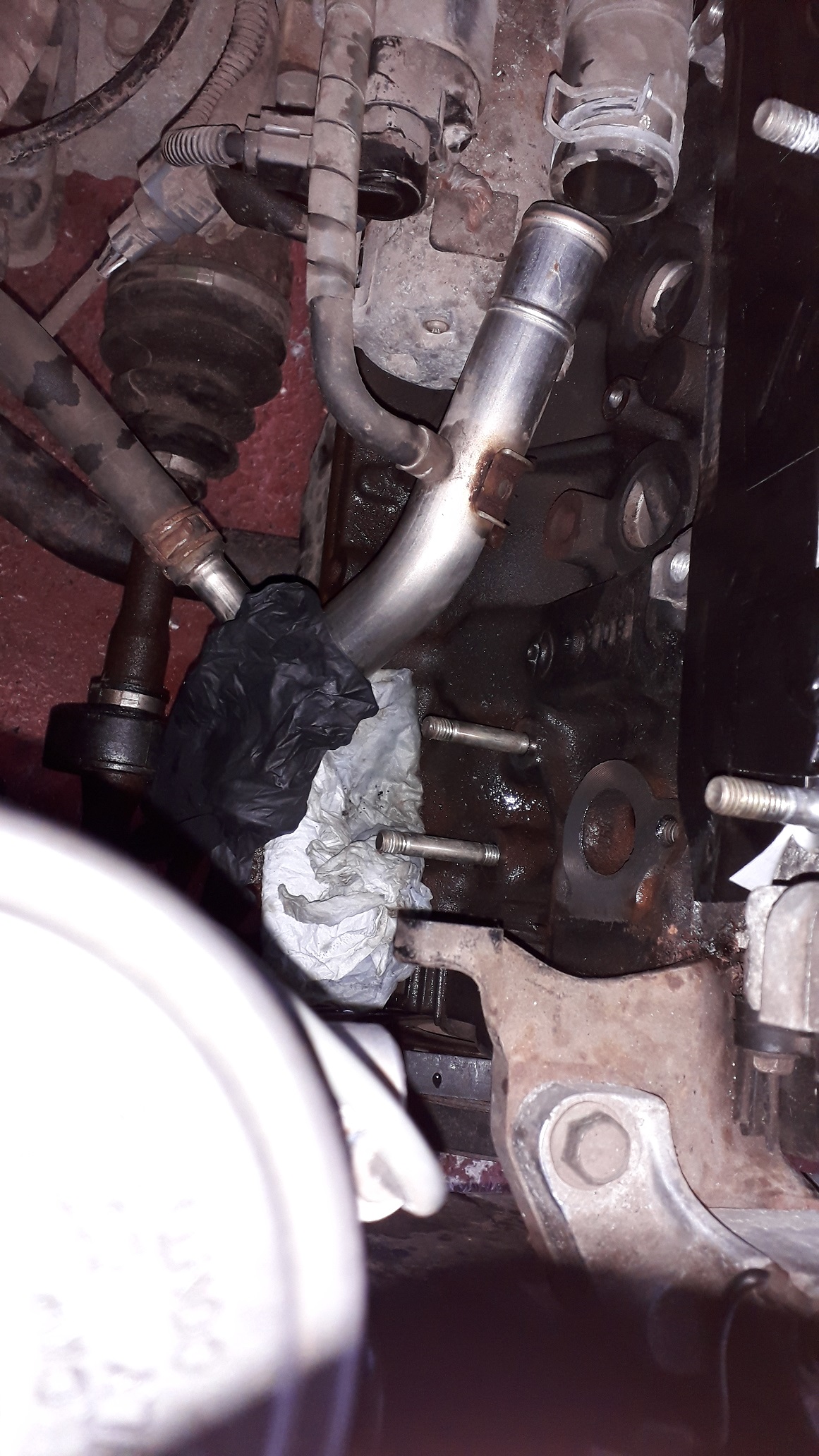

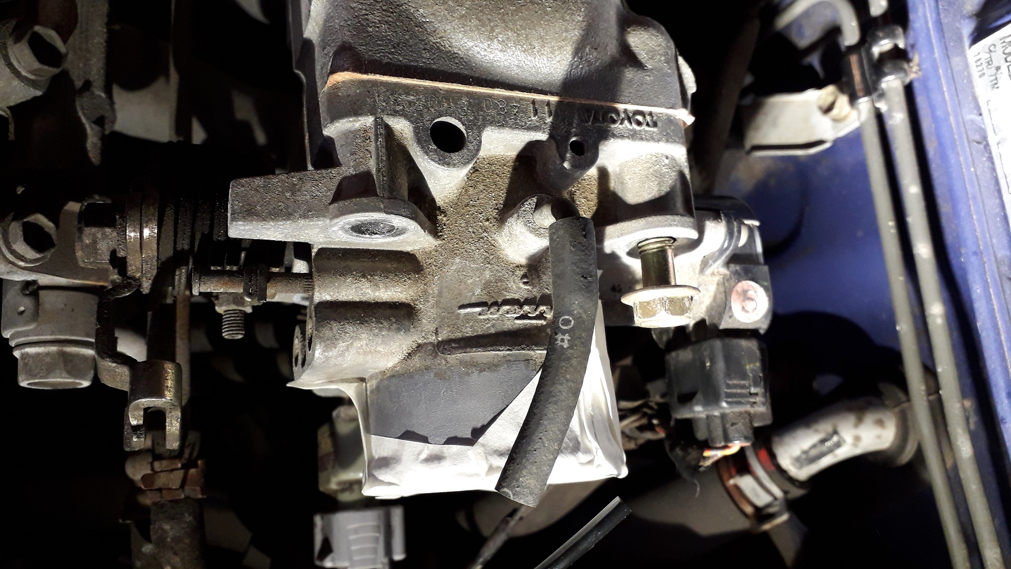

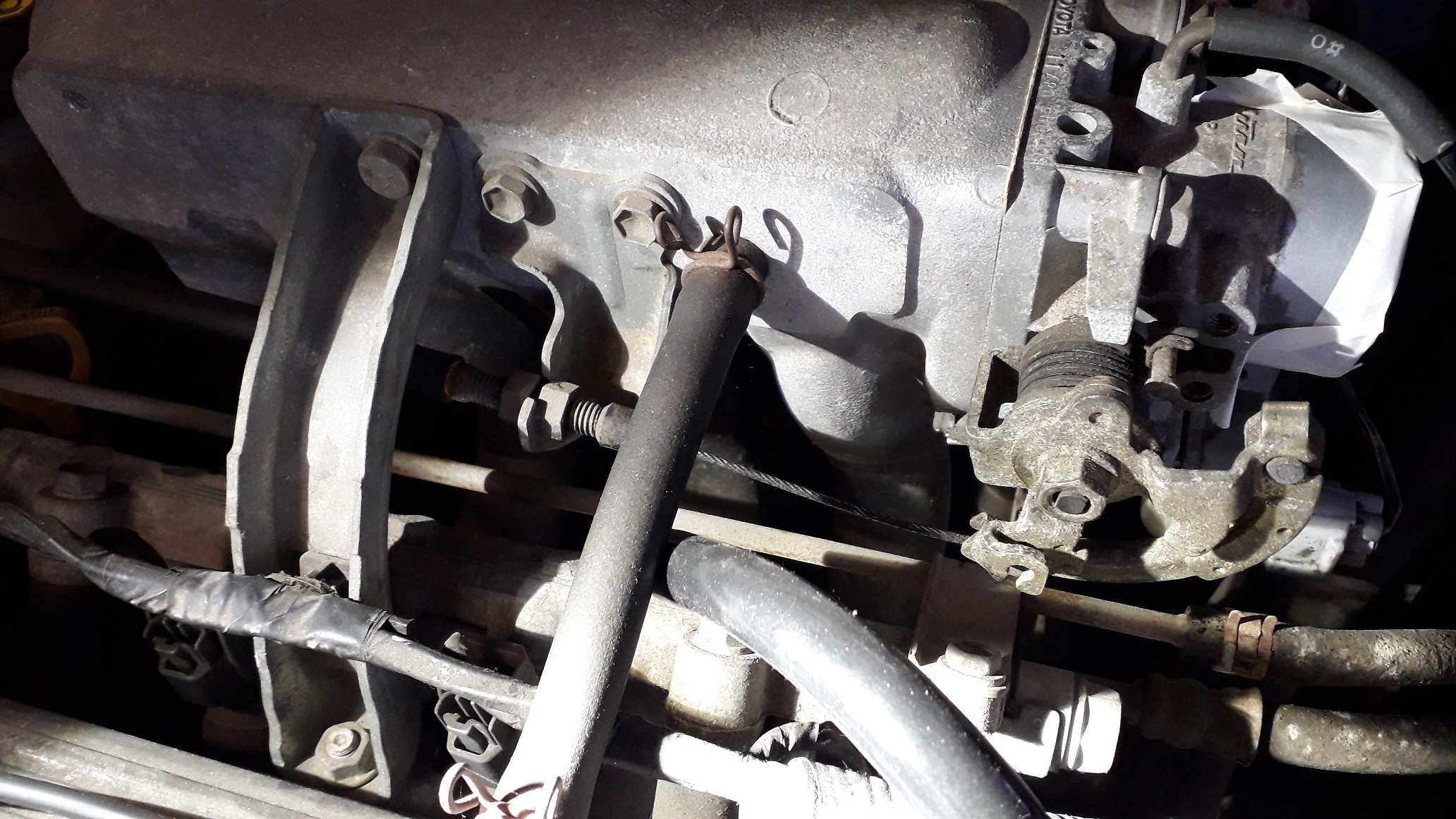

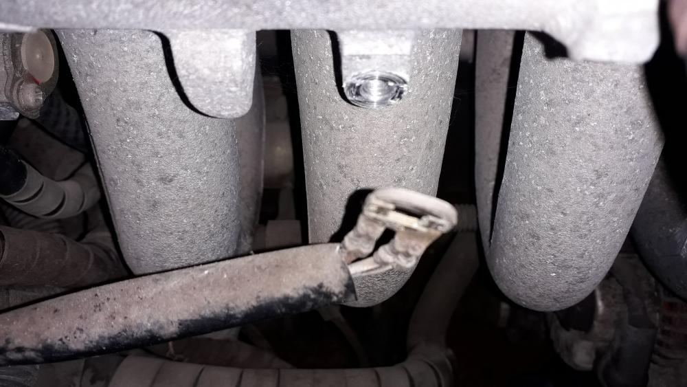

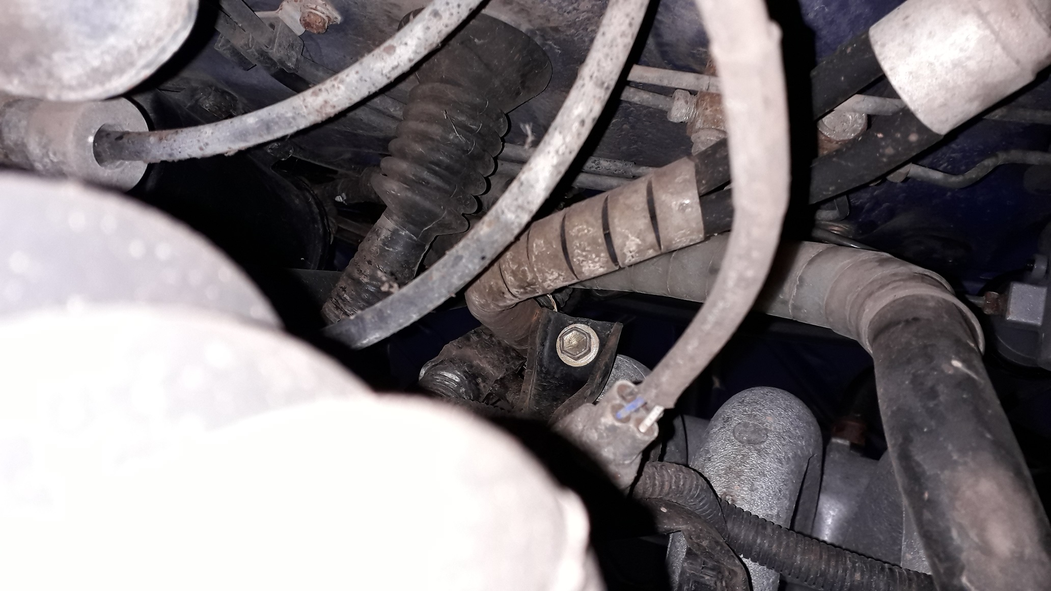

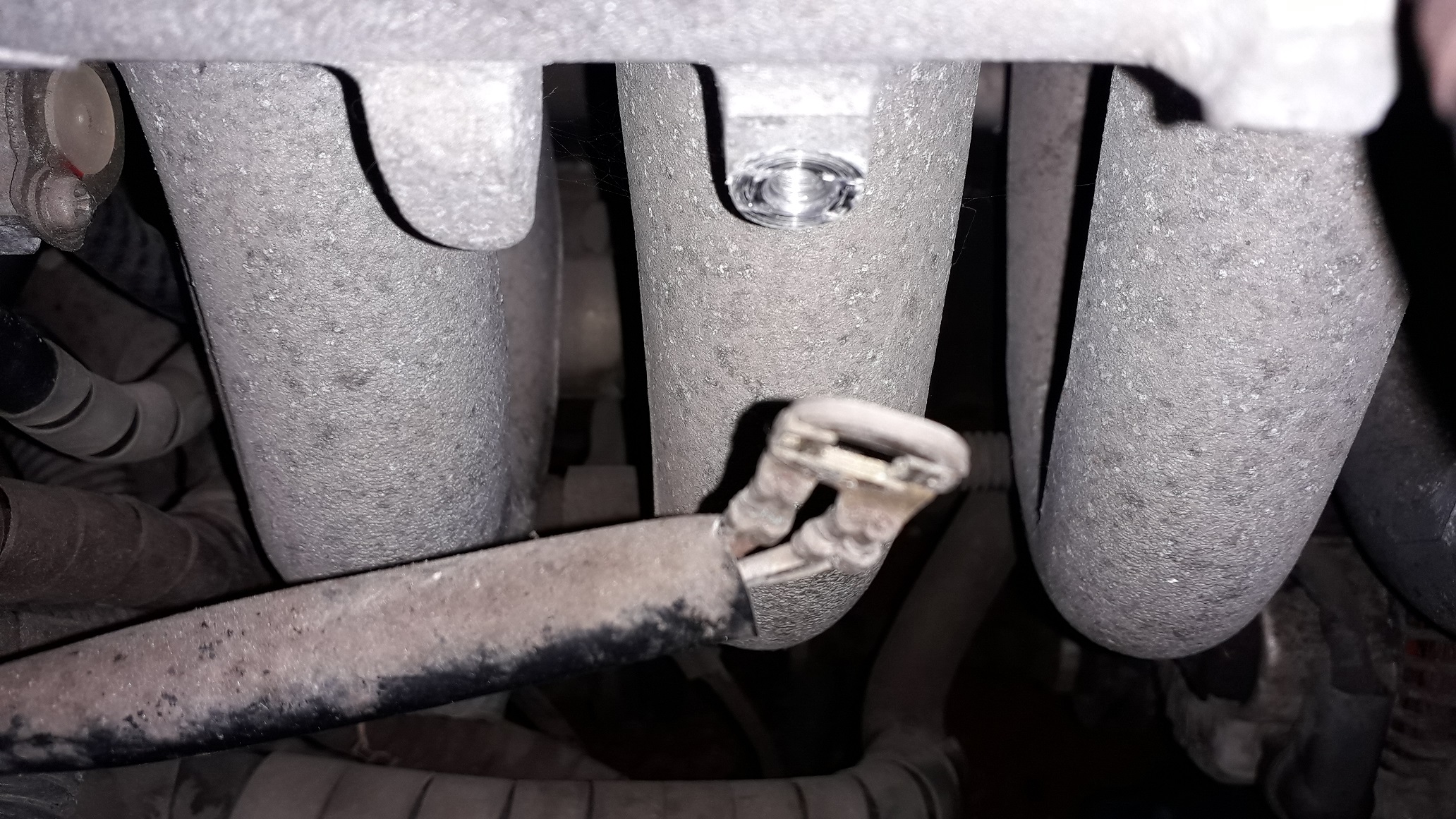

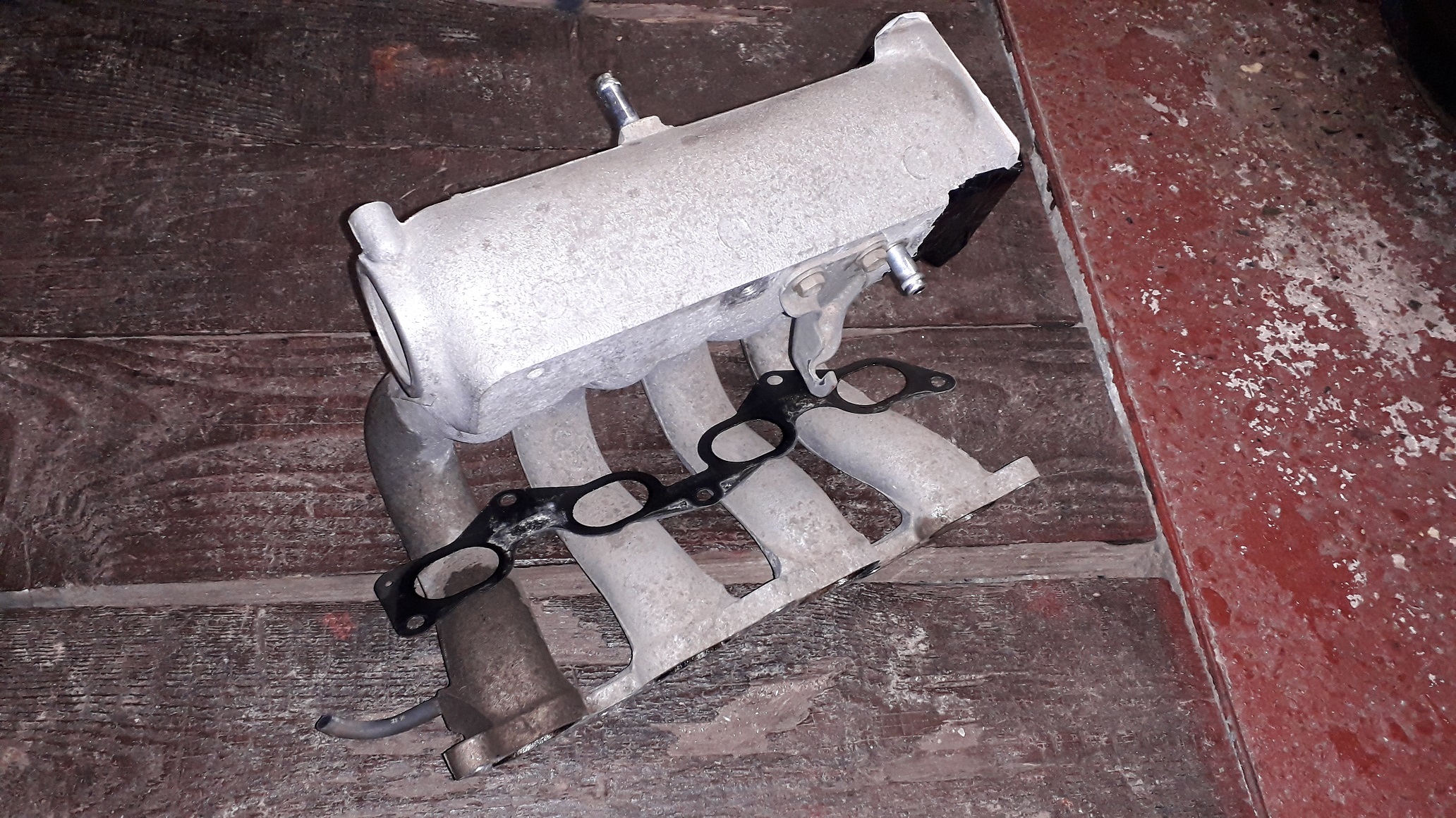

Claymore Posted March 10, 2021 Author Posted March 10, 2021 (edited) 4efe inlet manifold removal. I'm looking to replace the water pump and as the inlet manifold will be replaced with the 4efte version it made sense to do it as part of the pump replacement. So today I started burrowing down the back of the engine to get at the pump. I have a complete water pump with housing so it seemed to be the easiest way of doing it. It quickly became apparent that this is the type of engine bay that requires half the work from above and half from below. So with the car safely on axle stands it was time to start disconnecting things, first I removed the pcv, map sensor, fpr, and tvv hoses from their manifold pipes. Loosened the 12mm nuts holding the throttle cable and unhooked if from the throttle body. Unbolted the 10mm bolt that holds the earth wires to the back of the manifold. Crawled under the car to find the lower support bracket is bolted to the manifold in one place. Used a 12mm long extensions combo to undo said bolt. The lower bracket has the O2 sensor plug, alternator loom and engine wiring loom clipped to it also. The bottom of the bracket is connected to the block with a single nut that I also removed. Edited March 10, 2021 by Claymore Quote

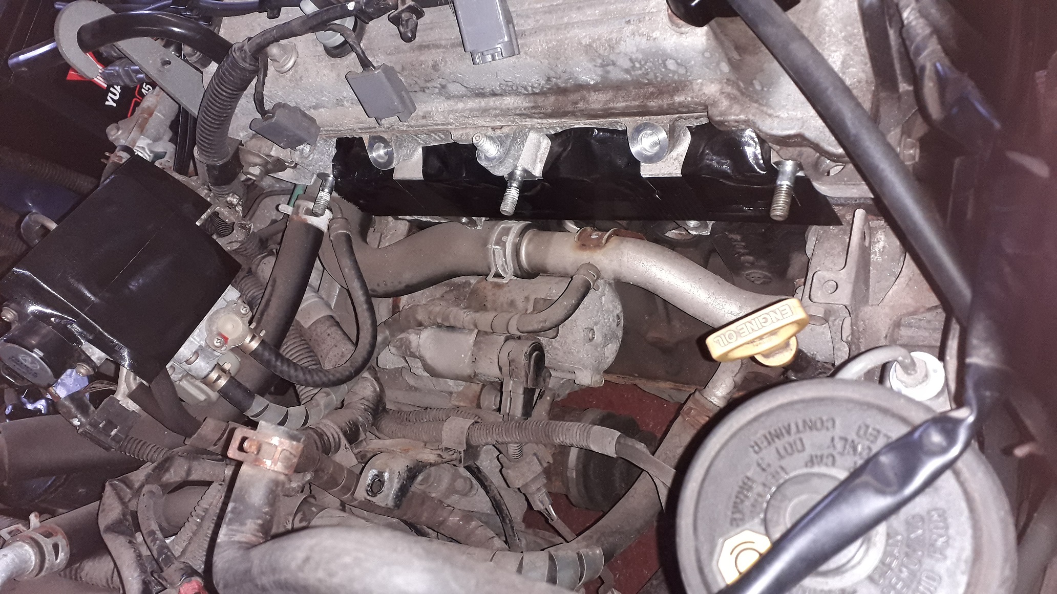

Claymore Posted March 10, 2021 Author Posted March 10, 2021 (edited) Back in the engine bay..... Unbolted the 4 x bolts that hold the throttle body on and laid it off to the right. Taped up the manifold and back of throttle body. Removed the upper support bracket after unclipping the injector / map sensor / brake fluid level harness from their mounts. Needed to remove the injector rail to gain access to the manifold mounting bolts, removed the 2 x 12mm bolts that hold the rail on, rescued the spacers that fell out and fucked off under the car! The head seals had perished quite badly so I vacuumed up any loose pieces before lifting the rail slowly out. The middle rubber spacers were also munted on a few. Removed the lower injector seals from the head and vacuumed the ports. The 3 x nuts and 2 x bolts could now be removed with the trusty 12mm once again and the manifold was free. Pretty oily inside but finally it was out. Vacuumed out the intake ports and taped up the head to keep it clean. It was also nice to be able to see the water pump (right side in this picture) finally. Still a way to go but atleast the access is improved. Edited March 10, 2021 by Claymore Quote

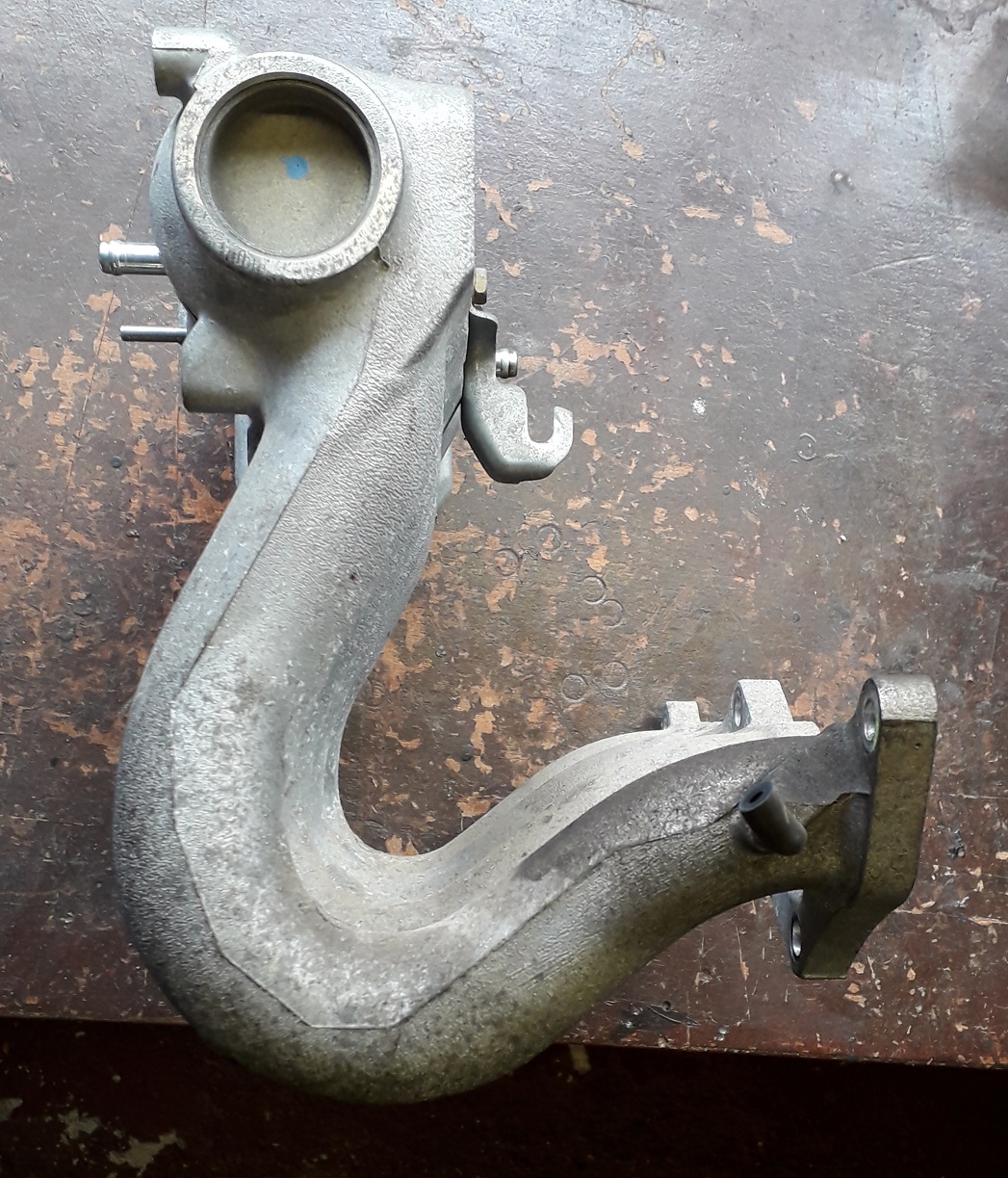

Claymore Posted March 11, 2021 Author Posted March 11, 2021 (edited) The 4efe stock manifold has quite a tortured path for the air to follow before entering the head, tight bends also. Edited March 8, 2022 by Claymore Quote

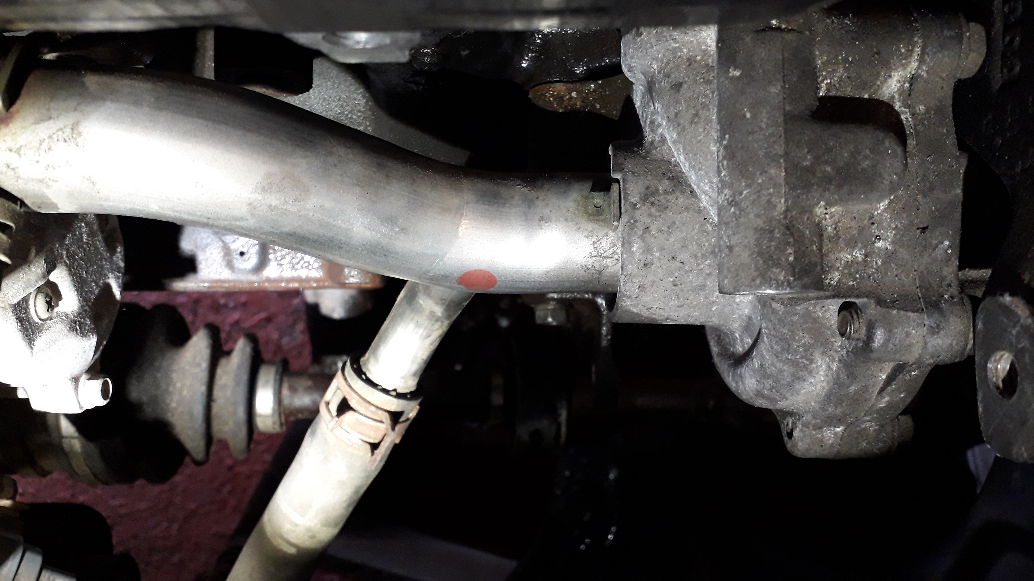

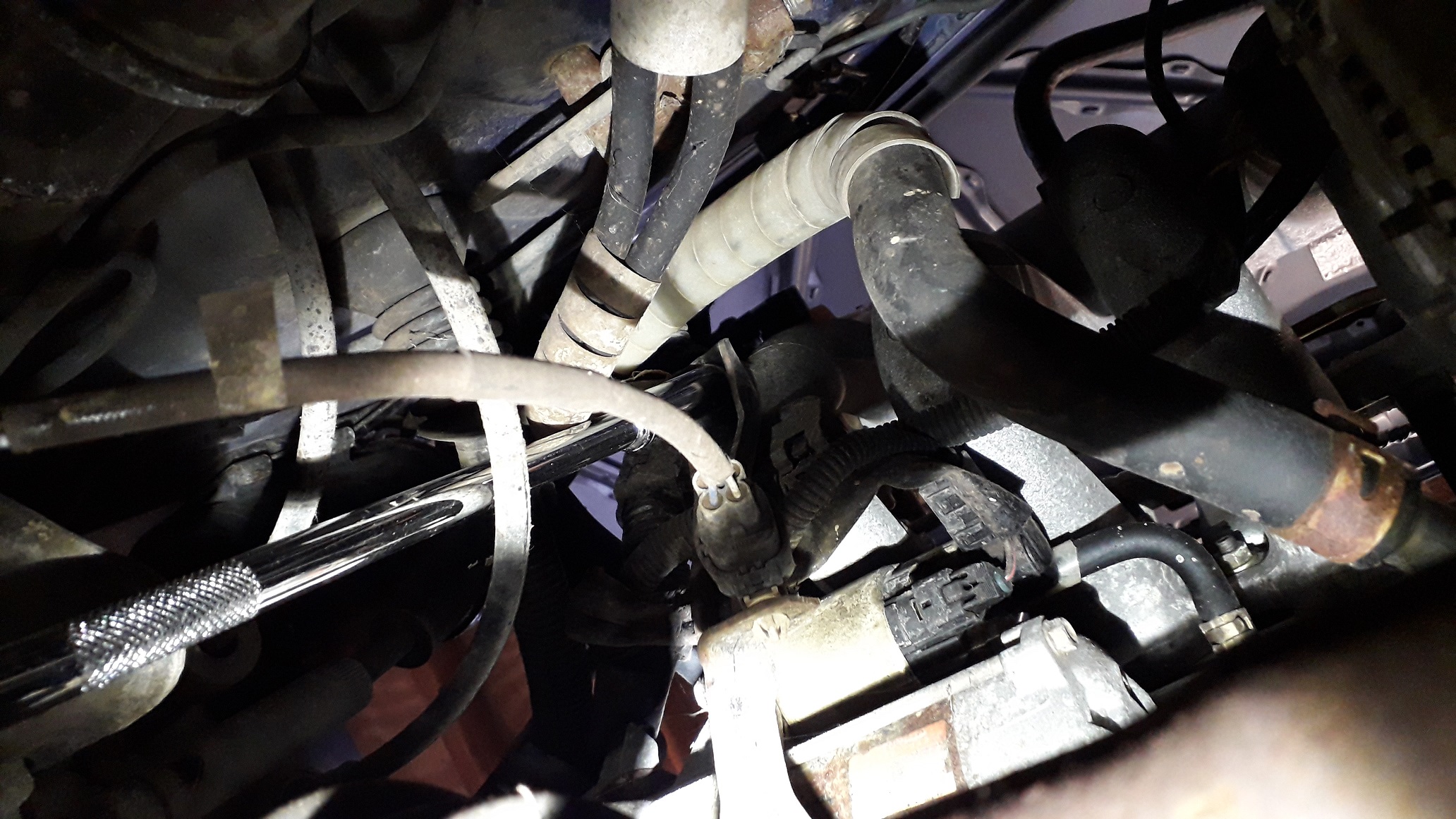

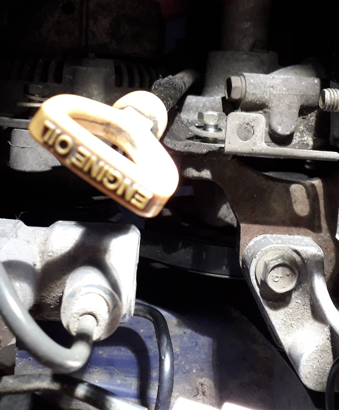

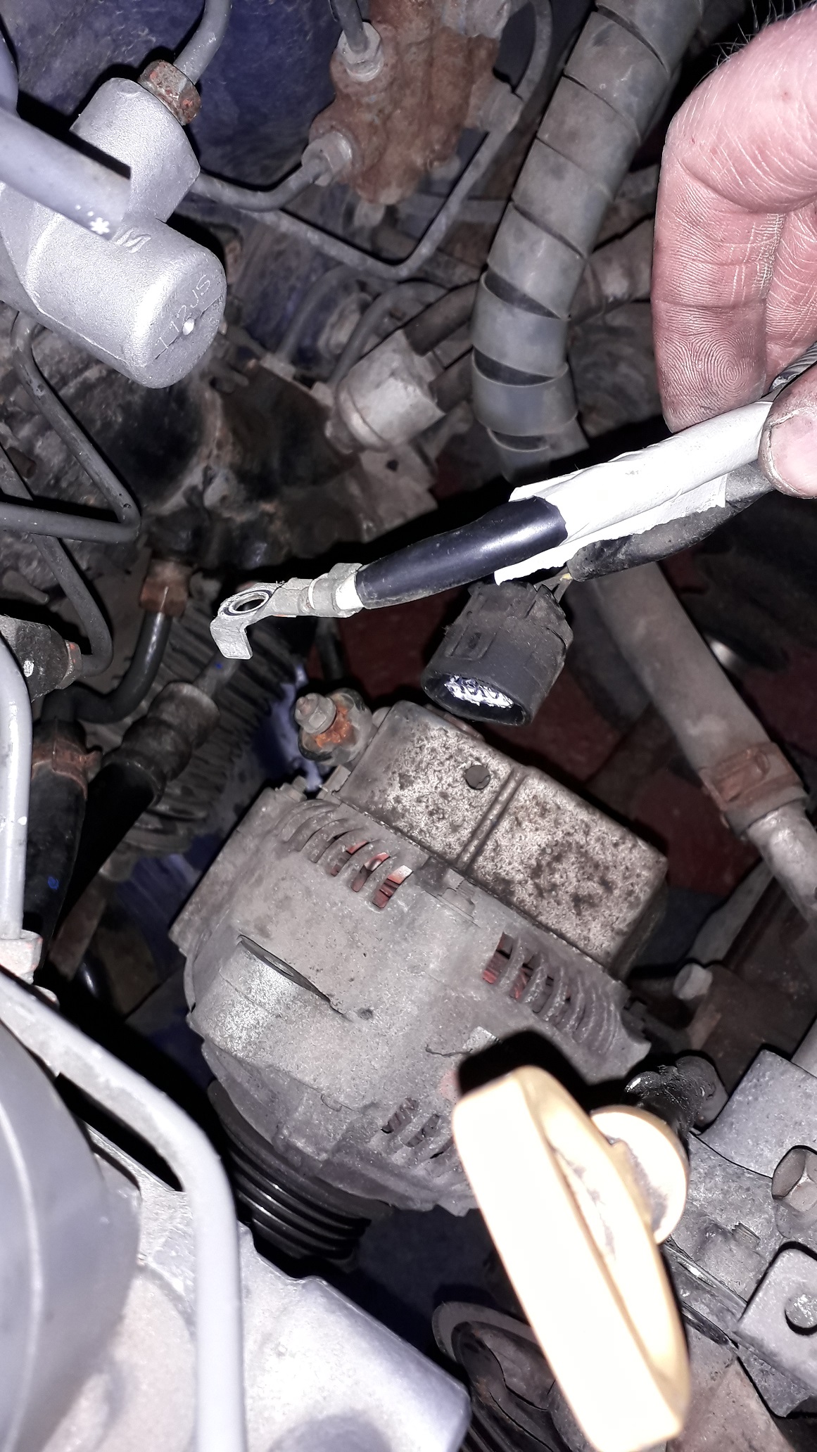

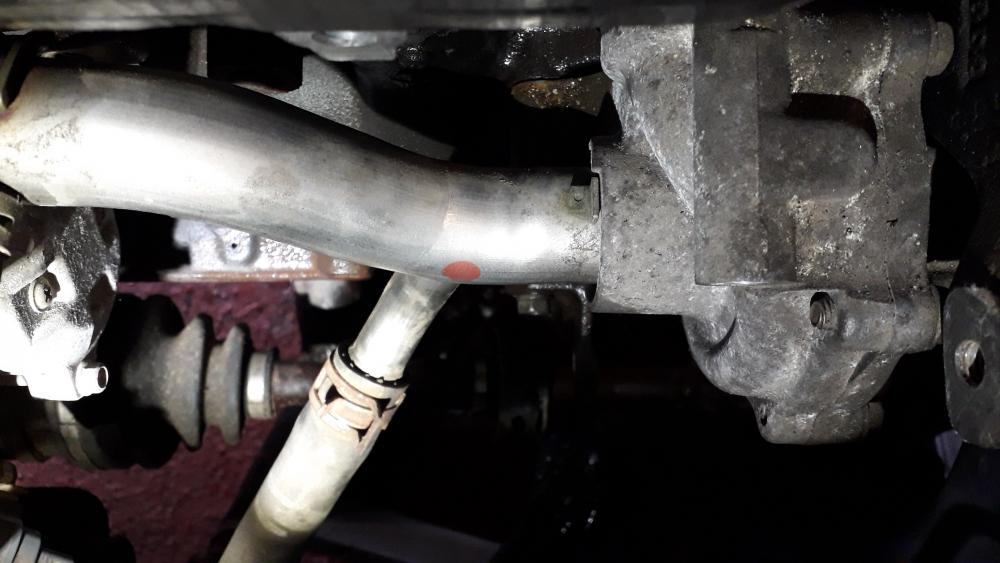

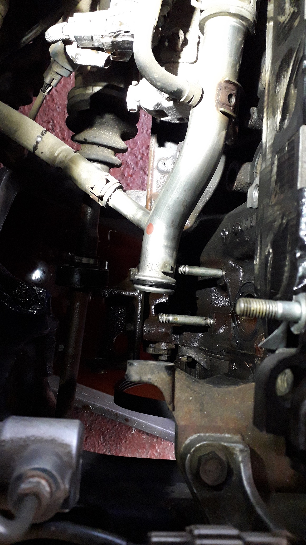

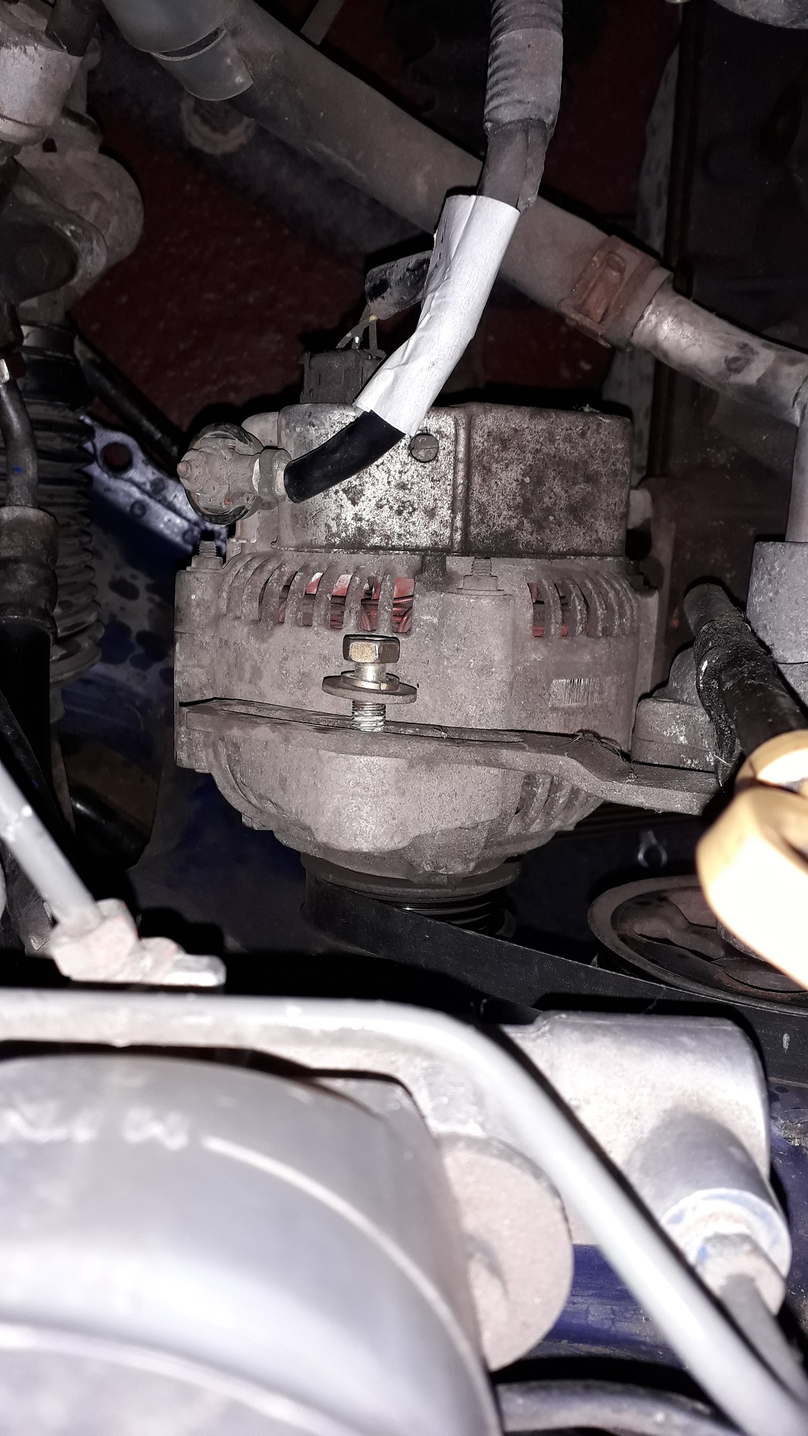

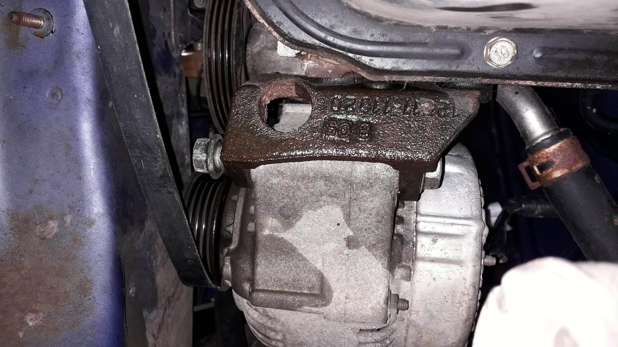

Claymore Posted March 12, 2021 Author Posted March 12, 2021 (edited) 4efe water pump removal. With the manifold off, the alternator was next on the list so I loosened and removed the belt tension adjuster bolt (12mm socket) Disconnected the alternator wiring. (10mm socket and a clip wire connector) Loosened and removed the lower pivot bolt and nut from underneath the car (14mm spanner / socket) Removed the belt tension bracket pivot screw (12mm socket) and the bracket. It also attaches the dipstick tube to the engine mount. Removed the alternator from the engine bay. The dipstick tube was now free so I removed the stick and pulled the tube out of the block. Vacuumed the crust from the hole it revealed in the block. Edited March 12, 2021 by Claymore Quote

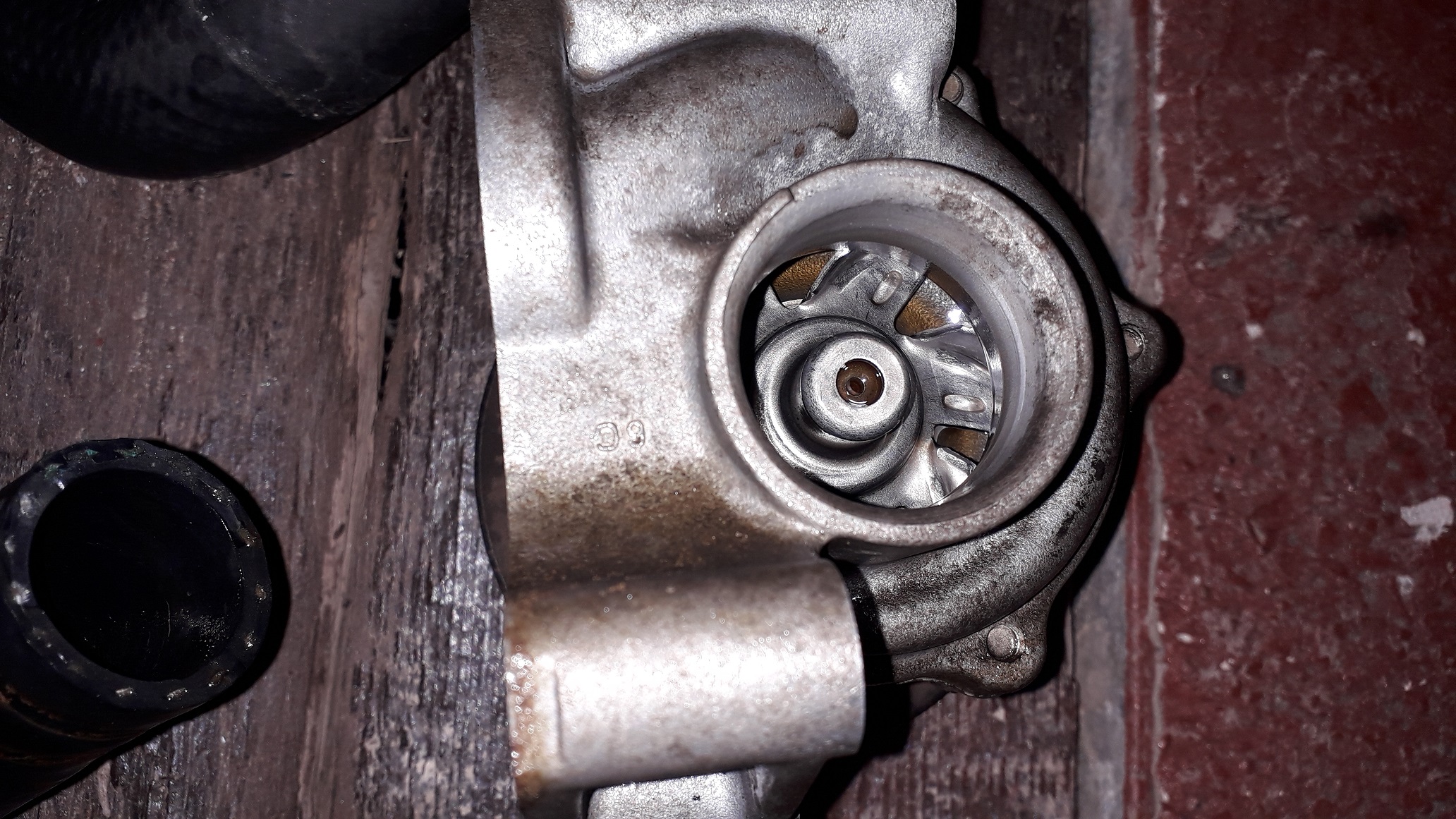

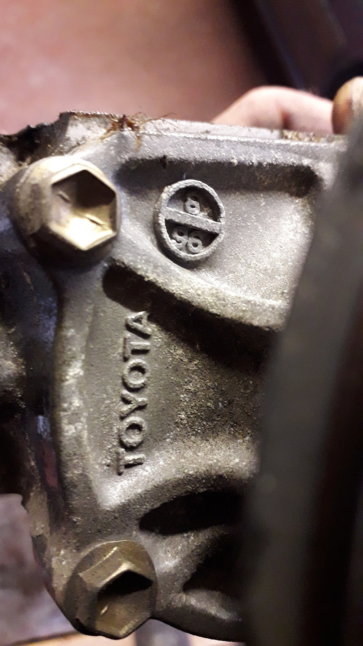

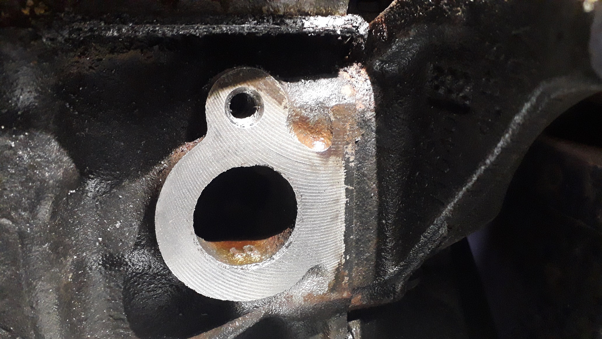

Claymore Posted March 12, 2021 Author Posted March 12, 2021 (edited) Finally getting somewhere I could actually remove the pump. (12mm socket for 1 x bolt and 2 x nuts). The water tube is held to the block with a single bolt (10mm socket) and I removed this to allow the pump to be separated from the block with the pipe still installed and then I removed the pump from the pipe. Note the metal tab on the pipe locates next to a step in the pump housing to make sure the pipe bracket is correctly angled to bolt to the block on install. At this point I realised I hadn't covered the dipstick / block hole and the torrent of old coolant that had poured from the block on pump removal may have entered the sump a bit! (oh well 😲) Pump off and the O-ring on the tube is clearly visible. I removed it with a small blunt screwdriver ready for the replacement. Cleaned up the block face with a mixture of Stanley scraper to get the worst of the sealant off then a small wire brush to get the remaining material from the machining marks still visible on the face. The pump had the casting date August 96 so looks to be the original one from the Toyota factory. The impeller vanes looked excellent, not rust to speak of. Only a slight squeak when turning which I assumed was the seals. Plenty of life left in it really (only 43k miles on the engine) but peace of mind is an important thing before turboing. Removed the water pipe from its hose to free up its movement and make installing it in the new pump easier. Thankfully the car is as taken apart as it needs to be for this part of the build so next will be the pump install and re-attachment of the ancillaries. Edited March 12, 2021 by Claymore Quote

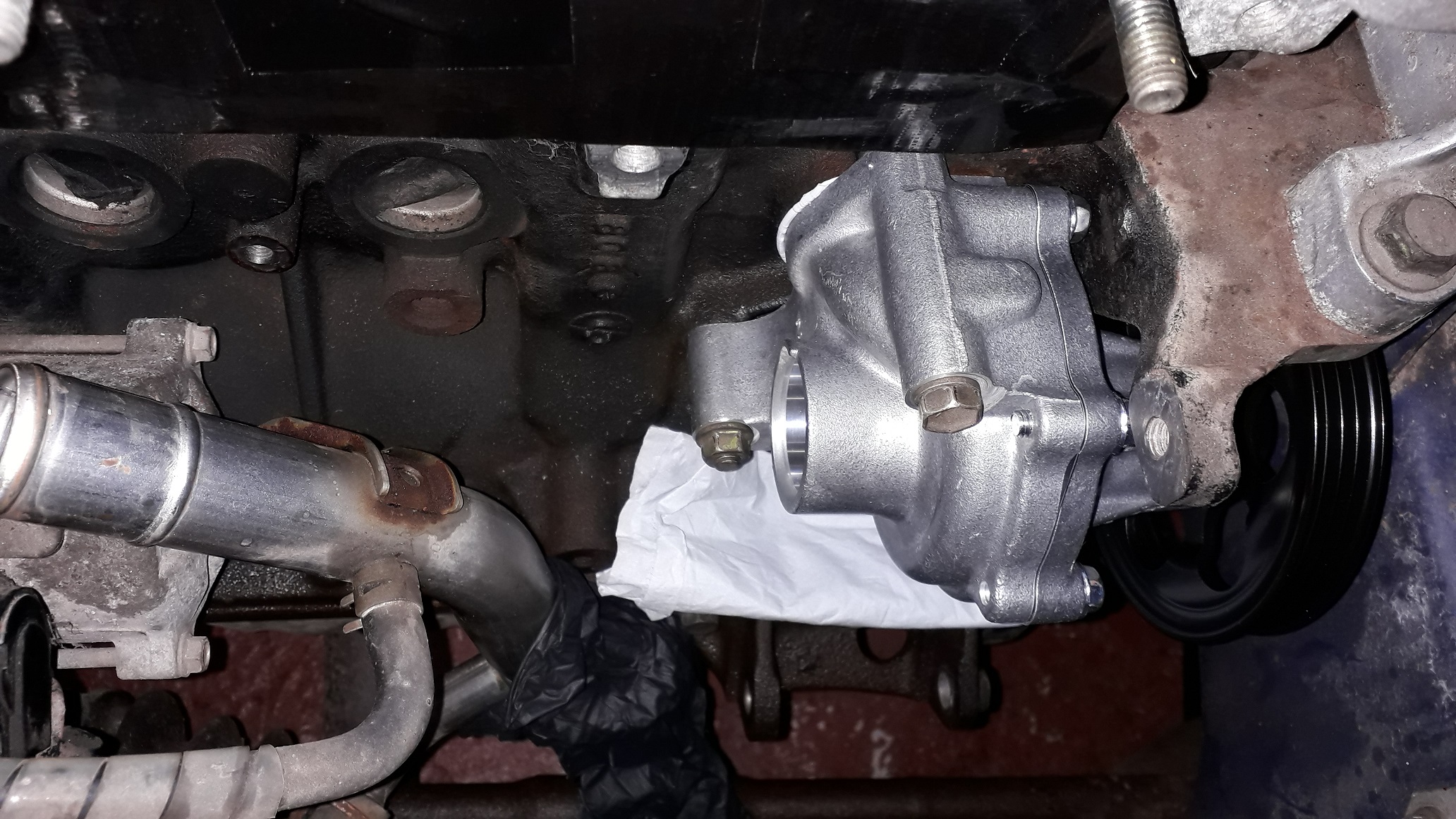

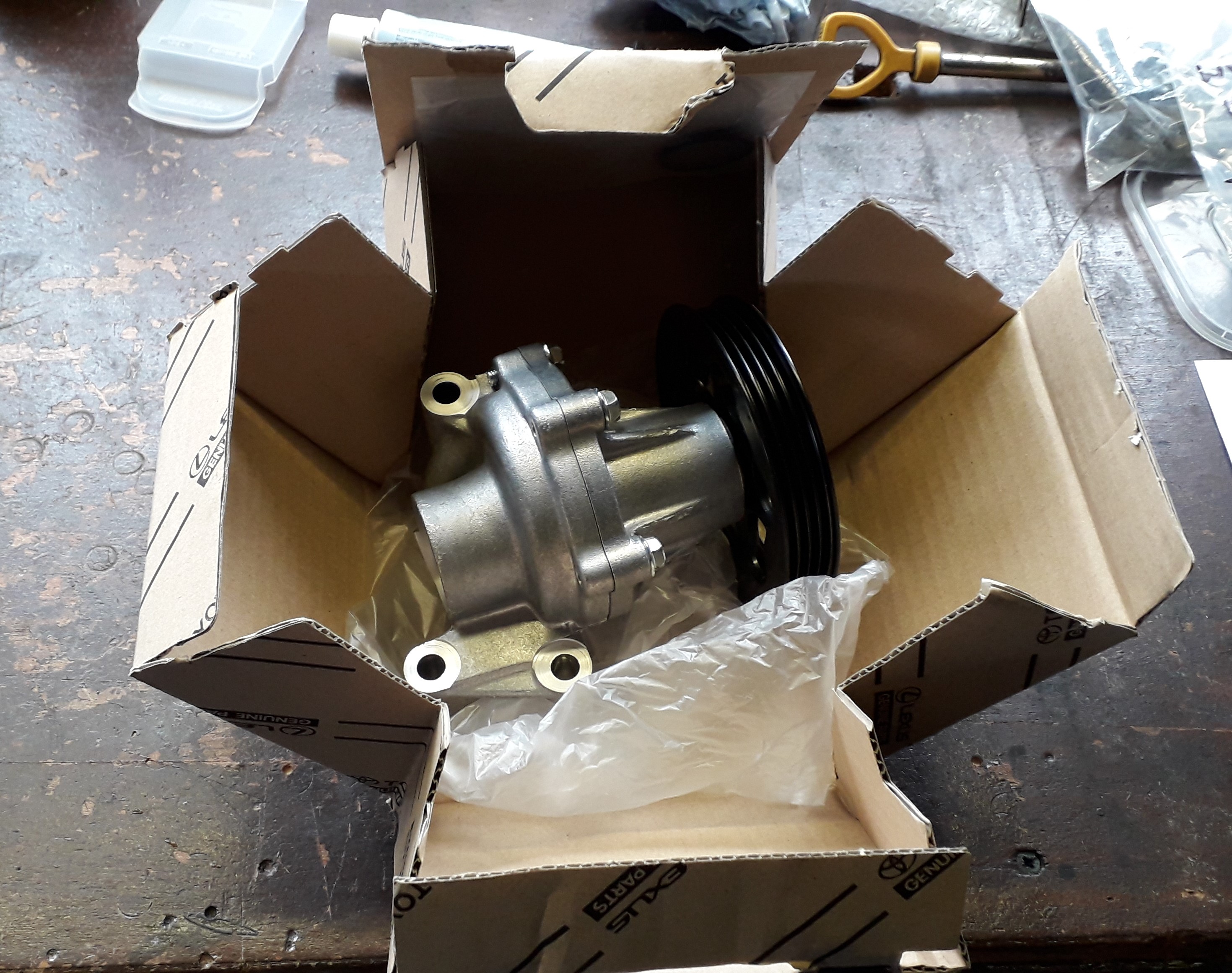

Claymore Posted March 13, 2021 Author Posted March 13, 2021 (edited) Water pump install. Bought a complete water pump and housing assembly from Toyota. No pattern parts bullshit this time! Part number is 16100-19226. Even the box is awesome! It consist of the pump, housing and the O-ring for the water pipe. Wrapped in a sheet of anti-corrosion paper, then in a plastic bag then boxed. Not many photos of this stage as it was time sensitive due to the sealant. I applied a bead of sealant (Elring Dirko) to the circular groove in the pump housing face and on the face next to the groove. Inserted the top securing bolt and slid the pump housing down the 2 x studs that Toyota cleverly installed in the block to guide the pump towards the block. Started screwing the top bolt in and the loosely attached the 2 x nuts to the studs. Pressed the housing to the block making the seal and tightened the fasteners evenly to a torque of 18Nm Gonna let the sealant cure and then rebuild the rest of it. Edited March 22, 2021 by Claymore Quote

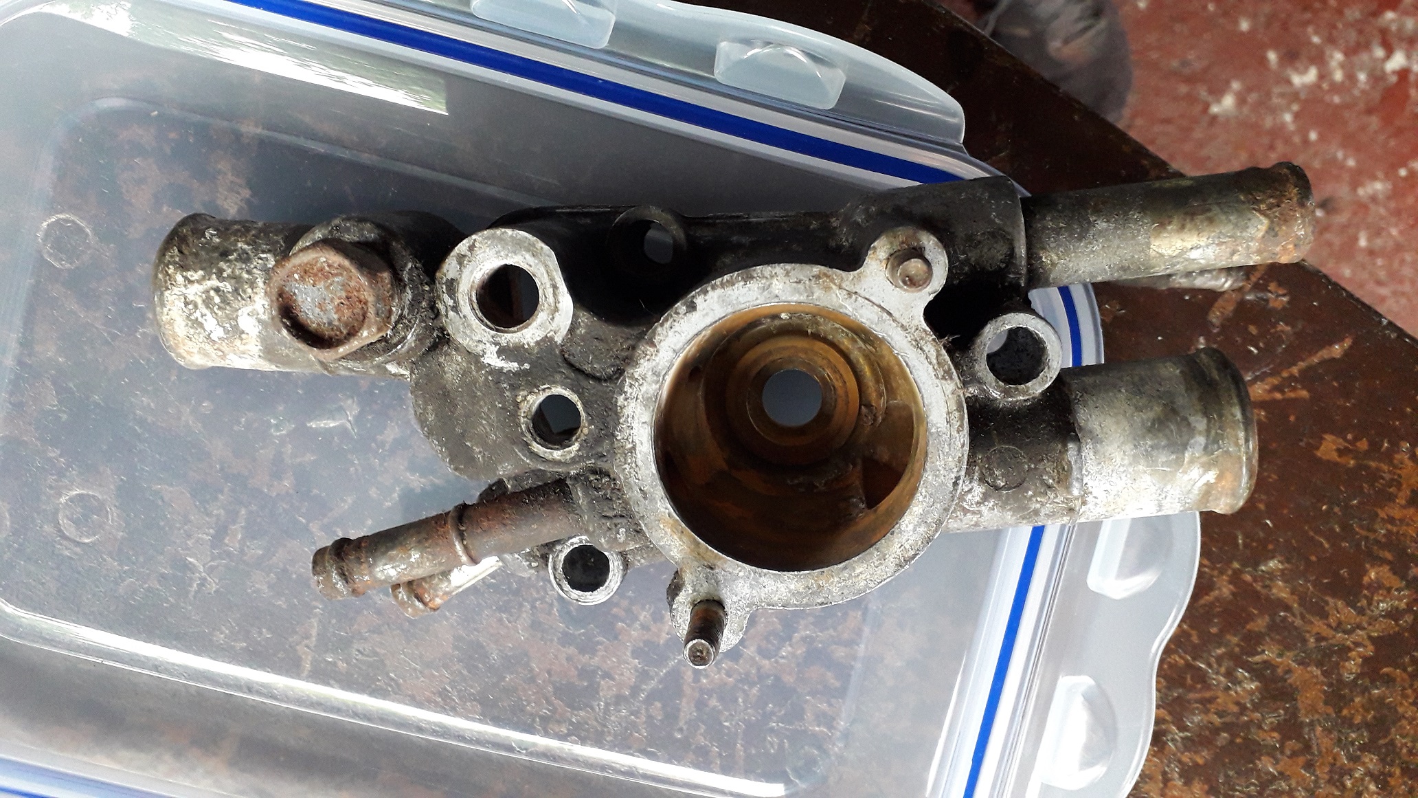

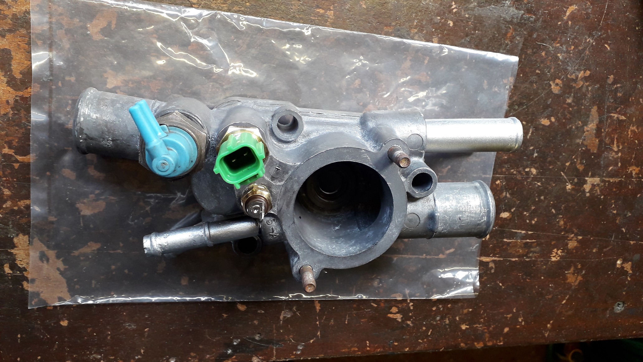

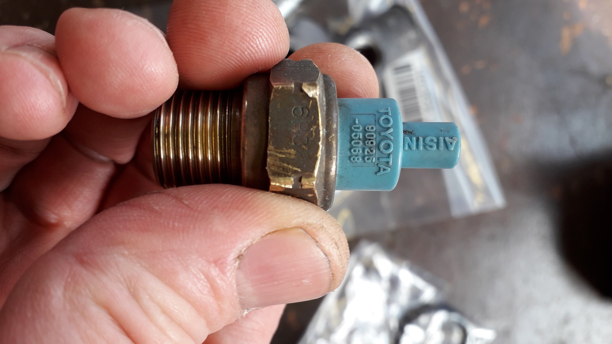

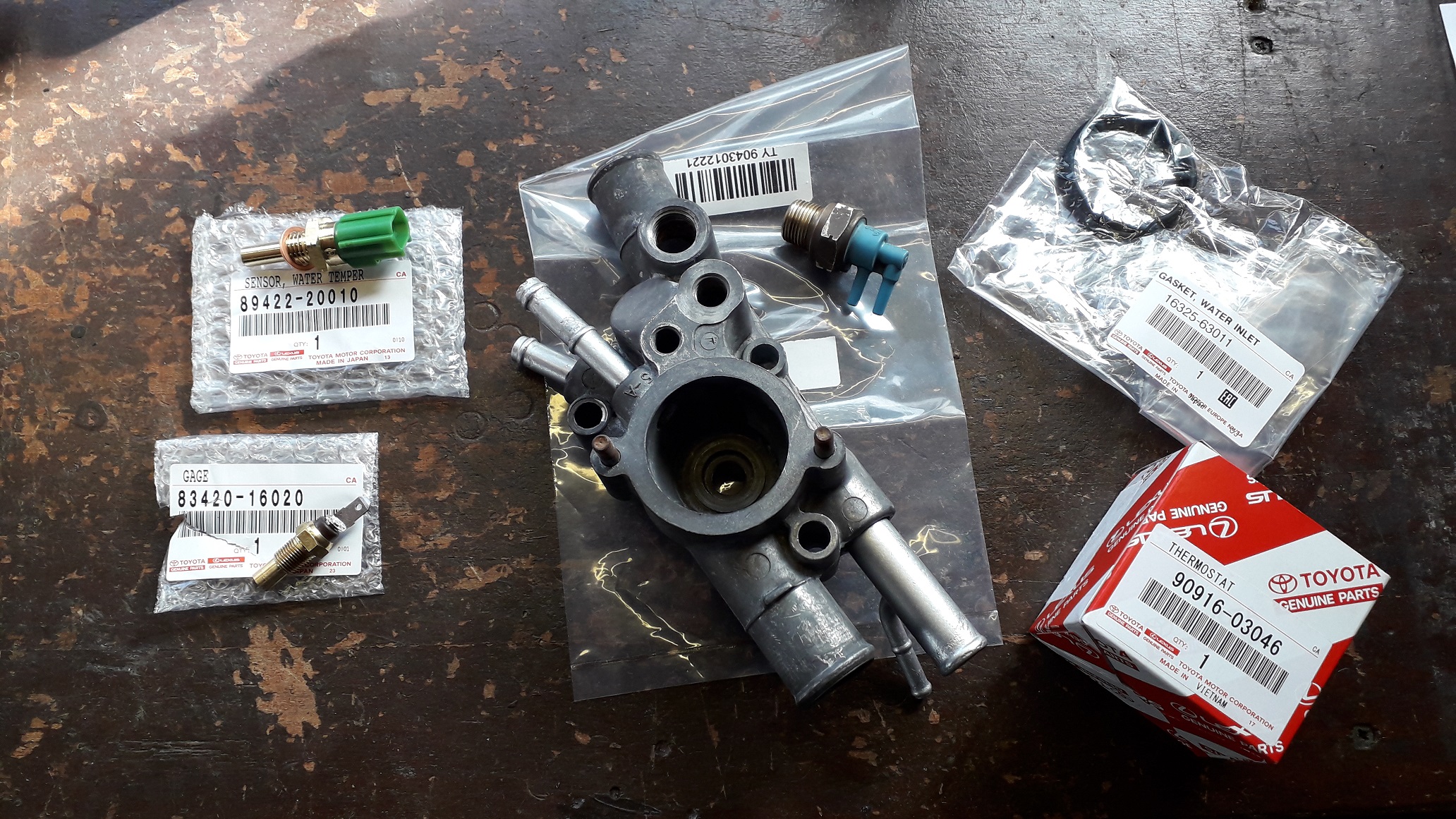

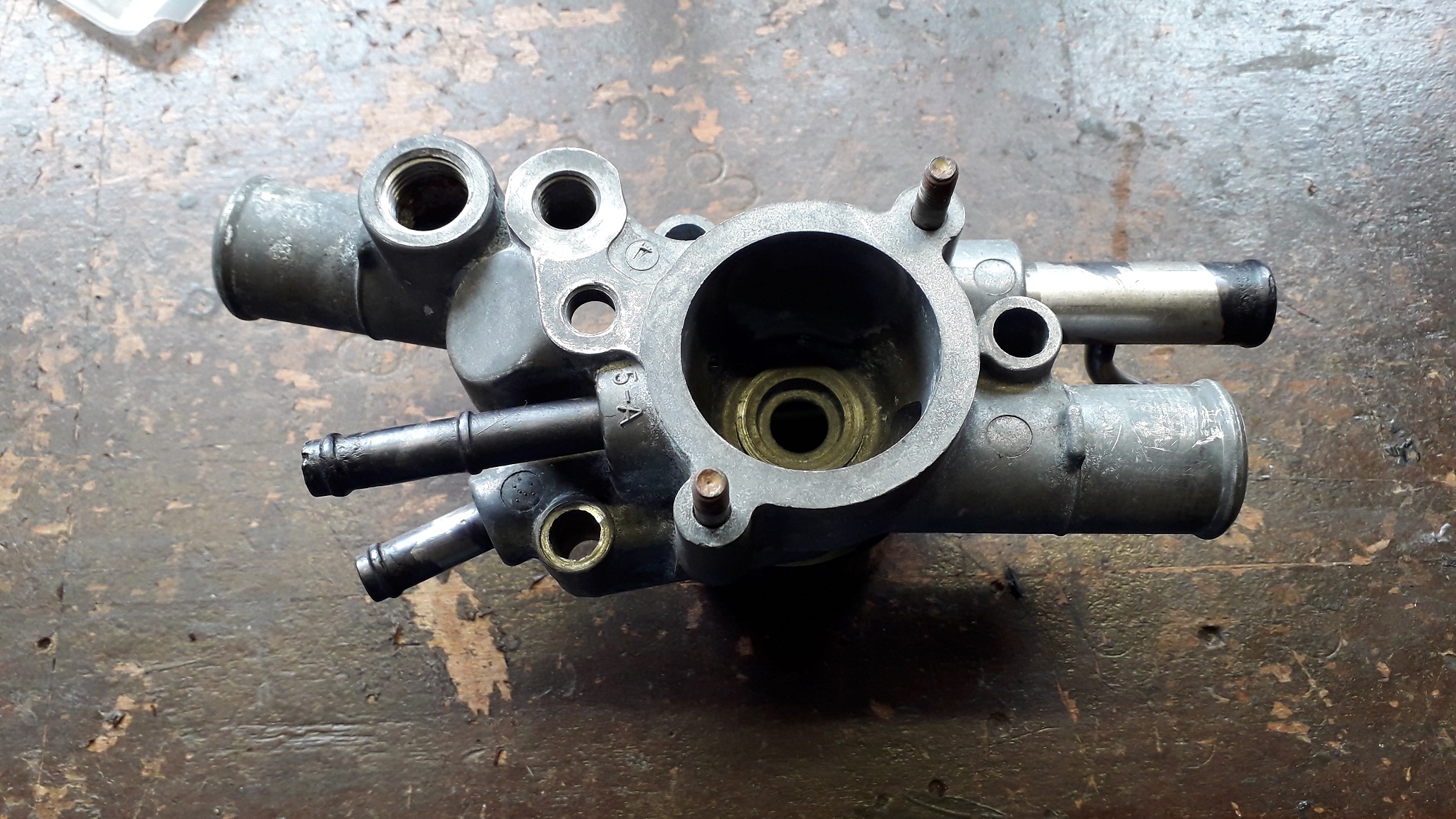

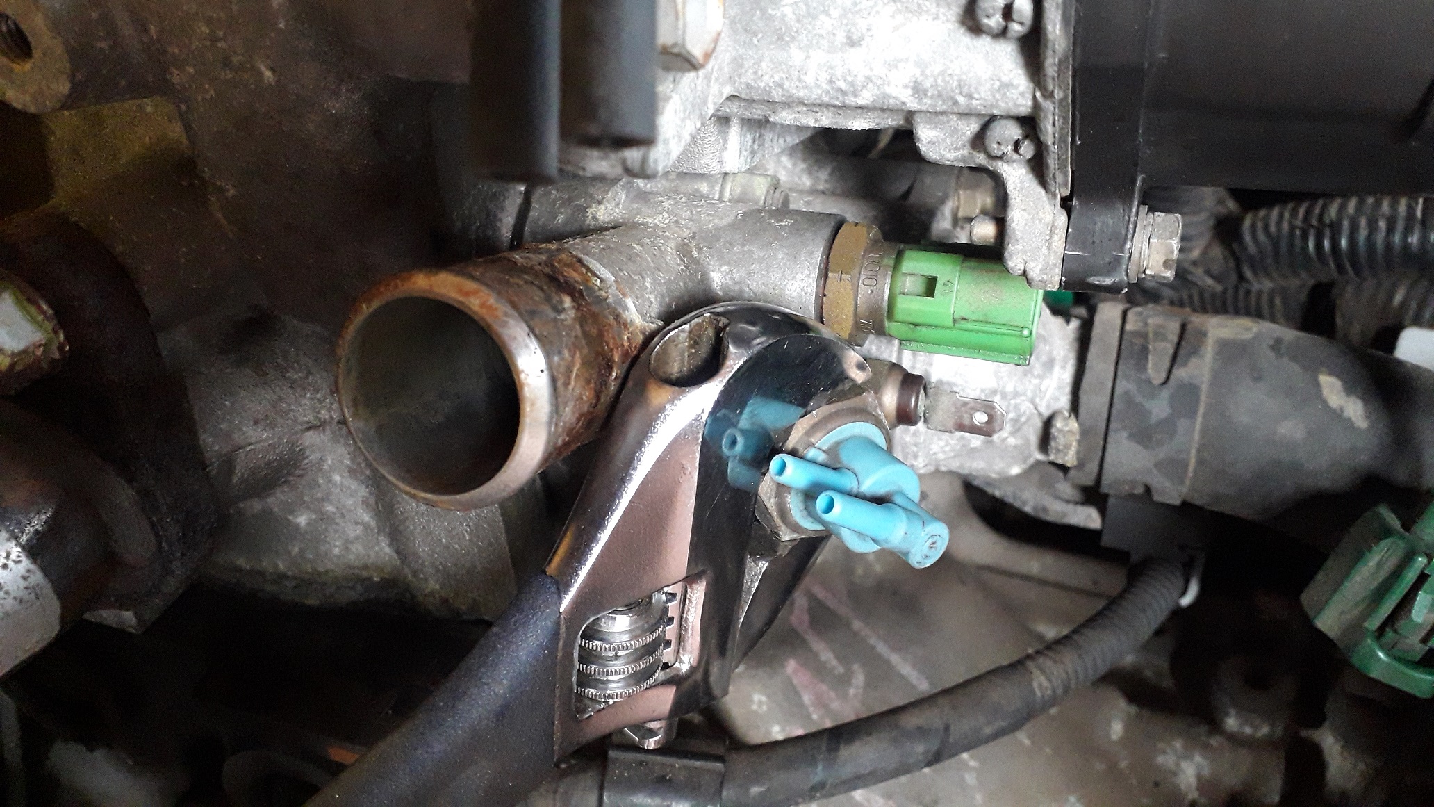

Claymore Posted March 14, 2021 Author Posted March 14, 2021 (edited) Cooling system mods continues.... With the water pump on it was time to work my way round to the water outlet / thermo housing. Managed to buy an early style 4efte water outlet from Sam44 seemingly months ago now. The early style has the 2 separate thermo sensors for the ECU and instrument gauge. This will provide the coolant feed for the turbo. After a clean up, and I also removed the blanking plug (tapered thread again), don't usually use the cordless impact on things but it was virtually impossible to hold the cast alu housing safely so after some tense moments with rattle gun it was out, housing unscathed. This port was now available for the fitting of the TVV valve (thermo operated valve) to retain the charcoal canister system for emissions control. New sensors and thermostat, genuine Toyota. Part numbers in pictures. The ECU thermo sensor has a copper washer to seal to the housing and the other 2 sensors are taper thread and I like to apply Loctite 577 for good measure. Sensors in, Started the install from left to right for clearance to each other and for spanner room. Ideally the TVV ports should be pointing at the 9'oclock position. https://www.youtube.com/watch?v=dC7z5eIff34 New seal on and thermostat installed, cap nuts tightened to 5Nm. The unit is ready to install. Edited March 10, 2022 by Claymore Quote
