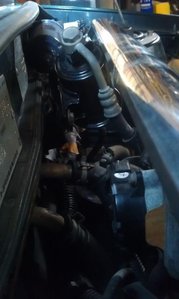

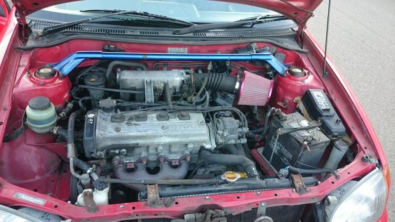

burty Posted August 26, 2020 Share Posted August 26, 2020 Been offered a glanza front strut brace at a decent price but heard they foul the fuel filter? Is it a major task getting them to fit? Has anyone got any pictures of how they overcame this problem or should I not bother all input welcome Quote Link to post Share on other sites
akyakapotter Posted August 27, 2020 Share Posted August 27, 2020 I just forced it down a tad when I had my na sure I only used one bolt aswell. crude way but it worked for me. Quote Link to post Share on other sites
burty Posted August 27, 2020 Author Share Posted August 27, 2020 Thanks for input just didn't want to damage anything, 38 minutes ago, akyakapotter said: I just forced it down a tad when I had my na sure I only used one bolt aswell. crude way but it worked for me. I'd image all aftermarket strut braces for the glanza would foul I then? Quote Link to post Share on other sites
Claymore Posted August 27, 2020 Share Posted August 27, 2020 According to a build thread on the aussie site the Whiteline one fits and clears the fuel filter just, but it won't fit with the standard airbox. Quote Link to post Share on other sites
burty Posted August 27, 2020 Author Share Posted August 27, 2020 5 hours ago, Claymore said: According to a build thread on the aussie site the Whiteline one fits and clears the fuel filter just, but it won't fit with the standard airbox. Thanks for that info much appreciated Quote Link to post Share on other sites
4EFEJay Posted October 12, 2020 Share Posted October 12, 2020 You can get it in, I've got one on mine, you just have to bend the bracket a little bit, I put some rubber around the brace so it didn't wear the filter. Been on for 3 hard years on track and never been a problem. Quote Link to post Share on other sites
