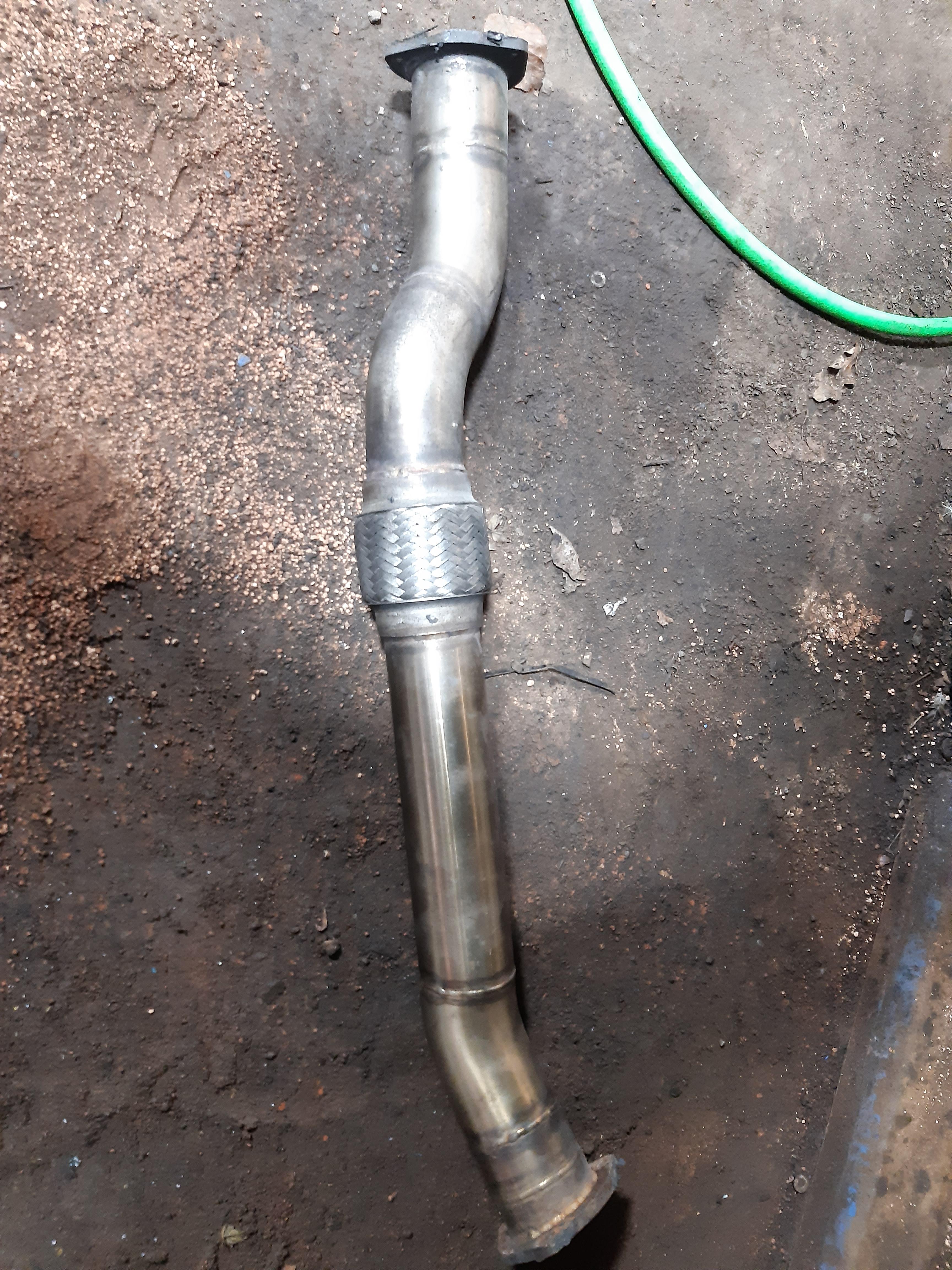

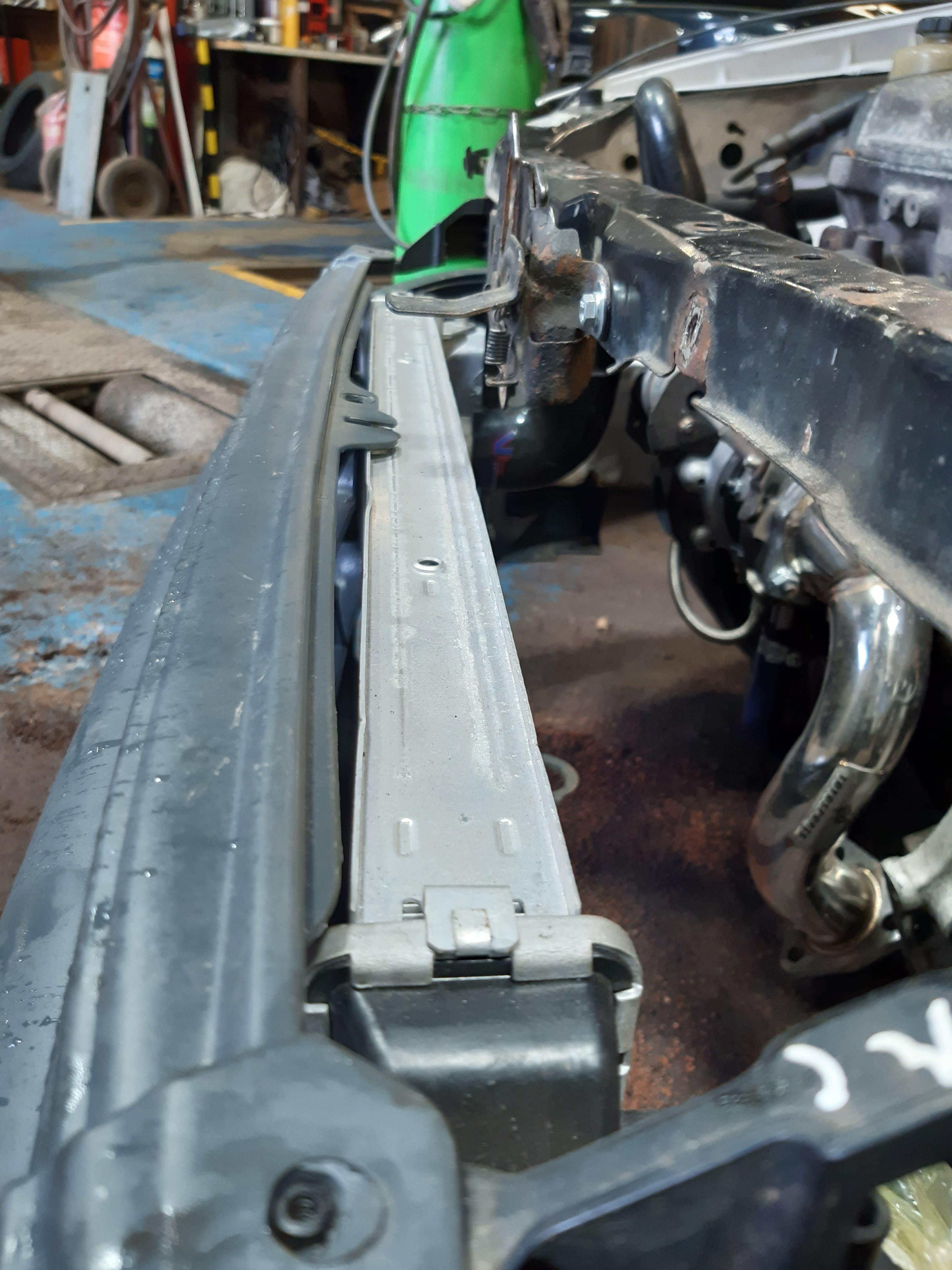

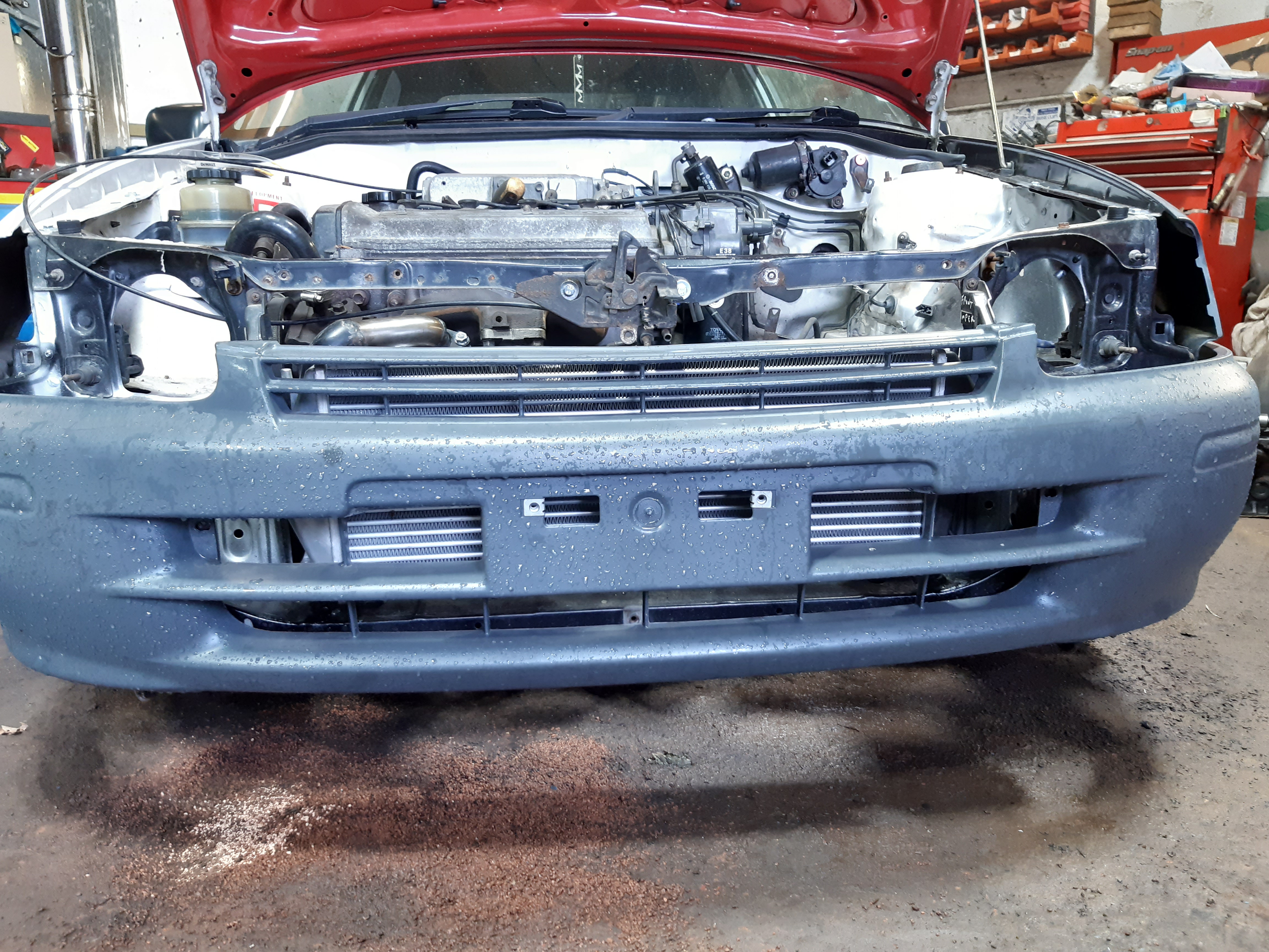

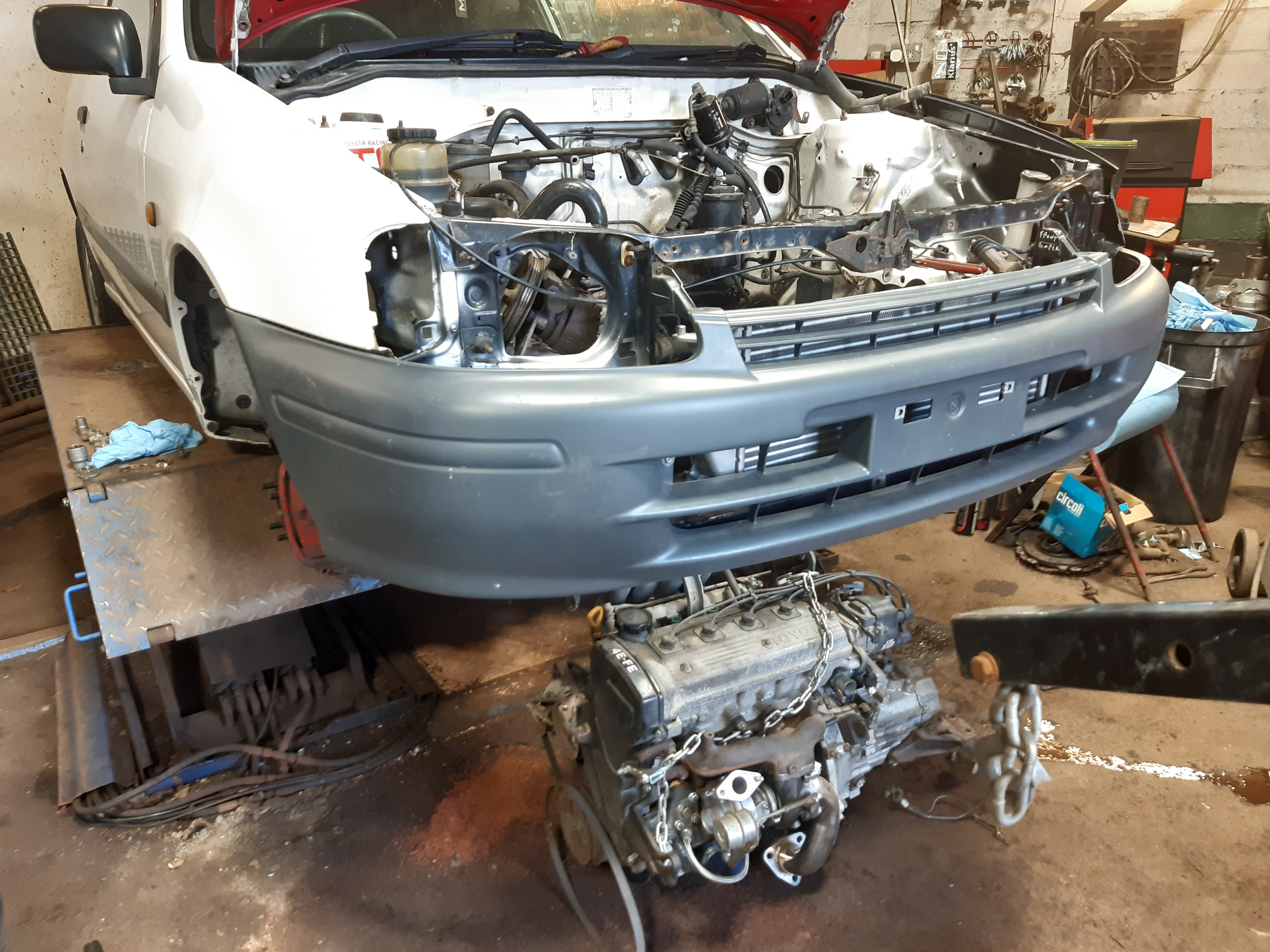

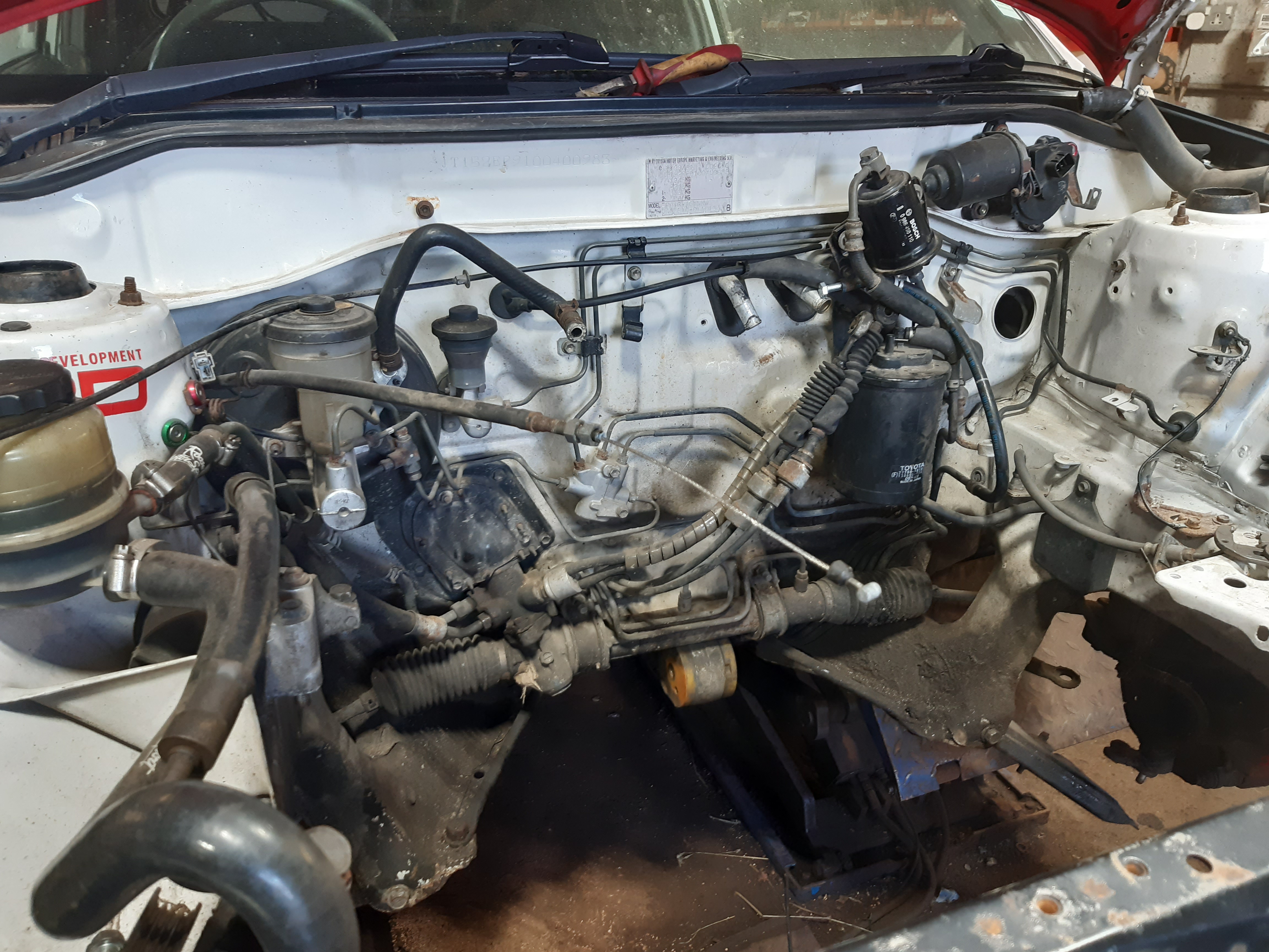

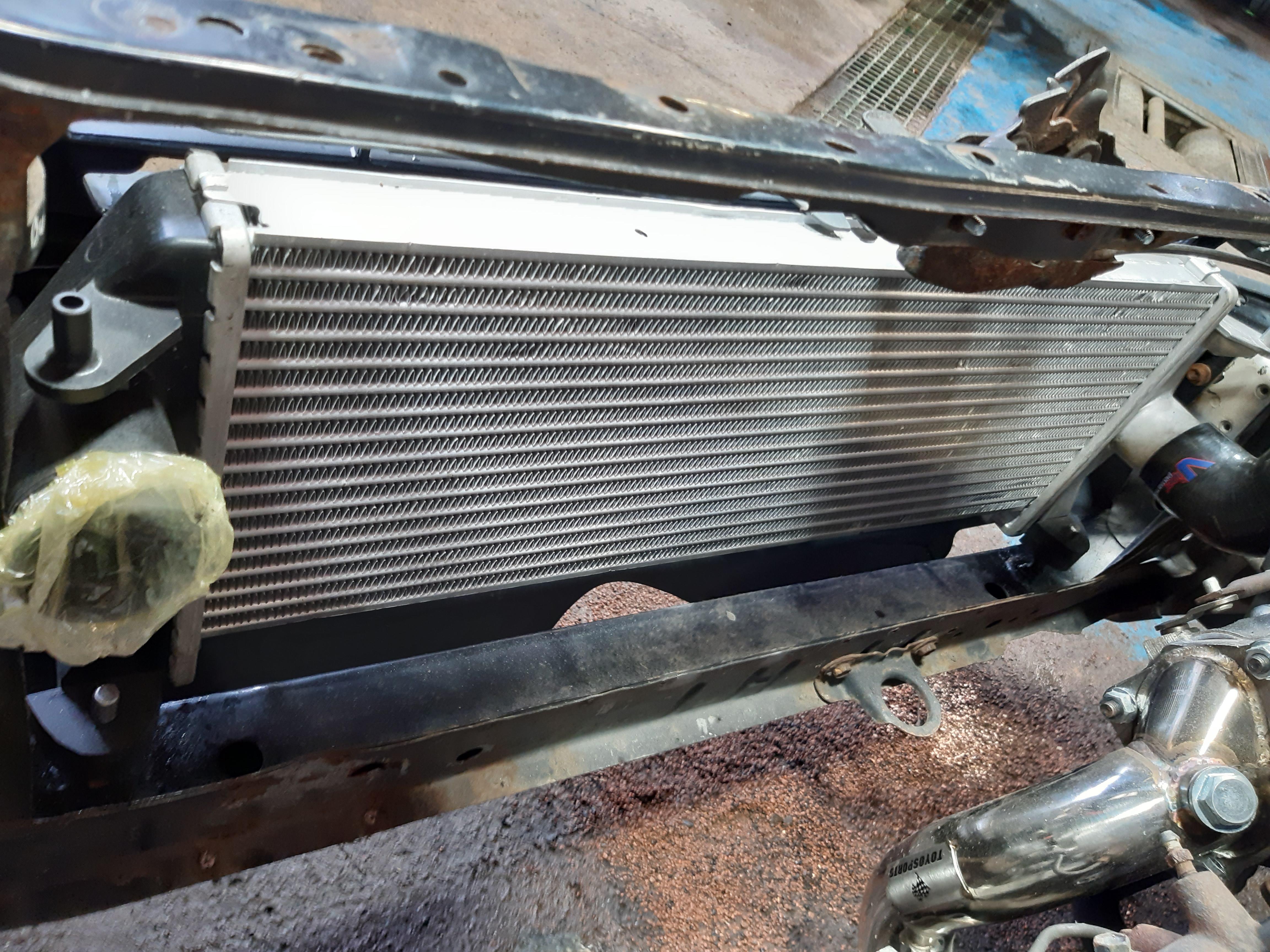

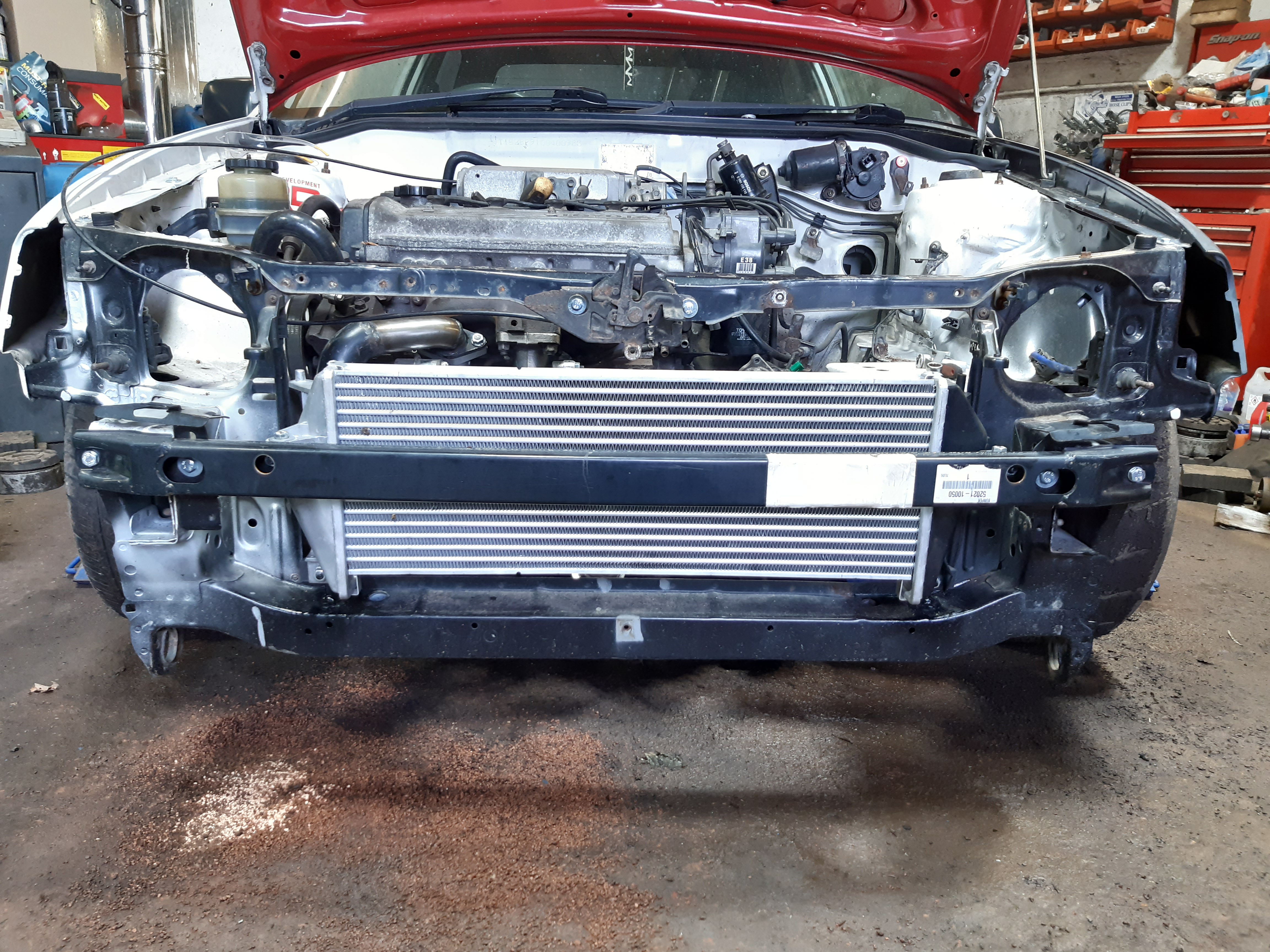

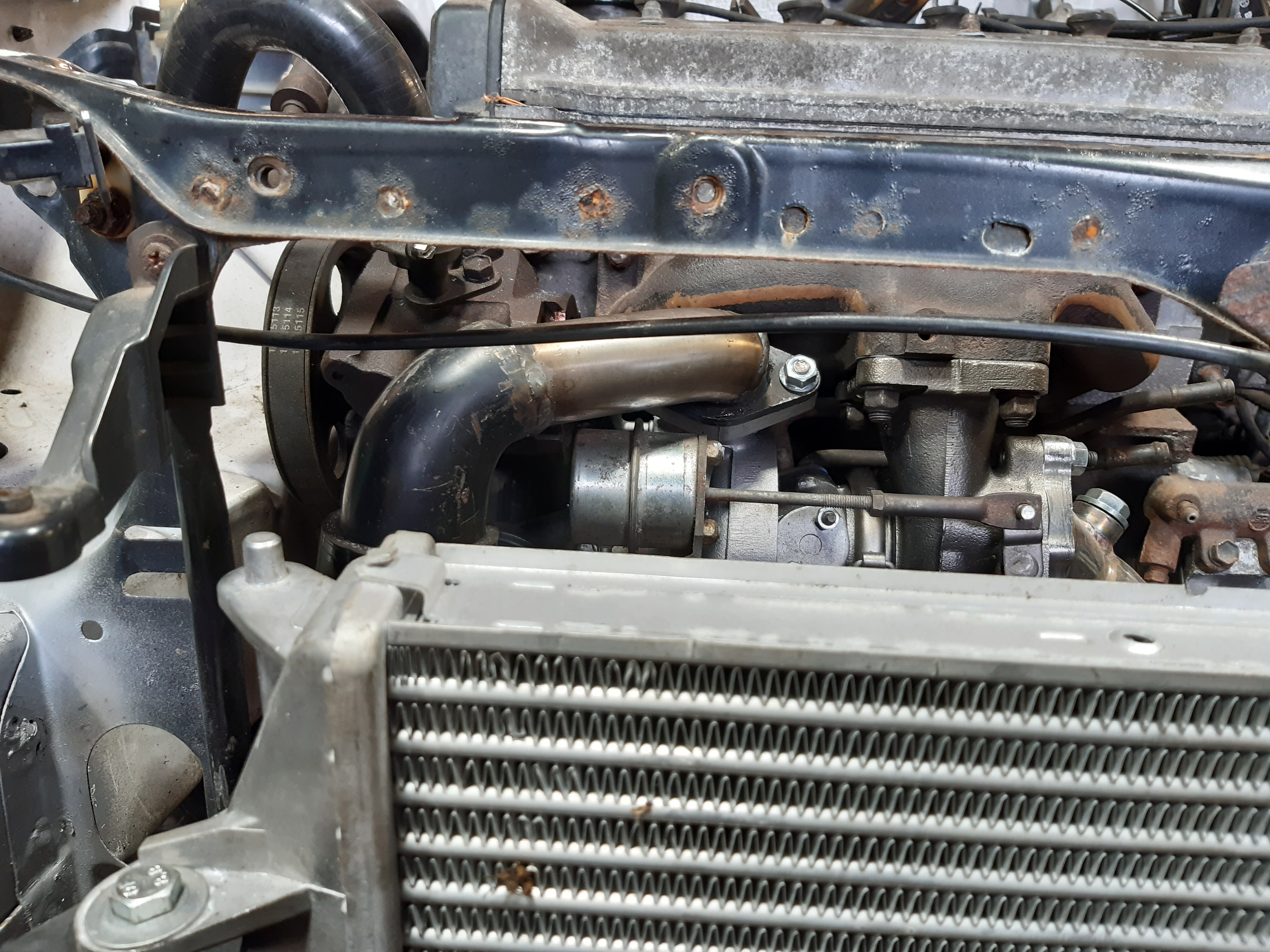

Fitted a new custom stealth front mount intercooler and made up a nice and short route cooler pipe. Used a landrover intercooler due to size and weight . The radiator is the usual half civic alloy rad but will move the lower pipe. Also keeps from cutting any bumpers etc. Also just bought a full 2.5" race-tech exhaust and full turbo engine to swap in.

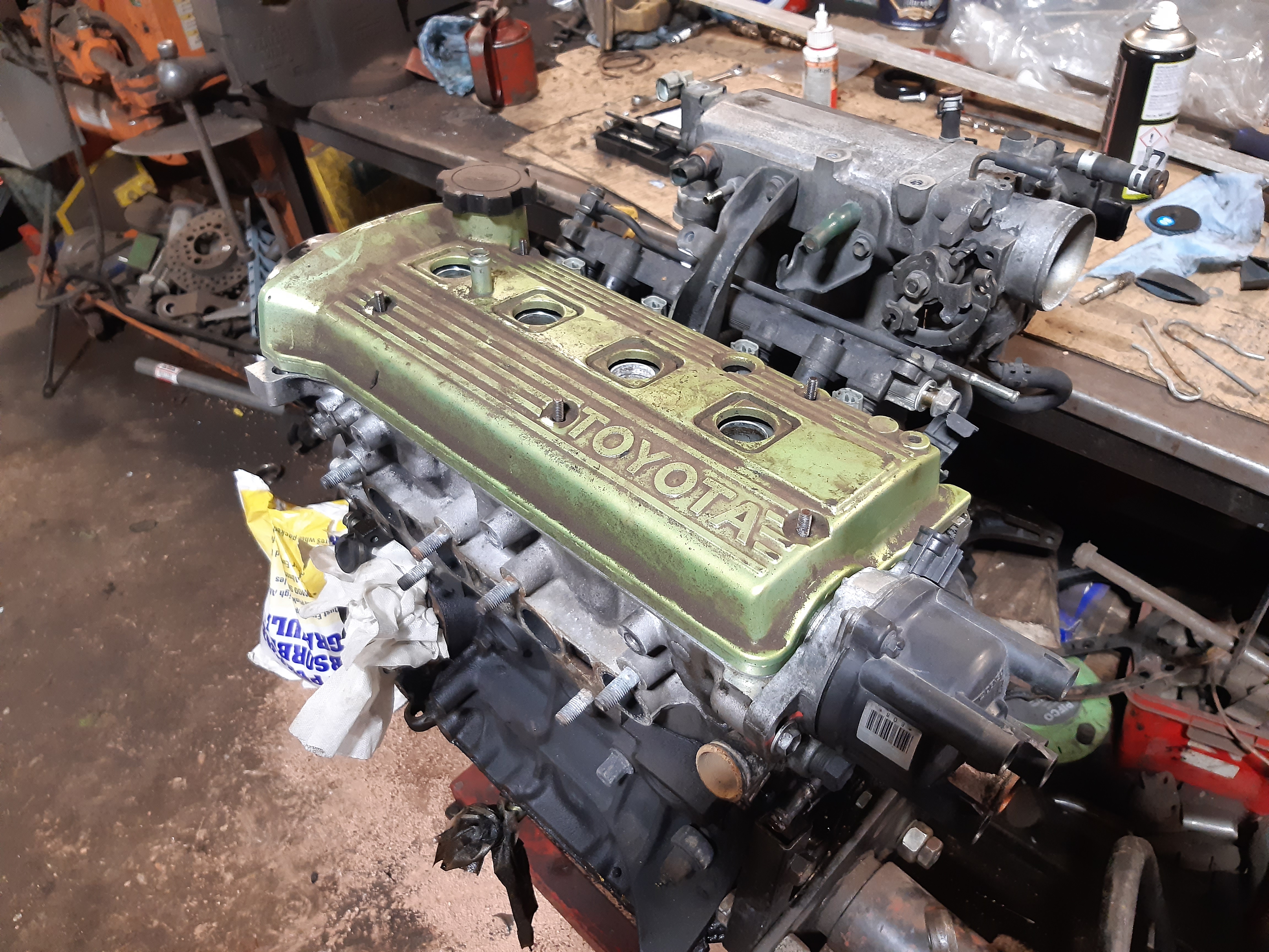

Really enjoying this.
Are you fitting the 4efte engine.
Cheers
Aye got a complete 4efte engine with inlet to fit 💪
