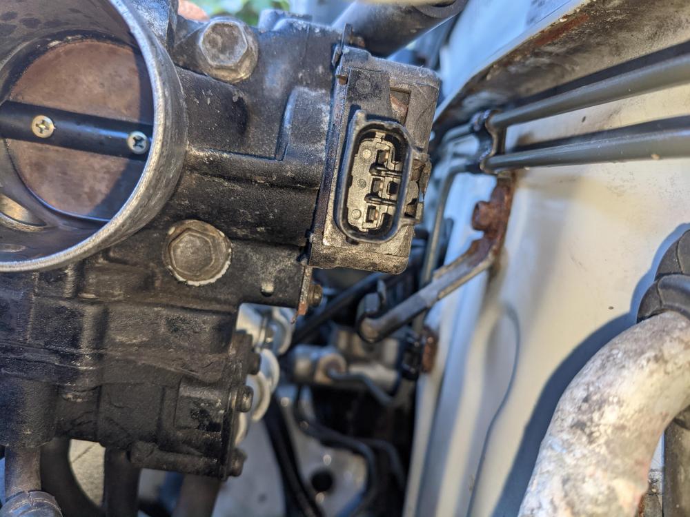

Hi guys, got a question some of you I'm sure will know the answer to. I have bought a Throttle position sensor and the plug on the loom doesn't fit.
I'm guessing this is the correct plug but it's a different shape? My glanza is a 97, but I can't be sure this is the same loom from new, any info on it?

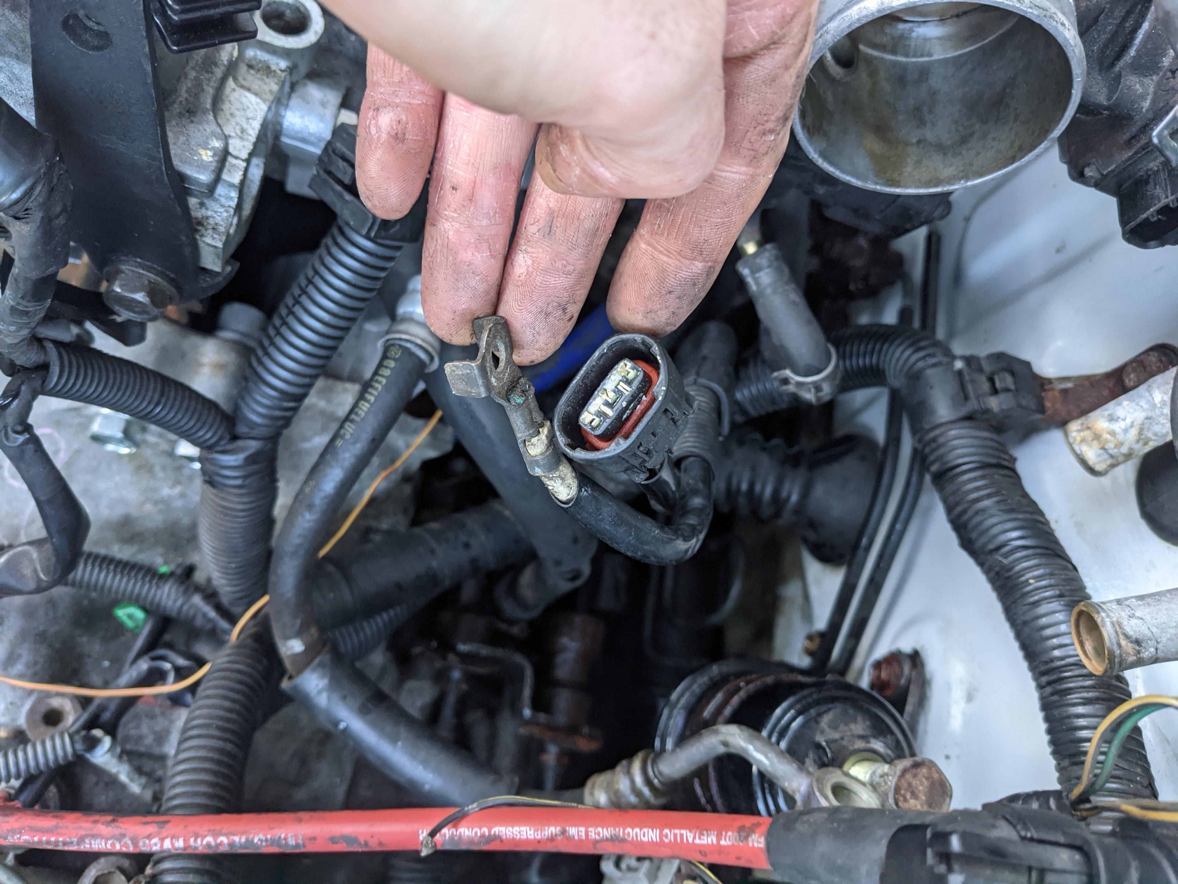

*Edit: that looks like it could be the alternator plug with the wire that bolts to the alternator? Maybe?

Ah yes! You might be right there! I will check it to the alternator connector and see if it fits, very good shout that!
Yeah that looks like the alternator plug and power cable . It’s will be around there have you anymore plugs ? It could well have been cut off ?
