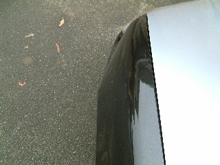

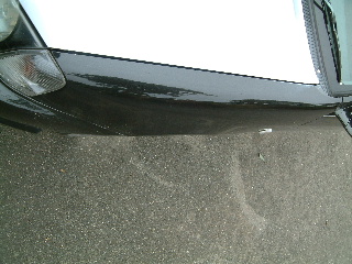

peanuts Posted April 3, 2006 Posted April 3, 2006 hey guys i ve got 215/35/18 on mine with 1 42mm offset , thou i had to pump the front gaurds and pull the inner plastic gaurd out and roll it, and on the back i am using a gt axle and brake set up because the axle is shorter in width so i havent rolled my rears and still have 4mm between the gaurd and tyre! maybe try that if you can get a gt axle.might ad that mine gaurds are down to the chrome on the back and the fronts cover half the tyre at the top.oh and if you ask about the bolt part that holds te bumpers on the back has to be bent up and be mounted a little further back and the fronts it was easyer to pump the gaurd than to modify becasue you can still use the original mounts and it looks heaps meaner from the front!hope that helpsmaybe you guys would like some pics?cheers brett

peanuts Posted June 10, 2006 Posted June 10, 2006 heres a pic of the gaurds, unless you put another one next to it or a pic you cant really tell.
