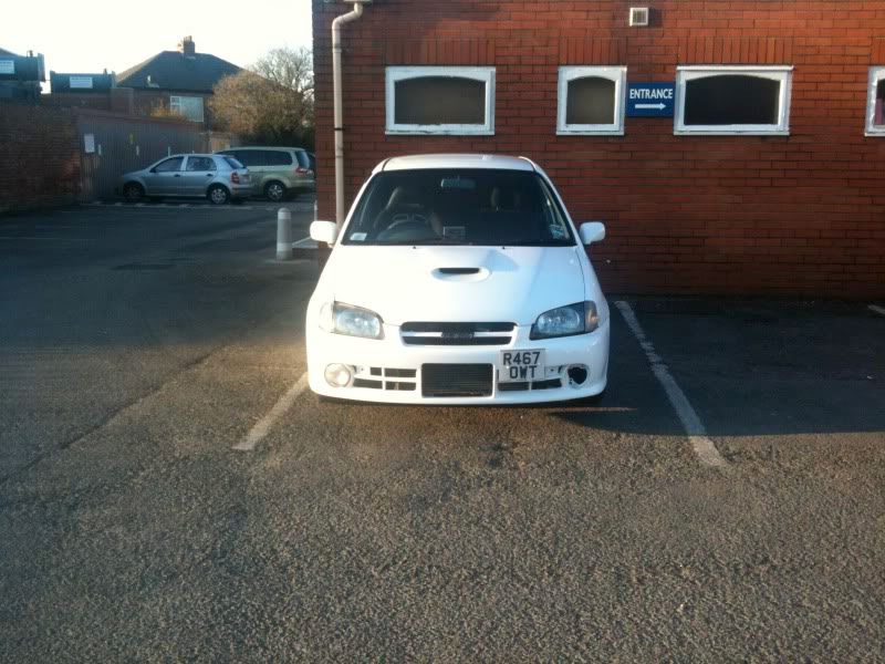

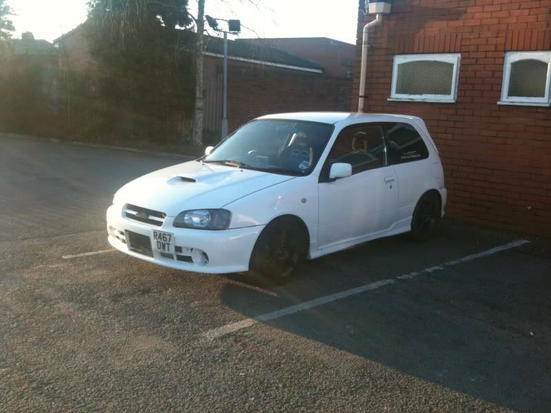

D-Day!
pictures where took at a mates house an hour after jumping in the old girl!

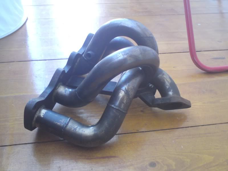

i bought a WEPR S/S manifold off madman! Thank you very much again!

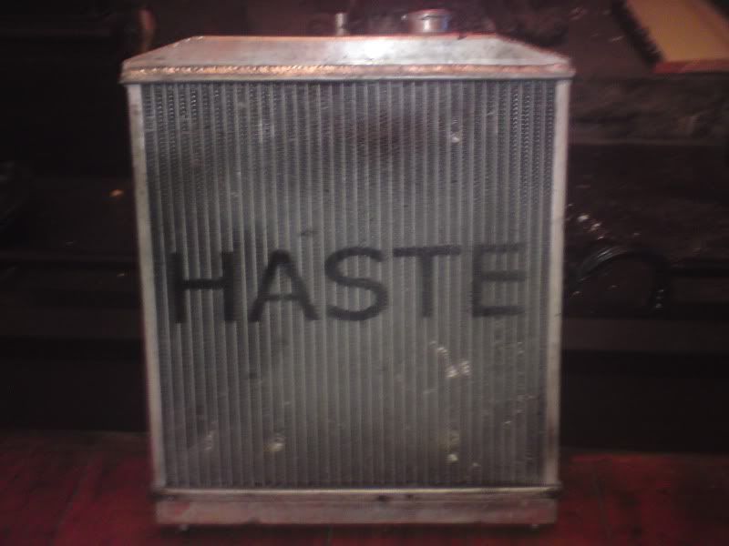

Went upto Nicks today at Tuning developments to pickup my Haste aluminium 3 core rad!
great piece of kit, can't wait to get it fitted next week!

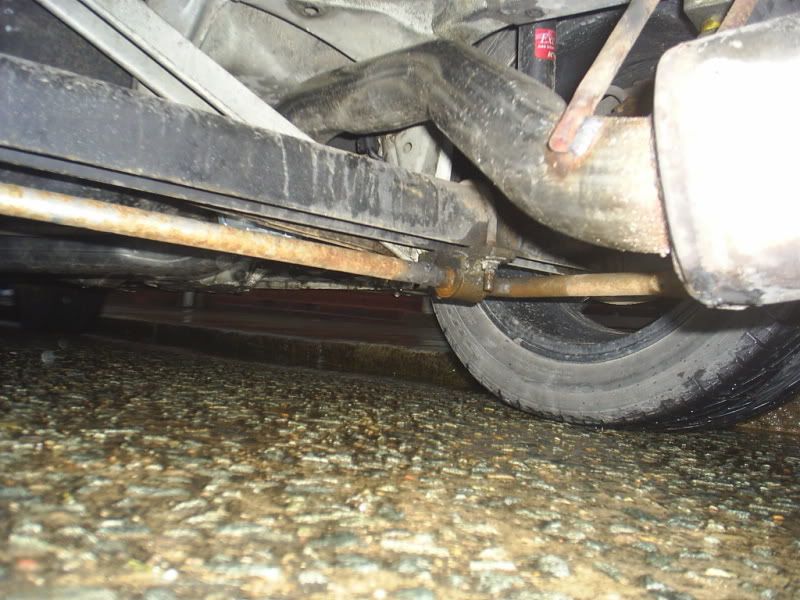

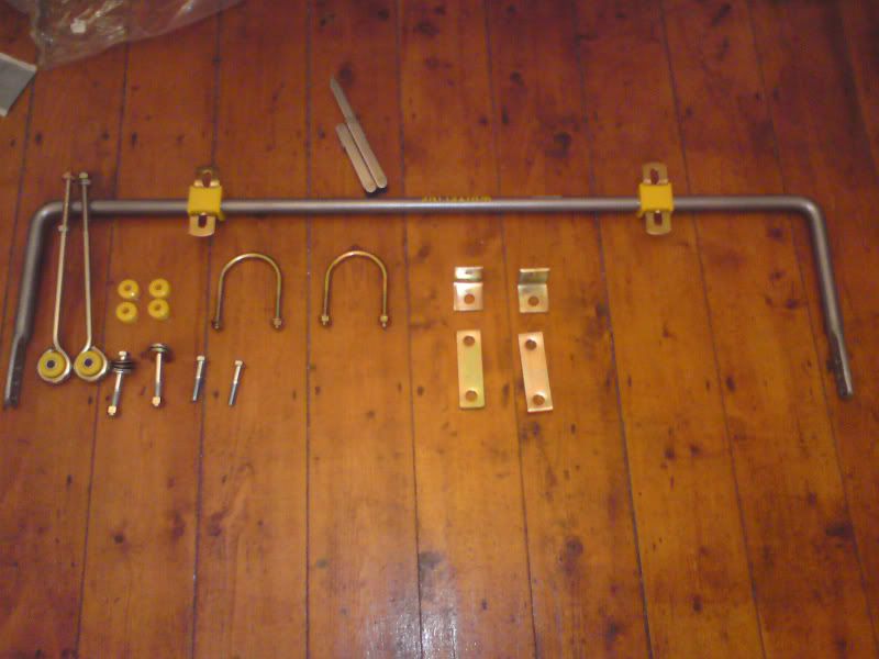

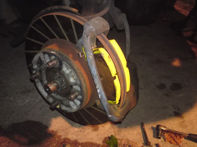

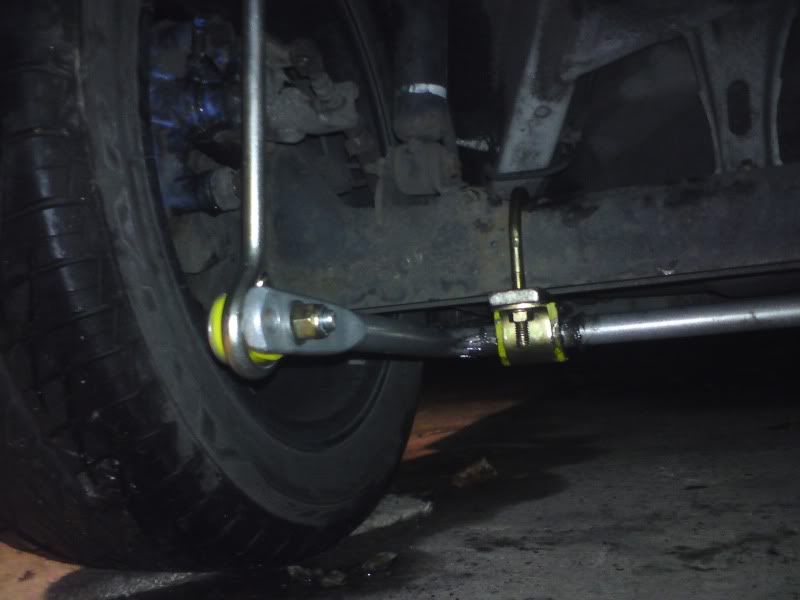

picked up some yellow stuff pads and a adjustabe rear anti roll bar! really chuffed with it! those will be fitted tomoz with some nice new fluid!
;):beer:
brakes are very good! and I've not even run them in yet, really sharp, and progressive!
the rear is alot more firm, it also follows the front of the car evenly, the car doesn't feel all over the place at all when taking corners at speed.
i highly recommend anyone who hasn't got one, to buy one! you will not be dissapointed!

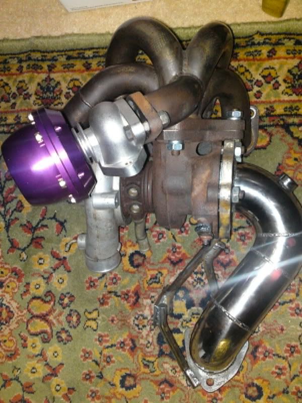

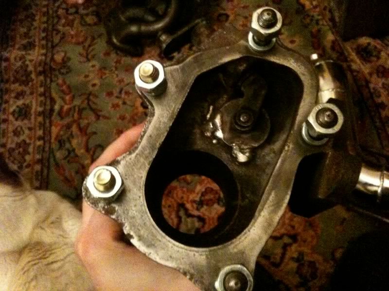

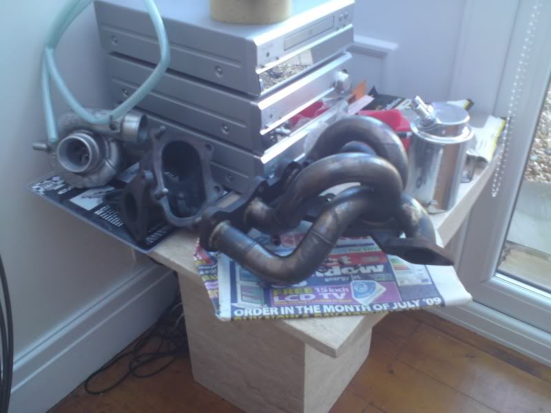

ecieved my WEPR downpipe last week during the early hours of my morning hung over! 7.30am and it was the fastest I've woken up and run downstairs ever! Ha!
really happy with the result! waited a while but it was well worth it!
anyone that is thinking about ordering parts from WEPR should not think twice!
the enginering is fantastic!
i now i have all my TD04 kit, my gaskets will be arriving tomoz and will have more updates soon and it will be getting fitted next tuesday!!

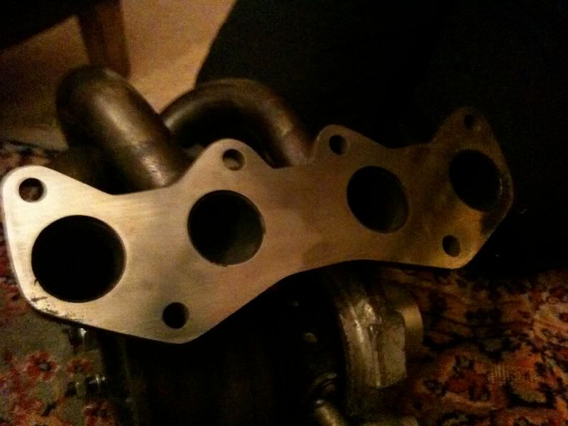

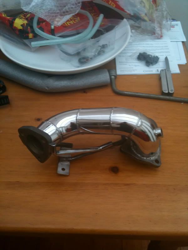

got my gaskets through the post this morning! i have two sets on order one from sacha and one from turbo dynamics so one set will be for sale sooon!
anyway took my downpipe to a best mate and got it all mocked up and ready for fitting on tuesday!
Can't wait!!
whilst waiting for my gaskets i had another good freind reface the manifold and exhaust housing.
apparantly the manifold face was miles out so that now is perfectly flat!:lol:
Thanks for looking!:drive:

One question when fitting the RARB in the pic its jacked up but was there something under the wheels? As im sure the wheels needed to be on the ground or have the load on them when fitting the RARB.

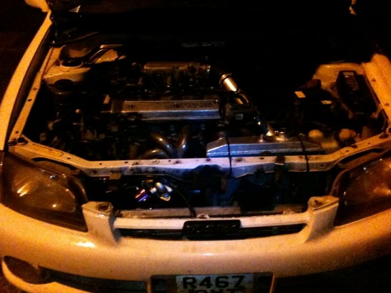

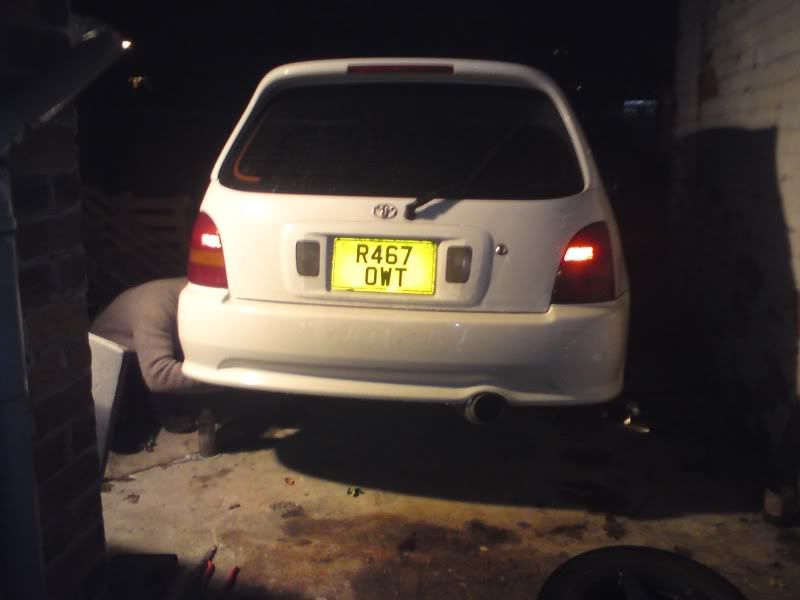

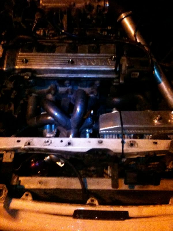

well today was the day! finally got the TD04 fully fitted!! and i love it!!
everything went really well! we had one or two things that came up that could be a problem but we got that sorted!

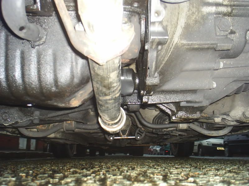

the only problem we looked at is the exhaust has been butcherd, so where the the downpipe bolts to the exhaust is rubbing on the flexy pipe on the driveshaft all the time! so that is a problem that needs to be fixed soon! the whole system isn't that brilliant. so thats something i will be looking for very soon!
at first start up everythin was fine! no leaks at all anywhere! the exhaust was really different! its so raspy and loud than before its unreal!
it gave abit of white smoke out at first but since i went down the road in cleared up and not seen anything out of the back which is good!
just have to see if it smokes in the morning but im fairly confident!
running 0.65 bar at the min till i get the emanage blue fitted and mapped by tuning developments in jan.
anyone who is thinking of going TD04 don't hesitate! its flamin awesome!!

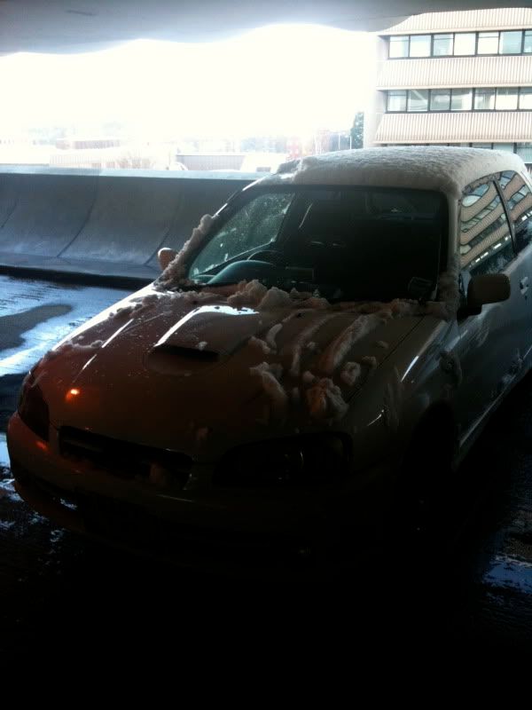

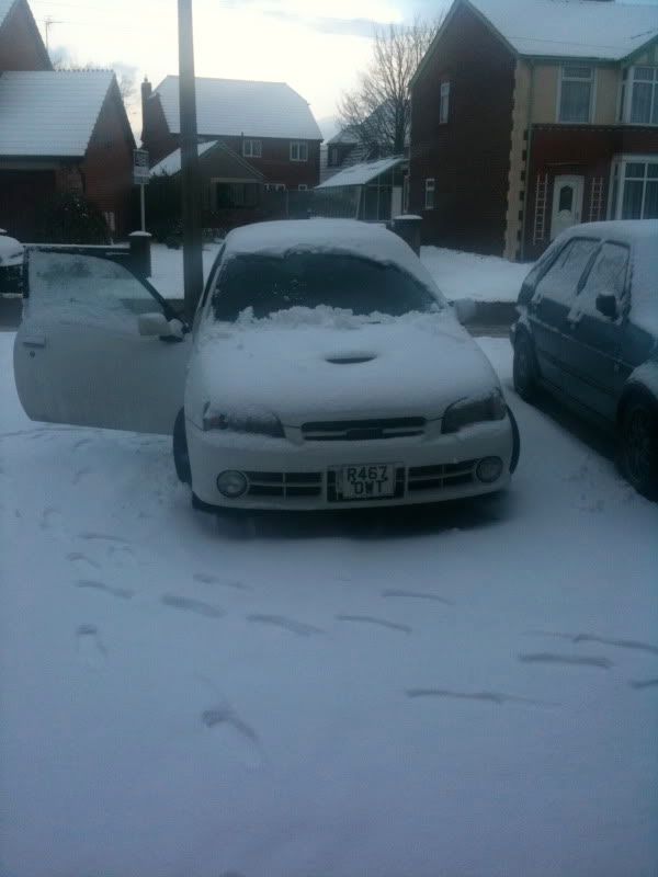

was really different when we had abit of snow, the car was quite abit of fun at times!
only got a a couple of pictures nothing exciting.

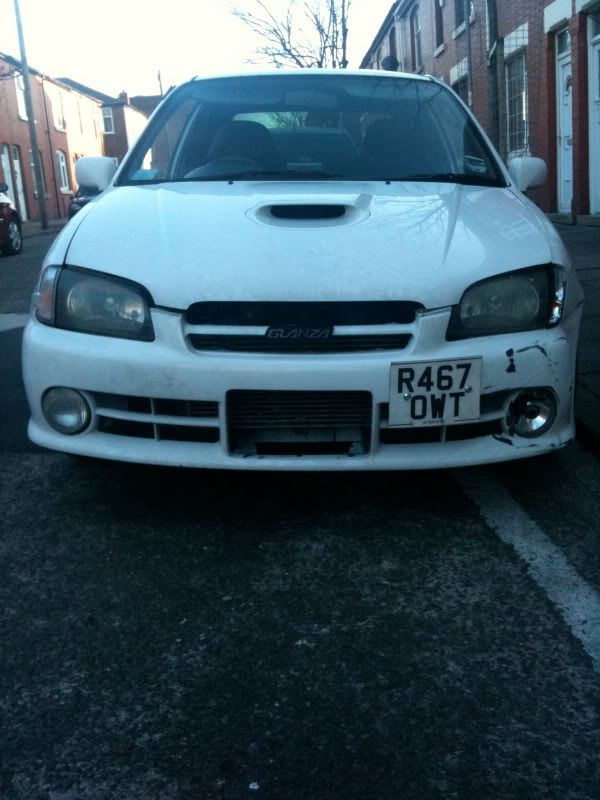

next things to do on the list is move the front mount down and sit it flush with the front bumper.
well i finally got the car back after nearly two weeks without it.
it would have been a week but my washer bottle was smashed on the damaged side of the car so had to get a new one which took flamin ages!
anyway car looks good, only problem is i need a new bonnet really.
fella at the body shop said he tried his best to straighten it out but couldn't get it perfect as my hinges where badly bent.
but at least the car looks alot better now.

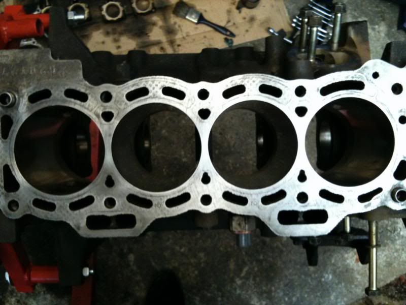

so we picked that up from his and started stripping it!
everything looked fine, headgasket had a slight burn on the inletside of cyinder 4, but nothing major. big ends and main bearings where fine, but could tell the engine had done some miles, plus the brass was starting to show on the edges of some of the bearings.
anyway got on a stand and cleaned down!
spent a couple more hours tonight in the garage to clean a few more things up and degrease a few things.
I recieved my ACL bearings from Iain on tuesday! Thank you very much for those Iain,
the crank looked in good working order with a few light marks but with the milage i wanted to do it right, so the crank has been sent off to bambers round the corner from me, with the 0.25 ACL bearings for a grind and will be ready tomorrow night, after that i will be placing an order for my 3 puck exedy paddle clutch and sending my bottom end to get balanced!
This is going to be stock build for the moment to see how it goes,the plan is to run emanage Blue on TD04 running a bar boost.

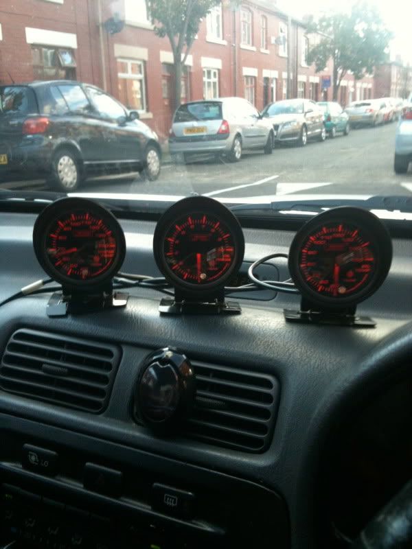

and finally picked these prosport gauges up off ashygt,
spot on couldn't have asked for anything better, really nice touch to the interior, i only have water temp working for the minuite as I've yet to modify the powersteering bracket to get my sandwich plate to fit but il get onto that very soon!

Suspension:
HNR springs
KYB shocks
Whiteline Adjustable rear antiroll bar
(on hardest setting)
