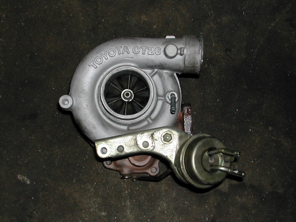

keirz Posted June 11, 2009 Posted June 11, 2009 well after a fair bit of research ive finally come up with what i feel will be an awsome hybrid. this is the second hybrid ive built, the last one made decent power but i fancied a change and with my added experience and knoweledge i felt i could create something that would be completely different from the rest.ive made this myself for myself on my break times at work, its ended up being a little bigger than i first planned but its all came together nicely. its took a rediculous amount of work and i came up with some unforseen problems, but in the end i got there just as planned.heres the pics,first off heres a comparison of a ct9 compressor wheel and my new hybrid compressor wheel. note the bigger bearing housing too.heres the new bigger compressor cover, ive also internally polished it up so it will spin up nicely!the comp endshaft end, note the wastegate is welded up as im gonna run it externally gated. lots of weld to make sure it dont leak!look at the size of the outlet compared to normal ct9and here next to ct9next to Td04ive also custm made some water lines which reverse the blanking plate so the lines are at the front for ease of access and also for better looksive gotta wait for my externally gated mani to come and then im gonna put it on and see what happens. as its completely unknown what kinda power its gonna create im gonna run it at 0.8bar to start with and see how it goes. as its not forged and i feel this turbo just may be pushing it a little too much. time will tell.im not looking for massive power with this turbo, although i feel it will create it. im looking for a very responsive spool up and put out around 220bhp at less than 1 bar.thanks for looking!keiran Quote
4efte_ryan Posted June 11, 2009 Posted June 11, 2009 that hybrid looks awesome mate , keep us updated on how you find it fitted etc would really like to noryan Quote
DavidAshton Posted June 11, 2009 Posted June 11, 2009 That does look pretty brutal, look forward to seeing how it performs. Quote
Idrees Posted June 11, 2009 Posted June 11, 2009 Looks awesome, looking forward to some results! Quote
Sparky Posted June 12, 2009 Posted June 12, 2009 Looks immense mate!!What comp housing is that off?Hope it does you proud Quote
Nanglebadger Posted June 13, 2009 Posted June 13, 2009 dude, thats some seriously impressive DIY skills there!!!i doff my cap to u Mr K!!! great work man, hope it performs for u as u hope it will!!Phil. Quote
keirz Posted June 14, 2009 Author Posted June 14, 2009 thanks mate, im sure it should work fine. if not i have my old one to fall back on as im gonna keep it as a spare.when i get back to my house i can post up some specs like inlet, outlet, compwheel size ect, to give an idea how it compares to a ct9 Quote
