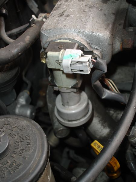

Patches Posted January 17, 2022 Posted January 17, 2022 On 1/15/2022 at 11:54 AM, Frankieflowers said: Hi guys. My engine starts ticking not on idle but when I start driving it and I press the throttle. It does it for a few hundred meters (around a minute) and then it stops doing it. If I give more gas the engine is not running properly. As soon as the ticking fades everything turns to normal. It does it when I fire it in the morning and it’s still does it when the engine is warm. At first I thought it was the oil missing on top of the engine for the valves hydraulic but I am not sure and I would like someone to help me find out. Thanks. This can sometimes be the idle control valve. Assuming you have a 4e-fte, unplug it while the engine is running and see if the ticking stops. Quote
Frankieflowers Posted January 17, 2022 Posted January 17, 2022 1 hour ago, Patches said: This can sometimes be the idle control valve. Assuming you have a 4e-fte, unplug it while the engine is running and see if the ticking stops. I will try to unplug the black hose and see if something changes. Thanks. Quote
Patches Posted January 17, 2022 Posted January 17, 2022 3 hours ago, Frankieflowers said: I will try to unplug the black hose and see if something changes. Thanks. Don't unplug any hose. You want to unplug the grey connector you can see here Quote
Frankieflowers Posted January 17, 2022 Posted January 17, 2022 4 minutes ago, Patches said: Don't unplug any hose. You want to unplug the grey connector you can see here I did so and it stopped ticking while rpm raised. what shall I do now? Should I buy a new one or can I repair? IMG_5371.MOV Quote
Patches Posted January 17, 2022 Posted January 17, 2022 1 minute ago, Frankieflowers said: I did so and it stopped ticking while rpm raised. what shall I do now? Should I buy a new one or can I repair? IMG_5371.MOV 14.57 MB · 0 downloads It's pretty common, I don't actually know if a new one would solve the issue. They are pretty expensive from Toyota and they are shit 🤣 If the car runs ok I would perhaps ignore it. I've actually made an adapter which replaces this valve with another more modern idle valve and removes the wax stat from the throttle body as well. You would need an aftermarket ECU to control it. Quote
Frankieflowers Posted January 18, 2022 Posted January 18, 2022 18 hours ago, Patches said: It's pretty common, I don't actually know if a new one would solve the issue. They are pretty expensive from Toyota and they are shit 🤣 If the car runs ok I would perhaps ignore it. I've actually made an adapter which replaces this valve with another more modern idle valve and removes the wax stat from the throttle body as well. You would need an aftermarket ECU to control it. That’s cool. So I cleaned it with a product and the ticking disappeared. But then I gave some gas on the throttle with my head close to the engine and I heard that the ticking I hear from the cabin comes from the exhaust manifold. So this must be caused by a crack in the manifold or in the downpipe. I read this around and I was hoping it wouldn’t happen. Quote
