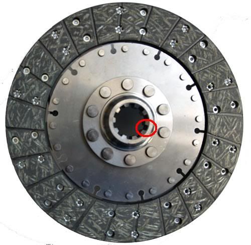

Scott-EP Posted April 3, 2010 Posted April 3, 2010 Did you File the splines down in the center of the Clutch plate ?? There quite blunt when you get them, if you file the corners of them down the shaft slides in alot easier The bit i've circled in between the teeth Quote

WallaceGlanza Posted April 3, 2010 Author Posted April 3, 2010 I've not filed the teeth down but I'm going to check now how easily the plate goes onto the shaft,I also didn't use an allignment tool - I just did it by eye, I did it by eye previously (when the engine and box were both out) and the box fitted back on easily then, I am going to get a clutch allignment tool just incase though.Even if the clutch wasn't alligned properly I think the shaft would still go partly on but I'm not getting anywhere at all, I think it is the the postioning of the box - it's just so bloody awkward and at the moment I am doing it just on my own. Quote
