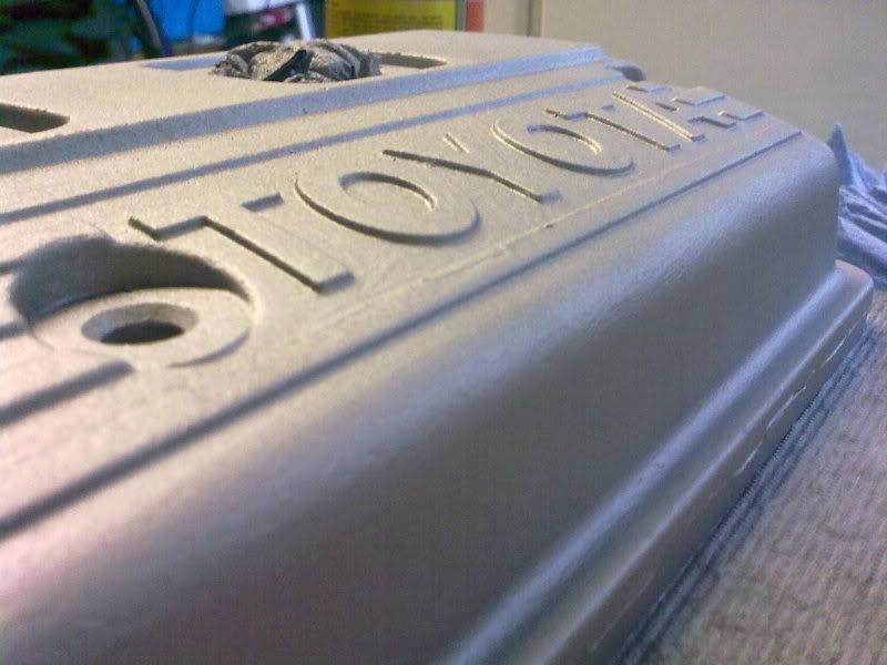

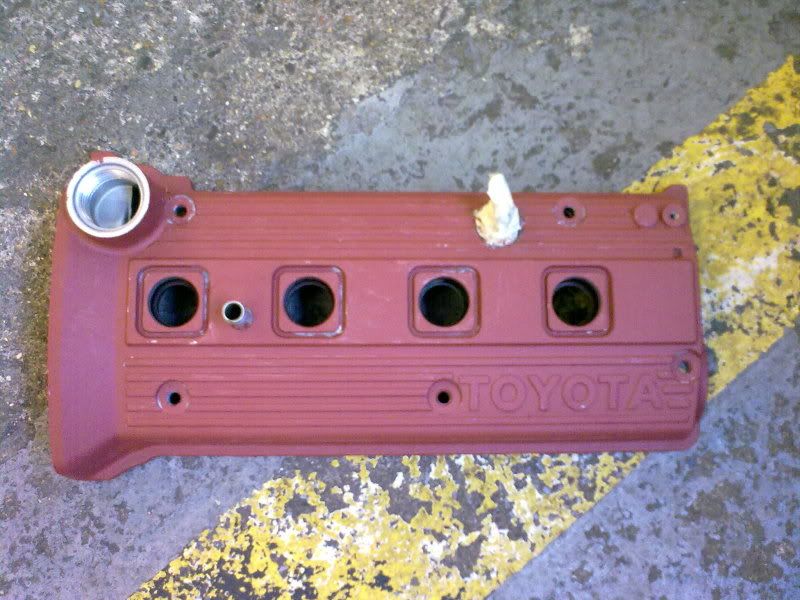

Scott-EP Posted June 10, 2010 Author Posted June 10, 2010 Found some Hammerite special metal primer down work that my boss used to do his roll cage with, Put a coat of it on the Cam Cover have just gone out and keyed it up and put first coat of VHT on it again and will have to wait and see what happens, Unfortunately its not High Temperature primer don't think they make it ?? But i know hammerite is tough as nails and people have painted there blocks and Heads with it so should be ok considering Cam cover doesn't get to hot...The Paint that should Prevent further problems First coat after the PrimerFirst coat before without primer, You can tell it looks really Grainy where its reacting with the aluminium, But this finish does look alot better then it does with primer on underneath as you can see little brush marks There very Faint mind you Quote
