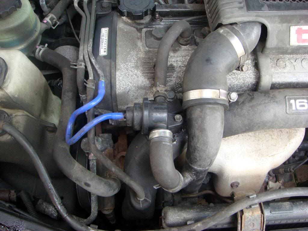

Amjad Posted August 27, 2010 Posted August 27, 2010 I'm completely new to turbo's as haven't got a clue Which pipes do I block off and with what?Thanks,Amjad Quote
bucketep91 Posted August 27, 2010 Posted August 27, 2010 take that blue hose off the recirc valve but leave i attacthed to the metal pipe then put something in it to block it off, a big screw or something i dont think ul need to block the recirc valve but i could be wrong Quote
steed Posted August 27, 2010 Posted August 27, 2010 for chatter? the air rushing backwards over the turbo noise? surely that's not what you're looking for as it reduces the life of the turbo? if it is what you are going for though then remove the recirc/dump valve. Quote
Amjad Posted August 27, 2010 Author Posted August 27, 2010 Ah okay thanks for that! I thought it was an aftermarket DV on there, I didn't think recirc valves had an audible dump Steed yes, I want that awesome sound lol! There's always been debate about whether they damage the Turbos, a lot of people run without a DV so I'm gonna go ahead! Quote
Carl. Posted August 27, 2010 Posted August 27, 2010 Take the valve out completely and block both the thick pipe coming from the i/c pipe and the blue pipe. Then I'd just have a breather filter either straight on top of rocker cover or on end of the pipe that's there at the minute. Quote
Carl. Posted August 27, 2010 Posted August 27, 2010 Otherwise U'll have nothing filtering the air to the breather because at minute it's been filtered through your intake filter going to turbo. Quote
lukEp Posted August 27, 2010 Posted August 27, 2010 just take the blue pipe off the recirc valve and put a srcrew in the end of the blue pipe simples Quote
steed Posted August 27, 2010 Posted August 27, 2010 just take the blue pipe off the recirc valve and put a srcrew in the end of the blue pipe simplesthe problem with doing that is there is a chance that as there is no pressure acting on the top of the recirc valve and under boost it may leak. Quote
lukEp Posted August 27, 2010 Posted August 27, 2010 mine never did but they are all different plus i think he just wants to hear it as hes not driving it yet. Quote

SooperD Posted August 27, 2010 Posted August 27, 2010 Tell him to save up and buy a nice blitz adjustable BOV now mate.. then he can have chatter and/or "whoosH" with out all this unsightly nuts,screws etc.Mine is currently adjusted so it chatters on low boost(low revs) and releases on high revs/boost. Quote
Amjad Posted August 27, 2010 Author Posted August 27, 2010 Whos car is that Amjad?Mine Check the build thread in EP82 section air filter relocation kit... simple!In good time my friend@Ryan: Tell him to save up and buy a nice blitz adjustable BOV now mate.. then he can have chatter and/or "whoosH" with out all this unsightly nuts,screws etc.Mine is currently adjusted so it chatters on low boost(low revs) and releases on high revs/boost.Thanks for the advice, but I only want to spend money on POWERRR, for now anyway For the record, I blocked of all three hoses that lead to the Stock DV, but left the rocker cover breather loose (will be buying a breather filter) Thanks for the help guys! Quote
