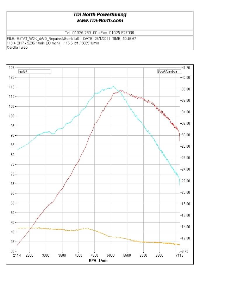

miib14 Posted February 1, 2011 Author Posted February 1, 2011 dynowith WHP (green)with AFR (yellow)Dyno run 0.4bar114bhp @ 5349 revs115.9 lbft @ 5051 revs Quote

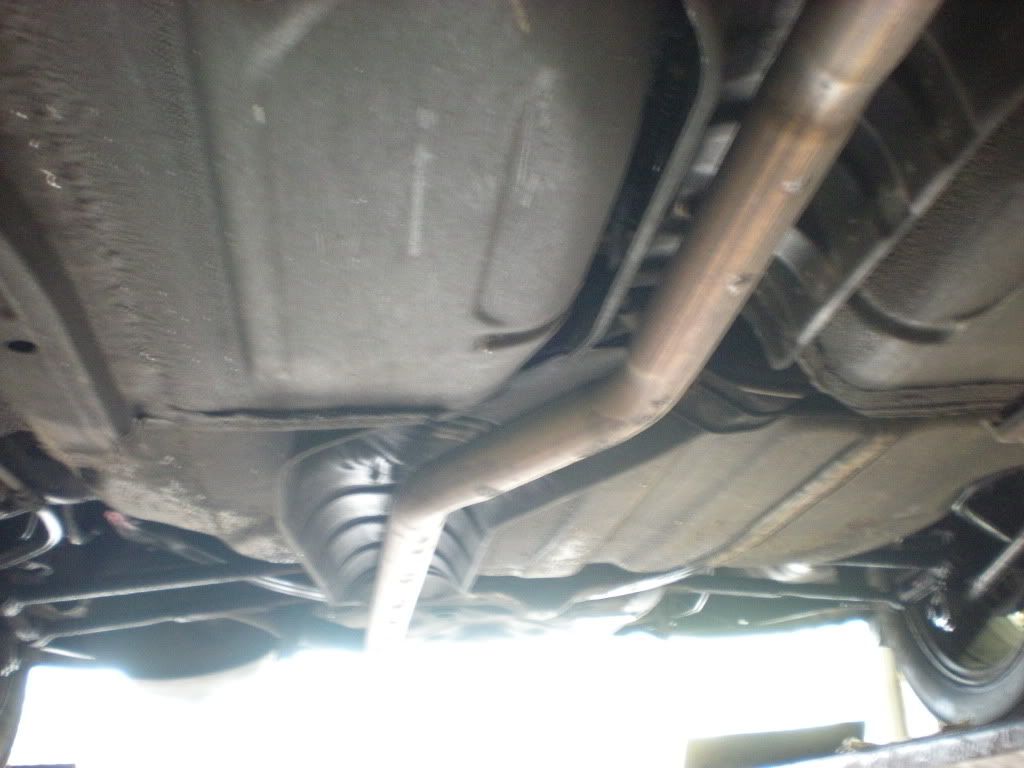

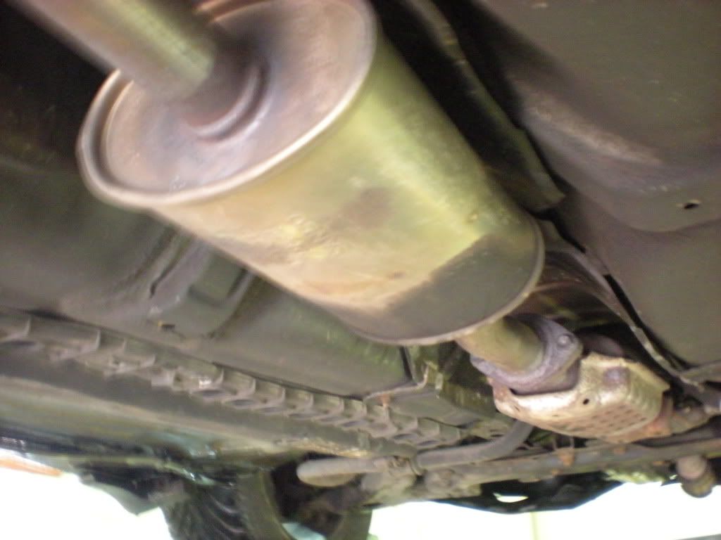

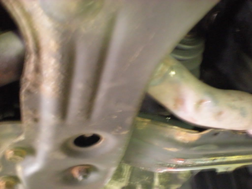

miib14 Posted February 4, 2011 Author Posted February 4, 2011 pics of standard exhaust system...(took them awhile back) Quote
