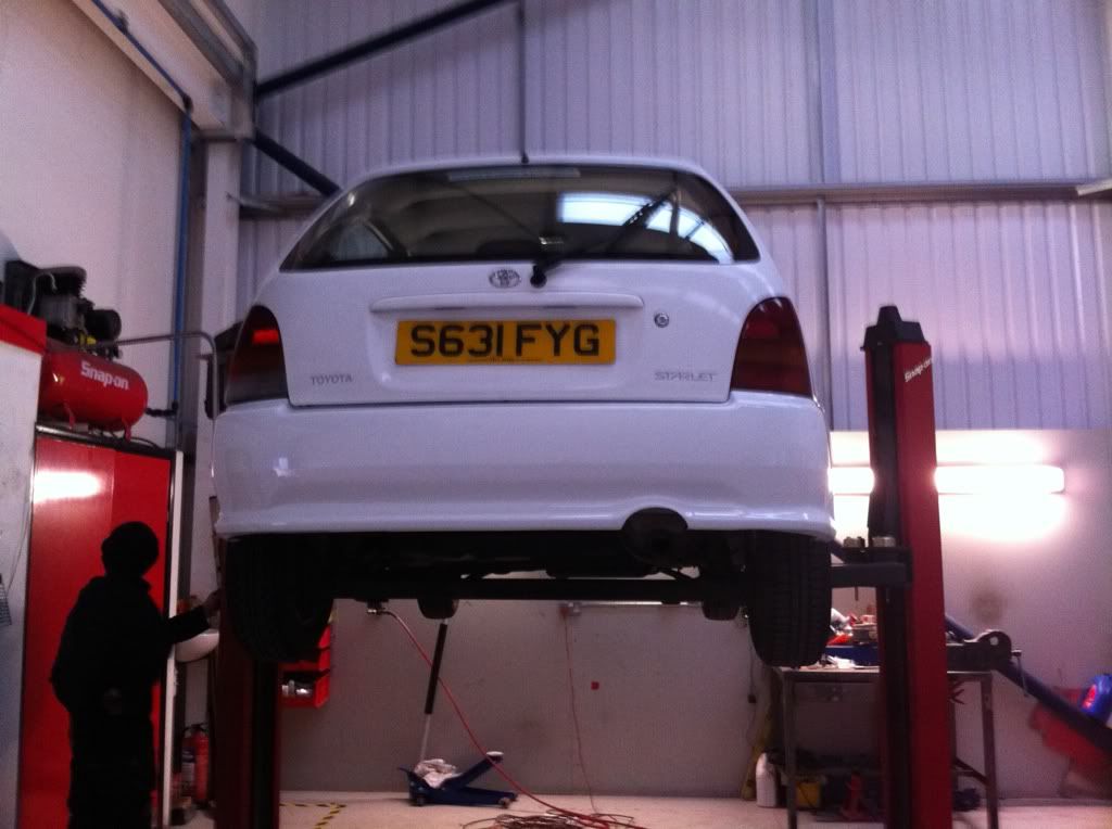

ryan lang Posted April 26, 2011 Posted April 26, 2011 comments obv ^^ hahalooks a bit tidier now mate, you going for the full glanza rep? Quote
dai_starletN/A Posted April 26, 2011 Author Posted April 26, 2011 comments obv ^^ hahalooks a bit tidier now mate, you going for the full glanza rep?i wish i could say but you will just have to wait and see lol.. Quote
hill_bill10 Posted April 26, 2011 Posted April 26, 2011 looking good mate, thanks for that part number ive been meaning to get some of those clips for ages as mine had the same problem because its been in a few bumps from previous owners and they dont fit properly because theres no clips lolcars looking good, much better with clear lenses plus get those wheels white, white wheels ftw Quote
dai_starletN/A Posted April 26, 2011 Author Posted April 26, 2011 clear indicators look loads better pal thanks mate Quote
dai_starletN/A Posted April 26, 2011 Author Posted April 26, 2011 looking good mate, thanks for that part number ive been meaning to get some of those clips for ages as mine had the same problem because its been in a few bumps from previous owners and they dont fit properly because theres no clips lolcars looking good, much better with clear lenses plus get those wheels white, white wheels ftw your welcome mate and thanks. i got some bigger wheels in mind these ones are 13" im going for 15" or 16" Quote
dai_starletN/A Posted April 26, 2011 Author Posted April 26, 2011 lmao yes then? or remix bumper?alright guys might as well its going to be a remix front end Glanza spots or equivalent and im taking my starlet badge from the front and placing it on the remix Quote
hill_bill10 Posted April 26, 2011 Posted April 26, 2011 alright guys might as well surrender.gif rolleyes.gif its going to be a remix front end Glanza spots or equivalent and im taking my starlet badge from the front and placing it on the remix thumbsup.gifgood man, everyone does the glanza conversion, im goin for the remix too hopefully next week just not sure were to get the fogs from let us know how u get on Quote

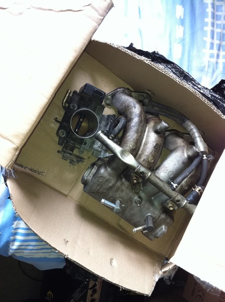

dai_starletN/A Posted May 5, 2011 Author Posted May 5, 2011 i just had a delivery i'm mega happy about it cant wait to fit it, i just got to figure out how to. thanks Idress it arrived well packed it took me a while to get into the packaging but i am really happy with it :rtfm: 4E_FTE Intake Manifold Quote
Ryan5793 Posted May 5, 2011 Posted May 5, 2011 ahhh mine still isnt here! let me know when you have fitted it :rtfm: Quote
nastyrash 2003 Posted May 5, 2011 Posted May 5, 2011 wer abouts u at fella, i will pm u my number and talk u thw the instalation mate.shine it up, and u will need a blanking plate making for wer the idle valve sits. Quote
ryan lang Posted May 5, 2011 Posted May 5, 2011 let me know if you get the TB to work, and how got this lying around so may fit it :rtfm: Quote
dai_starletN/A Posted May 5, 2011 Author Posted May 5, 2011 ahhh mine still isnt here! let me know when you have fitted it :rtfm:alright will do but i don't think i will have it done by ace cafe meet. Quote
nastyrash 2003 Posted May 5, 2011 Posted May 5, 2011 let me know if you get the TB to work, and how got this lying around so may fit it :rtfm:lol it works fella, trust me, will send u my number 2 ryan. Quote
dai_starletN/A Posted May 5, 2011 Author Posted May 5, 2011 wer abouts u at fella, i will pm u my number and talk u thw the instalation mate.shine it up, and u will need a blanking plate making for wer the idle valve sits.thanks mate just saw your pm now. sorry for sounding a bit dumb but where is the idle valve :rtfm: Quote
ryan lang Posted May 5, 2011 Posted May 5, 2011 cheers chris, i think i have it but got a feeling its the wrong 1its not a case of straight plug and play though is it? Quote
nastyrash 2003 Posted May 6, 2011 Posted May 6, 2011 thanks mate just saw your pm now. sorry for sounding a bit dumb but where is the idle valve :rtfm: the oposit end to the TB, thr are 2 8mm bolt holes and a single 12mm hole into the manifold this needs blocking up do not put anything else in the hole other than body filler or a plate, but if u use body filler be very carefull to clean it (grease and oil free) and watch u do not push filler all the way thw the hole. just a nuff to cover. Quote
dai_starletN/A Posted May 6, 2011 Author Posted May 6, 2011 the oposit end to the TB, thr are 2 8mm bolt holes and a single 12mm hole into the manifold this needs blocking up do not put anything else in the hole other than body filler or a plate, but if u use body filler be very carefull to clean it (grease and oil free) and watch u do not push filler all the way thw the hole. just a nuff to cover.thanks mate Quote

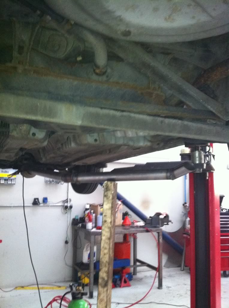

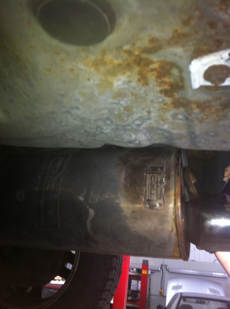

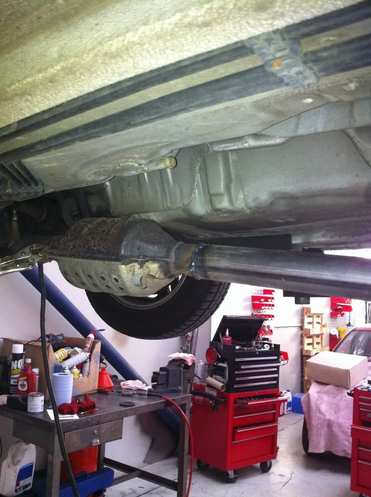

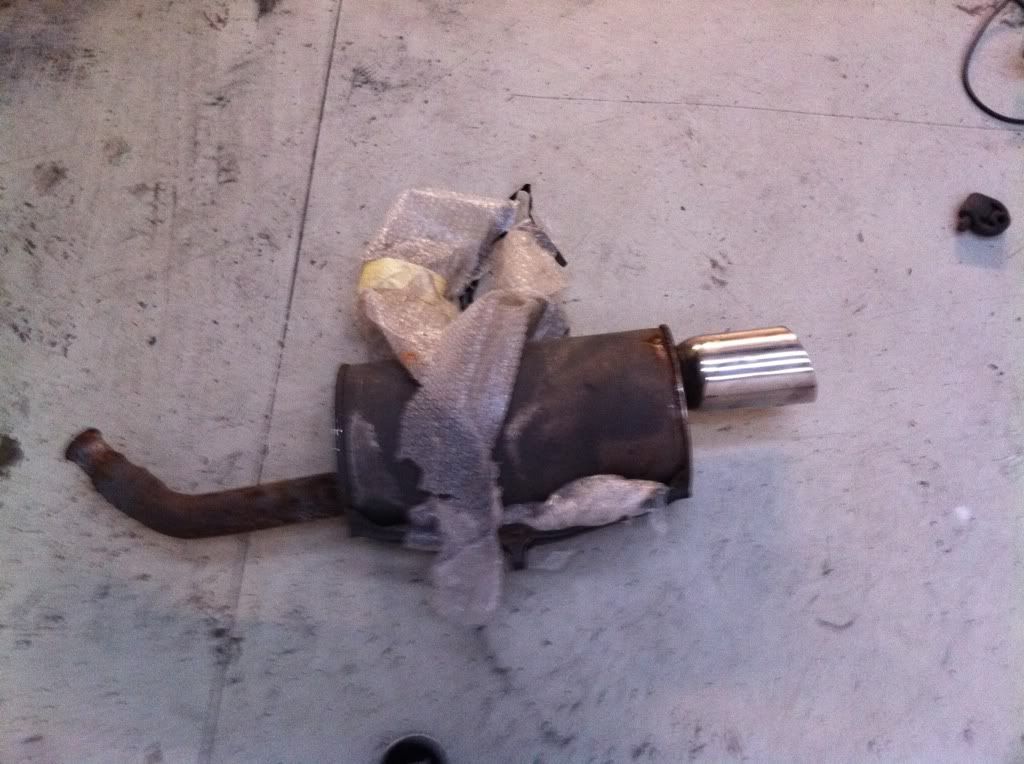

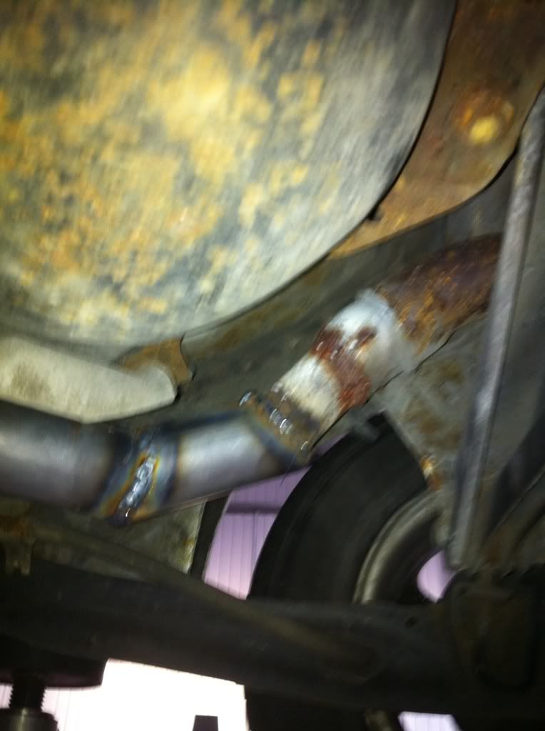

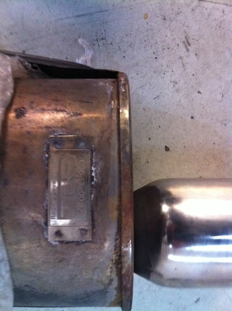

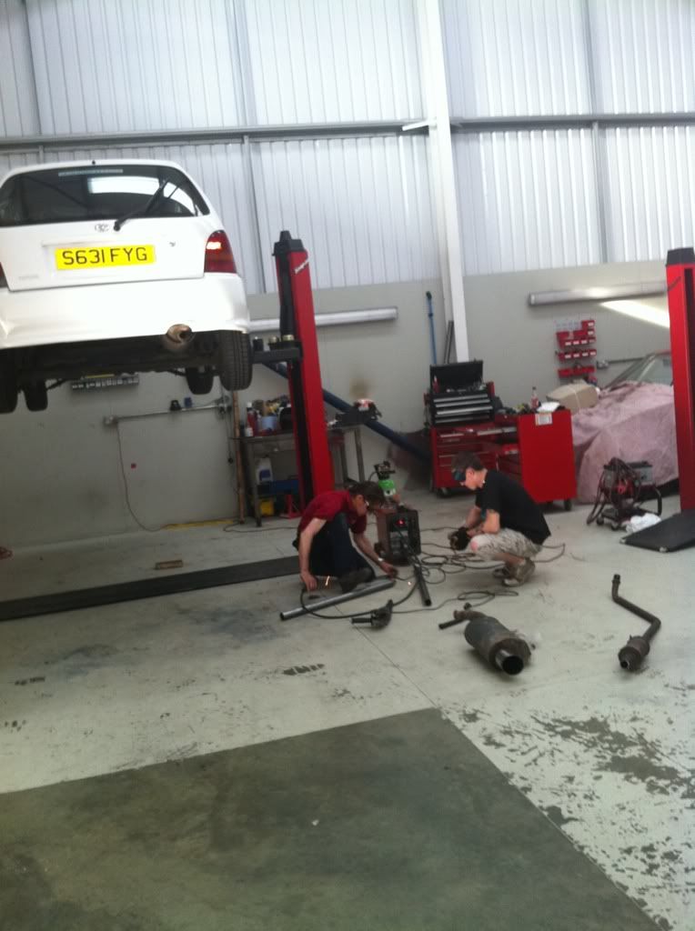

dai_starletN/A Posted May 6, 2011 Author Posted May 6, 2011 i decided to do this out of the blue today. CUSTOM CATBACK Finally the vid going to get a better one but for now HERE WE GO!!! ;) Quote
Ryan5793 Posted May 6, 2011 Posted May 6, 2011 you can actually hear it now! ;) cant wait to hear it in person, really miss how i could hear my music with that exhaust looks awesome mate Quote
