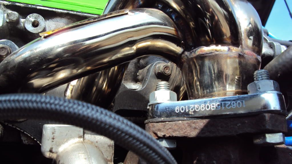

Taggy Posted April 23, 2011 Posted April 23, 2011 Took my car for a spin today to test out the TD04 and i noticed im getting hardly any boost, turbo wasnt even beginning to spool up until nearly 4500rpm and even then it was nearly nothing.Looked in the engine bay and can hear that the toyosports manifold i bought is blowing quite badly past the gasket, seems to be coming from number 4 and you can feel it when you rev it blowing.Now when i fitted it i notice that the manifold didnt just slide straight onto the studs, it must have been machined slightly wrong as i had to use a hammer to tap it onto the studs to sit flush.I also noticed gaps around the voids between each runner, i have included photos to show you, is this normal. What are the toyosports gaskets like, as no matter how tight i do it up, its still blowing from the bottom right number 4!Gaps aboveGaps belowNow i dont think these voids actually have anything to do with it, but i just wanted to check as it looks a bit odd, im sure the old CT9 manifold gasket went over these.Anyone else have problems with these toyosports manifolds?Craig Quote

daz gt turbz Posted April 23, 2011 Posted April 23, 2011 the gaskets suplied with them are a waste of time mate! toyota 1s are the best, youl need the block to manifold 1 from toyota and the others from subaru, think tmd do them aswel. but ive also heard stories of the flanges on the toyo sports manifols being warped from manufacture so with getting them skimmed to being 100% flat there always going to blow. Quote
Taggy Posted April 23, 2011 Author Posted April 23, 2011 Yeah thats what im worried about, it was a bit of a dodgy fit going on and i damaged a stud putting it on because it was so tight and had to replace it.I think im gonna take it off, put a flat edge on it and then go from there, fuckin pain the god dam ass is what it is! I didnt think to check it before i fitted.If its warped im sending the bloody thing back as i also noticed the Decat pipe was also machined wrong and i can only get two of the 3 bolts in at the moment so im gonna have to redrill it to make up for the tolerance inaccuracy.Ok so i want a toyota gasket for the head to the manifold then, will get one on order.the gaskets suplied with them are a waste of time mate! toyota 1s are the best, youl need the block to manifold 1 from toyota and the others from subaru, think tmd do them aswel. but ive also heard stories of the flanges on the toyo sports manifols being warped from manufacture so with getting them skimmed to being 100% flat there always going to blow. Quote

Taggy Posted April 24, 2011 Author Posted April 24, 2011 I just seen what the toyota original gasket looks like, i cant believe i put that piece of shit toyosports one on.this is what it should look like!http://www.camskill.co.uk/products.php?pli...b663s1303p11510The bloody toyosports one isnt even metal, its like bloody cardboard, arggghhh i got to pull it all off again Quote

Steve GT Posted April 24, 2011 Posted April 24, 2011 non OEM gaskets blow like fuck mate I've just had new ones on and they went straight awaymy advice is buy an OEM toyota gasket. also when you take the mani off check the flat edge on the front i guarantee it wont be 100% flat. grab a flat file and make sure its nice and smooth dude. get a bit of sand paper on it too get all the bumps out Quote
RobSR Posted April 24, 2011 Posted April 24, 2011 get all the mani surfaces skimmed and toyota/scoob gaskets then youll be fine... you said you keep tightening to try and stop it? how tight? mani to head is only meant to be 48nm and if youve over done it alot, it can crack the head.. Quote
