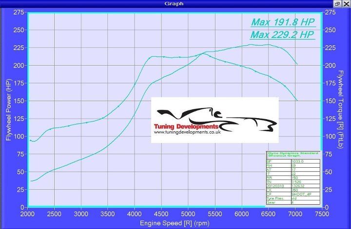

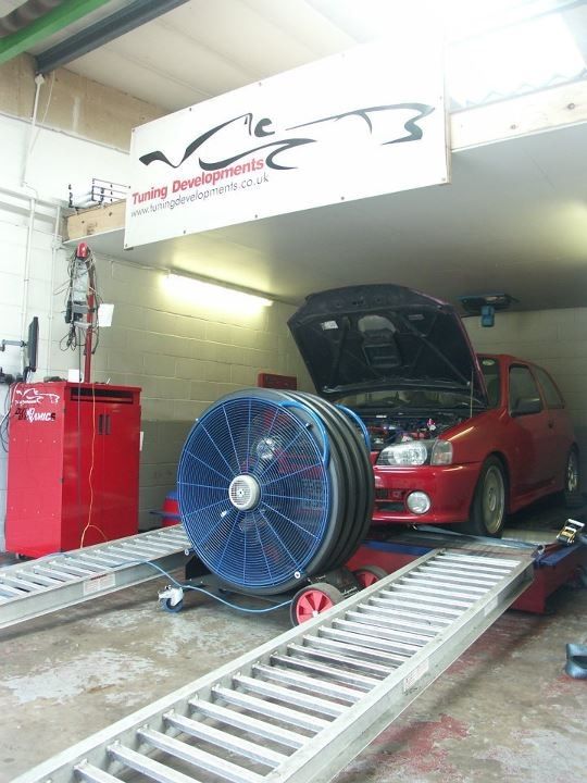

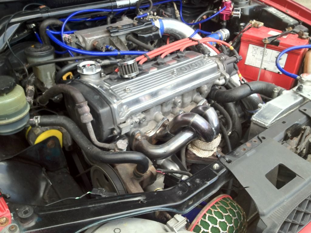

neilsmith Posted April 21, 2012 Posted April 21, 2012 Last month i traveled down to tuning developments to have the car mapped, been meaning to post the graph ever since but been to busy.Since having it mapped the car runs and drives alot better, theres more power throughout the whole rev range! The guys done a great job!It got mapped at 1.1 bar tailing off to 1 bar and achieved 229bhp at the fly which i was chuffed with!Cars running a TD04H With a toyosports s/s mani (surprisingly not cracked 'yet')Front mount intercoolerJperformance exhaust system360cc injectorsMagnecore leads with iridium plugsHks front mount air filterFuel pressure regulatorExedy paddle Clutch with lightweight flywheelLet me know what yous think of the results! Quote

Socks Posted April 21, 2012 Posted April 21, 2012 Approved Neil matey. Your troque seems rather tastey for your boost! compared with others, so well done! maybe the lightweight fly? unusual mod! Quote
neilsmith Posted April 21, 2012 Author Posted April 21, 2012 I noticed i put lbft next to tourqe, that was a mistake it should have been 220 nm i think, Quote

Socks Posted April 21, 2012 Posted April 21, 2012 I noticed i put lbft next to tourqe, that was a mistake it should have been 220 nm i think,No its correct matey, I check all the graphs and results... before approving a result Quote
