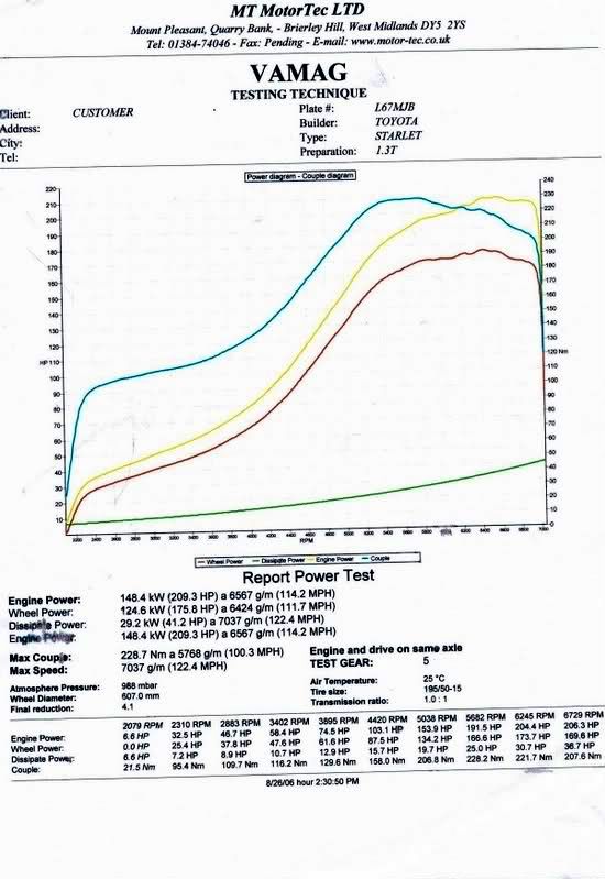

Bean Posted July 6, 2012 Posted July 6, 2012 the newer evo turbos are twin scroll the earlier ones arent. my old white car ran an evo 1-3 td05h 16g with a very early wepr kit this was years ago now. at a bar it made 210bhp but i sorted a few issues out and im sure it ran slightly more, it was quite laggy but once it was on boost it was a weapon lol.not the best quality graph but it was 2006 Quote
LukeSR Posted July 6, 2012 Posted July 6, 2012 the newer evo turbos are twin scroll the earlier ones arent. my old white car ran an evo 1-3 td05h 16g with a very early wepr kit this was years ago now. at a bar it made 210bhp but i sorted a few issues out and im sure it ran slightly more, it was quite laggy but once it was on boost it was a weapon lol.not the best quality graph but it was 2006God damn I miss that car!! First turbo car I went in Quote
Bean Posted July 6, 2012 Posted July 6, 2012 yeah it was a beast alright! it was savage when the boost came in, it was all or nothing lol. i wish i could have kept it. Quote
