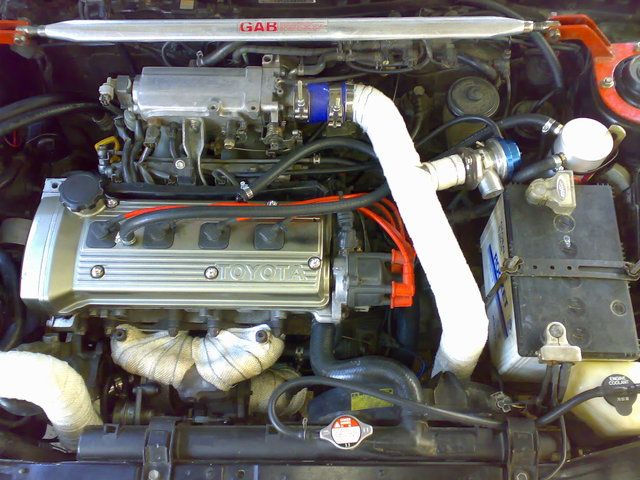

TurboTobz Posted October 31, 2012 Posted October 31, 2012 (edited) Seen/heared of issues with running it via pcv. Mines personally matched corofins set up, although had the car nearly a month never seen anything in it - could well have been emptied prior to buying it, but of course there's not meant to be a major amount within it.P.S. Corofin, that bays stunning! Is it yours? Edited October 31, 2012 by TurboTobz Quote

corofin12345 Posted November 1, 2012 Posted November 1, 2012 Seen/heared of issues with running it via pcv. Mines personally matched corofins set up, although had the car nearly a month never seen anything in it - could well have been emptied prior to buying it, but of course there's not meant to be a major amount within it.P.S. Corofin, that bays stunning! Is it yours?nope, not mine.. one of irelands nicest glanzas tho.... Quote
Beastmode panda Posted November 1, 2012 Author Posted November 1, 2012 Yep that's exactly how mine is except on the can i don't have a filter, mines just vented.That's ok then, just wanted to double check i was doing it right! I took off the hose that connects the pcv to the inlet and the pcv was pretty damn oily, is that normal?And DANNNNNNNG that engine bay is sexy! Love his build up thread. Insane car. Quote
5T4R7ET N/A Posted November 1, 2012 Posted November 1, 2012 ^^ with the engine bay pictured above, I believe you dont need a catch can from that breather.all you need is a filter. if you have oil coming out of the breather (one on the left) your pistons rings are gone. only excess air should come out of it.actually you dont even need a filter on there but it's helpful in stopping moisture getting inside the engine especially in winter. ( and its looks better) Quote
