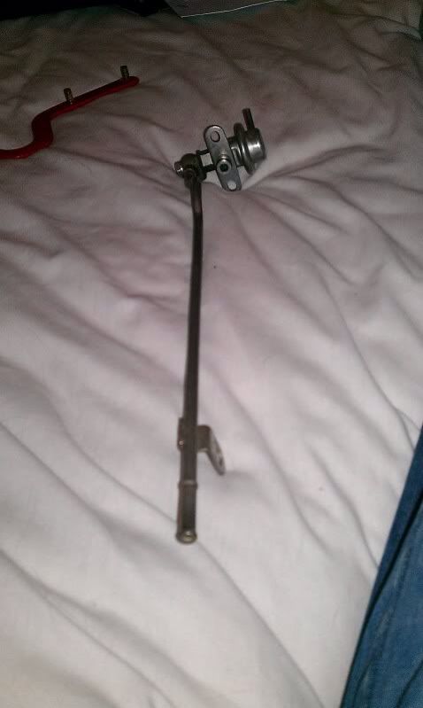

I am not planning on upping the boost anytime soon I just want the car to run normal lol if I turn the nut on top of the FPR will this adjust the pressure? I will just turn until its back to 2.3/2.4 bar.. Is that correct?
Thats correct, turn the nut on top with the vacuum hose disconnected and the engine running at idle.
Does it have any brand name on the regulator at all?
