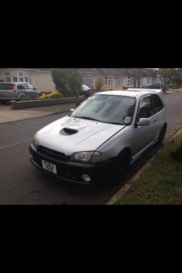

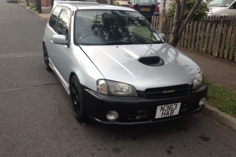

Since then I've had a lot of cars but I eventually got bored of my Ibiza cupra and decided to get another glanza. I wanted something white pref 98 spec and with a bit done, I ended up getting a silver 96 spec with very little done. I was not overly happy with it and knew i would be changing a lot on it!
Here's how she looked:-

The car originally had a livesports front end it was cracked and replaced with a 96 spec bumper.
Spec was as follows (taken from for sale listing and modified slightly as I found a few little surprises)
Hks ssqv squential dump valve
Hks mushroom air filter
Hks actuator
Hks fuel cut defender
Magnicore 8mm blue ht leads no king
Toyo sport stainless manifold
Toyo sports stainless decat
Straight through system (DIY straight bar welded in and universal can clamped on)
Jperformance oil catch can
Tanabe sustec and shocks
Front mount intercooler
Complete hard piping and blue hosing
Mph dial facia
16" advan rcii reps excel
Bonnet raisers
98 spec rear lights
98 Spec clear indicators
Original optional wind deflectors
Original optional ignition ring light
electric mirrors
Livesports rear spoiler
fob system (remote battery gone)
Smoked boost gauge pod
New brake discs and pads all round
Blue anodised throttle pulley

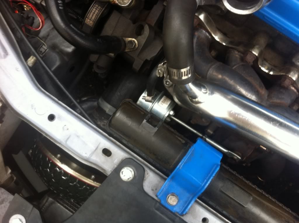

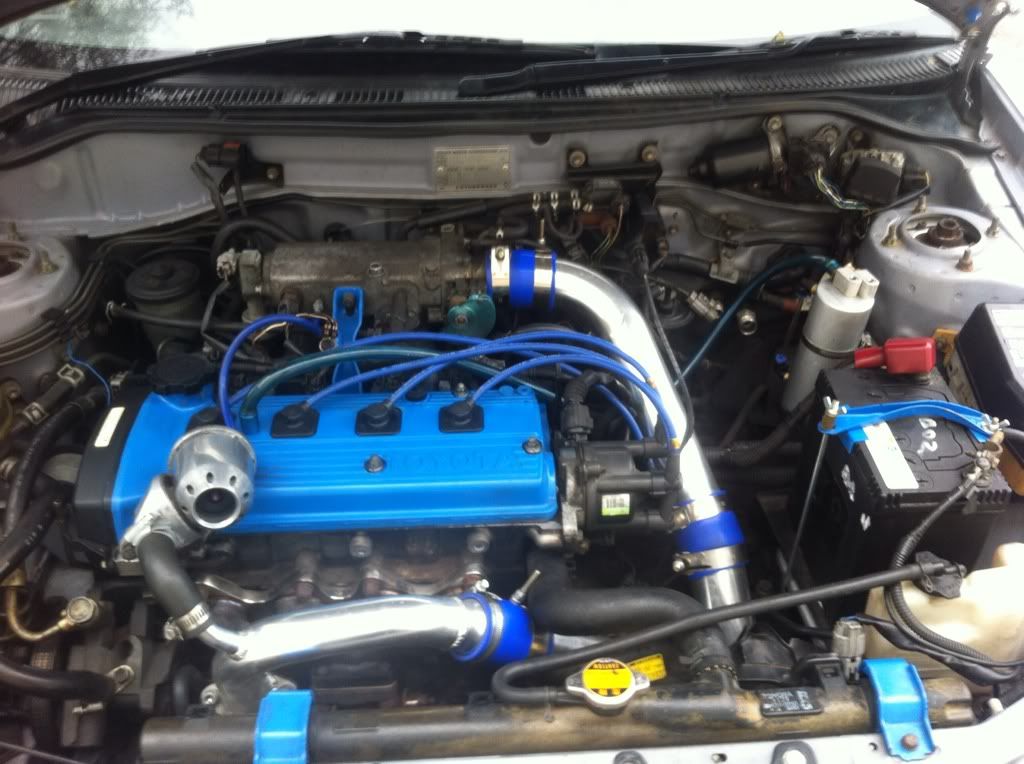

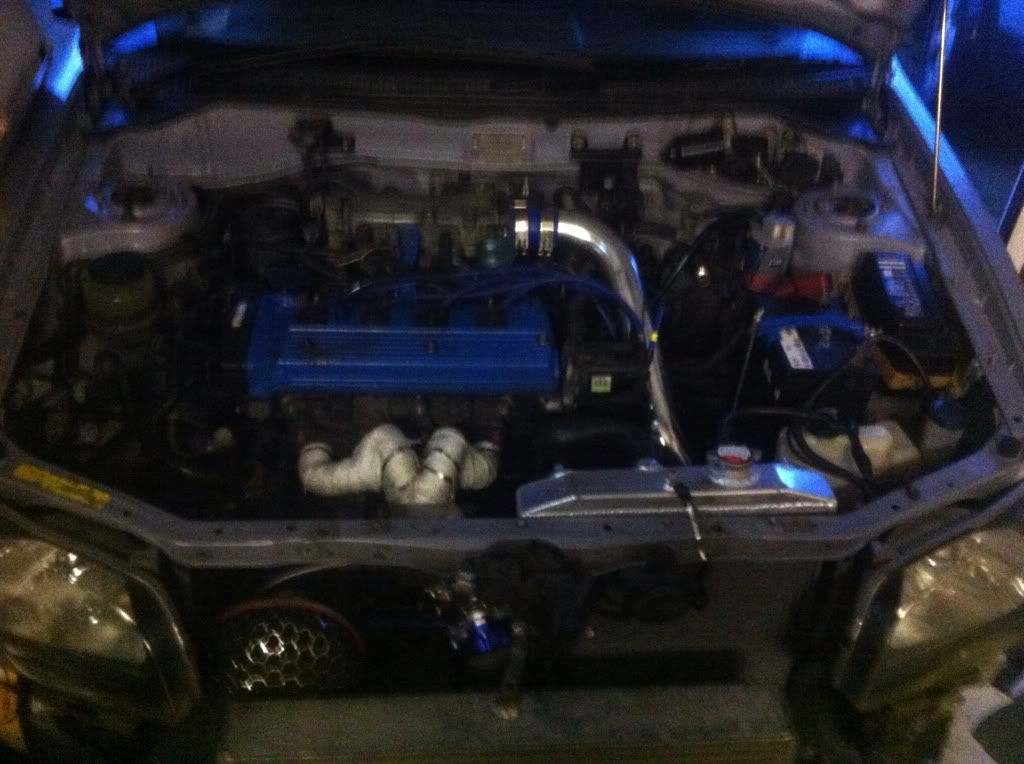

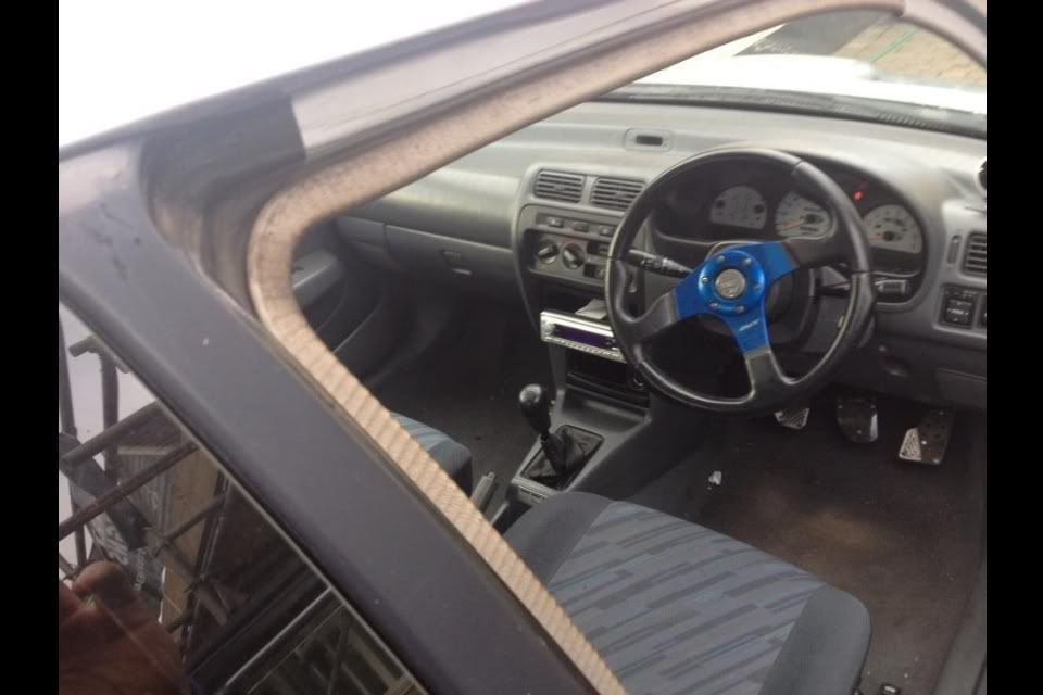

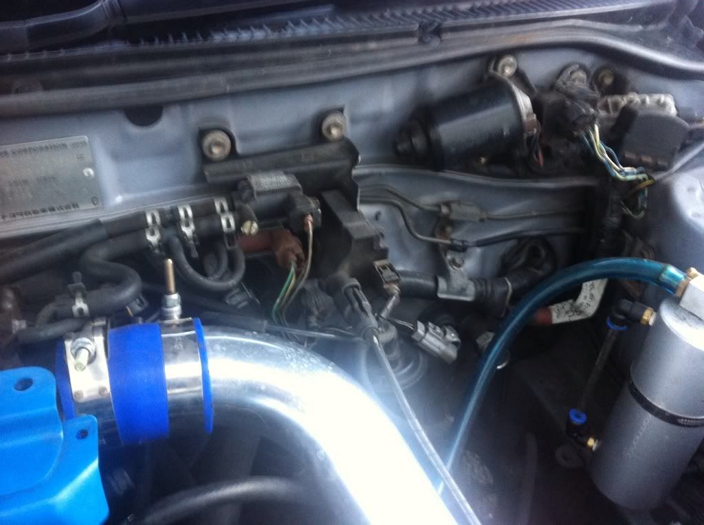

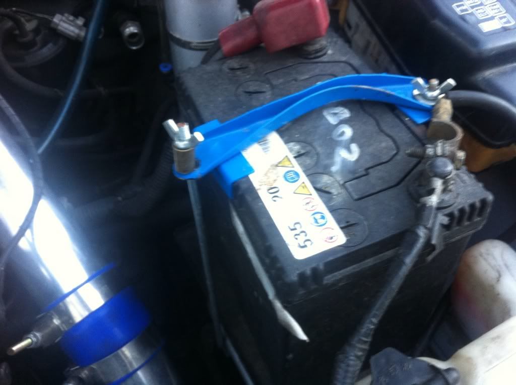

As I was searching through the car I found a hks FCD which was switched off that the owner didn't know about.
I started removing some shitty blue brackets and found a anodised blue throttle pulley.
The owner had no idea what make the coilovers were I expected them to be crap.
Everything had been rattle canned blue, and the exhaust manifold was cracked and blowing among a few other little pesky issues.

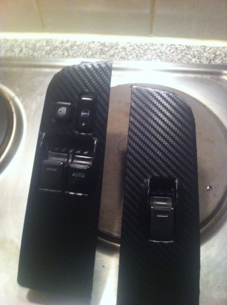

Tried wrapping first attempts:

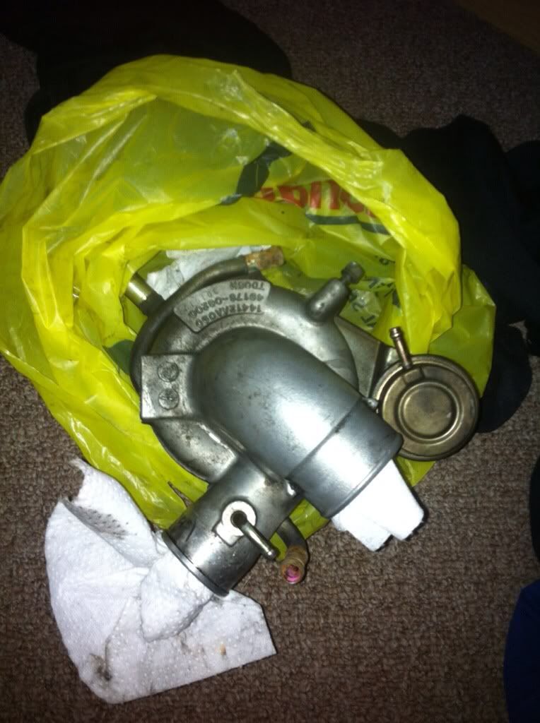

My toyosports manifold eventually killed the ct9 oil feed my mate tried brazing it for me but it didn't quiet work out so rather than mess about I started some ordering, really dislike ct9's...

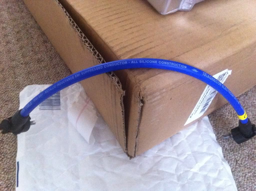

Mine and rbz's replacements couretsy of Magnecore racing

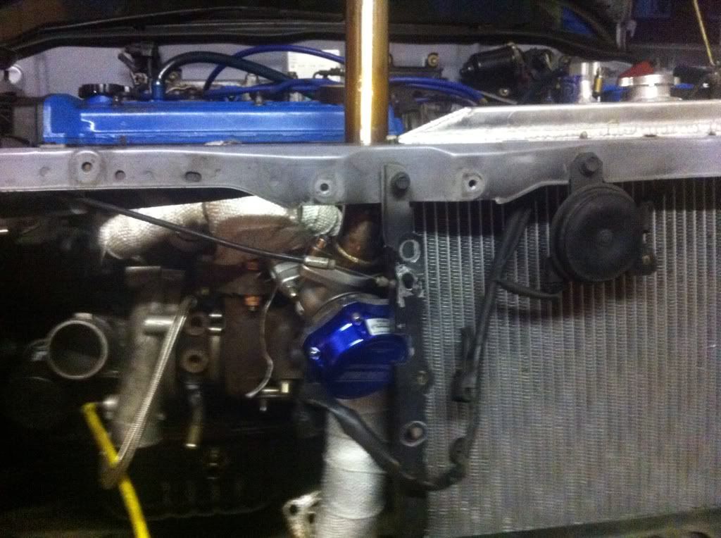

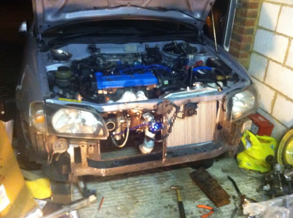

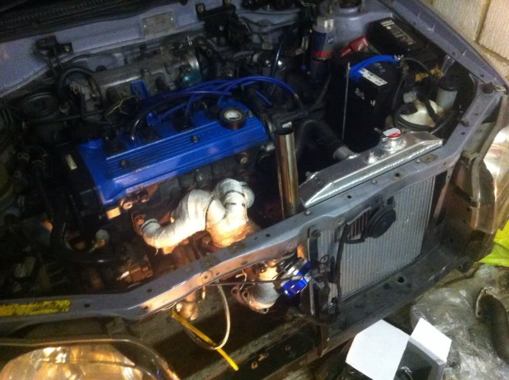

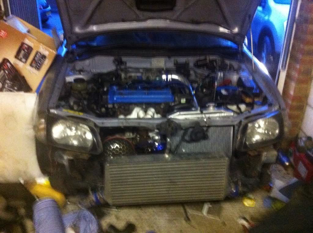

And so the work began!
7464B8ED-8616-43AA-884E-D9E6AE95768A-797

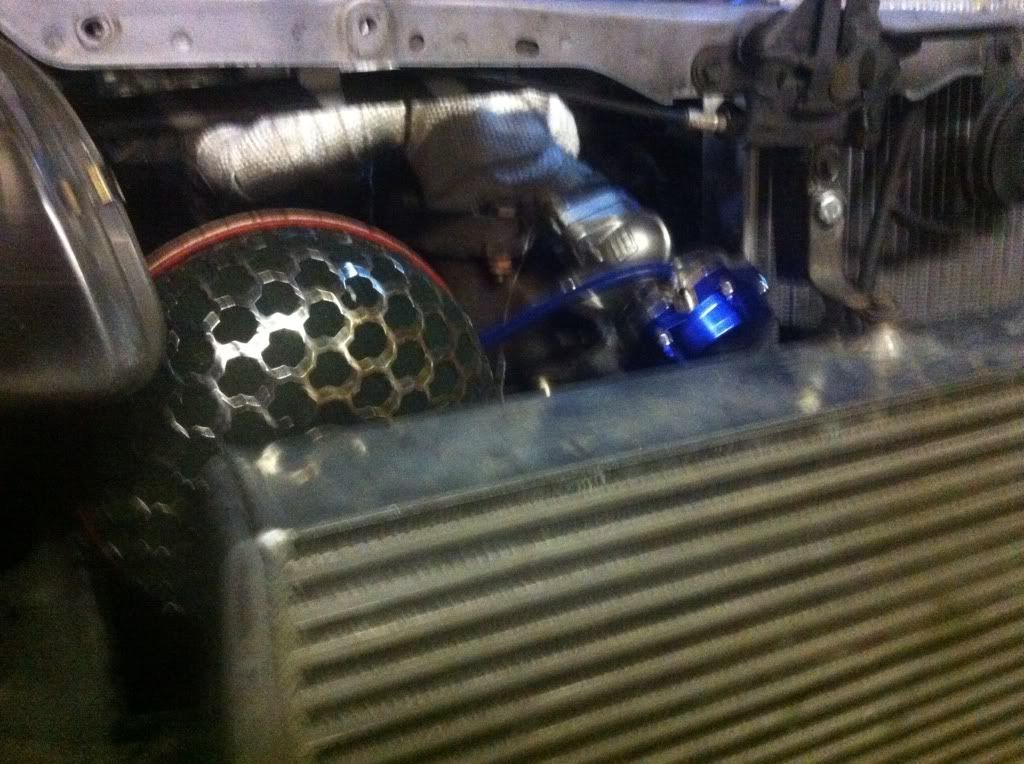

made a small cut out for the Slam panel reinforcement bar to clear the external wastegate
D6853243-7D4E-416E-99FE-88DEF305D1FC-797
15C95A95-7B4E-42A5-B571-540EE4CB2AFD-797
ADA5473D-10DF-4A5F-8CC2-992A525DE88F-797
Left it over night and came back to ensure I'd got everything sorted no point rushing these things next day came...
37ADD4D8-36B2-4374-AAF1-643054C143EE-797
2BD5B861-DB3F-4B3E-ACDB-1F875C5748EF-797
Decided against running the bonnet exit screamer...
D3C9A490-B262-41F0-8BB1-6FB17395FF25-797
EE27C111-FC5D-46D9-A7BA-9D857D9F9B4A-797
079ACEF2-7790-41BA-B14D-39A0E5E6EE06-797
(radiator still hasn't been completely mounted I have the brackets just need a day in the garage)

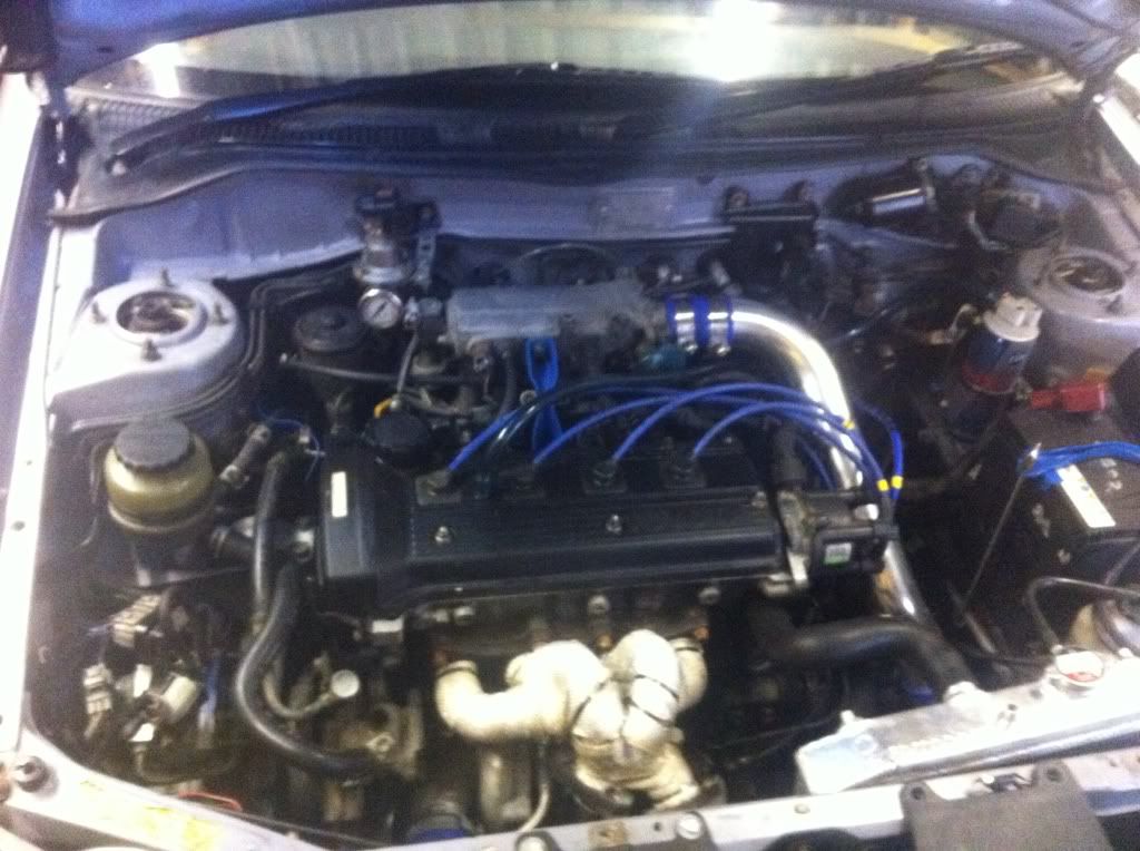

had a small bit of fabrication involved for intercooler etc but not a massive amount.
Parts were:

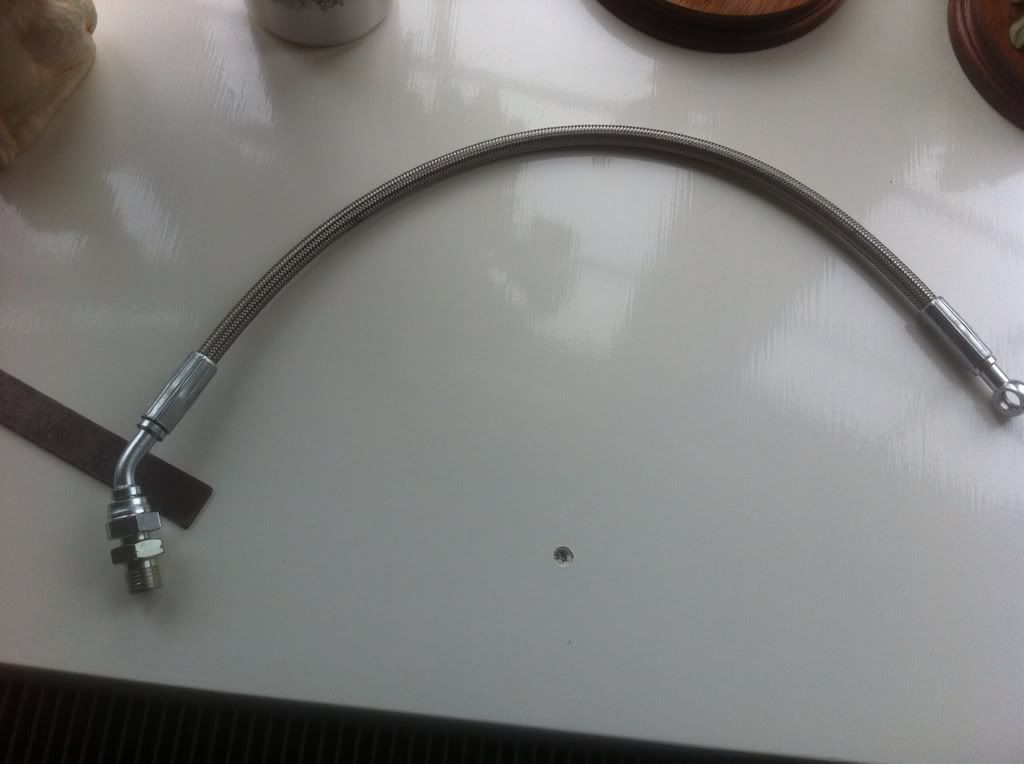

- td05h 16g and a td04 16g but the 04 needed seals so it's sat in my garage at the moment
- Magnecore racing king lead.
- tuning developments braided oil feed.

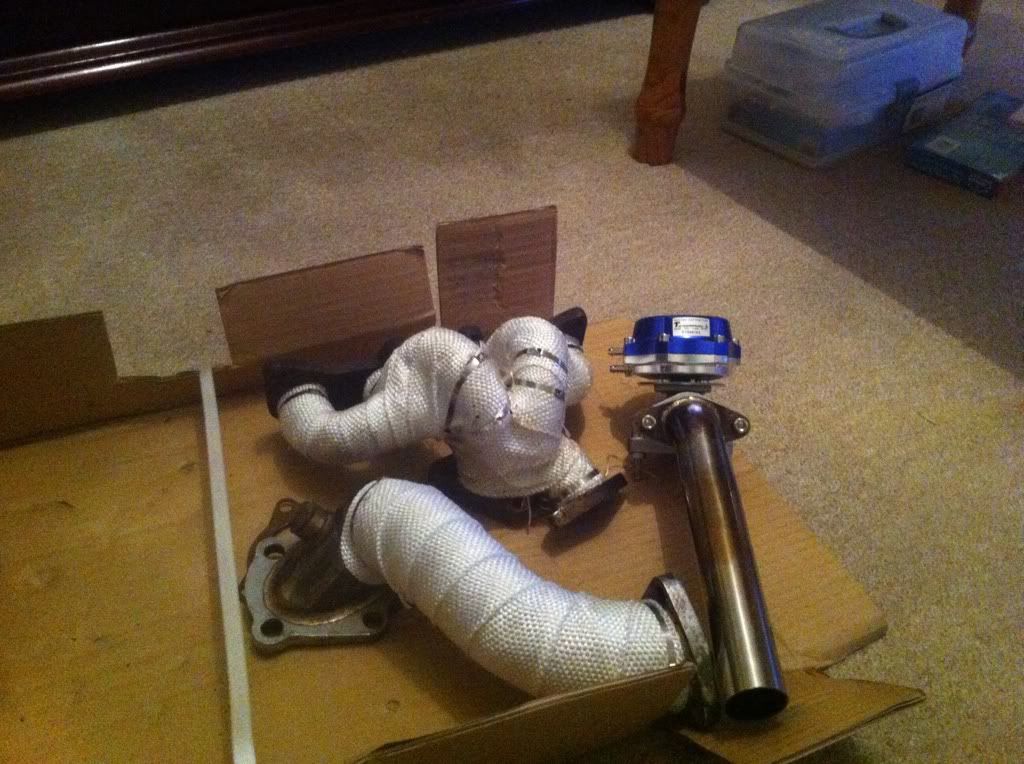

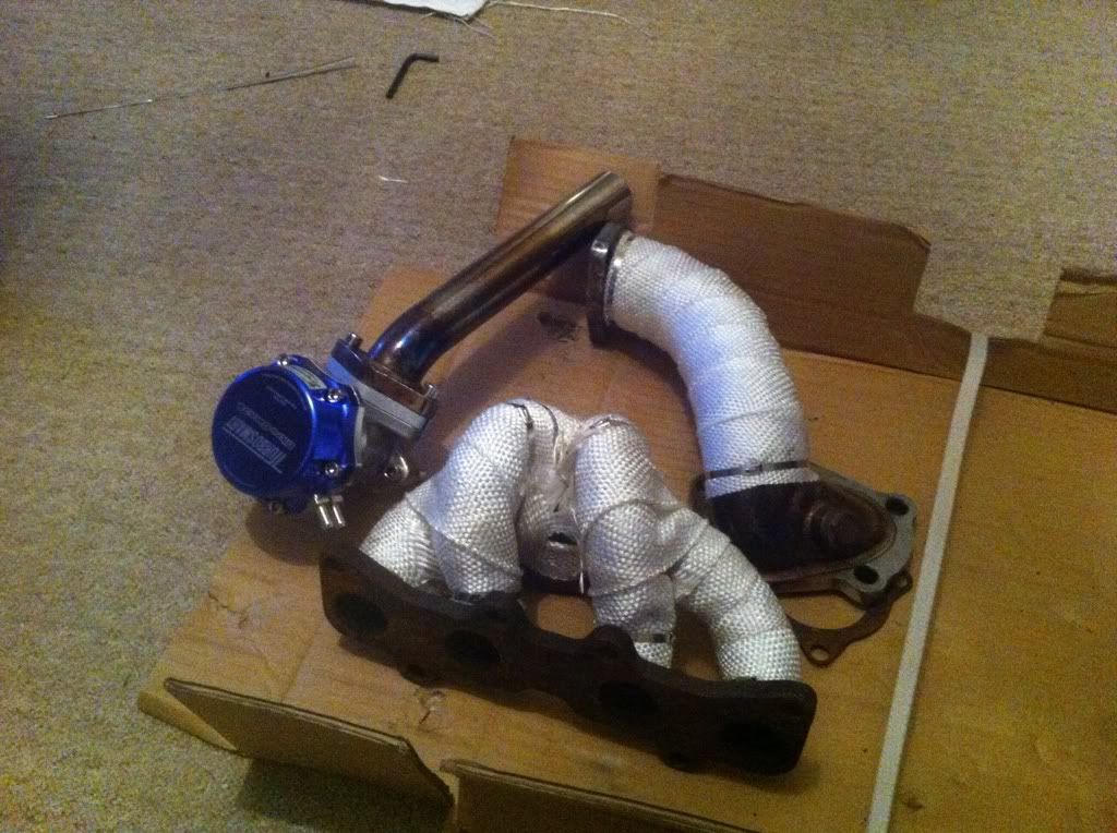

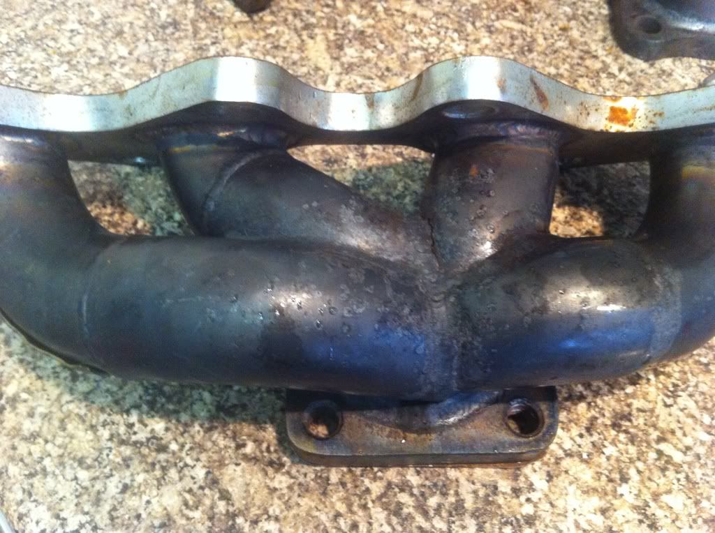

- mild steel ewg manifold td series flanges.

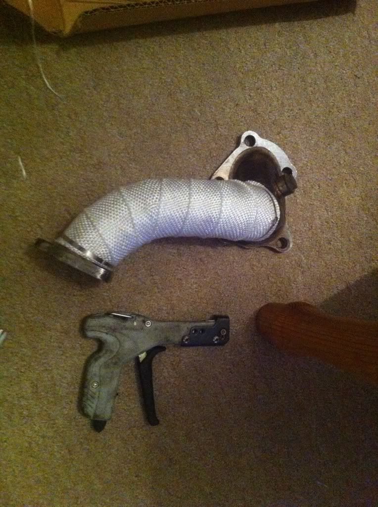

- stainless steel td series decat.
- Copper nuts for manifold.
- toyosports heat wrap.

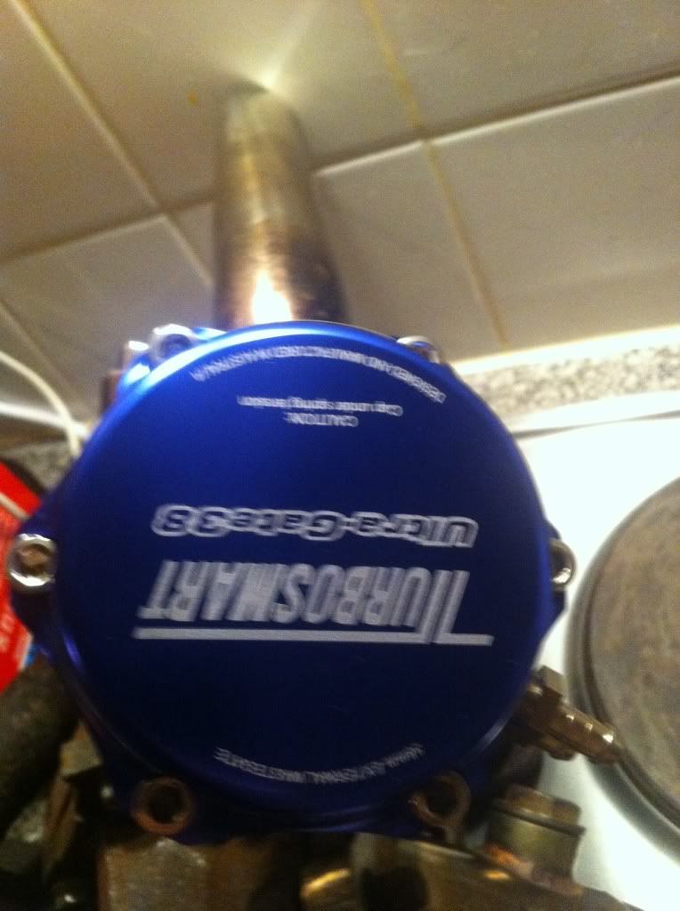

- Turbosmart ultra gate 38mm external wastegate .5 and 1.0 bar spring.
- 38mm screamer pipe.

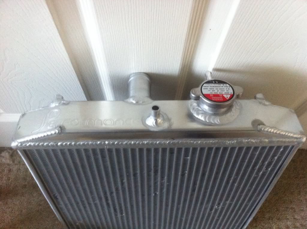

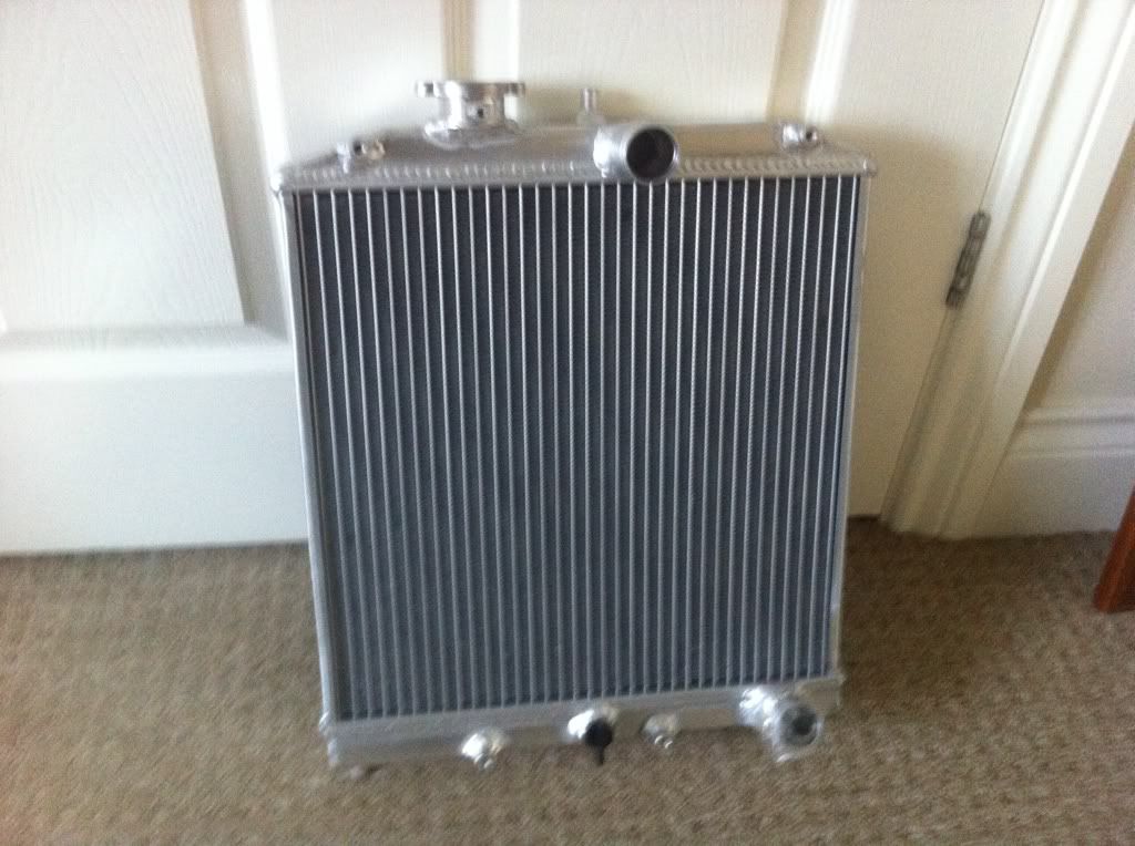

- jperformance 42mm civic alloy racing radiator.
- Toyota red coolant.
- Castrol Magnatec fully synthetic 10w40 oil.
This left me with the fuelling to sort and set up until I have a better set up and Ecu.
How come the screamer sits upwards mate?? Or is it that you had it like that while you were working on it??

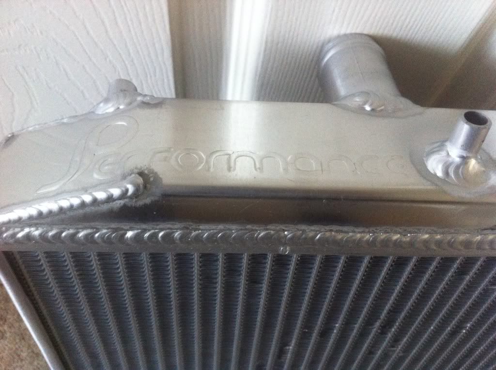

Looks good though mate where did you get the rad from?
Cracking stuff... No seriously.... Glad these were removed lol.

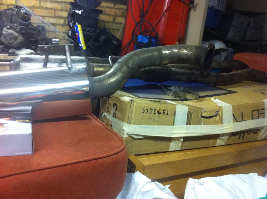

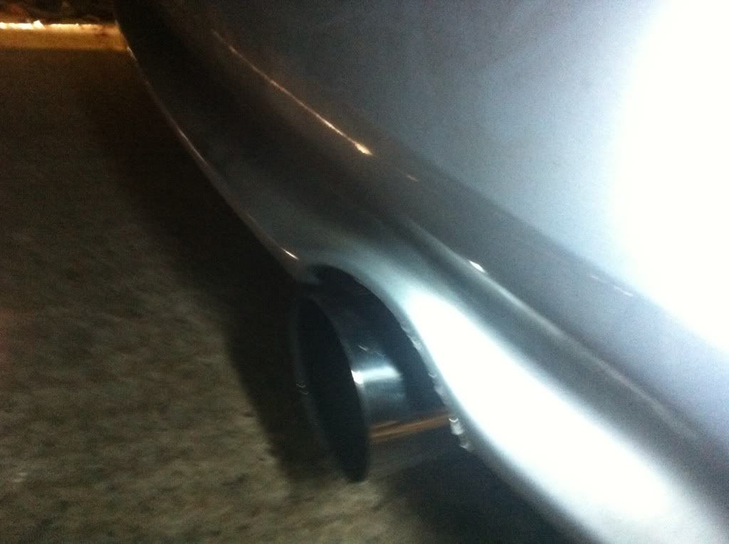

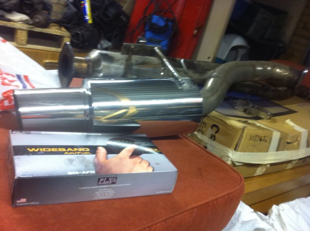

Exhaust, full jperformance stainless system. With thanks to lew91!
C4CB279A-30BF-4B10-BBB5-23BBA03605E9-824
B0C4380B-7C14-436D-826C-FB4F626F1CD9-824
81A9A2F0-C7E0-422F-BD0D-B2768656ABCA-824

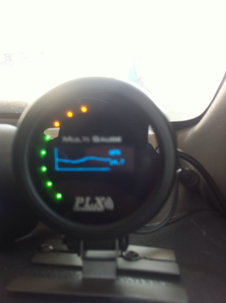

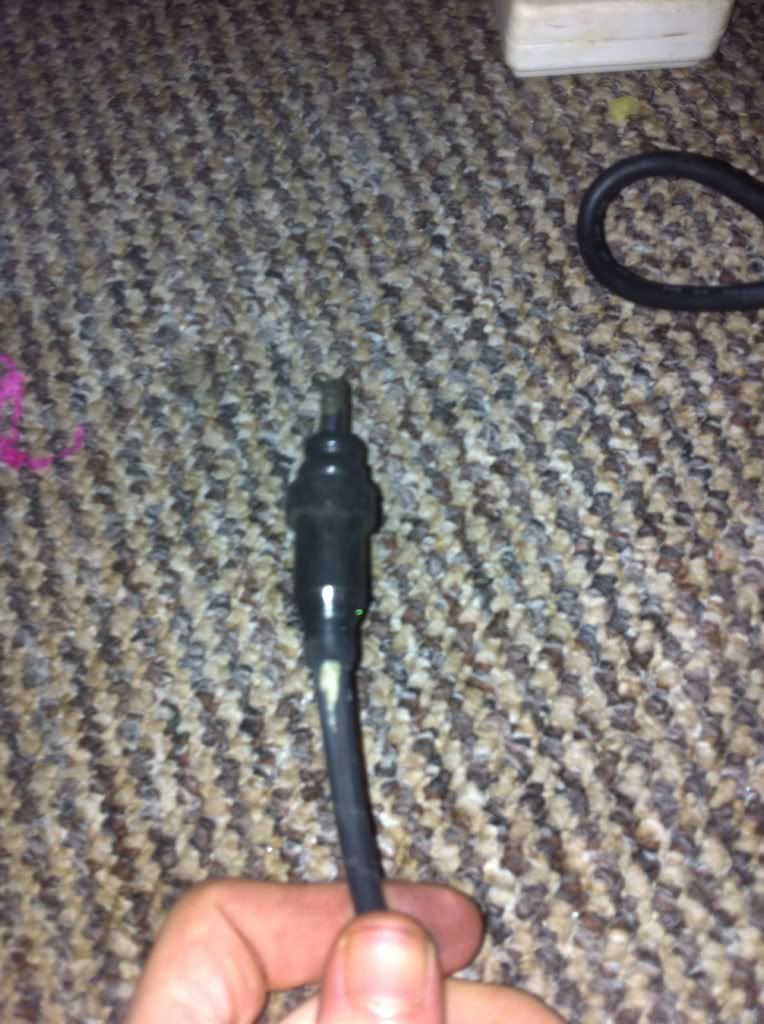

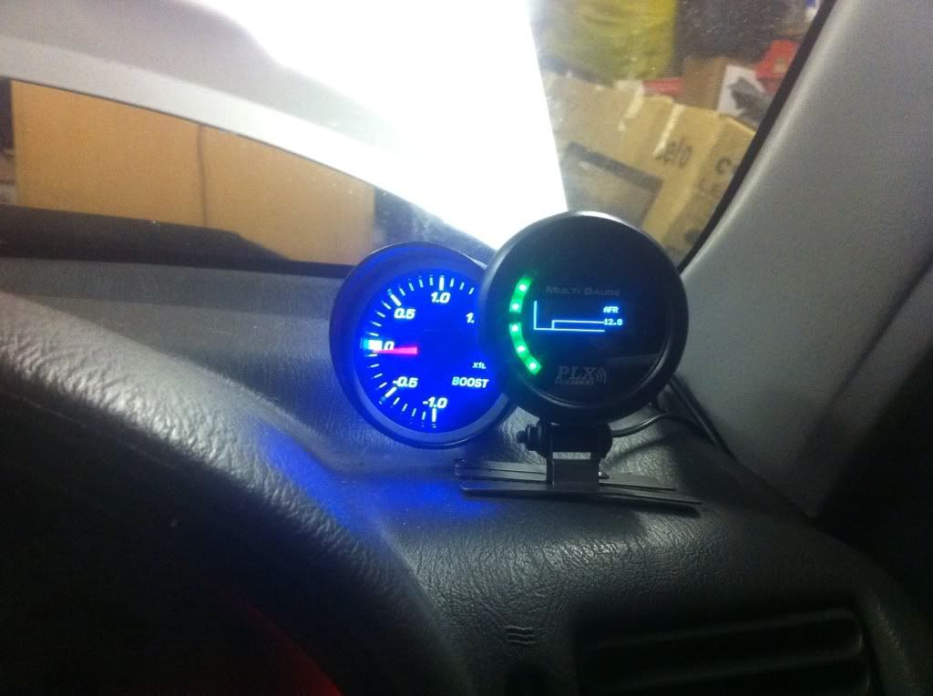

And a plx dm6 wideband multigauge kit
EB1D6AC5-22DE-4A8B-89C5-CB09D69F2200-824
B5ECEB21-3931-441B-8089-0B0367253510-824
Bung welded in
FAD63F1E-E649-49F2-AB1C-976F998D6154-824

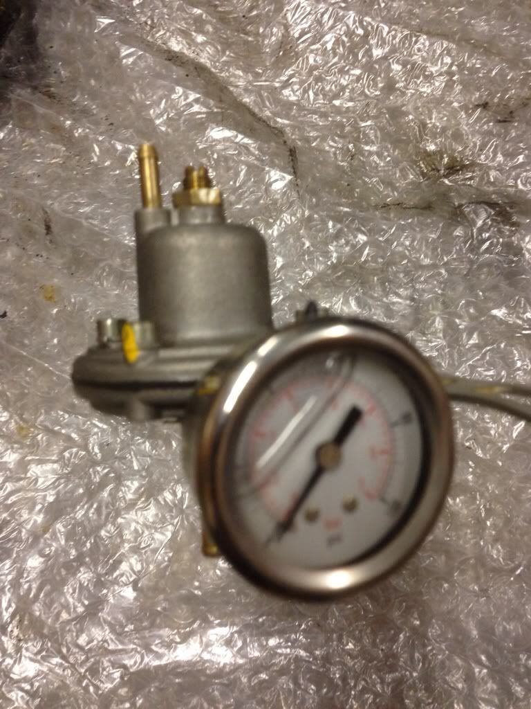

Parts:-

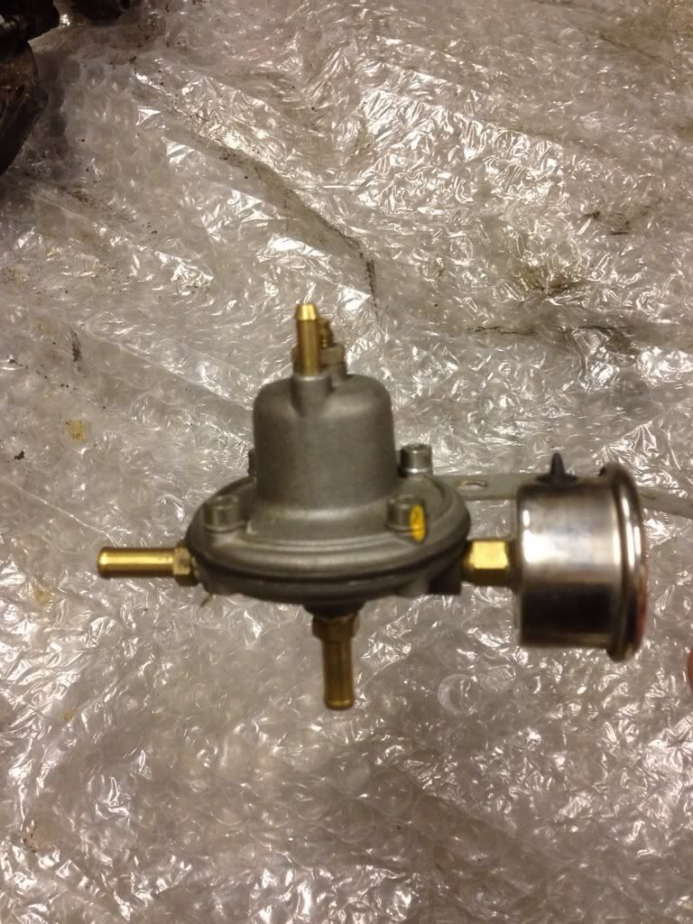

- Fse sytec 1:1 rising rate adjustable fuel pressure regulator.
- jperformance full stainless exhaust system.
- plx systems dm6 multi gauge and wideband module.
- Tuning developments fuel rail adaptor

Liam, I span my wastegate 180 degrees, it was designed so you could cut a small hole in your scoop for it to come through. Got it from eBay the seller was called Ryan-onfire.

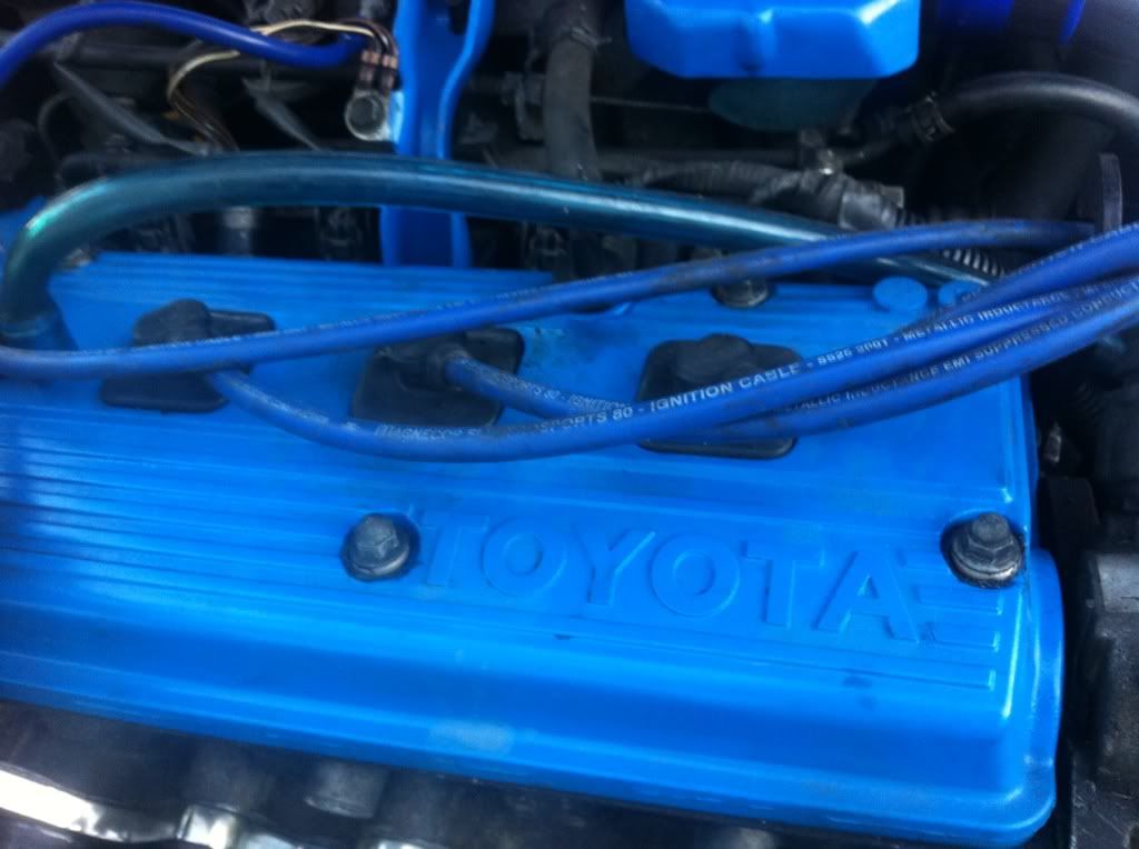

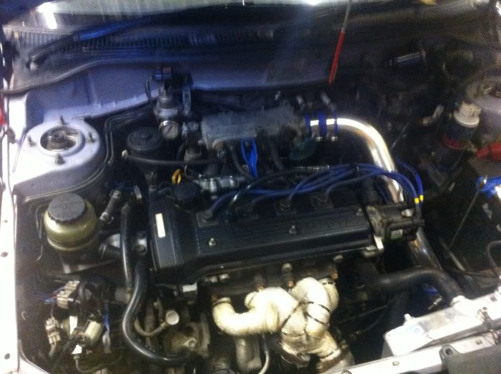

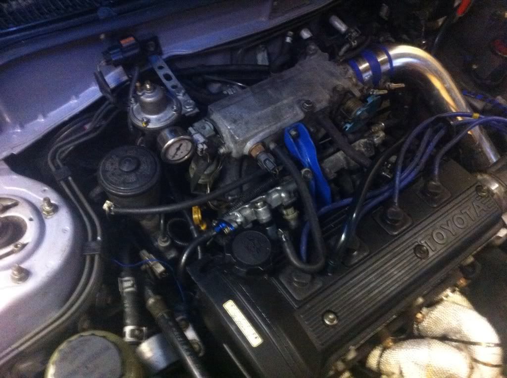

Began fitting them, borrowed a rocker cover from the infamous rbz (cheers) while I began modifying my own and losing the blue that over ran my bay.
Also gave the bay a coat of degreaser and done a wire tuck on my injector rail, and removed my charcoal cannister and vented it below the car.

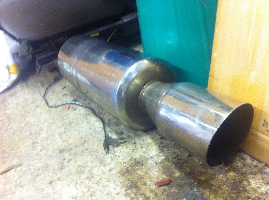

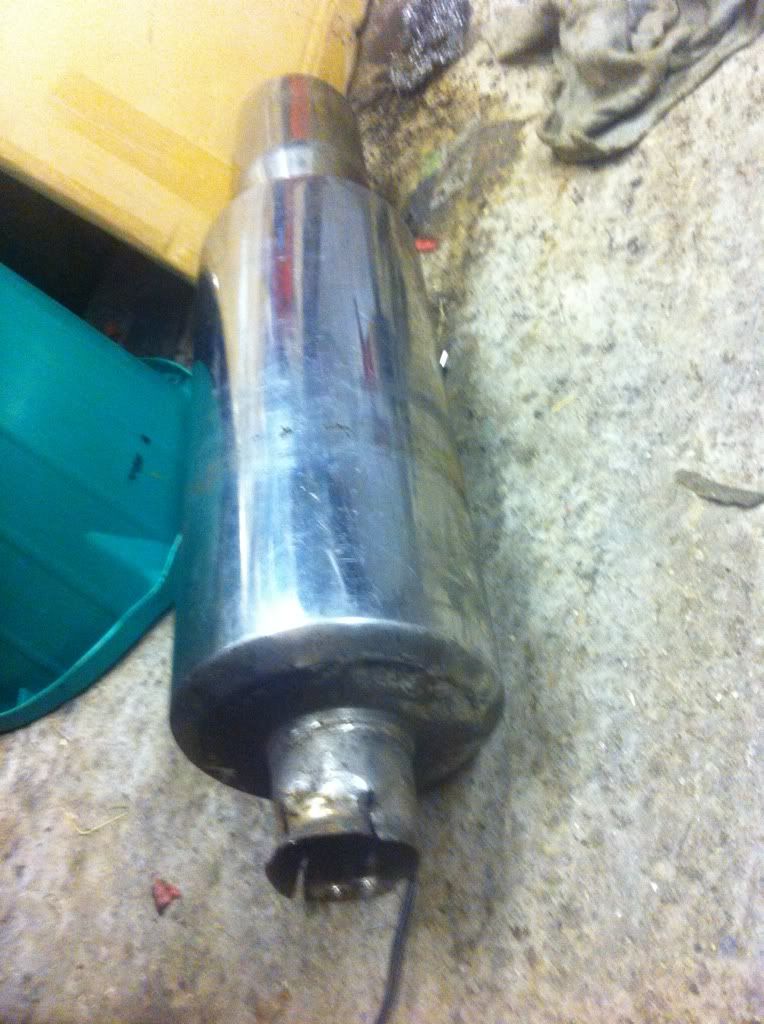

Got rid of this bollocks and the bodge up of an exhaust system too. No pics of the exhaust but it was genuinely a waste of time!

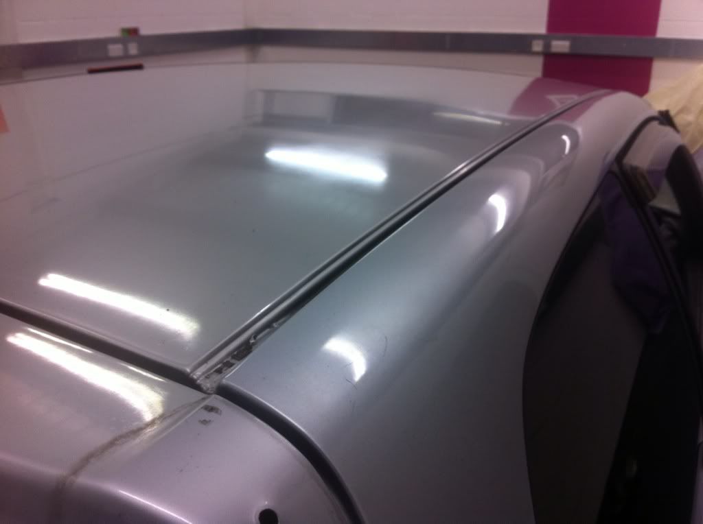

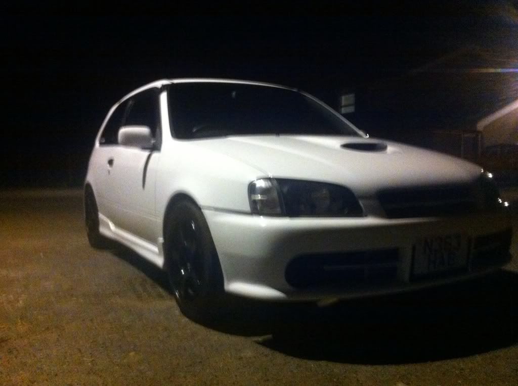

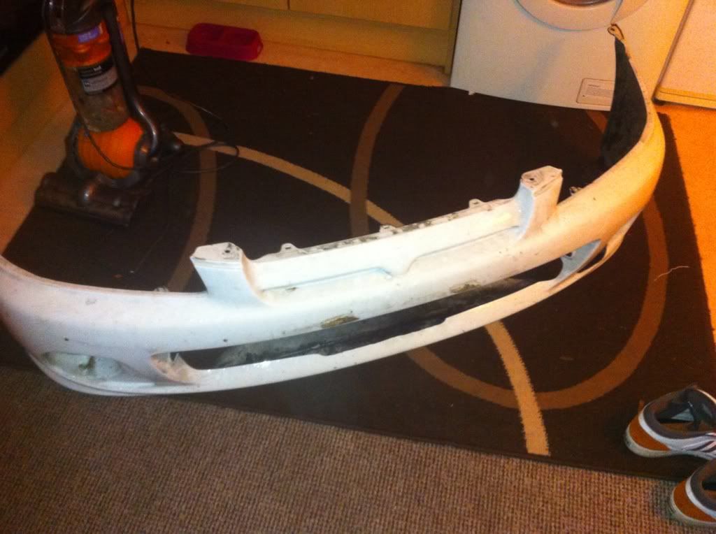

So the time came for a colour change, I didn't have time to get the 98 spec bumper sorted so I filled the glanza badge recess and remove it and dropped it off for the weekend.
Stripped down:
1BD94CAE-269B-4A71-AC07-973B22B91E1A-861
0F35F202-FA52-4022-A5FB-0DF3E612071C-861
B938EB61-7062-4640-A9E3-12CCE7908A9F-861
I left it like this Friday evening and returned to this on Sunday afternoon:
16FA6D4A-2E32-47D0-BF54-648D494D5B82-339
82A2145C-AAB9-4D41-B94B-54337DEAB7C5-339
3D981906-8B3F-4CED-BCC5-A24187B93F0B-339
Car was completely vinyl wrapped in white! Looked amazing Was really impressed!
Also the livesports spoiler was removed and replaced with an oem spoiler and high level brake light cheers hughes21/joe!
