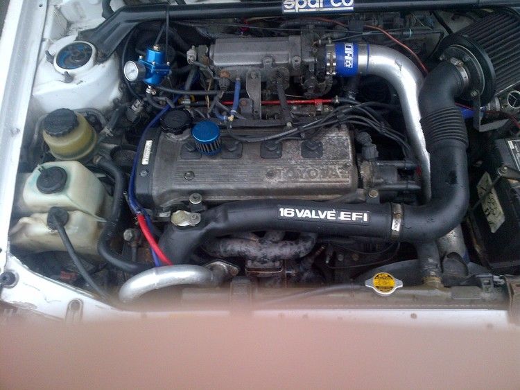

Sandham Posted June 9, 2013 Posted June 9, 2013 (edited) Hi ive just bought a starlet ep82 quadlight and after driving 200 miles home sprung a tiny leak from around the oil feed/return area on the standard ct9 turbo.Does anyone know what i should check and what i need to do to fix the problem?On a tight budget due to having every penny in the car to begin with lol.Found this on ebay and he says he can make the feed lines aswell and provide new banjo bolt kit for the engine side. Is it any good? And will it fit?http://www.ebay.co.uk/itm/110763276589?redirect=mobileThanks. Edited June 9, 2013 by Sandham Quote

TurboTobz Posted June 9, 2013 Posted June 9, 2013 The angle of the turbos altered by the after market manifold thus bearing a strain on the oil feed as it's a fixed fees not a hose, you'll probably not be able to see the leak, only if your under the car or the car with it running you may see it.Take it off plug the ends with your finger fill it up with water and blow through it really hard, you'll see small drips forming around the flange where the hose goes into.Go for a braided hose feed, or do what I did and get a bigger turbo kit instead lol Quote

Fro Posted June 9, 2013 Posted June 9, 2013 As above those lots are good or get a stock replacement which are good.Make sure you get the oil return rubber bend too. No doubt it will crack when you take it off like mine did!! Get a braided feed and not an oem replacement, the oem ones arent much cheaper than the braided one iirc, and after time you will just have the same problem.As someone mentioned, your aftermarket manifold alters the position of the turbo slightly which puts strain on the feed which causes it to crack. You probably wont see the crack very easily cause it will be small, but oil will escape, and quickly! So carefull and not run dry Quote
