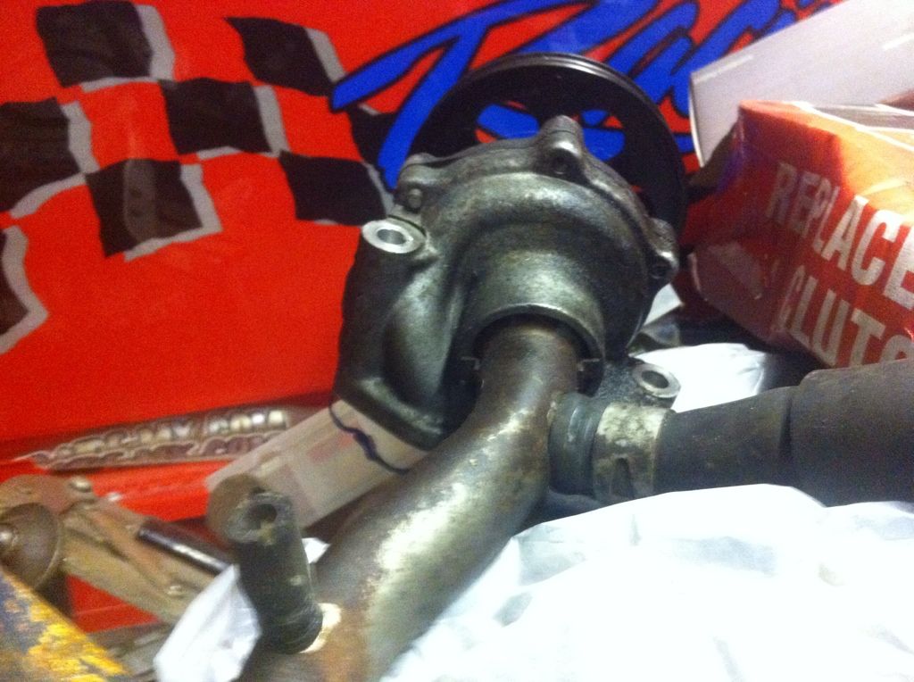

iamlegend Posted June 22, 2013 Author Posted June 22, 2013 (edited) cheers lads i WISH it was the cj performance hoses as every one even mike is putting that to blame then I found this?? any ideas?? its like the rubber is poking out meaning what??? water pump failed.. i have no idea am no mechanic!!! this BULLSHIT IS FUCKING GREAT!! expect to pay what I cant be fucked with!! Edited June 22, 2013 by iamlegend Quote
Lew91 Posted June 22, 2013 Posted June 22, 2013 Looks like the metal pipe has popped out, there should be a bracket on the pipe double check that it's bolted to the block. Quote
yaristurbo Posted June 22, 2013 Posted June 22, 2013 As above little 10mm holds it to block once slide into pump Quote
TurboTobz Posted June 22, 2013 Posted June 22, 2013 I'll get a pic of the back of a water pump and piping it may help Quote
iamlegend Posted June 22, 2013 Author Posted June 22, 2013 (edited) so I take it that needs popping back in or what?? but there is nothing to secure it back in? so has the pump shat it self or what? Edited June 22, 2013 by iamlegend Quote
Lew91 Posted June 22, 2013 Posted June 22, 2013 Pump should be ok, push the pipe back in so you can't see the rubber seal, find a 10mm bolt and pop that back in job done boost till your hearts content Obviously put more anti freeze back in lol would double check the seals in its seat tho. Quote
iamlegend Posted June 22, 2013 Author Posted June 22, 2013 Pump should be ok, push the pipe back in so you can't see the rubber seal, find a 10mm bolt and pop that back in job done boost till your hearts content Obviously put more anti freeze back in lol would double check the seals in its seat tho. so how has this been caused mate? Quote
Lew91 Posted June 22, 2013 Posted June 22, 2013 No 10mm bolt That's if it's not there, I'd double check first tho. Quote
rwdrev Posted June 22, 2013 Posted June 22, 2013 mine did this, but i found the O ring on the pipe had split, obviously not enuf lube. bit of a cock to get at when its built, but very easy fix. Quote
morgey Posted June 22, 2013 Posted June 22, 2013 That pipe should have a bracket on it bolted to the block stopping it from being able to come out like it has.Either the bolts come out or it was never fitted Quote
TurboTobz Posted June 22, 2013 Posted June 22, 2013 The brackets just past the hose that t's off from nearest the pump hold on I got you some pics Quote
iamlegend Posted June 22, 2013 Author Posted June 22, 2013 (edited) Just checked the gasket has sheered of need a new gasket! how do you detach it's stuck in its loose bit doesn't want to come off Ffs So what's happened here?? Bracket been forgot? Also when new gasket is on how does it tight back on? where shall i get a new gasket? this is new so wtf lol Edited June 22, 2013 by iamlegend Quote
Lew91 Posted June 22, 2013 Posted June 22, 2013 I'd imagine the silicone hoses are holding the metal pipe in place, remove the silicone ones and completely remove the metal one. Them replace the O-ring, push the metal pipe back in, replace 10mm bolt (use loctite if your paranoid about losing it again) then reconnect the silicone hoses job done. Quote
