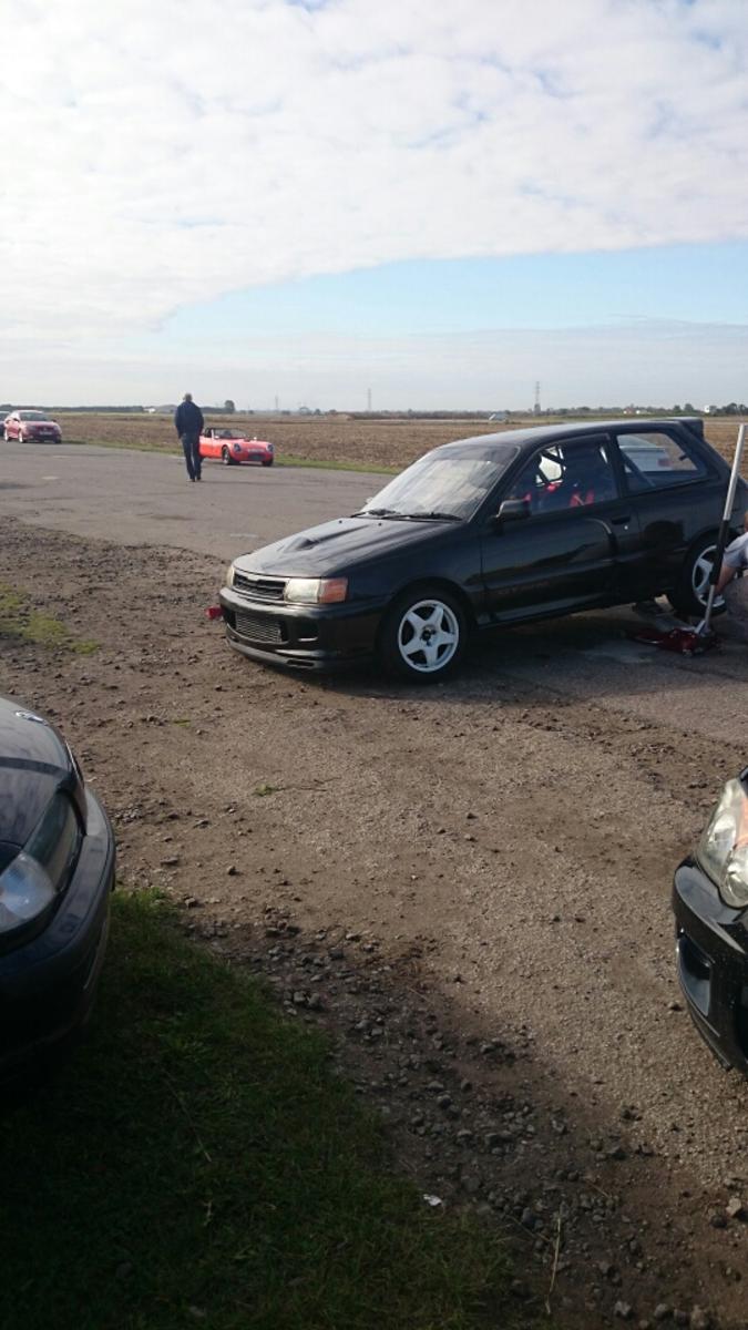

At that moment I was trying to fix the only problem I had all day, and that was bodywork rubbing Tyres when I had a passenger in the car. In the end I just had to go steady whenever I took someone out, some arch massaging is going to be needed.
