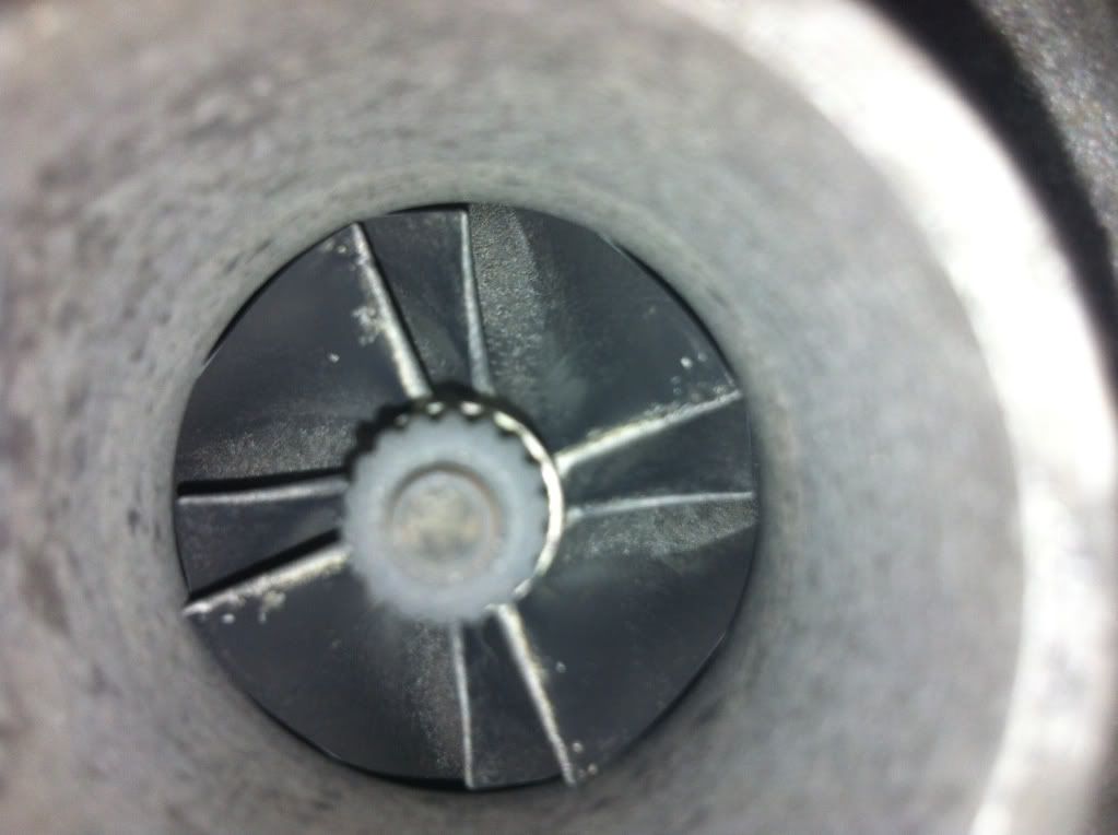

Dan Barnes Posted August 20, 2013 Posted August 20, 2013 When I purchased my car it said it had a hybrid turbo on the spec, I've never checked this as I wouldn't know how to tellHow can I find out if its hybrid or standard ct9?This is my first turbo'd car so don't really know much about them,Thanks in advance. Dan Quote
TurboTobz Posted August 20, 2013 Posted August 20, 2013 Look at the compressor side of the turbo (not the exhaust side, look into the turbo if it have 4 x double blades it's a standard turbo if it has multiple blade it's a hybrid Quote

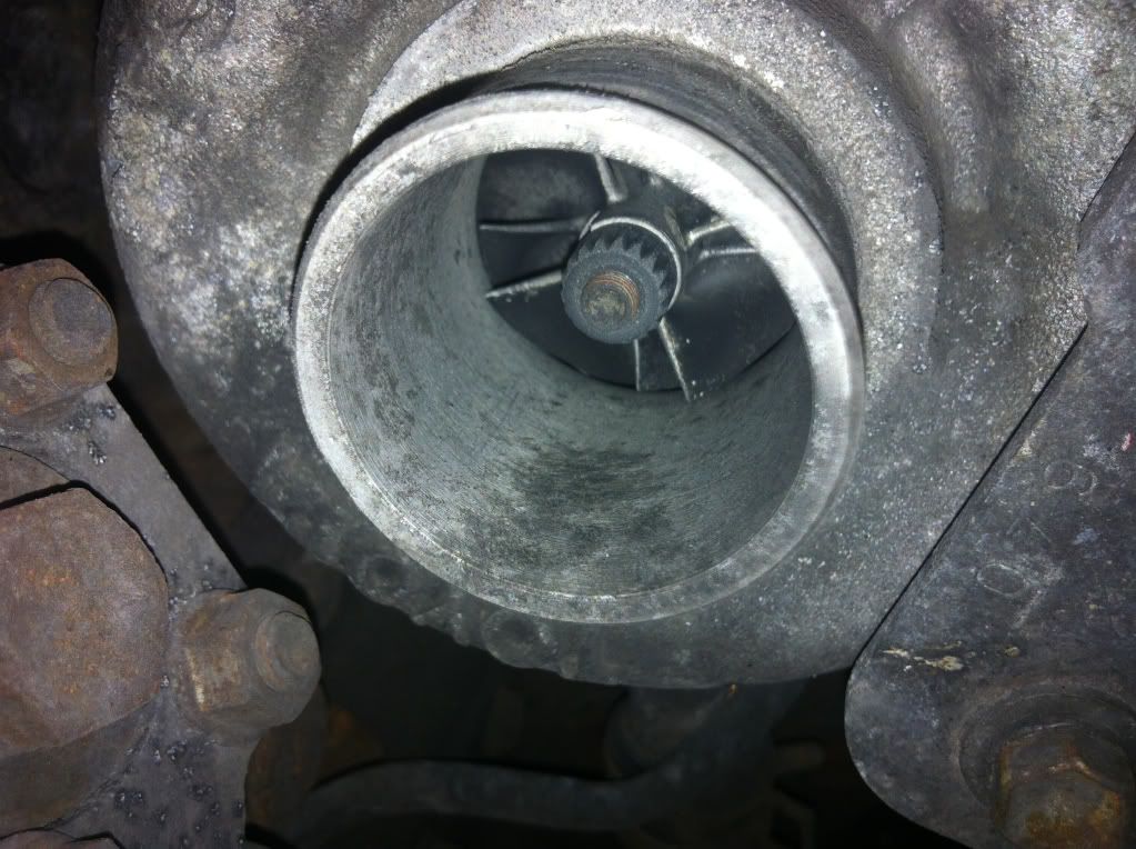

Dan Barnes Posted August 20, 2013 Author Posted August 20, 2013 Will I be able to look at it easily without taking it off? By removing the filter ? Quote
TurboTobz Posted August 20, 2013 Posted August 20, 2013 You can always improvise if not, mirror, phone camera or something if your unsure post a picture up and we'll be able to tell you instantly. Quote
RobSR Posted August 20, 2013 Posted August 20, 2013 (edited) Should be able to have a look with the filter off, power steering pump might be in the way tho Get a pic and post it up if you can. Edited August 20, 2013 by RobSR Quote

Dan Barnes Posted August 21, 2013 Author Posted August 21, 2013 Heres some photos, im guessing its just standard ct9Cheers Dan Quote

mikey4410 Posted August 21, 2013 Posted August 21, 2013 yea thats a standard tuby mate.with regards to your last comment thats a bit of boost creep Quote
Dan Barnes Posted August 21, 2013 Author Posted August 21, 2013 What's boost creep pal ? And yeah that's gutting :/ dont know why people have to lie when selling a car Quote
