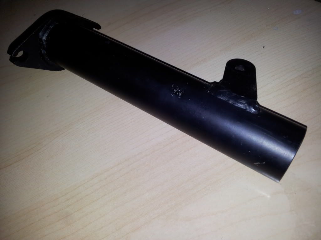

daniel_g Posted September 13, 2013 Posted September 13, 2013 This is my screamer, yet to be fitted. Quote

daniel_g Posted September 15, 2013 Posted September 15, 2013 (edited) They do sound awesome at full chat You'll need a new manifold with capabilities for an external wastegate, ie flange on it at the collector. The external wastegate itself, a screamer pipe, and you'll need the wastegate penny welded up on your existing turbo. And ofcourse gaskets etc. Basically a new turbo setup Edited September 15, 2013 by daniel_g Quote
