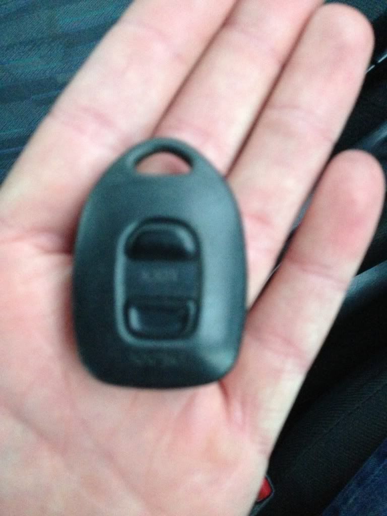

Ollieh17 Posted October 10, 2013 Posted October 10, 2013 Was told its for a glanza but having major ball ache programming it Quote
Ollieh17 Posted October 10, 2013 Author Posted October 10, 2013 Bought it from japan and it said it was for a glanza. I can't even get the car to do the key fob cycle thing Quote
Ollieh17 Posted October 11, 2013 Author Posted October 11, 2013 anyone else experienced one of these? Quote

Ollieh17 Posted October 11, 2013 Author Posted October 11, 2013 yeh shoulda got one direct from, tried to save some money by buying from japan. Don't think its suited for a glanza . Ended up wasting money ! Quote
corofin12345 Posted October 11, 2013 Posted October 11, 2013 did you try this procedure?? Unlock car.Sit in drivers seat, shut door.Put key in the ignition, turn key to on then off 3 times.Remove key and press the button on the new keyfob.Central locking should operate.Put the key back in the ignition and turn on/off again 3 times.Once again remove and press the new keyfob buttonCentral Locking should operate again. Quote
Ollieh17 Posted October 11, 2013 Author Posted October 11, 2013 yupp tried this along with another method i read Quote
fremyjay Posted October 11, 2013 Posted October 11, 2013 it might of come off a glanza, but i bet that the alarm wasnt standard Quote

Ollieh17 Posted October 14, 2013 Author Posted October 14, 2013 mines definitely got remote central locking, looks like the key fob is OEM toyota,so either the guy was lying and it doesn't work with a glanza. Or im missing something, Quote
corofin12345 Posted October 14, 2013 Posted October 14, 2013 im sure the OEM glanza fob can still be got in toyota.. parts number is: 89742-10010 Quote
Ollieh17 Posted October 14, 2013 Author Posted October 14, 2013 yeh it can. Its like £40 i think, this one only cost me £8 so was hoping it worked and saved me a bit of money Quote
corofin12345 Posted October 14, 2013 Posted October 14, 2013 may be worth borrowing someones fob to see if you car will except it.. its easy to program them on any glanza... my old fob is now on its 4th glanza since i sold it and god knows how many before i had it Quote
