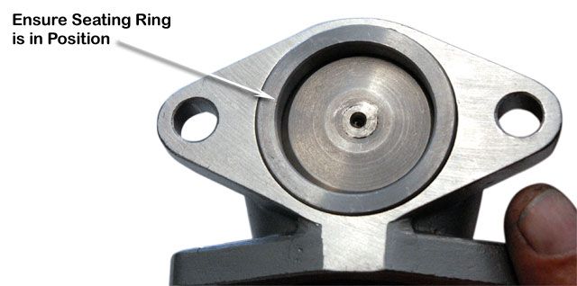

Beastmode panda Posted November 25, 2013 Posted November 25, 2013 Have you got the metal ring on the wastegate? Quote
Mikeyallgood85 Posted November 25, 2013 Author Posted November 25, 2013 Have you got the metal ring on the wastegate? sorry for sounding dim but what metal ring are you talking about? Gasket? Quote

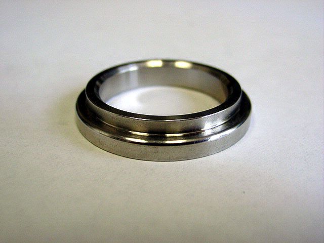

Beastmode panda Posted November 25, 2013 Posted November 25, 2013 sorry for sounding dim but what metal ring are you talking about? Gasket? Don't be sorry haha . Here mate; And this is the ring. The car simply won't boost without the ring in there. If it's a vacuum leak big enough to stop the car boosting at all then you'll 110% hear it! Quote
Mikeyallgood85 Posted November 25, 2013 Author Posted November 25, 2013  Don't be sorry haha . Here mate;  And this is the ring.  The car simply won't boost without the ring in there. If it's a vacuum leak big enough to stop the car boosting at all then you'll 110% hear it!I see lol :-) I'll check it when I get home from work! I thought the same as you with regards to a boost leak it would basically have to be a large one to not have any boost but I'm going to be checking everything hopefully it's something simple Quote
Beastmode panda Posted November 25, 2013 Posted November 25, 2013 I see lol :-) I'll check it when I get home from work! I thought the same as you with regards to a boost leak it would basically have to be a large one to not have any boost but I'm going to be checking everything hopefully it's something simple It always is something simple mate when something like this happens! Let me know tonight how you get on and i'll try and help as much as I can. Quote
