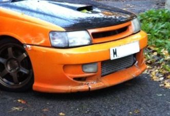

Dean_mc88 Posted January 24, 2014 Posted January 24, 2014 I have a genuine toms front bumper and cant let go of it haha im going to repair it its in a bad way, whole bits come off so its a big job and any advice on fiberglass repair would be great cheers Quote
Dean_mc88 Posted January 24, 2014 Author Posted January 24, 2014 This is what it looked like at its best it's a lot worse now Quote

Starbuck Posted January 24, 2014 Posted January 24, 2014 You could stitch the pieces together with tie wraps then fibre glass sheet repair the rear. Then when cured sand of the stitches at the front. Fill, sand, fill some more , sand some more etc etc etc. Quote

akyakapotter Posted January 25, 2014 Posted January 25, 2014 Fiberglass kit fiberglass bridging filler dolphine glaze high build primer jobs a gooden Quote
