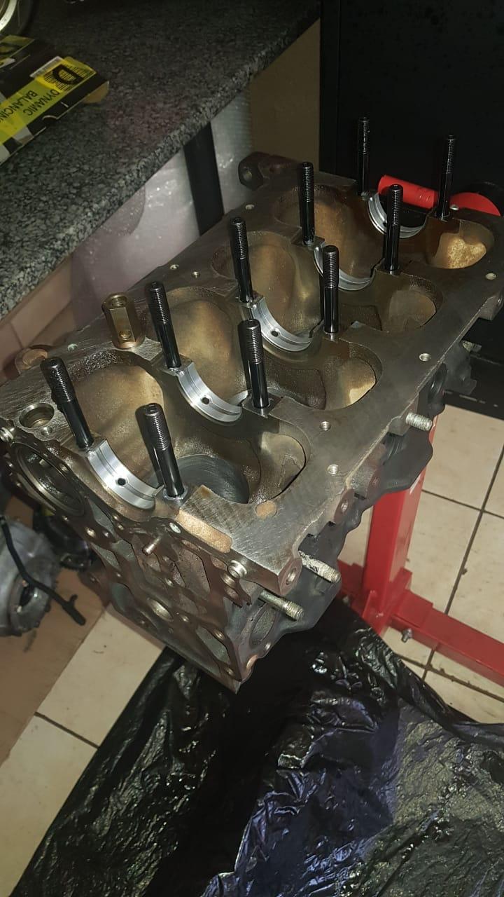

Faiyaz.123 Posted November 11, 2017 Author Posted November 11, 2017 (edited) Need some info I've tried looking it up .but can' seem to get a spot on answer. I have 74.5mm wiseco pistons with scat rods and head work done including Billet camshafts 8.8-9.0mm lift and 272 degrees duration im trying to do a compression test and my results are showing 8.1 which is about 125 psi across all cylinders Abit puzzled where I'm going wrong any help would be highly appreciated Edited November 11, 2017 by Faiyaz.123 Quote

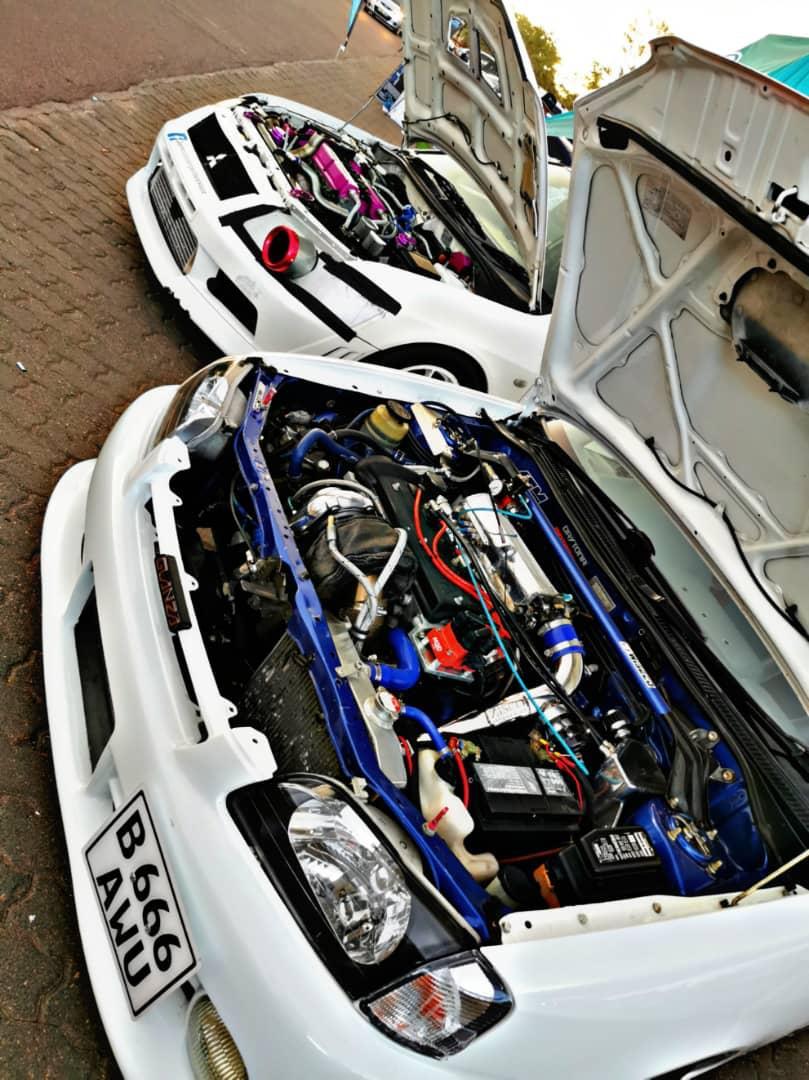

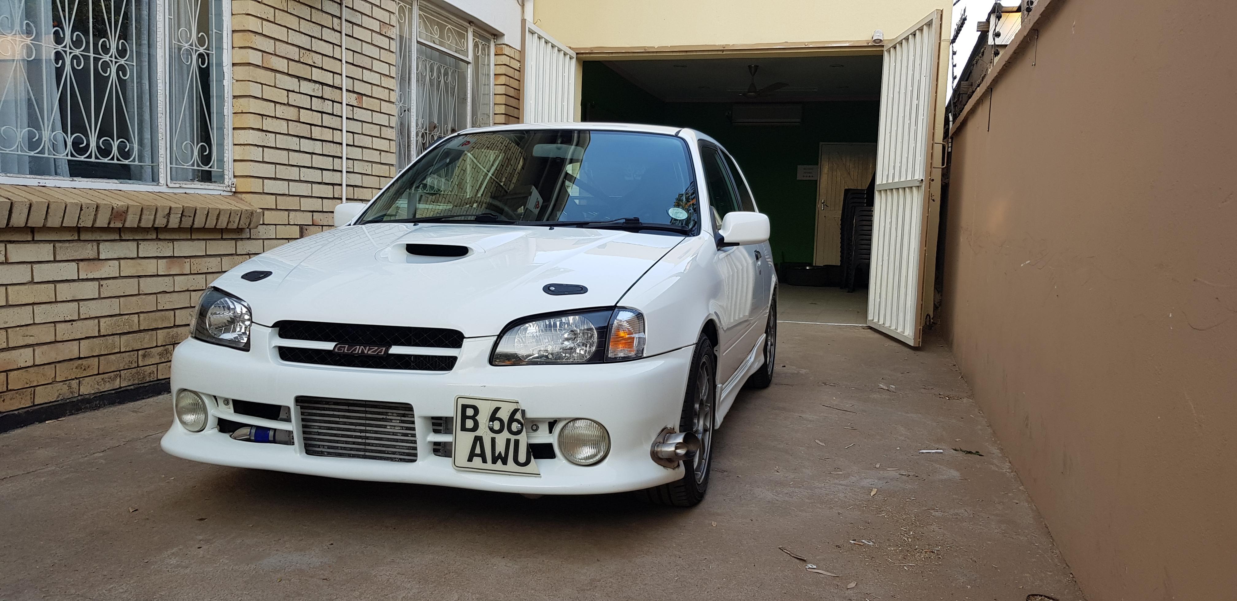

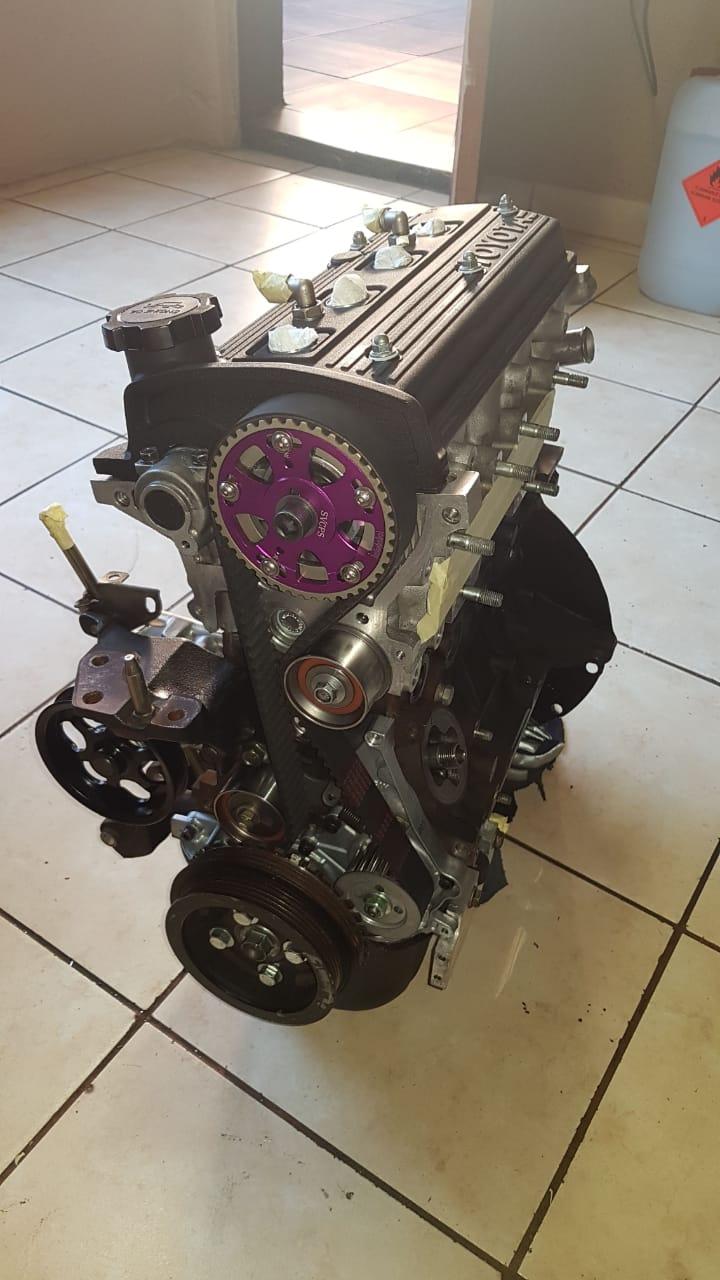

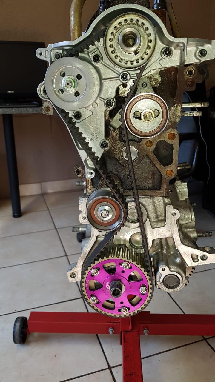

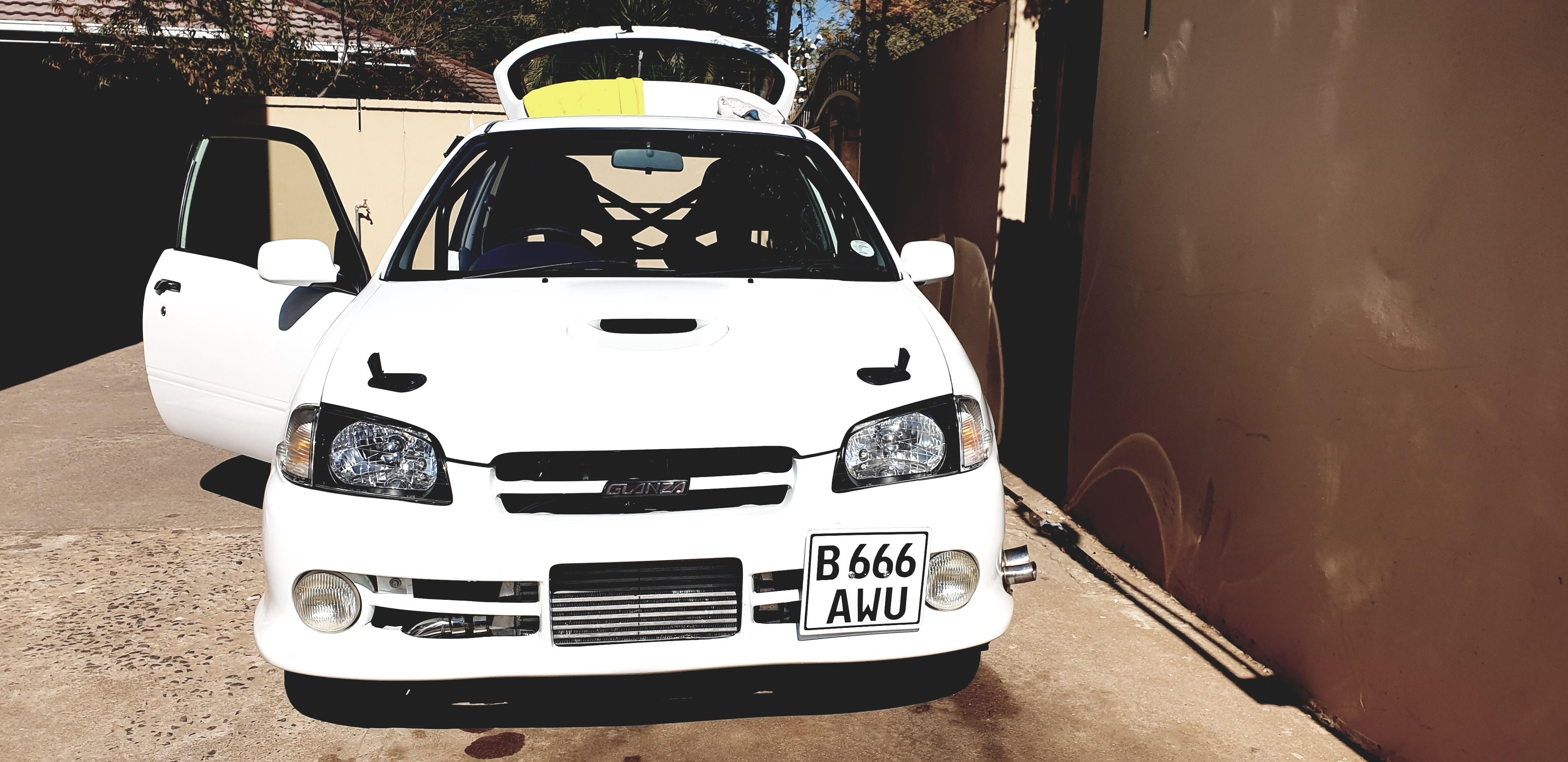

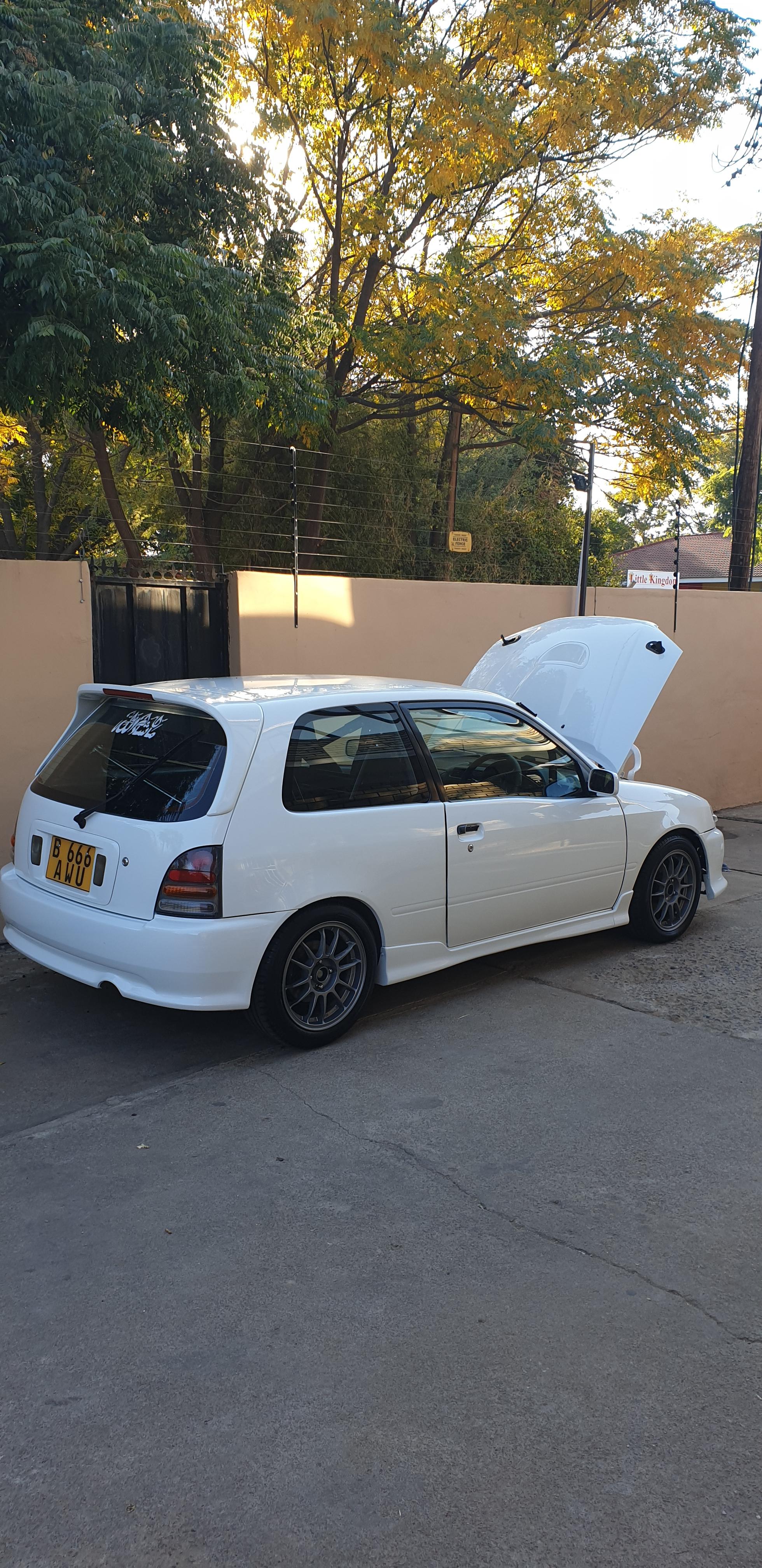

Faiyaz.123 Posted July 17, 2020 Author Posted July 17, 2020 (edited) So maybe it's time a update this . After my fall down with my previous 4efte engine bending the crank (don't know how) I've gone 5e will post some pics currently running .I've stopped at 1bar of boost and rev limit at 8krpm .gearbox doesn't seem like to like it but yeah we know there's no alternative to it hence why I lost interest in it. I've gone side exit its fun even though the person stuck it out the bumper instead of it sitting flush . Currently trying to figure out out why my p/s belt keeps splitting its a 4efte p/s am I using the wrong length or is there a spacer to be added. Help would be appreciated. I think this is my stopping point before I ended selling or stripping. VID-20200628-WA0006.mp4 Edited July 17, 2020 by Faiyaz.123 Quote
