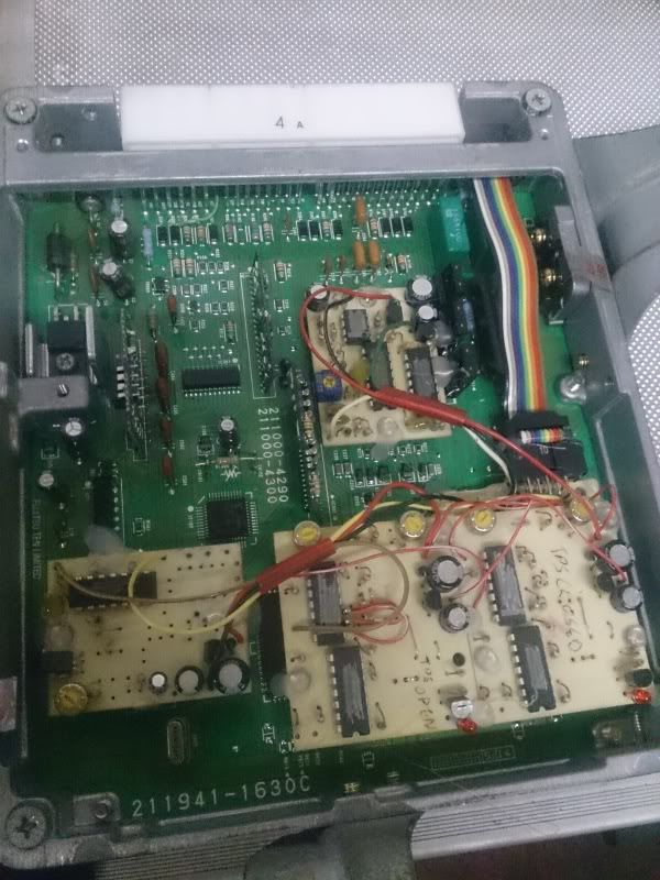

karl. Posted April 25, 2014 Author Posted April 25, 2014 A bit misleading as title says "auto ecu in manual", first sentence says "aftermarket ecu for a Auto Glanza" and then "once the manual one is fitted again it lights up fine". So are you trying to run an automatic Glanza with a manual ecu or vice versa? :-D Lol fair enough, What I'm trying to do it fit an aftermarket auto ecu into a manual Glanza. Maybe there is a fault with the ecu or something I cant get my head around whats wrong with it. Heres a picture of inside it. Quote
karl. Posted April 25, 2014 Author Posted April 25, 2014 As you can see there is settings for tps open and tps closed. There is 6 points of adjustment that I can see, I will need to see what pins on the ecu these are connected to to see exactly what they do. Quote
