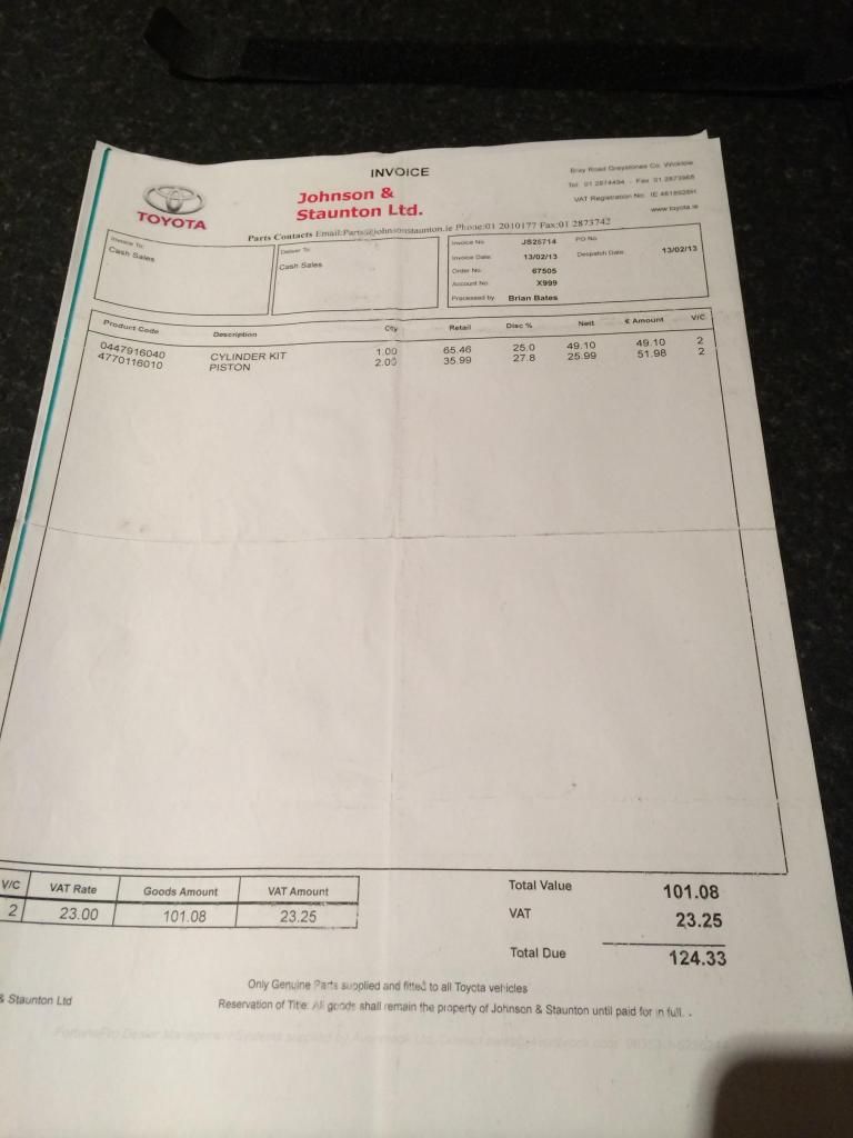

matty gt Posted September 2, 2014 Posted September 2, 2014 here the price in my local turned up nice Quote
morgey Posted September 2, 2014 Posted September 2, 2014 Did you get the caliper for that price or the piston a rebuild kit? Quote
