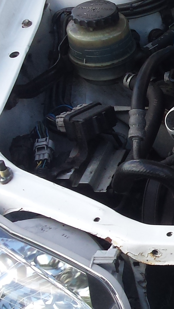

Turbo Goose Posted November 8, 2014 Posted November 8, 2014 Hi guys, im removing my abs today and wondering if this electronic unit on top of the abs block can be completely removed?Thanks guys Quote
Ollieh17 Posted November 8, 2014 Posted November 8, 2014 Yup all that comes off, did mine the other day Quote

Turbo Goose Posted November 12, 2014 Author Posted November 12, 2014 Ive just done mine and engines still out so will take some pics. Literally takes 2 T pieces, sum copper tube and like 8 end fittings. So easy to do Quote

daniel_g Posted November 12, 2014 Posted November 12, 2014 I removed to ABS on my old GT, made up a kit for about 15 quid or something.This is a great diagram from WallaceGlanza Quote
karl. Posted November 12, 2014 Posted November 12, 2014 Thanks very much for that Daniel, I will make my own kit up if I ever have my engine out. Quote
Butchysr Posted November 12, 2014 Posted November 12, 2014 That's a good pics got every think ordered now thanks everyone :-) Quote
Turbo Goose Posted November 12, 2014 Author Posted November 12, 2014 It can be done without the big block to the bottom right of the pic. Just 2 T pieces.ill post pics tomoz Quote
daniel_g Posted November 12, 2014 Posted November 12, 2014 It can be done without the big block to the bottom right of the pic. Just 2 T pieces.ill post pics tomozThats the brake compensator valve, best to leave that in place. Quote
Ollieh17 Posted November 12, 2014 Posted November 12, 2014 It can be done without the big block to the bottom right of the pic. Just 2 T pieces.ill post pics tomozI think the kits rely on that still being there though? Quote
Turbo Goose Posted November 13, 2014 Author Posted November 13, 2014 Meh i took mine out think a few others have as well. Does it balance between front and rear brakes? Quote
WallaceGlanza Posted November 13, 2014 Posted November 13, 2014 Meh i took mine out think a few others have as well. Does it balance between front and rear brakes? Yup, gonna be a bit crap without that! Quote
Turbo Goose Posted November 13, 2014 Author Posted November 13, 2014 Ill just get a manual one and pop it on the rear brake line. Get her on the rollin road at mot and get it set Quote
