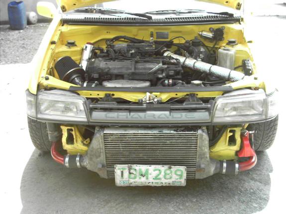

pockrockgtti Posted January 5, 2006 Posted January 5, 2006 Was looking on the net for 4efte conversions, and was suprised to find that someone has transplanted a 4efte into a g100 charade, im am now considering doing the same with my Charade GTti, i dont wanna follow the crowd. Id like to have something a little diffrent. what do you guys think? Quote
scutch0 Posted January 6, 2006 Posted January 6, 2006 jeez!! nutcase!!!!i thought the old 3cyl gtti engine was virtually indistructable?? i guess the 4efte is a nice little upgrade, and has the parts out there to get 300bhp out of it!!its surprising how well it fits!!Rich. Quote
pockrockgtti Posted January 6, 2006 Author Posted January 6, 2006 The little 993c engine is indestructible but, realisticly only 180bhp is achievable from the little 3cyl monster, 200bhp is possible but requires a throttle body conversion which is a bit of a hassle. Quote

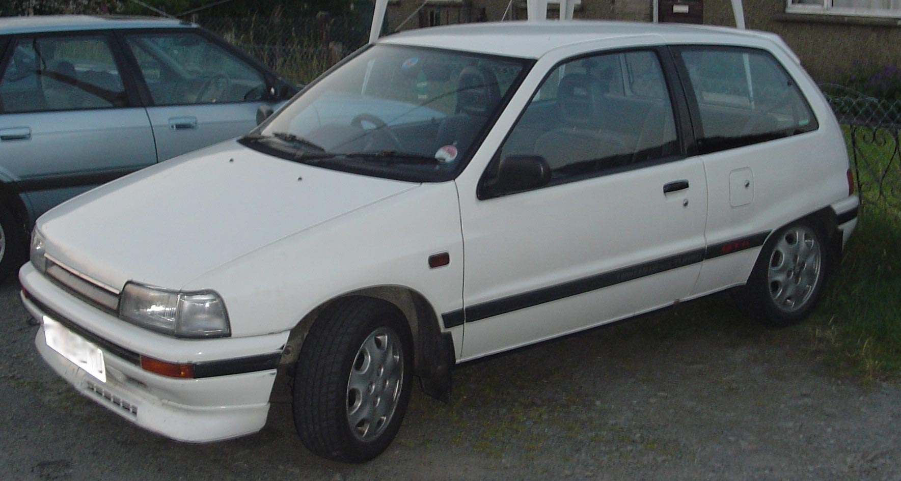

pockrockgtti Posted January 6, 2006 Author Posted January 6, 2006 Here's my ride , its a nice example of a charade, the shell tends to rust easily, but mine hasent. its only got a slight bubble on the rear, driver side arch.Here are the list of mods:Lowered 35MM.Dump Valve.Blue Flame 2 1/2" exhaust system with a 3 1/2" tailpipeCustom Made Iduction kit.Blitz Turbo Timer.Polybush Kit.After puting on the exhaust system i had to take the induction kit off, and replace it with an replacment element filter. This was because the turbo was spooling up 2 fast because of such good flow, and the boost pressure was creeping up because the wastegate couldnt cope, and the fuel cut was eventually kicking in at 12.5 psi. I plan to drill out the wastegate in a few weeks time and get the induction kit back on. I estimate it to have about 110-115bhp now, i also plan to invest in a set of alloy wheels in a couple of weeks too. I tryed to put a set of speedlines on my car off of 'llawgoch' starlet sr, but the bore wasent big enough and they wouldnt fit. Quote
