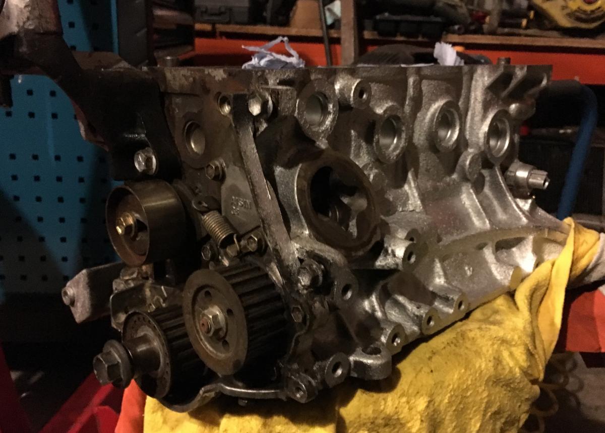

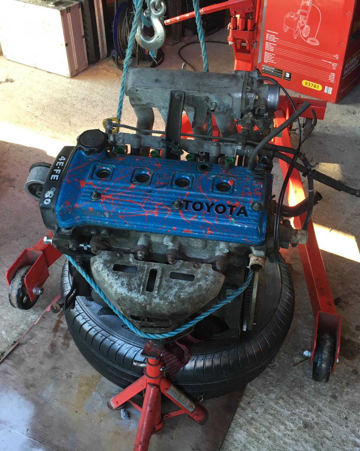

SpikeyJp_68 Posted November 27, 2016 Author Posted November 27, 2016 Got engine #2 yesterday to save me taking my one out. Started like this And is now stripped to just the block & crankshaft. Will take the crank pulley off tomorrow at work becuase my impact decided to pack in. Plan from there is to clean it as much as possible, hone the cylinders, measure my crank journals( big & main) then it can be snuck inside (for a clean environment) and built up after that. As for the head, I'll be doing the valve stem seals and I've bought some valve lapping paste and a stick so the valves will be reseated aswell. Will be resurfaced before going on. I'd upload some more pics but it says each file is limited to 2MB which I've never had before or at least I don't remember it Quote

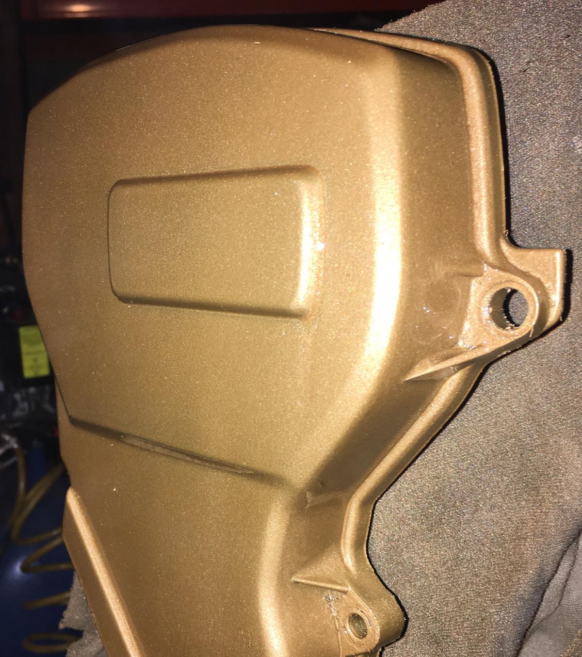

SpikeyJp_68 Posted November 28, 2016 Author Posted November 28, 2016 Ended up with runs the last time I painted it.. take 2Hopefully it'll end up the same colour as my cam cover Quote
EP70-PT Posted November 29, 2016 Posted November 29, 2016 better now mate tbh, the other one was messy Quote

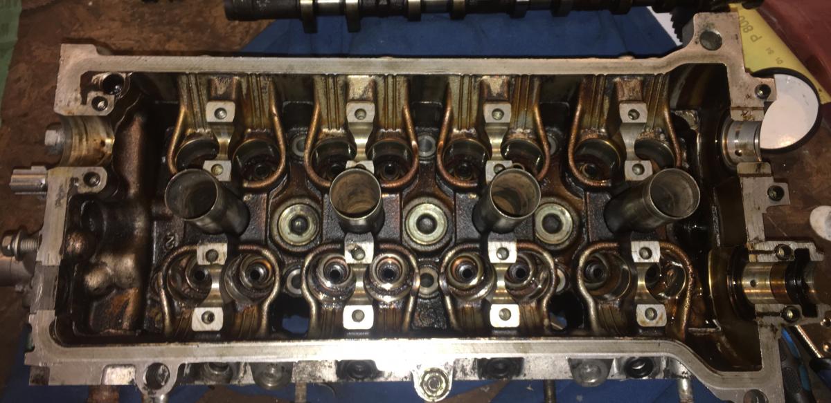

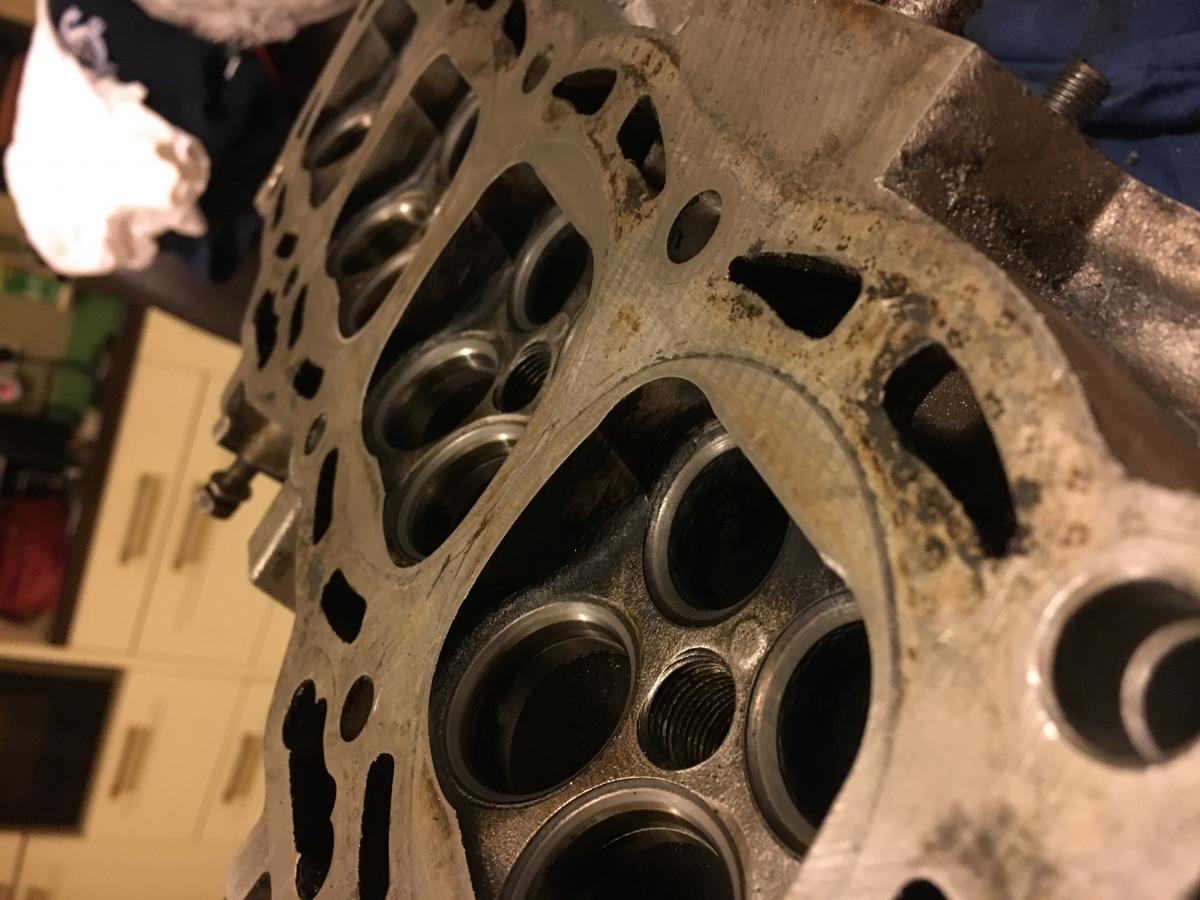

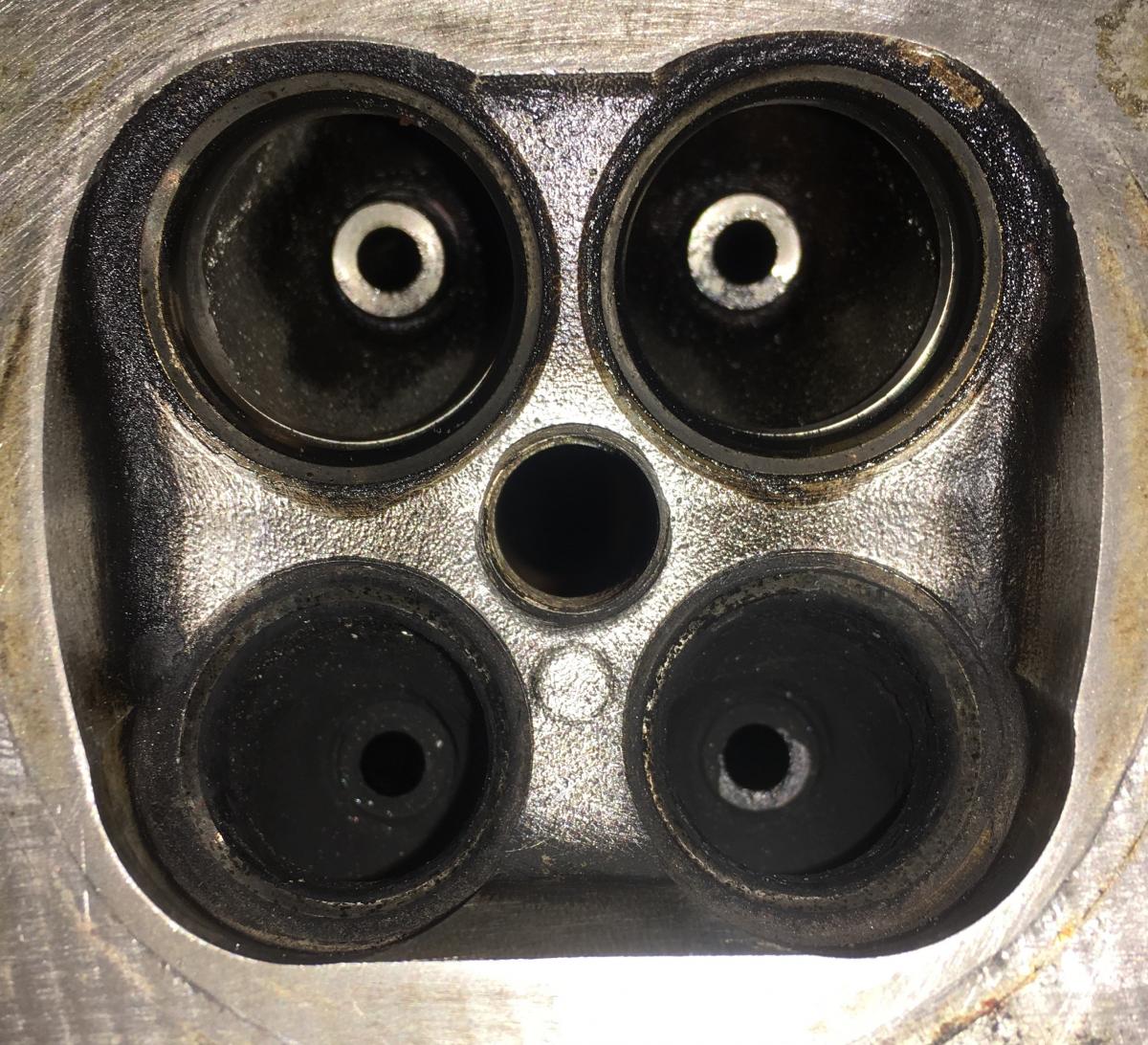

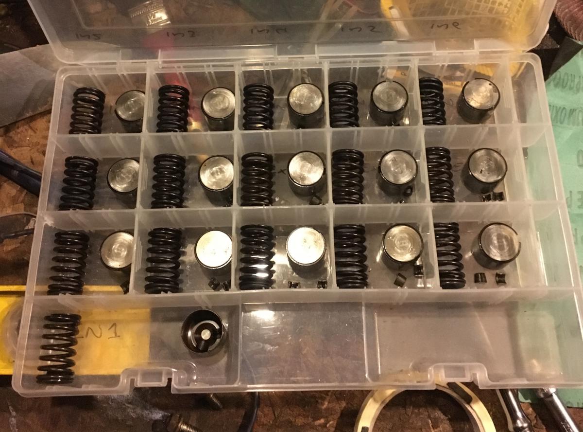

SpikeyJp_68 Posted November 29, 2016 Author Posted November 29, 2016 Head work has begun..Plan on cleaning the valves tomorrow at work then I'll have to wait for the die grinder I bought to arrive so I can smoothen the inlet and exhaust passages along with the combustion area. Then I'll reseat the valves and then send it off to the machine shop to be skimmed and re-assembled Quote
5e colin Posted November 29, 2016 Posted November 29, 2016 dont for get to port match the inlet to 1s your at it Quote
SpikeyJp_68 Posted November 30, 2016 Author Posted November 30, 2016 dont for get to port match the inlet to 1s your at it will be going that aswell Colin Quote

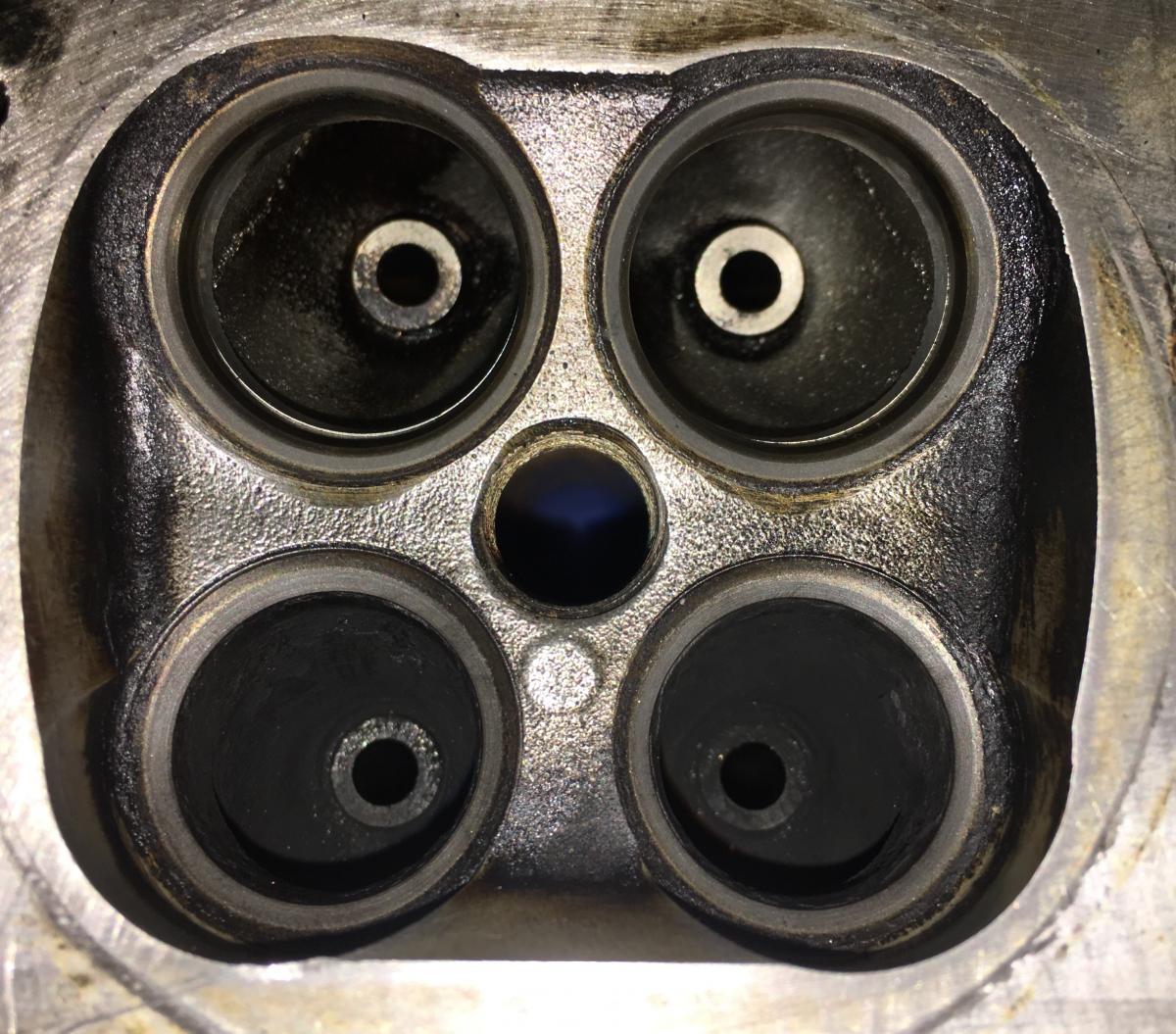

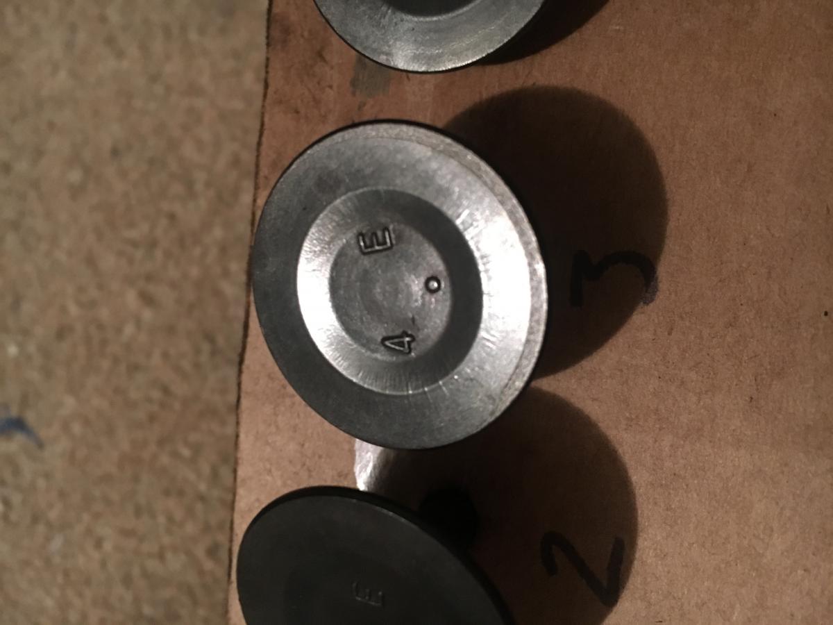

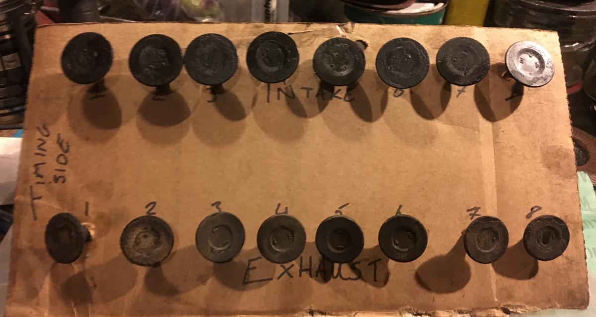

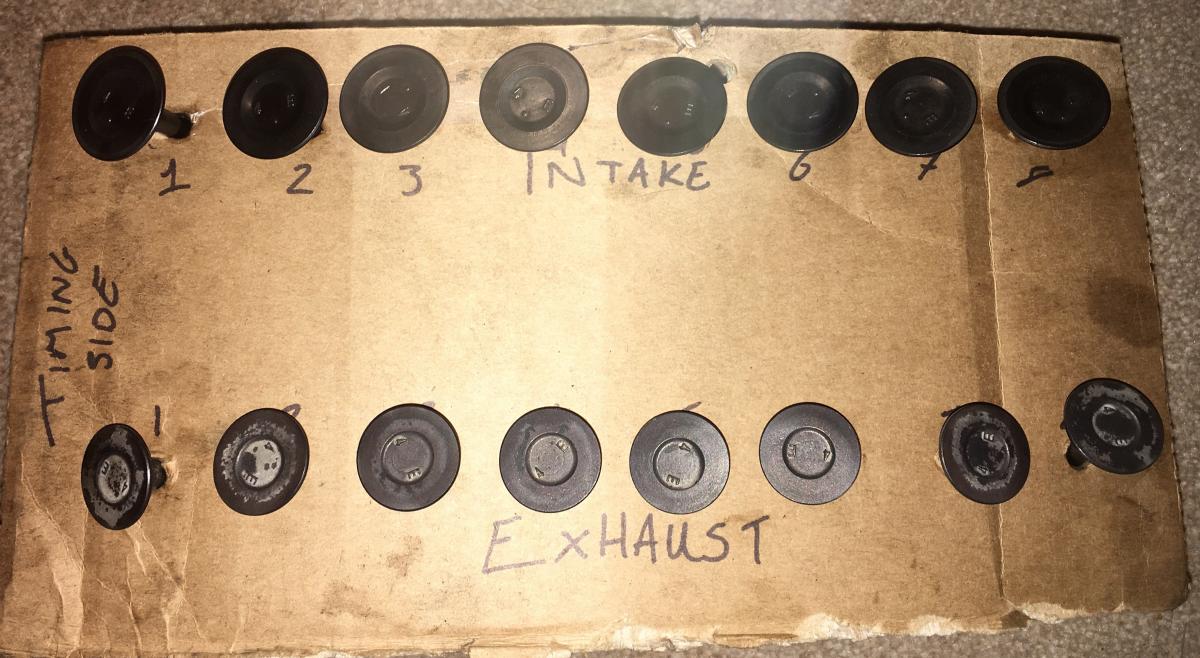

SpikeyJp_68 Posted November 30, 2016 Author Posted November 30, 2016 Valves have been cleaned. Might start reseating them tomorrow Quote
5e colin Posted November 30, 2016 Posted November 30, 2016 have fun joe tik tak tik tak ha ha check the time when you start and when you are fully seated on1 off the valve as in the other thread there going by minutes by hand takes me 10 with the drill left right left right Quote
SpikeyJp_68 Posted December 1, 2016 Author Posted December 1, 2016 have fun joe tik tak tik tak ha ha check the time when you start and when you are fully seated on1 off the valve as in the other thread there going by minutes by hand takes me 10 with the drill left right left right I'll let you know about time and the condition of my hands Quote
EP70-PT Posted December 2, 2016 Posted December 2, 2016 Aren't you going to ruin the valve seats with the die grinder now? Good job on them, how long? Quote
SpikeyJp_68 Posted December 2, 2016 Author Posted December 2, 2016 Aren't you going to ruin the valve seats with the die grinder now? Good job on them, how long?I'll have to go over them again with some fine grit for 2-3 mins per valve. Took about 2 and a half hours. Exhaust valves were badly pitted Quote

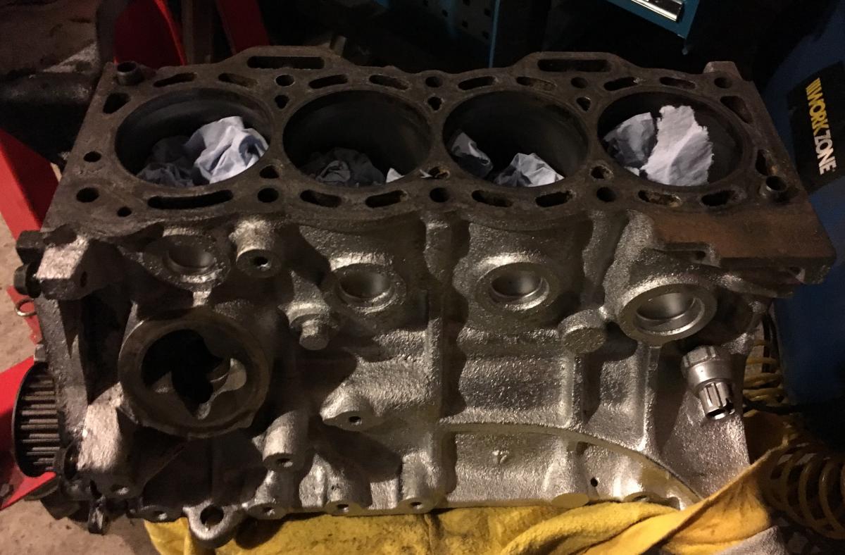

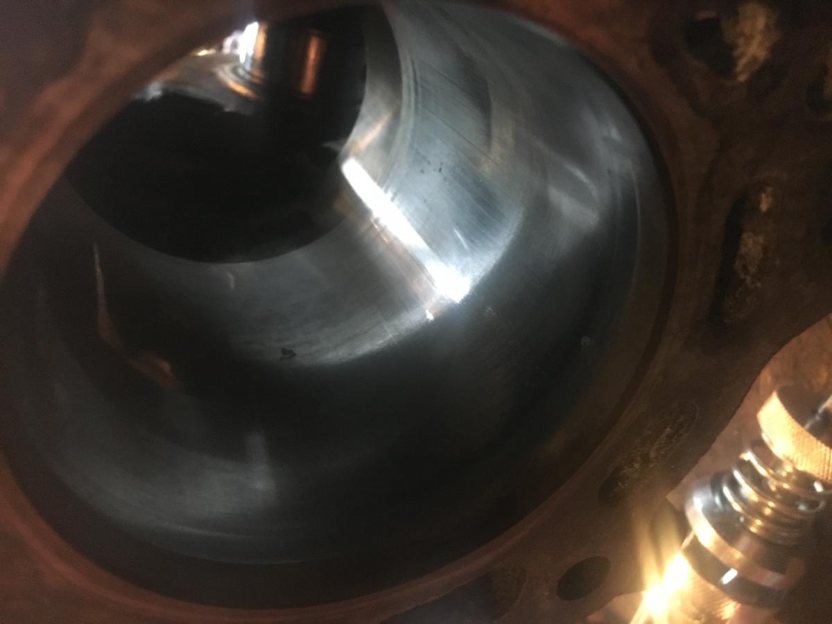

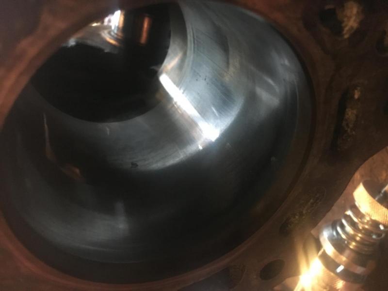

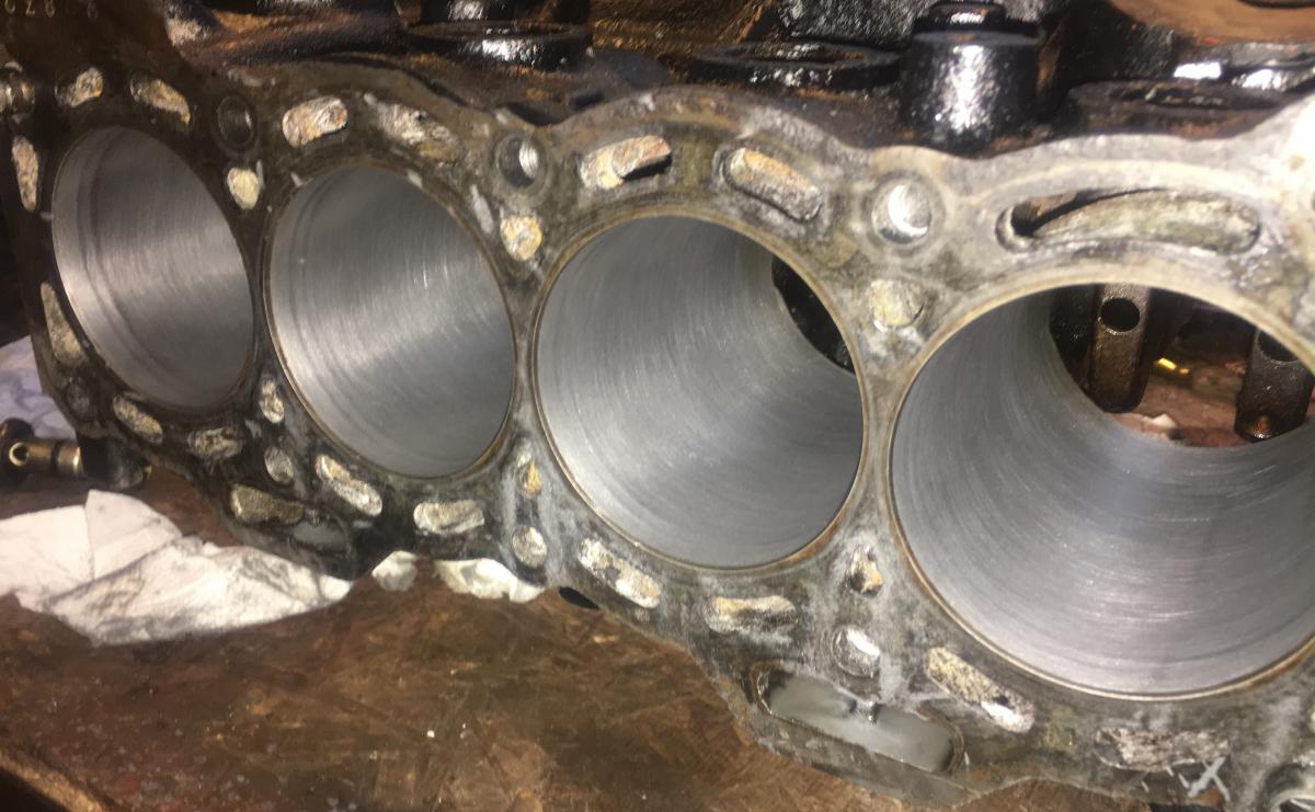

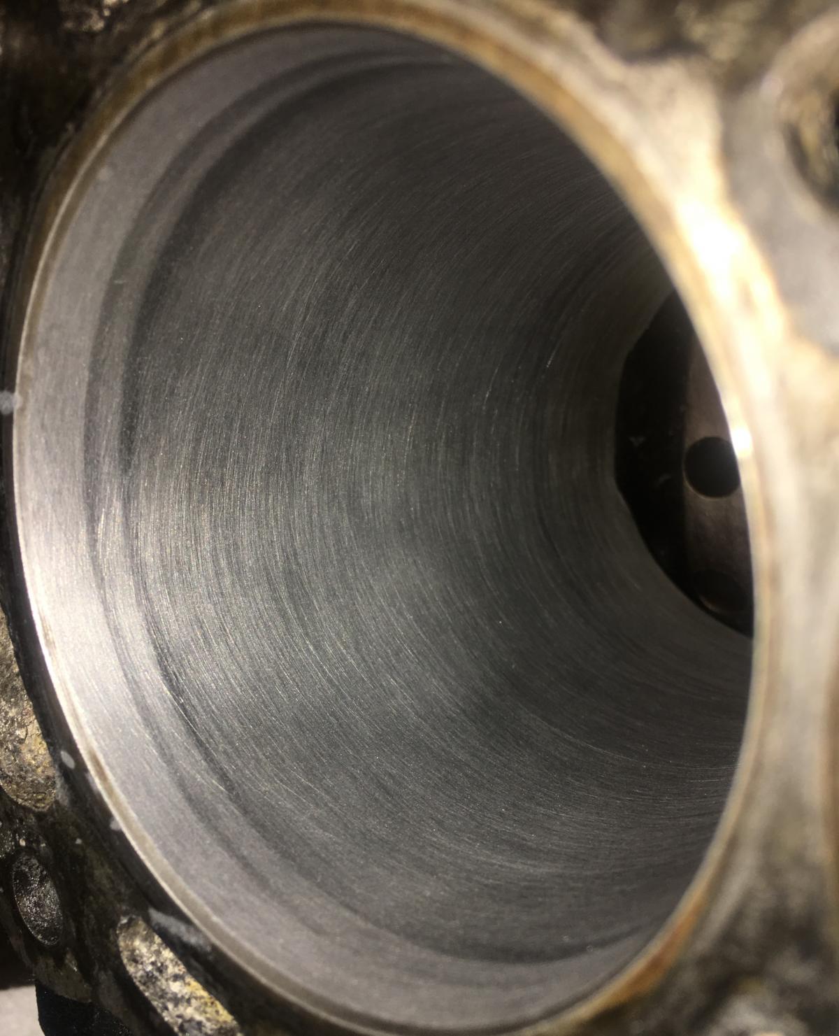

SpikeyJp_68 Posted December 5, 2016 Author Posted December 5, 2016 (edited) The cylinders have been honed. Before And after Edited December 5, 2016 by SpikeyJp_68 Quote
