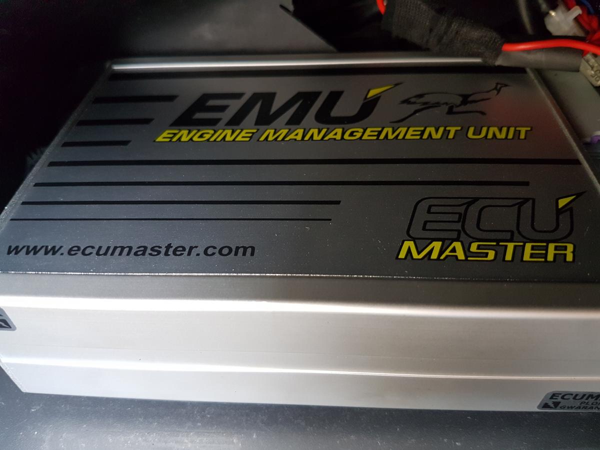

turbodailydan Posted May 30, 2016 Posted May 30, 2016 Info on the ecu master mate? Is it plug n play or harness adaptor needed? What size map sensor does it come with and How much did it set you back and where did you get it from? Quote

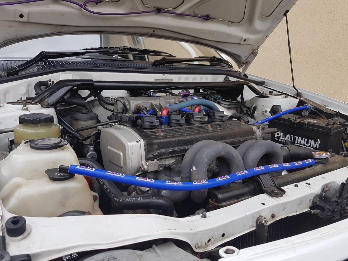

turbo-fever Posted May 30, 2016 Author Posted May 30, 2016 It's standalone so no need for original ecu, uses all original sensors but best to go coil on plug and you need a Nissan gtr tps. Had harness made to meet original loom also using it for boost control which works well. As for price you would need to speak to them personally they are rrr engineering in Kimbolton Quote

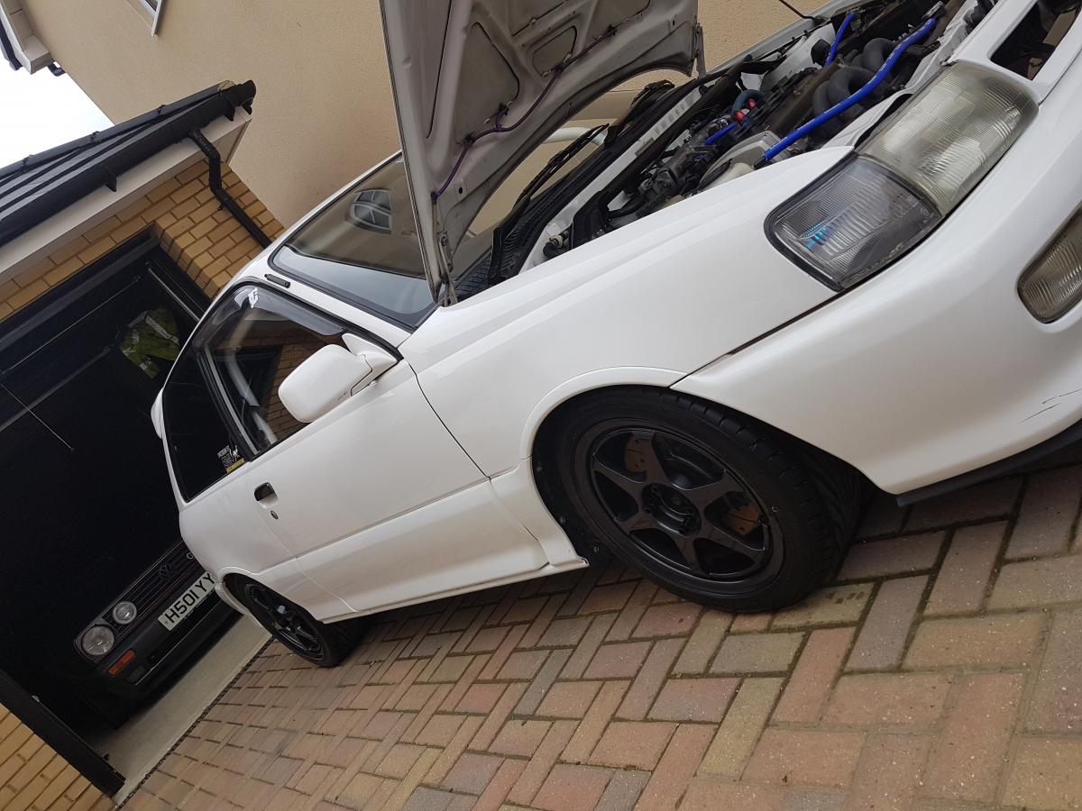

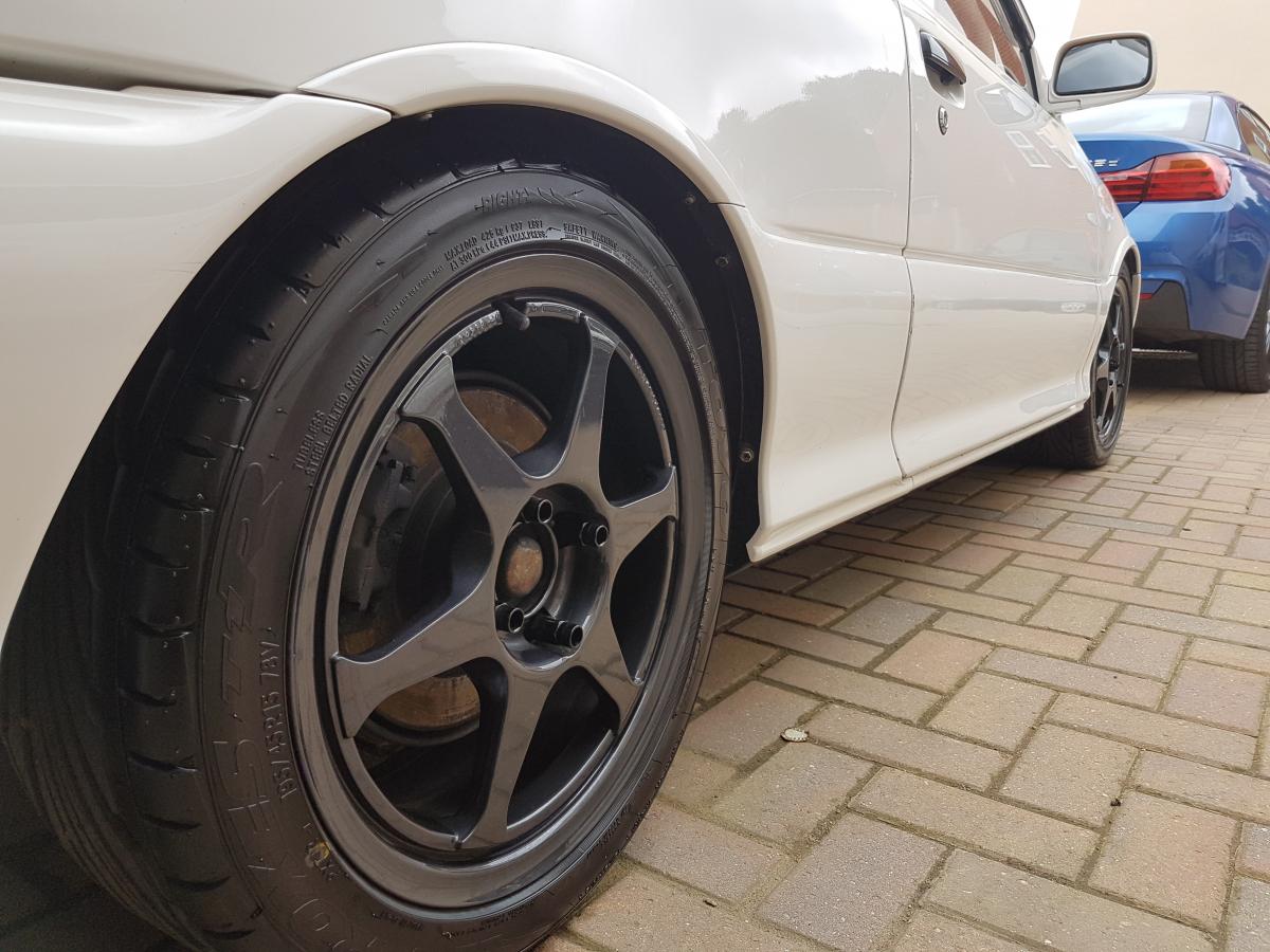

turbo-fever Posted May 30, 2016 Author Posted May 30, 2016 Couple of pics after wash don't look much different really had 4 new tyres ( all the same size now !) New extended wheel nuts. Can't wait to get all the dents sorted and give it a blow over will look so much nicer Quote
turbo-fever Posted June 18, 2016 Author Posted June 18, 2016 Nothing much to update yet, got my new wastegate spring and should be mapping more boost in next Saturday. Fitted this ready for the anti lag though Quote

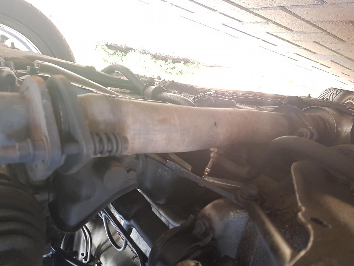

turbo-fever Posted June 27, 2016 Author Posted June 27, 2016 New problem to add to the list, a hole in my exhaust ! It's not the best system but it does work wellGot north weald next weekend need to try get the brakes done and a new section of exhaust Quote

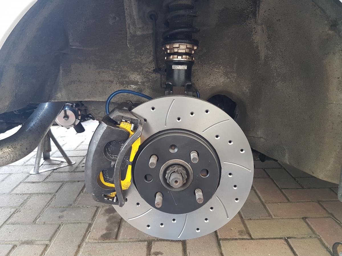

turbo-fever Posted July 5, 2016 Author Posted July 5, 2016 Well got the front calipers rebuilt thanks to Russ for sorting them out and new discs plus added Some yellow stuff pads with some dot 5.1 ready for the RING ! only problem is bled the whole system twice but brakes are still spongy ? Quote
