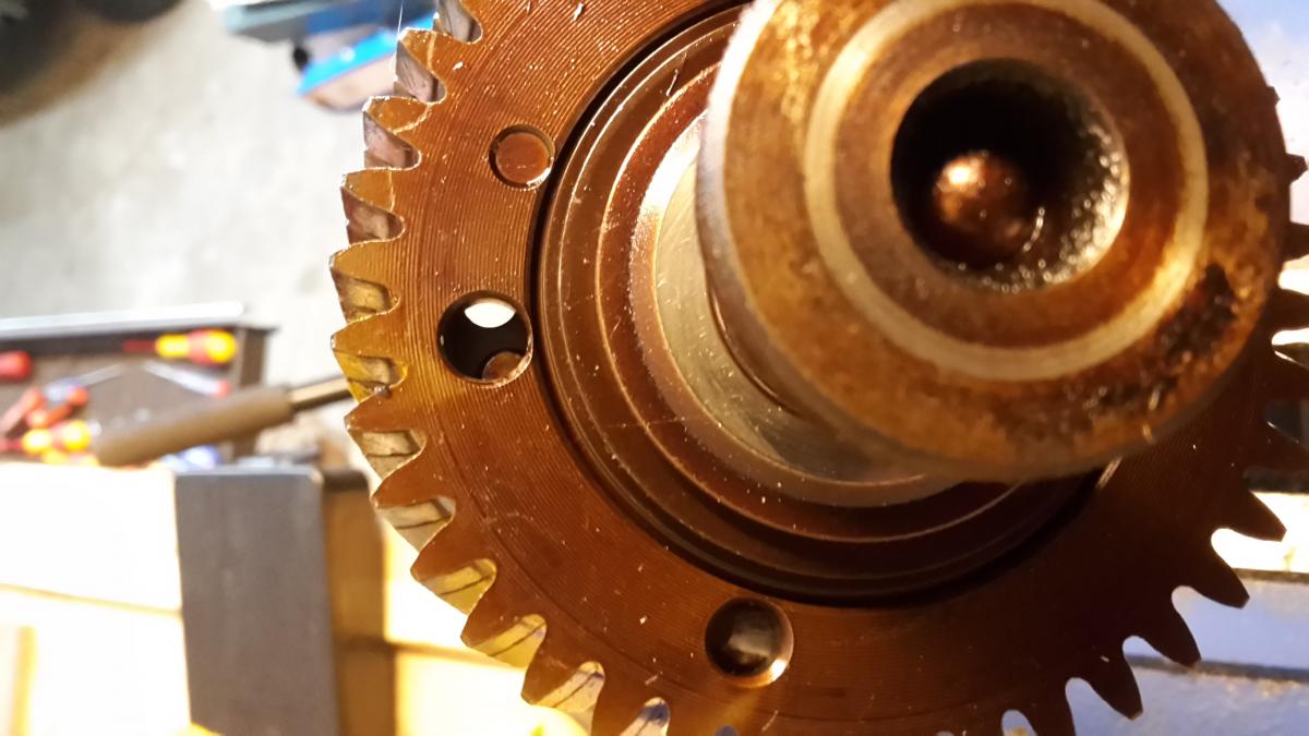

Johnboy GT Posted September 16, 2015 Posted September 16, 2015 This is a spare cam I have. I'm assuming the two holes I have pictured is where the service bolt goes? That will bring the cog round another tooth. Put in in the head, set the timing then remove the service bolt? I'm just making perfectly sure before I do it so sorry if it sounds dim.John Quote
Johnboy GT Posted September 17, 2015 Posted September 17, 2015 Bump. I will be doing this tonight hopefully.John Quote
ROTABOOST Posted September 17, 2015 Posted September 17, 2015 Yes mate, puts a tooth worth of spring pre load on the cam gears. Bolt the cams in then just remove the bolt Quote
5e colin Posted September 17, 2015 Posted September 17, 2015 ya thats it stick bolt in it stik cam in the vice and 2 bolts in the cog so you can tention is or muscle power Quote
