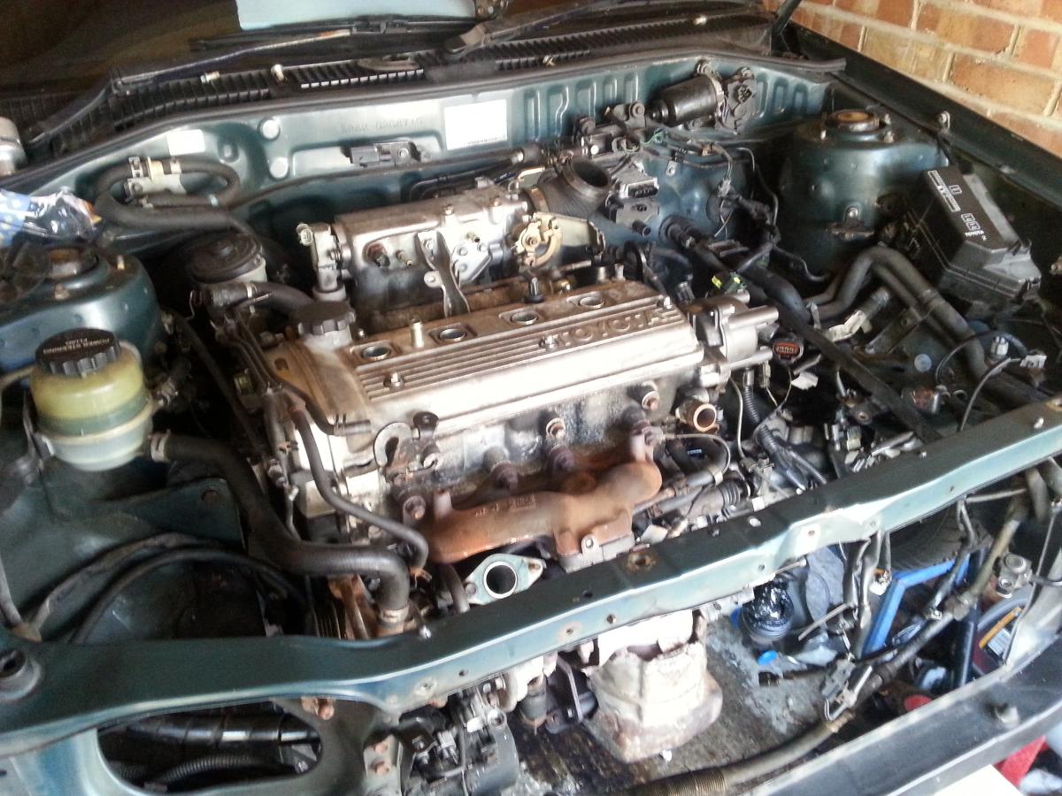

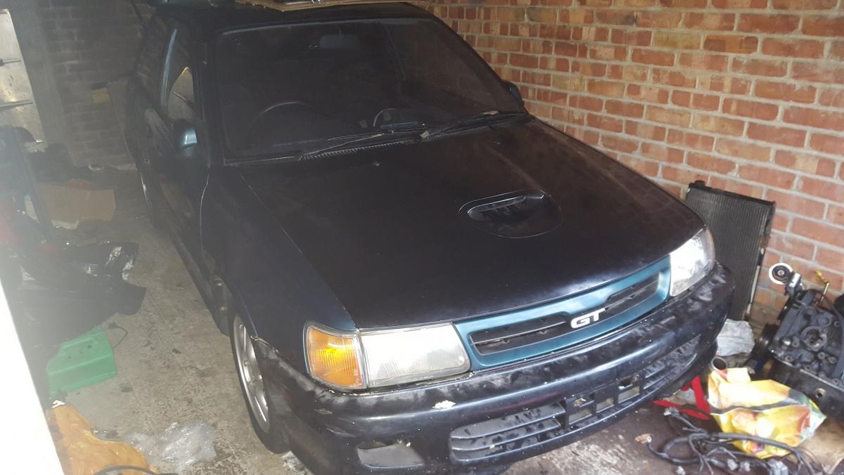

Update time! been dismantling all the auto filth in the engine bay, but i need my engine crane and stand to continue with that further so i set to work in the interior.

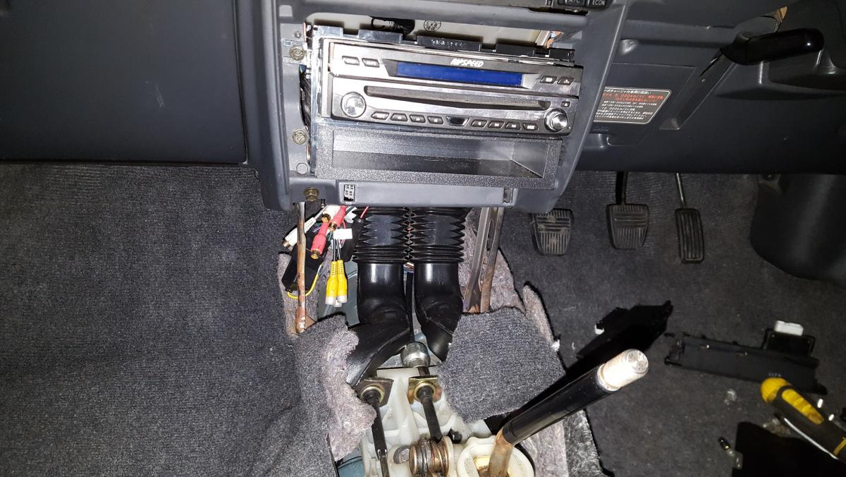

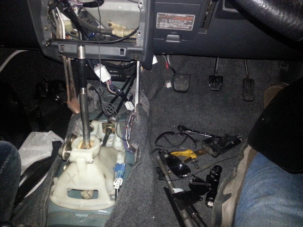

the auto's gear selector surround thing is different to the manuals as it has extra buttons to try and coax the slush heap into doing something, so that needed to come off. auto selector is easy enough, just 4 12mm bolts like the manual, annoyingly slightly shorter though so ill have to find them replacements.

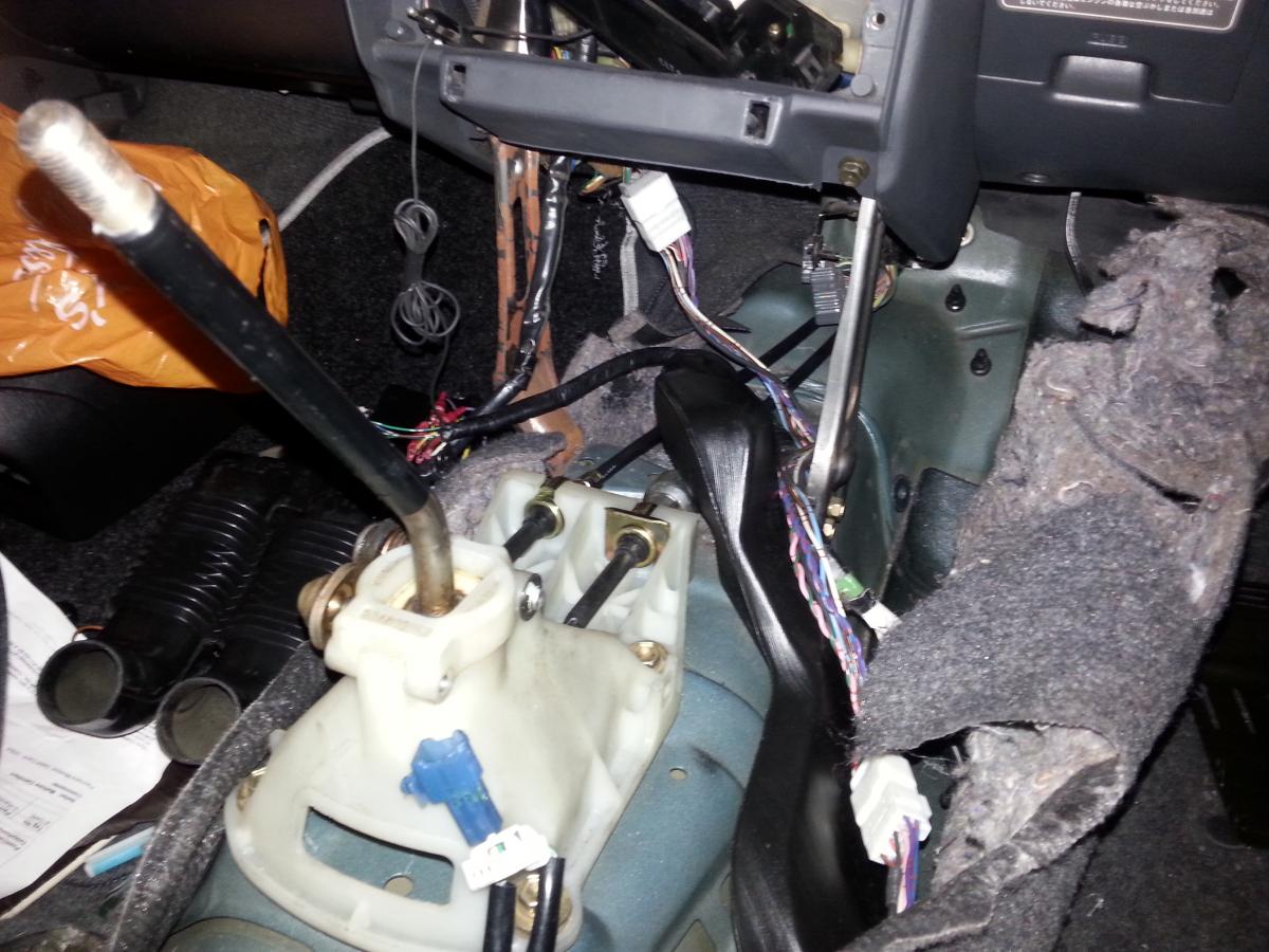

not the best picture i know but it was dark inside the garage at the time. the two plugs to the left there have me stumped, i suppose one is for the reverse light, can anyone tell me what the other does, and which colours do what?

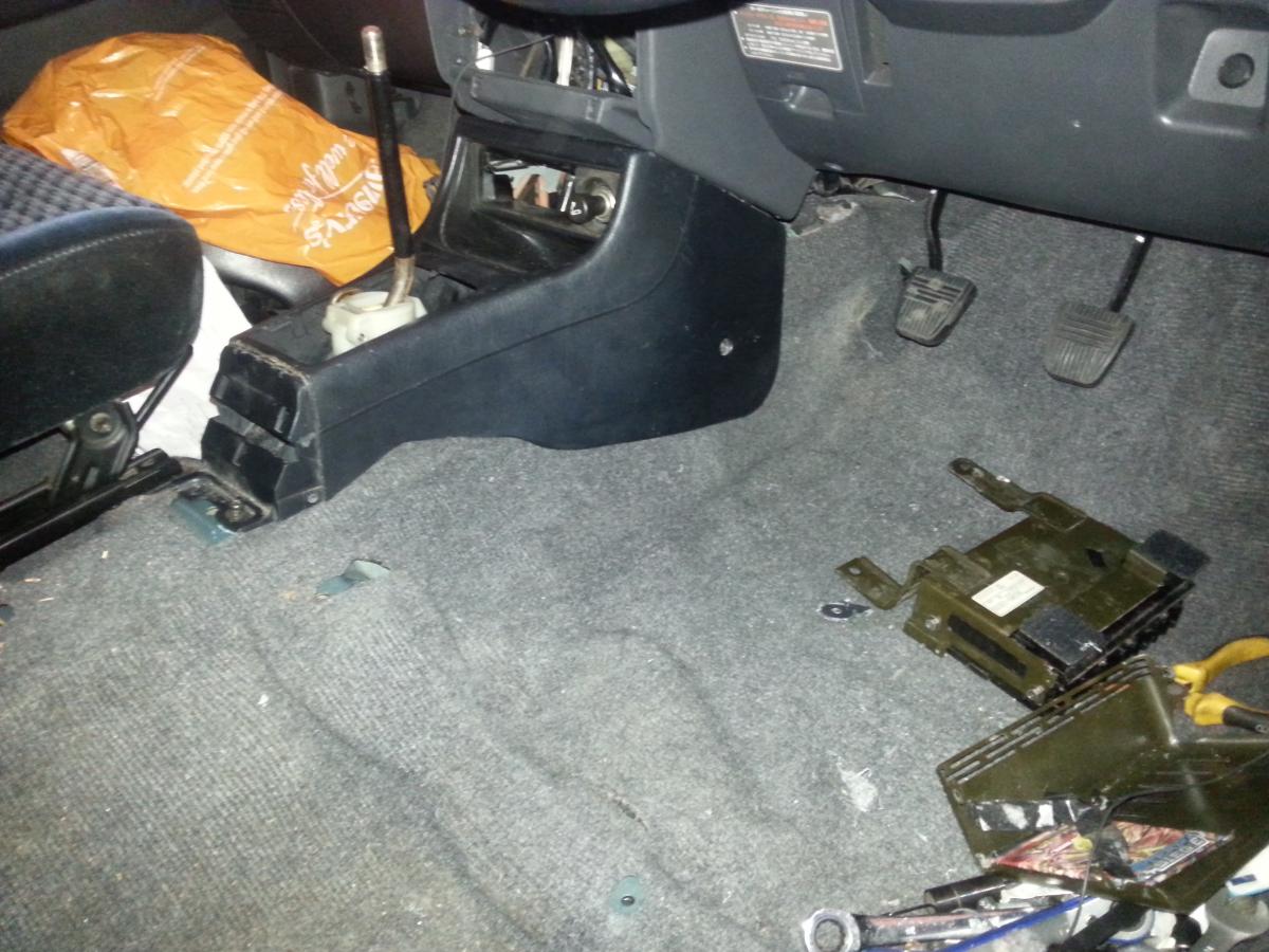

quick mock up of the manual job, needs a good clean up i know and ill do a little short shift conversion on it before it goes in properly, and maybe make some solid mounts as peeps seem to swear by them

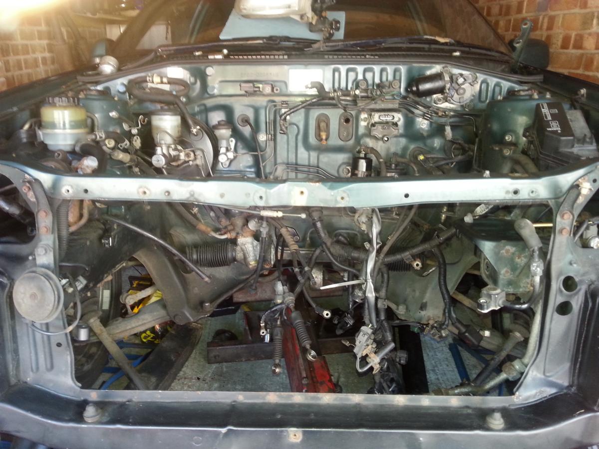

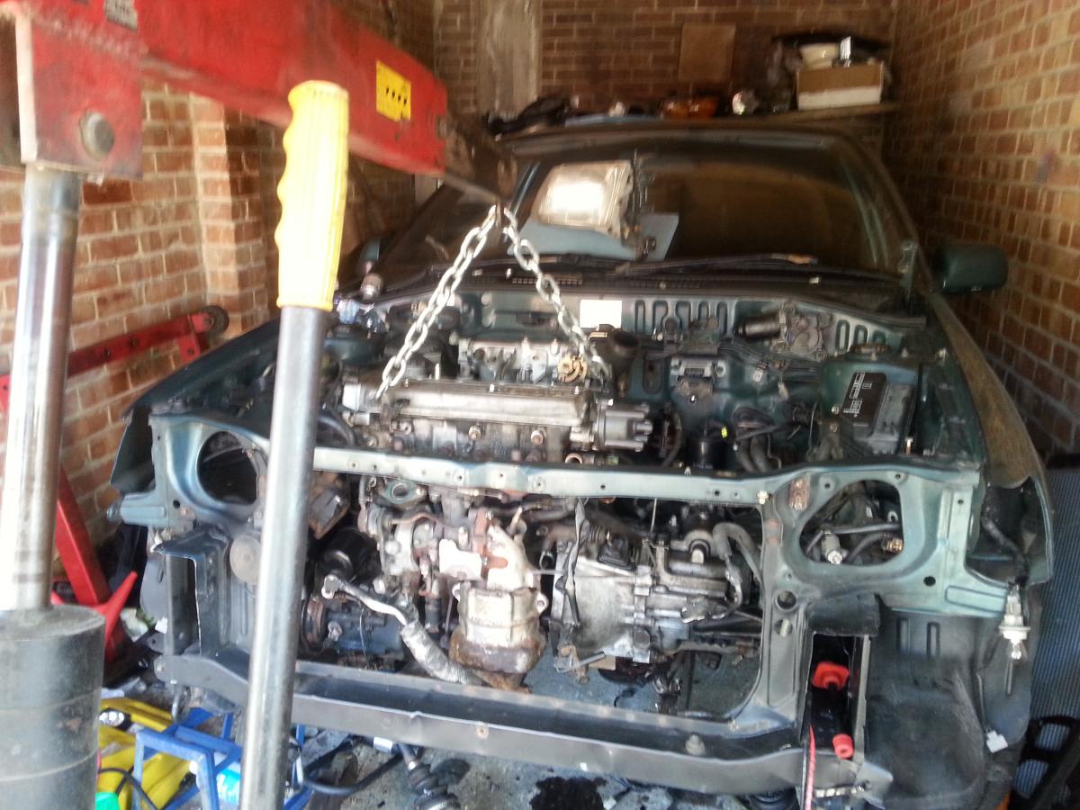

Small update time as ive been busy sorting through this, taken all the pictures and then found my laptop had shat itself ffs. Got the whole front off and the engine and gearbox out, thought I might as well pull the engine and do a belts and seals job on it to futureproof it. Made it a short shifter with a bottom weighted gearstick, solid shifter mounts and bearing bushings for the selector cables that I've pinched from my white shell, along with the clutch pedal and mech. I promised myself i wouldn't pinch bits from it as its what ill be working on when this is done, knew I was lying to myself lol. pics to follow!

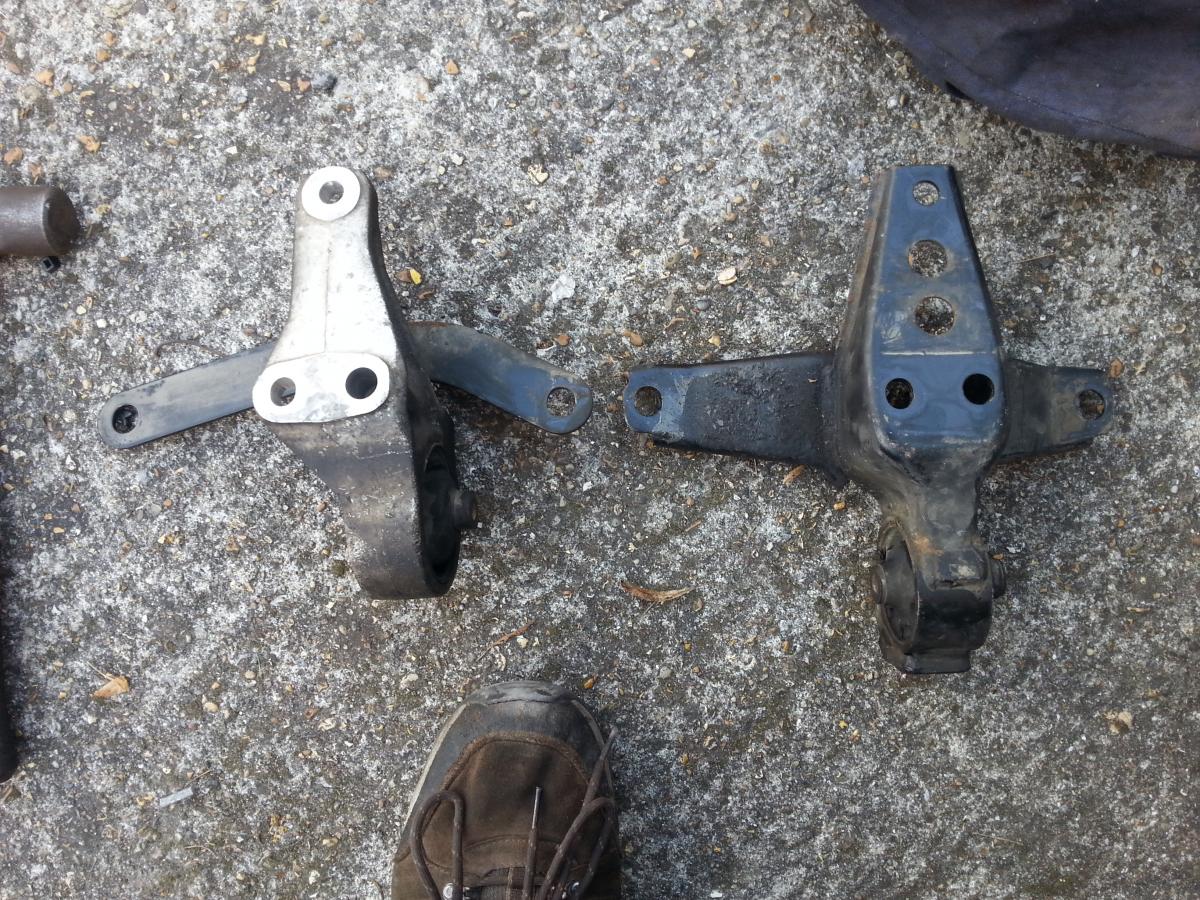

So i was down the scrappys as usual, and ended up trading my c63 gearbox for a corolla g6's c161 that i found lurking in a corner. Also grabbed all the metal gubbins out of its shifter to go with the box and found that the gearstick itself would go straight into a starlet with a somewhat shorter throw into each gear lol, its almost identical to my custom short shifter in length and i know thats about 10mm more than stock!
obv the one on the right is the modified one, the corolla would need a bit of bending to angle the gearknob towards the driver but itd be an easy easy job!

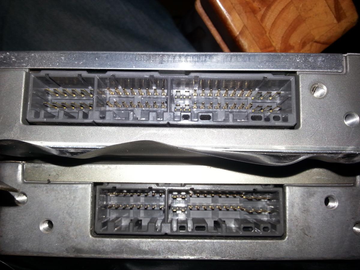

It seems to me like the auto 3 plug is exactly the same as a manual 2 plug with an extra thats dedicated to the auto box. Is that the case, can i just plug in the two that match the manual ecu and leave the third plug loose, or are all the wires jumbled up? Also, is it the same shape as a glanzas three plug?post-10502-0-47032200-1464189856_thumb.j

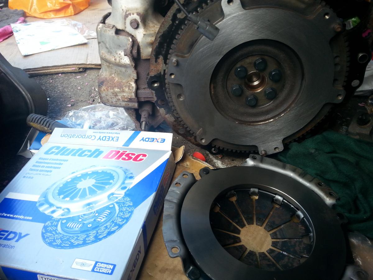

so i threw a load of new seals on the engine, new timing belt kit and all that good old 'while i was in there' stuff, and threw on my freshly resurfaced lightened flywheel, because why not. standard spec excedy clutch of course, and bolted my old gt's gearbox on. sorry the pic isn't the best, i took better pics of most of this then found id lost the lot and had to take more with my phone.

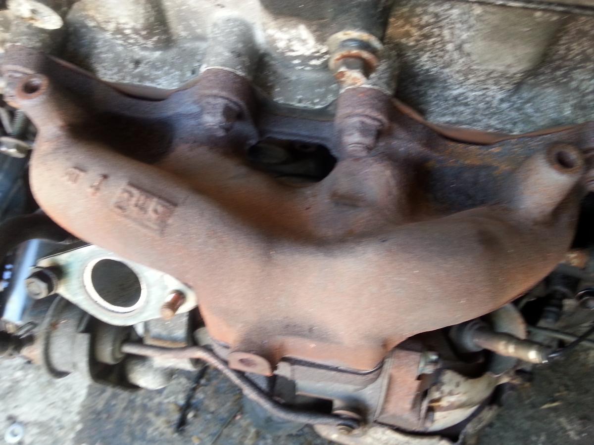

I took the cover off the og ehaust manifold the other day, was chuffed to see it hadn't cracked as so many others have. Perhaps its due to the autobox stopping less careful owners ragging the shit out of the engine, but thats just a guess.

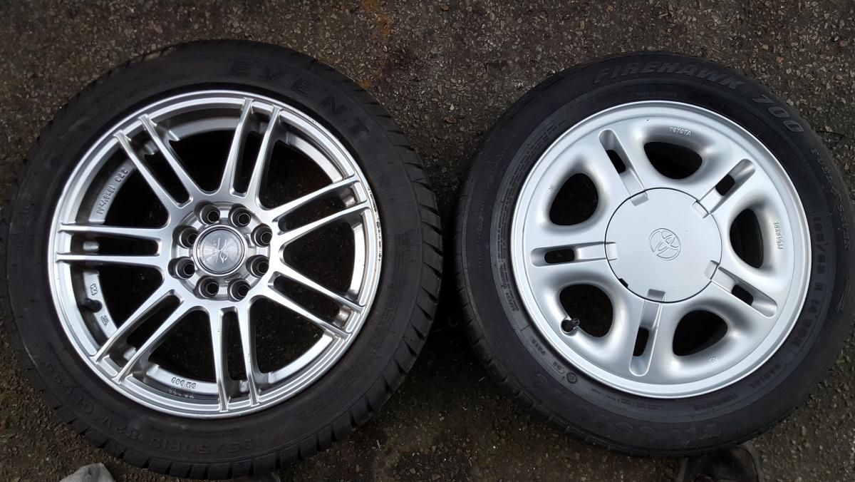

swapping mad alloys for correct 92 spec alloys.

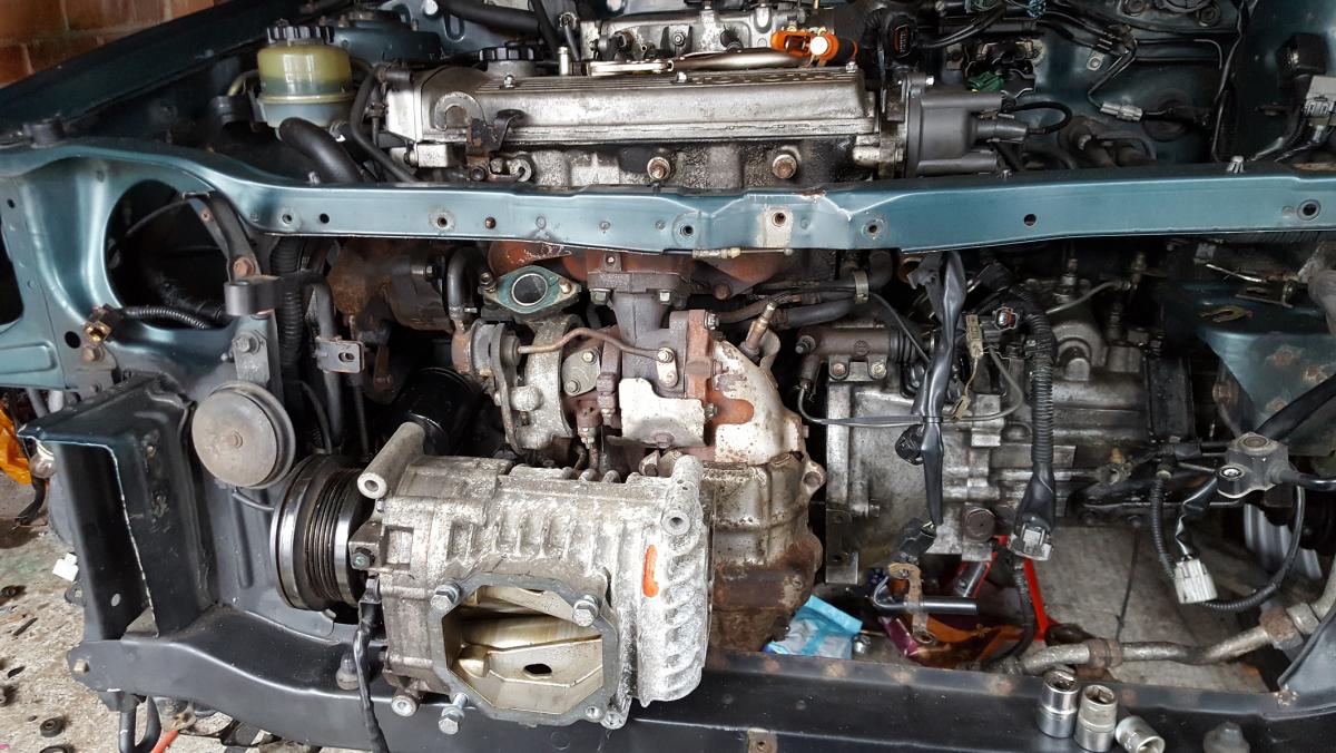

big nasty eaton m62 supercharger i got the other day for my other starlet, offered up to the bay while it looked like this to get an idea of how little space theres going to be where i wnat to fit it!

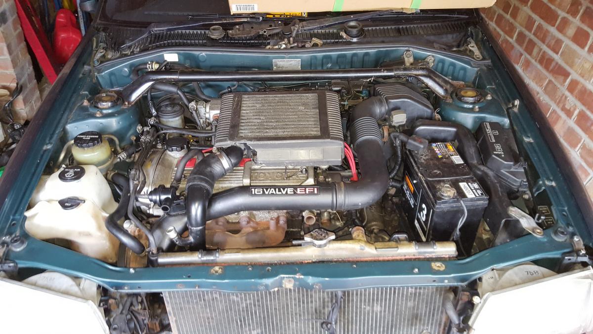

basically how it sits now, just waiting for the last few things in the bay like the ac condenser so i can get it motd and get it off to the paint shop to have that bumper and bonnet sorted!

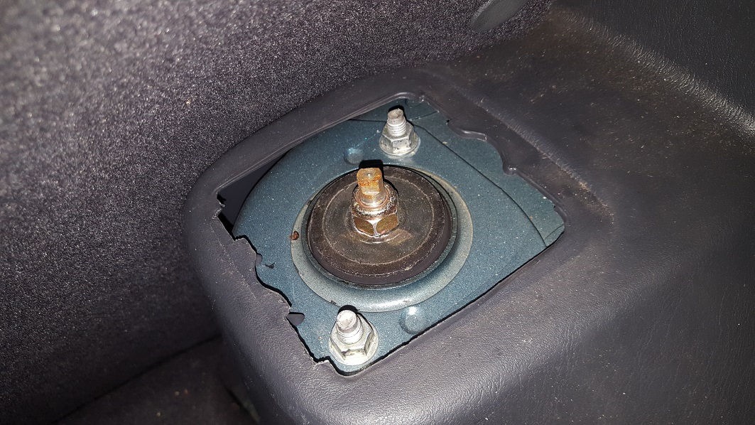

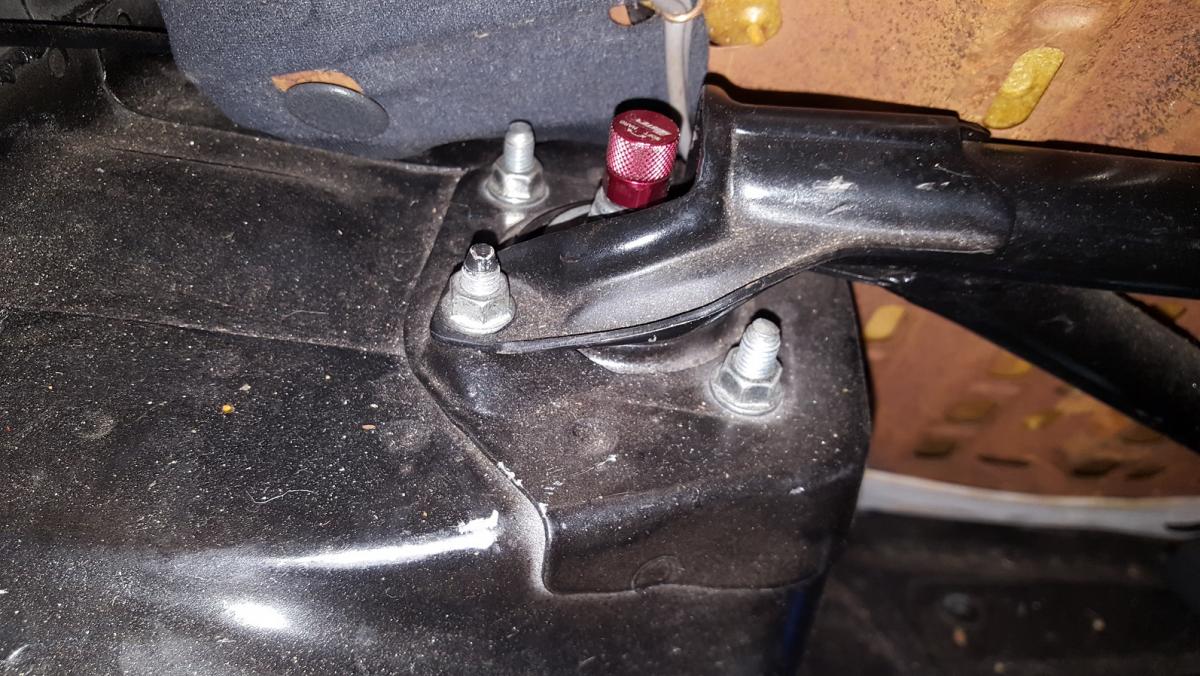

so i was trying to fit the 3 point brace to the towers on the rear and found this:
post-10502-0-73673900-1488837375_thumb.j
post-10502-0-12120200-1488837405_thumb.j
the turrets only have two studs from the shocks, and i dont think theres a central fixing point either. i shat myself immediately and assumed it must be a clone or some mad cut n shut, but ive checked it thoroughly and theres no signs of any tampering, and the frame number matches the one on the vin, which confirms this is definately a factory automatic gt turbo, so i was wondering if anyone could shed any light on this new nonsnese lol. perhaps as its an early 92, this is a last of the mk1 chassis factory fitted as the first of the mk2s, as ive read in places that mk1 chassis are different in several ways.
Edited by Chops
My 92 gt is the same way and so are the Mk1s
you sir, are a gentleman and a scholar, ive been freaking out a bit over it, its good to have it confirmed, cheers!
