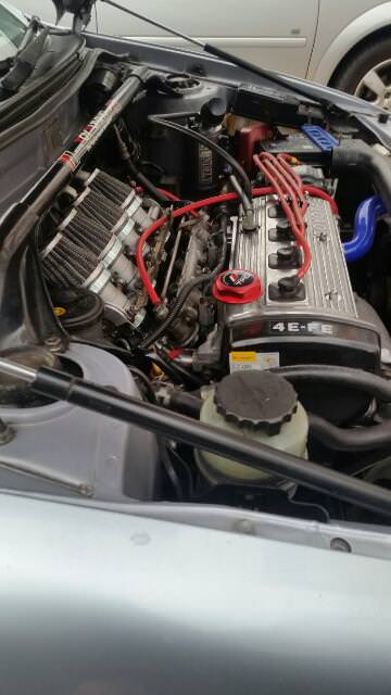

Hi guys haven't been on here in a while, the starlet is still going strong but been so busy with other cars. Speaking of which my most recent buy is another starlet which is having a very unique engine swap which hasnt been done yet. Will have a blog eventually. As for the sr in this time it has had abit of work, mainly engine as it was burning too much oil so I fully rebuilt a spare engine with the addition of : Skimmed head, fully ported and polished, lightened flywheel, full rotating assembly balance ie crank, pistons, conrods, flywheel, clutch, front pulley. Apart from this I've put some recaro seats and built a full stainless exhaust system including header which was all made by myself. Once the car was back on the road I was very impressed with the work I did as the car pulled alot nicer not too mention it makes the engine bay look 10x better with the golden runners. after making the first manifold tho I made a couple more designs with the materials I had left over see which one I prefered. Next thing is too get the management wired in properly once i get abit of time.

I am planning on using them with the throttle bodies instead of a manifold. And yeah I was looking into getting valve springs aswell I will have a look at that site later on.
