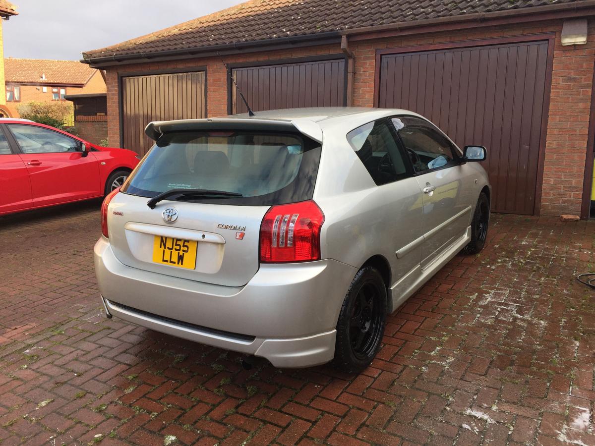

Cammy R Posted February 17, 2017 Author Posted February 17, 2017 So where are we now? Coilovers fell through I didn't have the funds then they turned out to be quite corroded, Short shifter was a terrible fit and I could no longer get reverse plus it wasn't even reducing the throw it was only a shorter gearstick! I then had to replace a driveshaft, driveshaft seal and do a gear oil change again! Thermostat was replaced now the car actually keeps it's heat, the passenger seat no longer slides on the runners, the drivers window actuator has given up on me and I have replaced both arb links and something is still knocking. Good points are 110K and I still love it even though it has caused me so much pain and free lifts from friends! I have on the way from Japan a set of the Runx tail light only found on their models I also waxoyl'd the car before winter, ate half my bodyweight in mud and rust just prep. the underside And some pictures for the viewing entertainment Quote

Budnbass Posted February 17, 2017 Posted February 17, 2017 looks good mate, can't beat a Ts for a daily. If you've still got the standard shocks and top mounts it's probably a top mount knocking and with the Passenger seat there's a pin that's welded to the seat frame that disengages the lock to allow it to slide it's probably snapped. Quote
