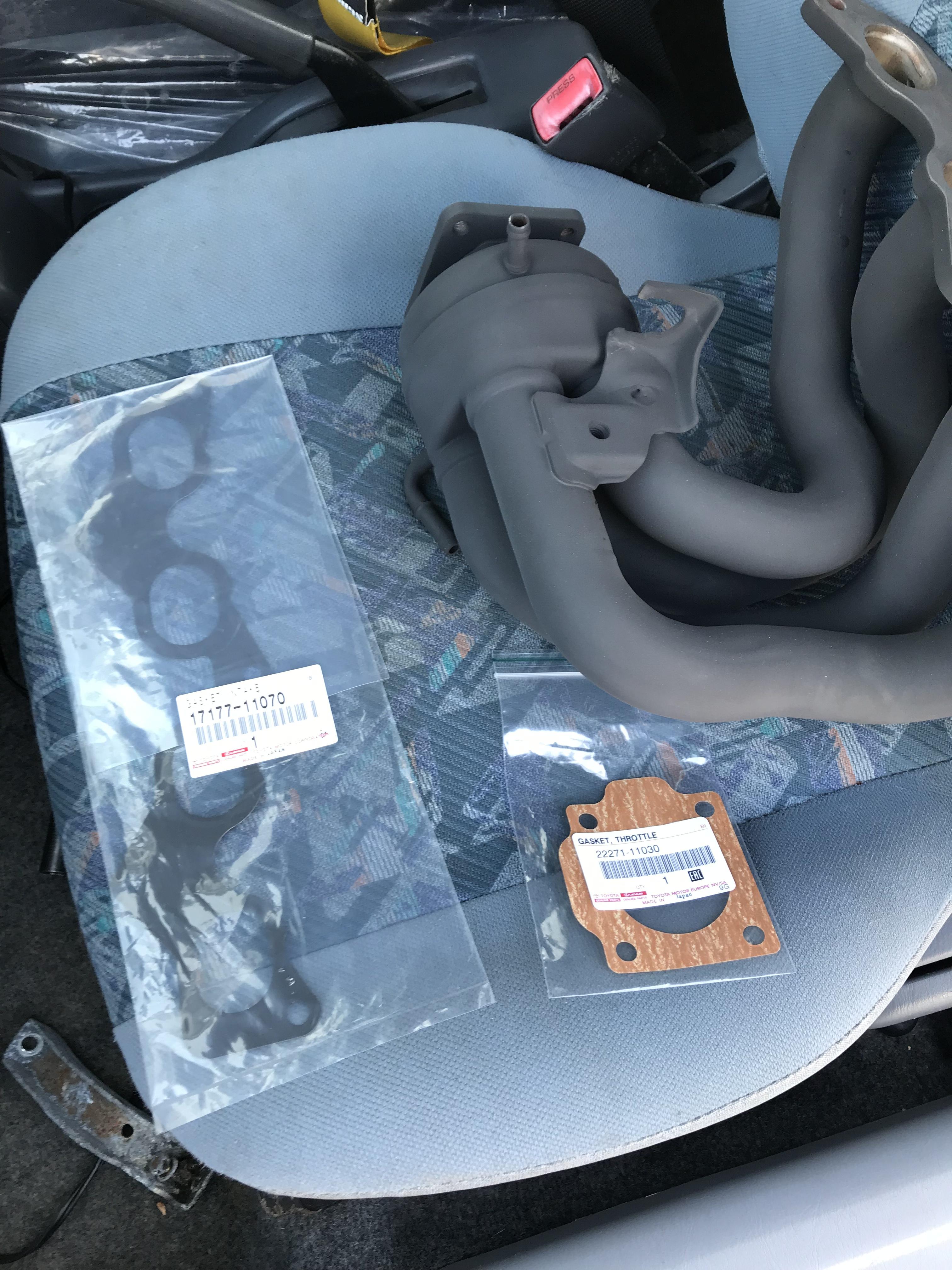

stevie82 Posted July 16, 2019 Author Posted July 16, 2019 Got my seat and Corolla manifold too, manifold won’t be staying red ! Quote

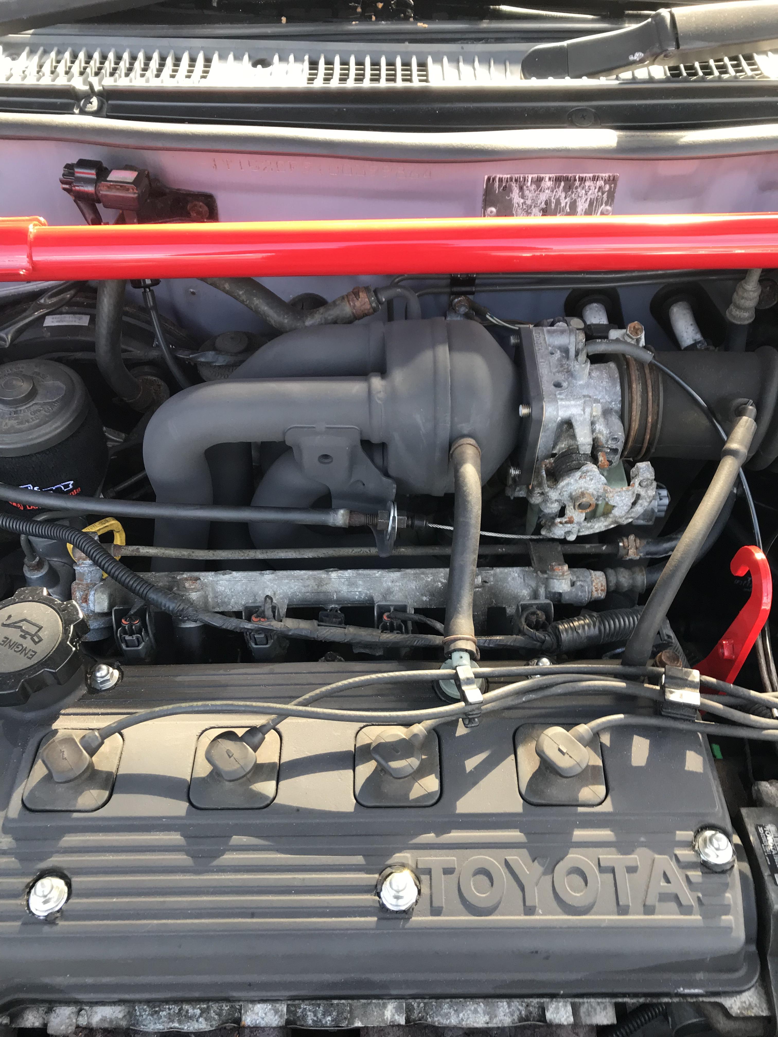

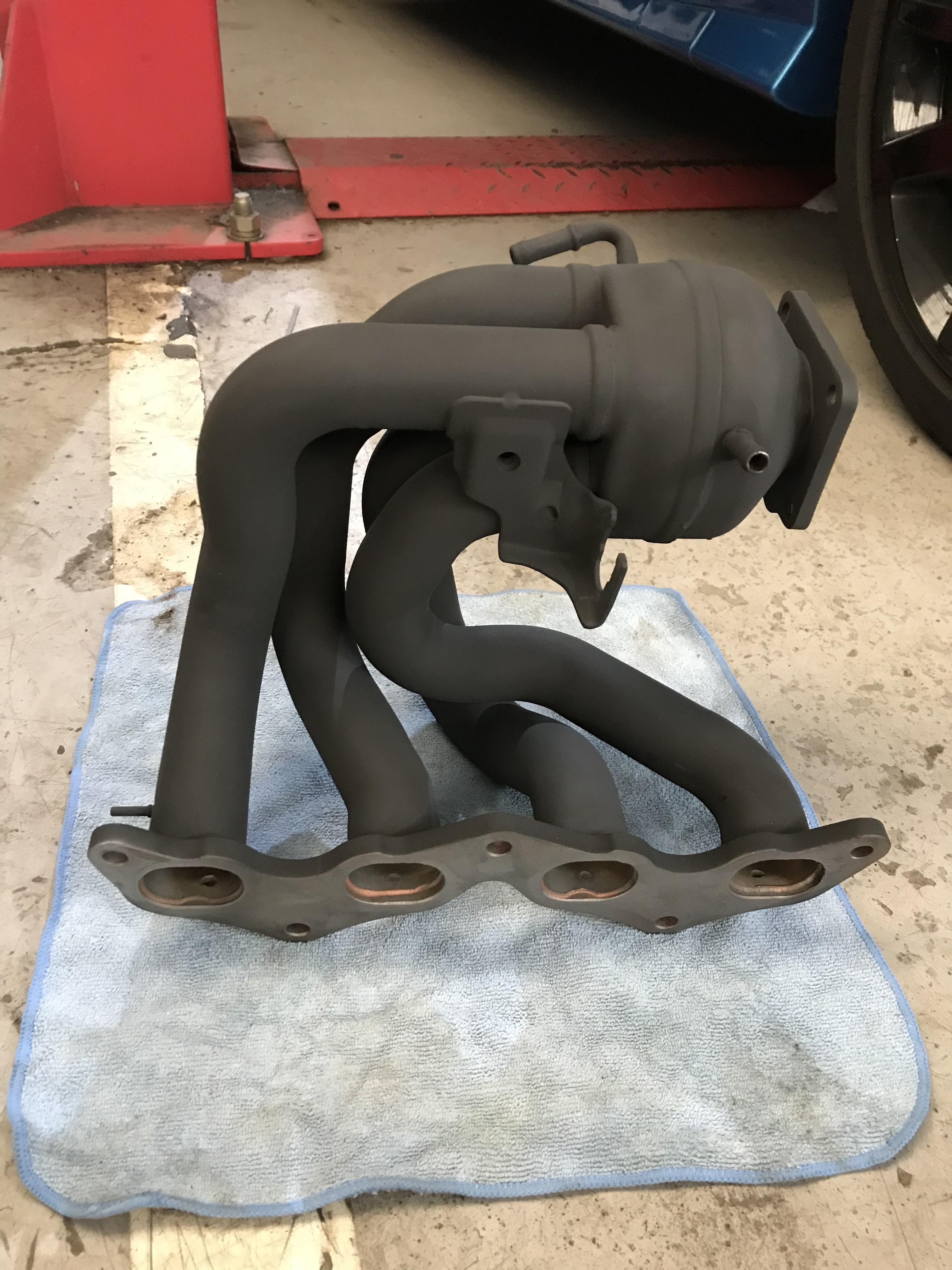

stevie82 Posted July 17, 2019 Author Posted July 17, 2019 Stuck the rolla inlet in the blast cabinet and the parts washer then hit it with some high temp paint Quote
stevie82 Posted August 3, 2019 Author Posted August 3, 2019 Still waiting on some new gaskets from Toyota for the Corolla inlet but will hopefully be fitted next week along with the ultra racing c pillar bar that’s finally back in stock and on its way. Quote

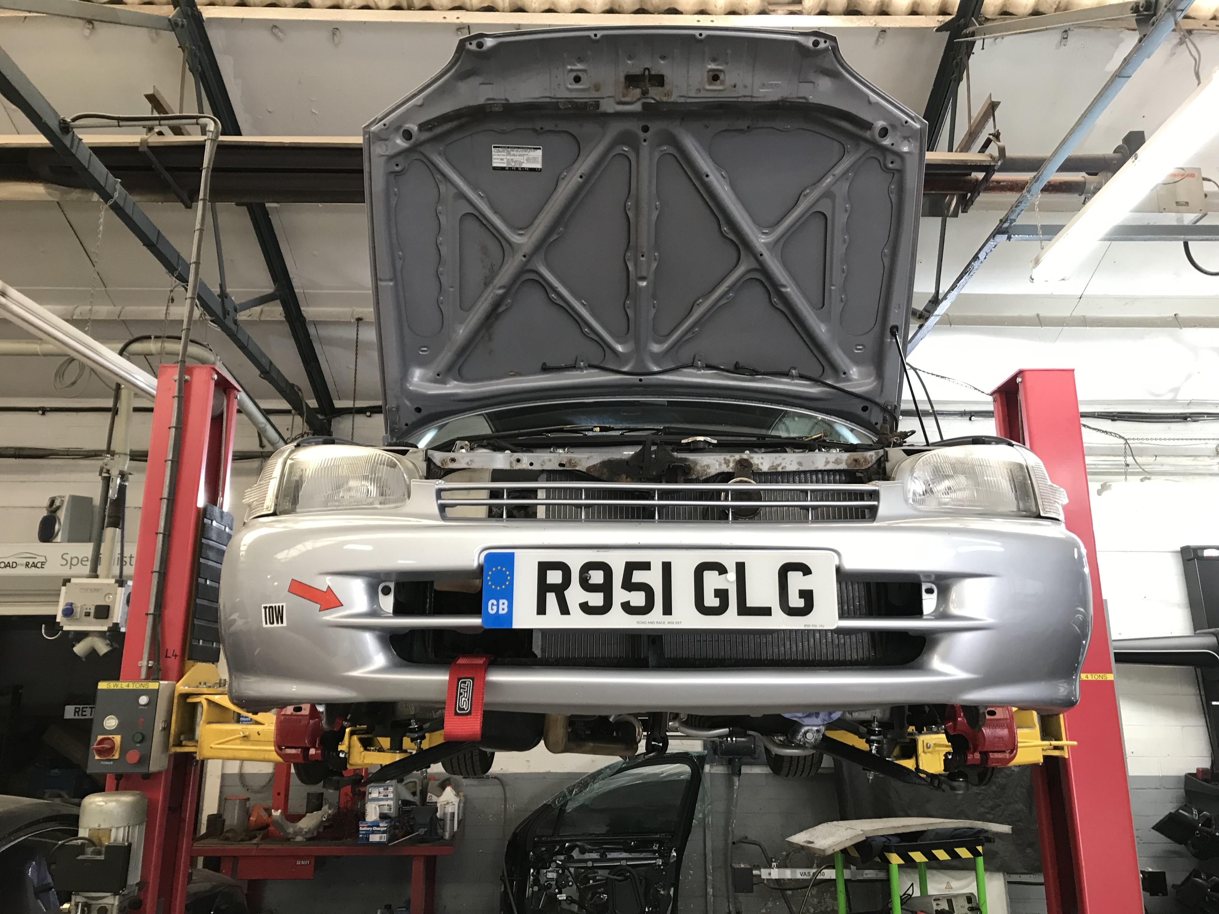

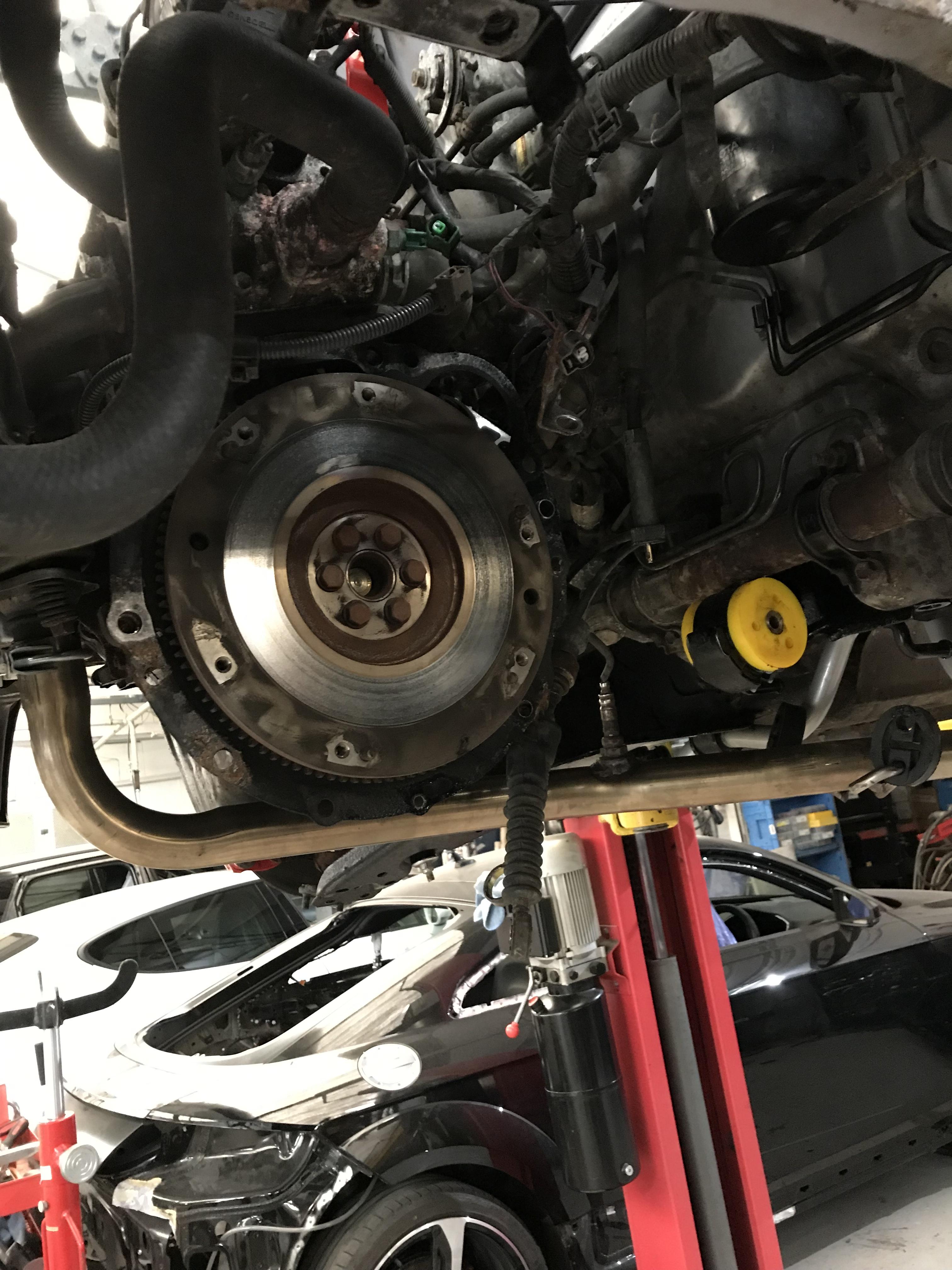

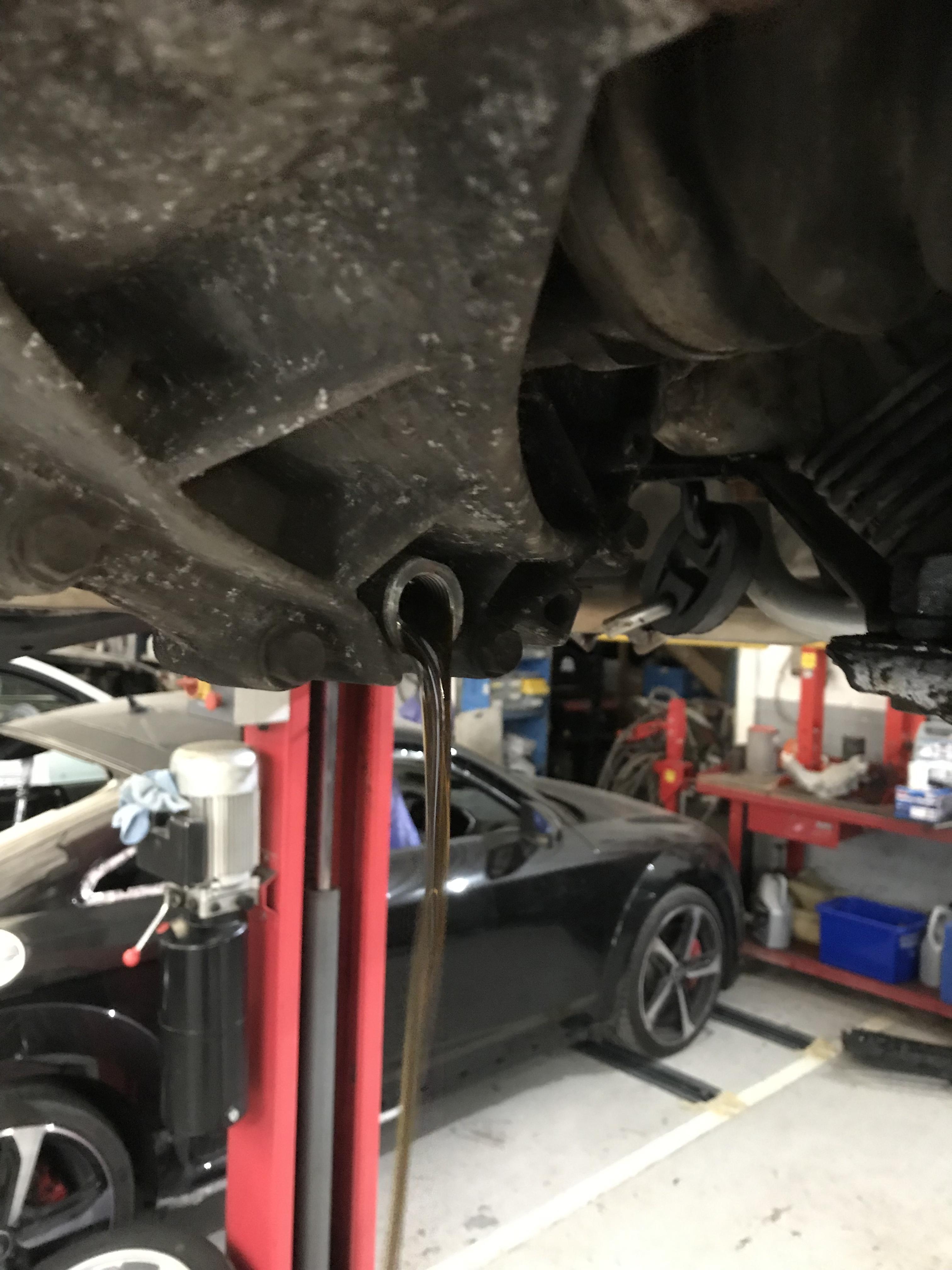

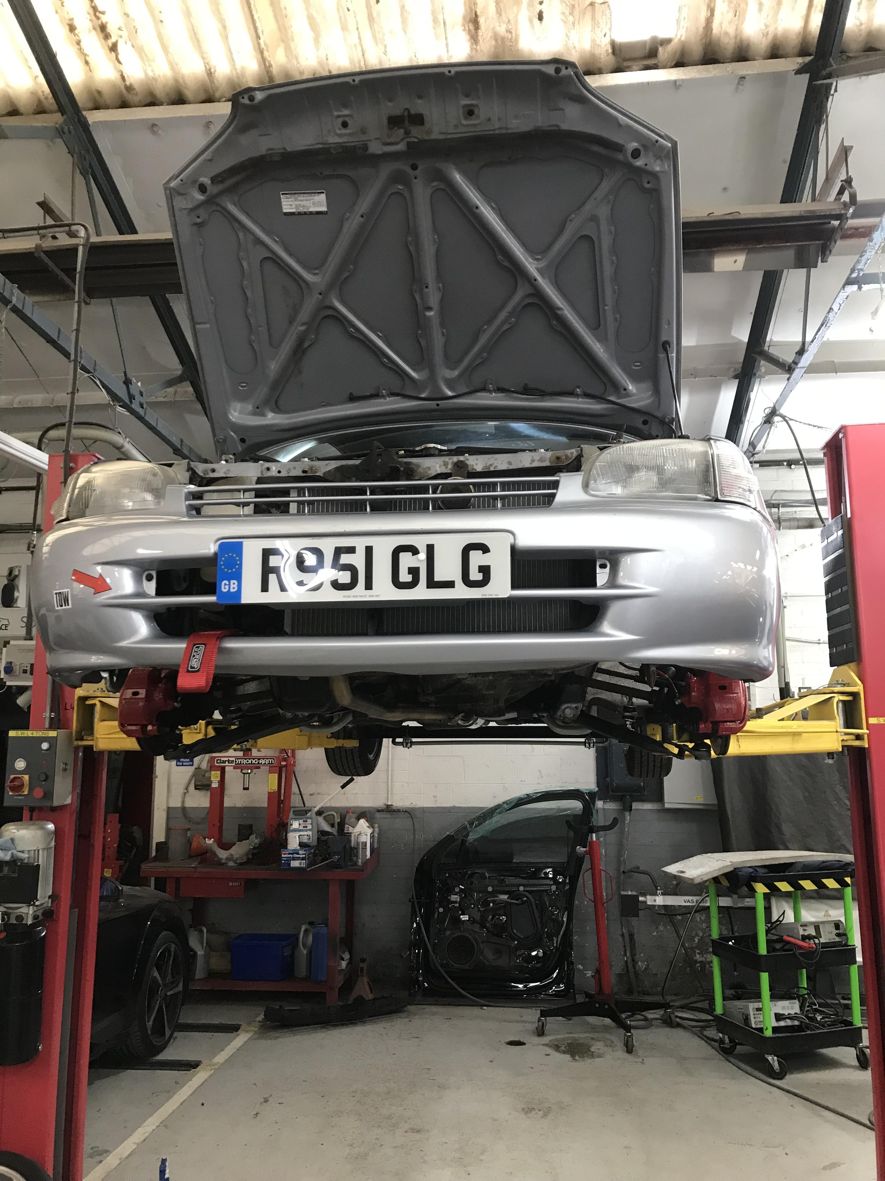

stevie82 Posted August 3, 2019 Author Posted August 3, 2019 Been away on holiday for two weeks so not done anything on it until today decided to do the clutch drained the gear oil and it was awful !millers 75w90 nt+ will be going in it Quote

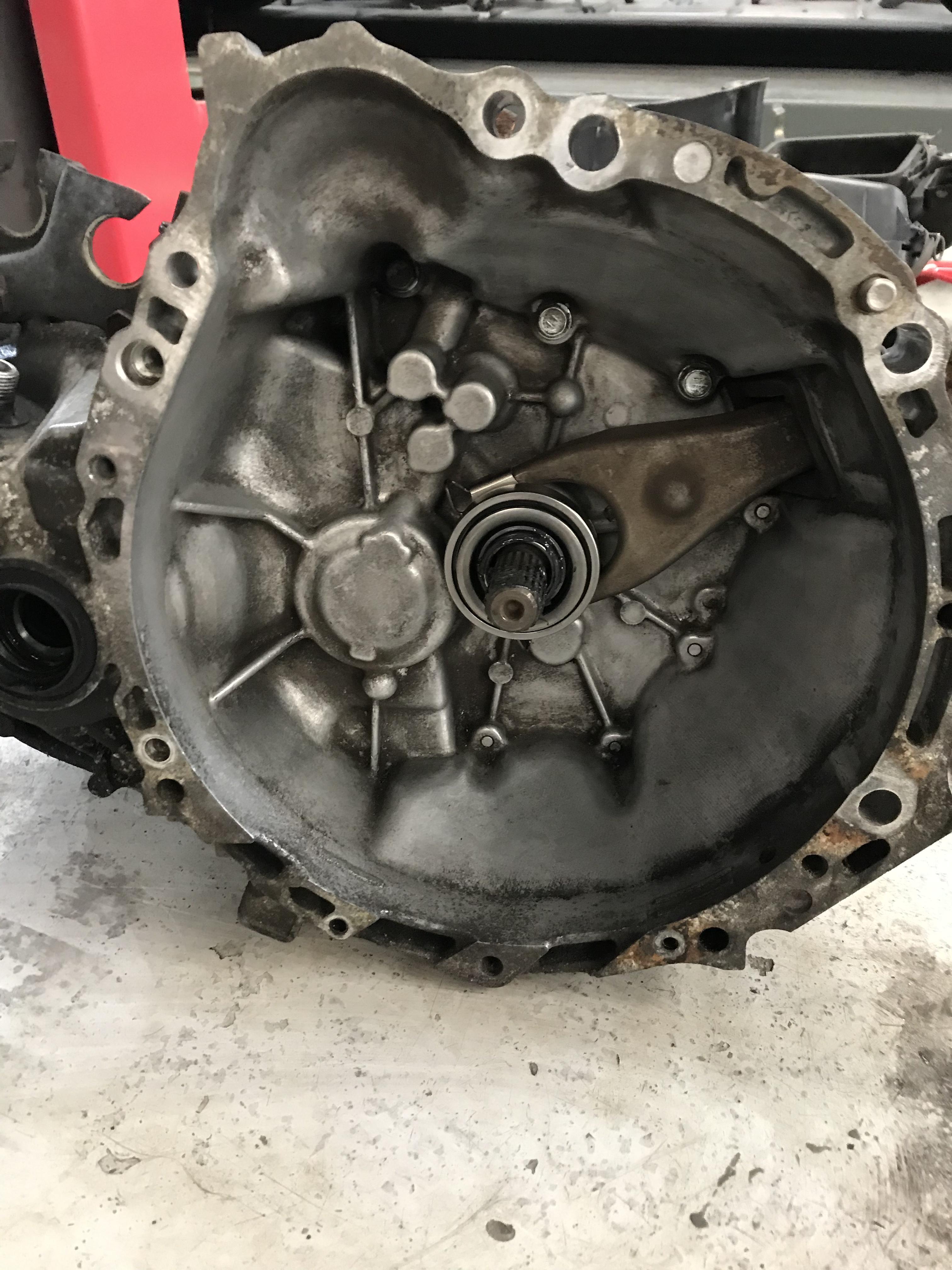

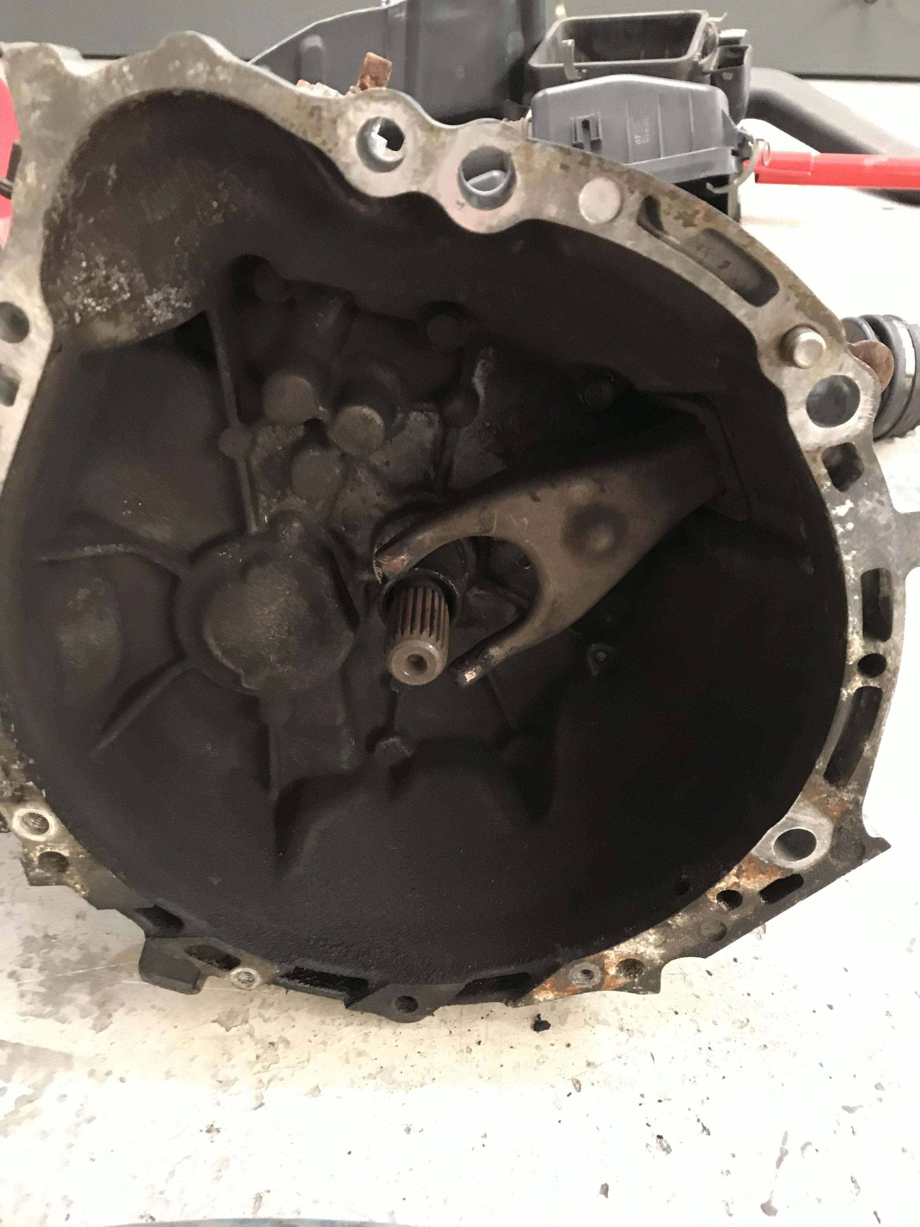

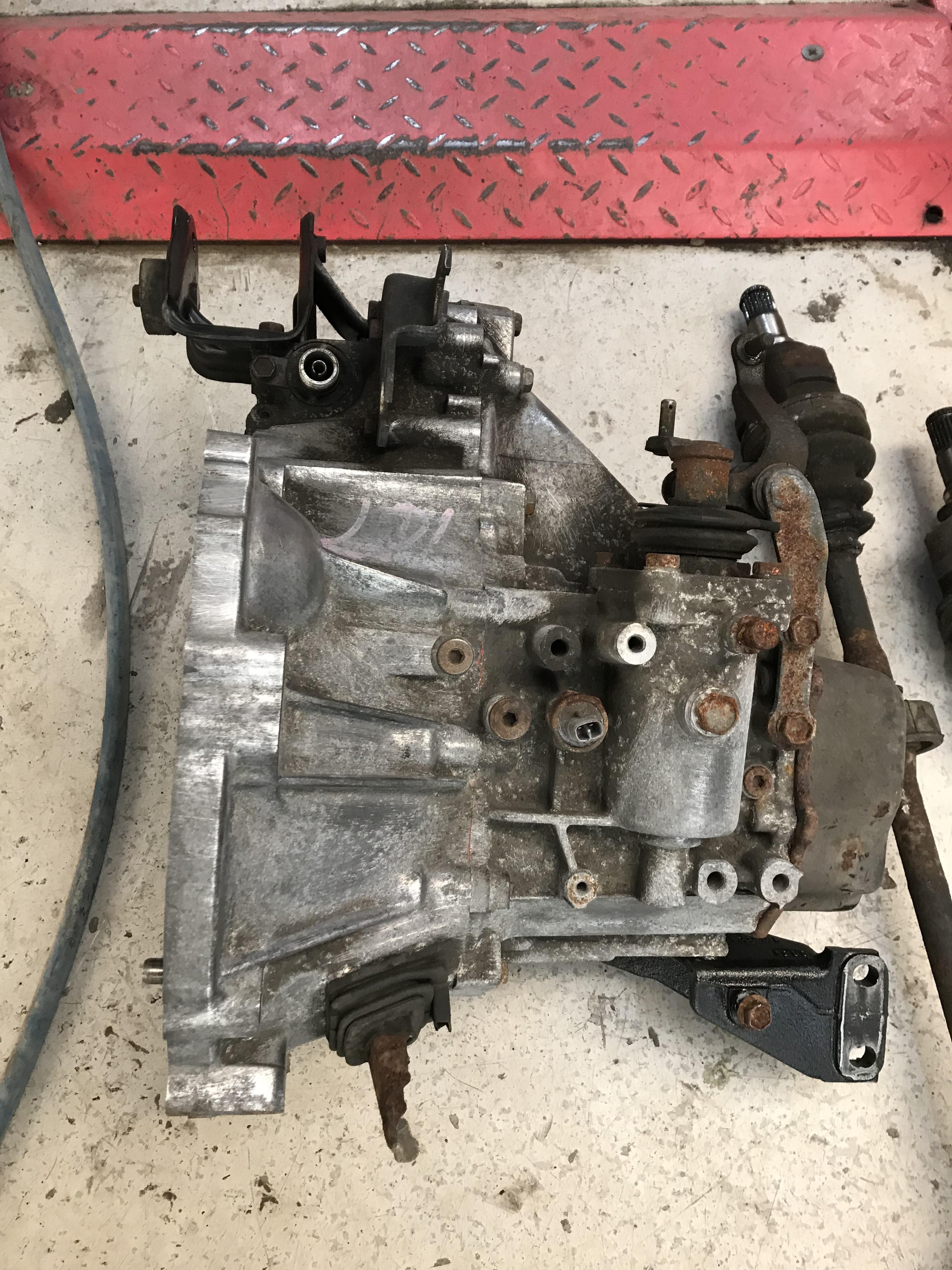

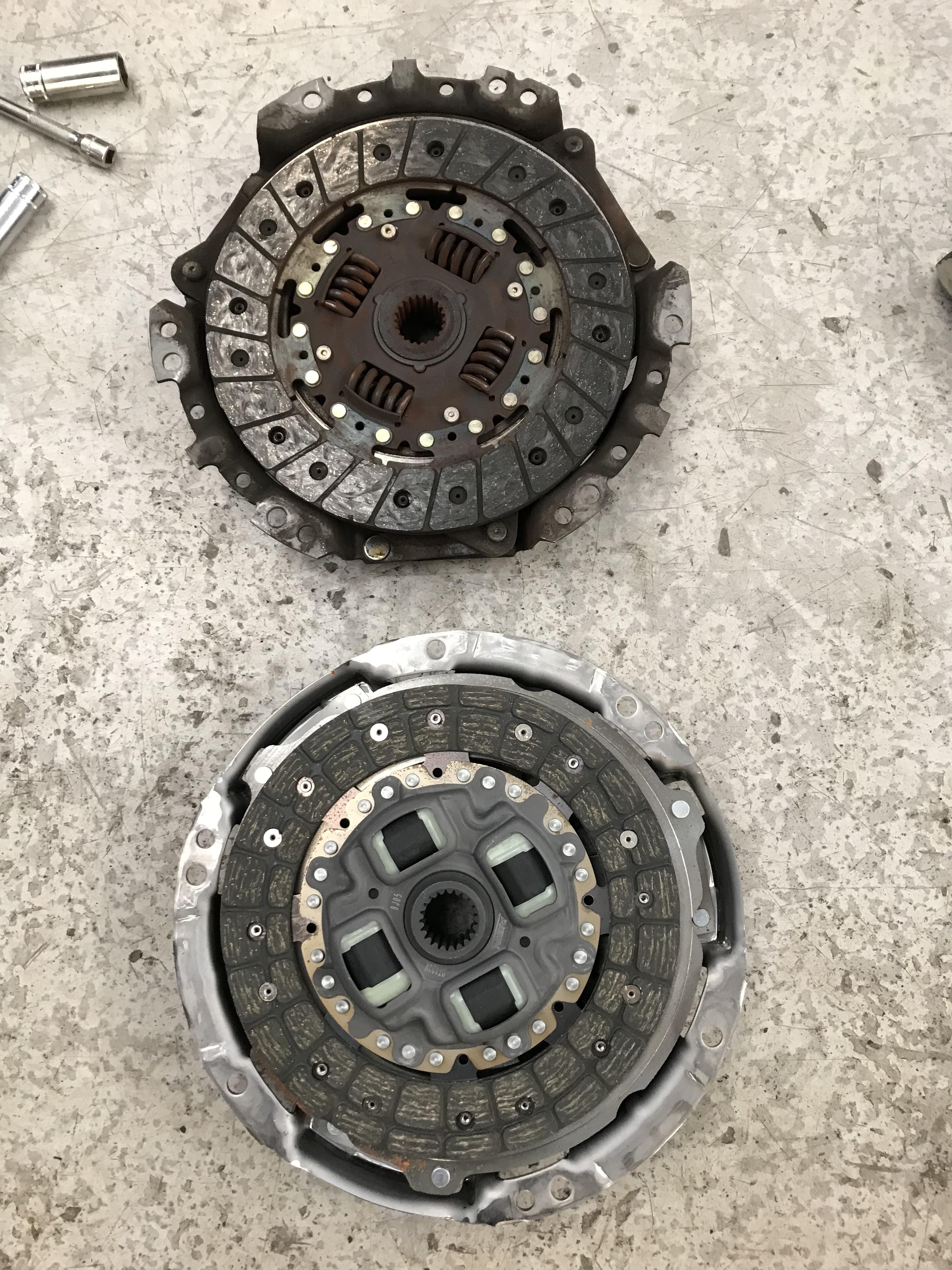

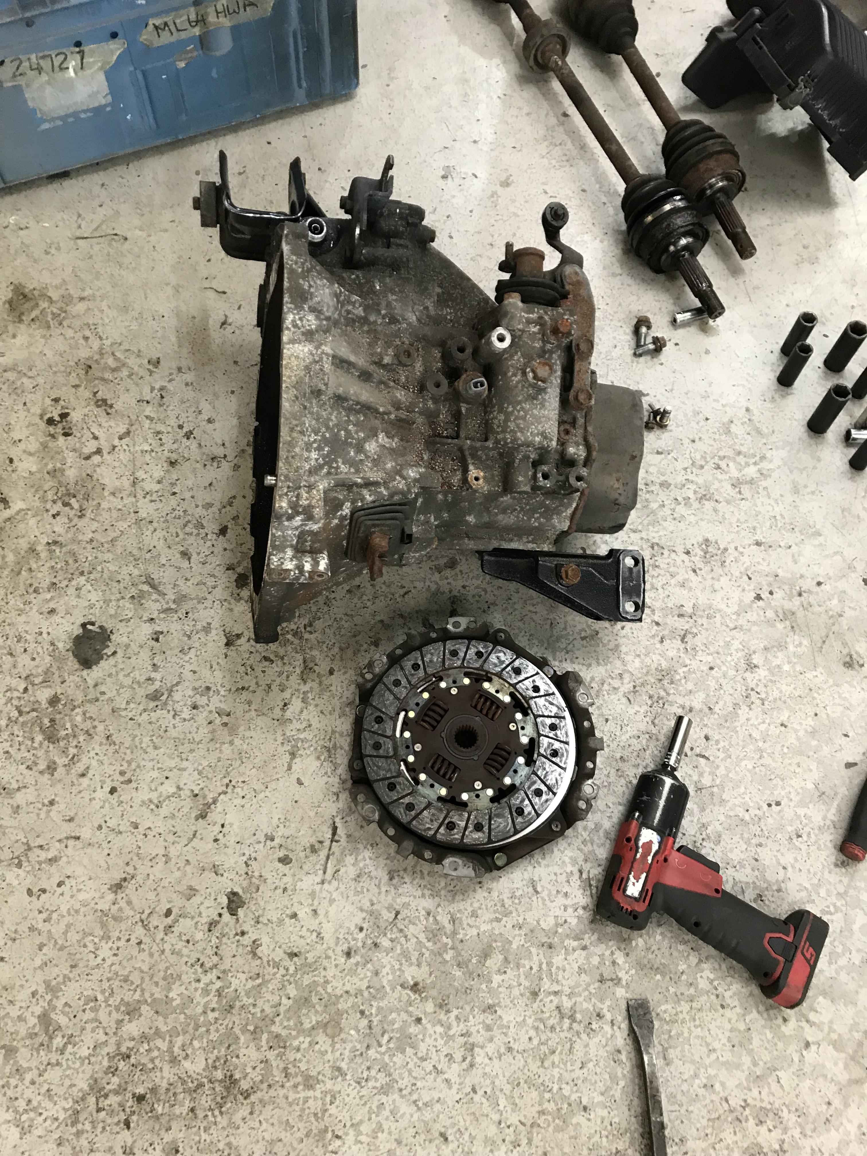

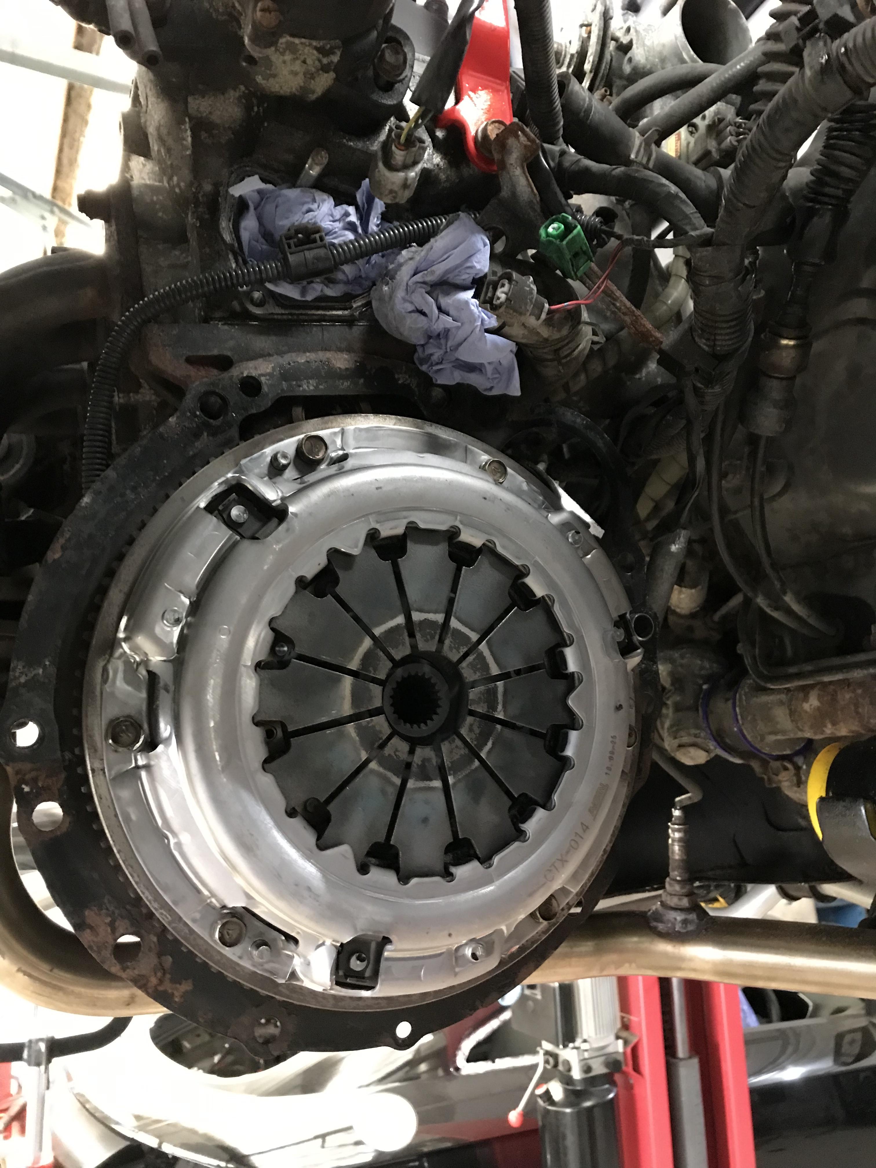

stevie82 Posted August 3, 2019 Author Posted August 3, 2019 I gave the box a small clean whilst it was out and fitted a new aisin clutch, old one didn’t look too worn even though the pedal felt high but the release bearing was a bit buggered so glad that’s been donebeforeafter Quote

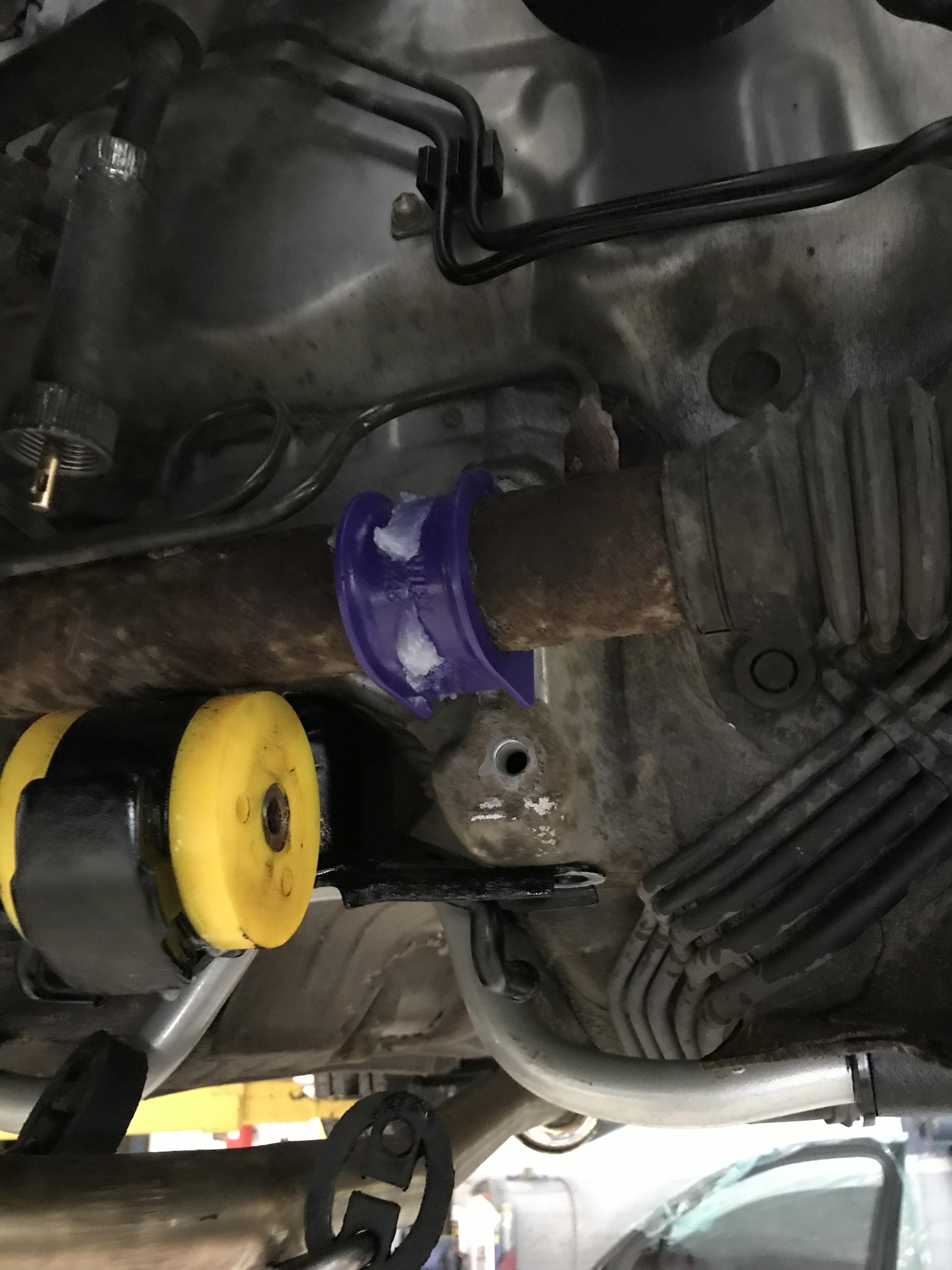

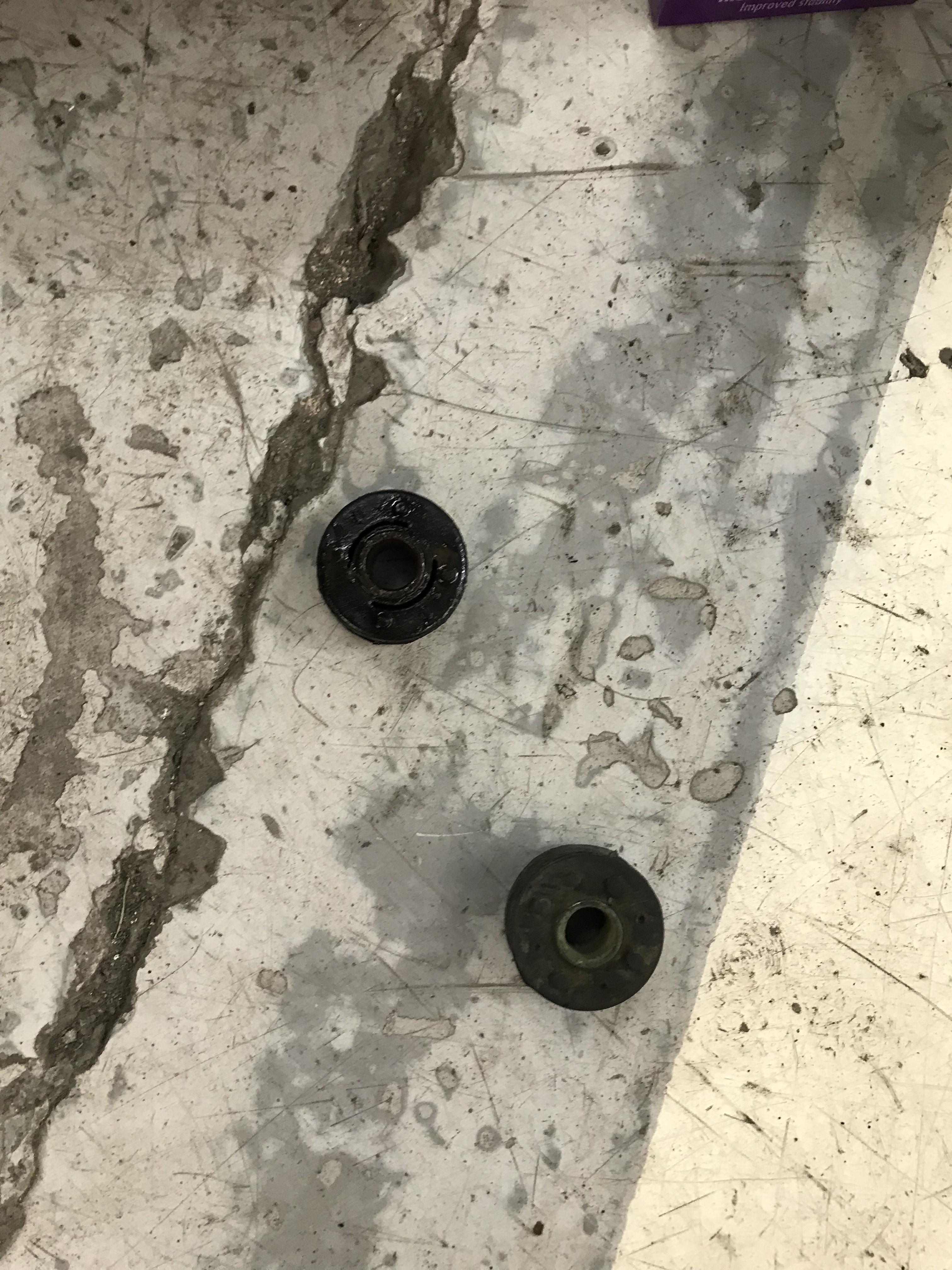

stevie82 Posted August 3, 2019 Author Posted August 3, 2019 With the box being out it made access easier to do a couple of other jobs, fitted solid shifter bushes (also going to be fitting a hypersport short shift)old rubber bushesnew solid bushes Quote

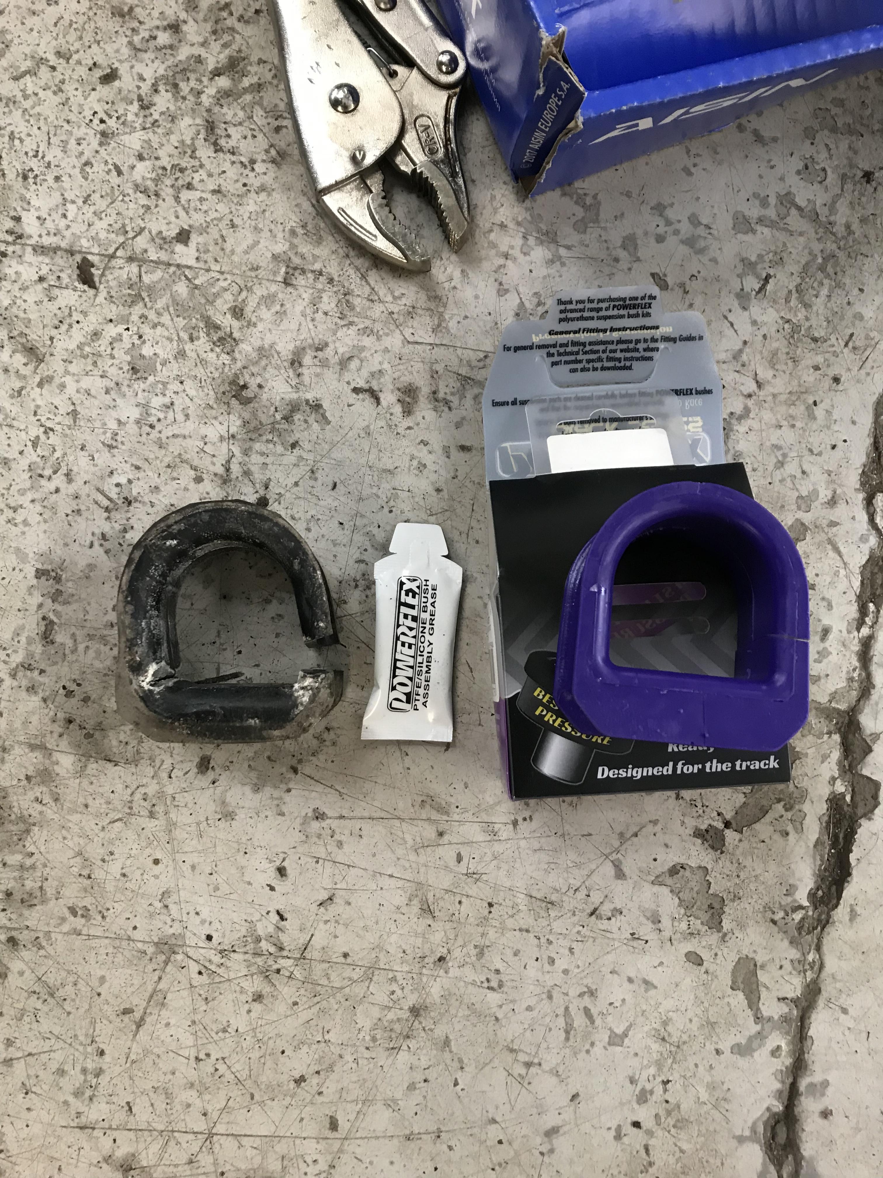

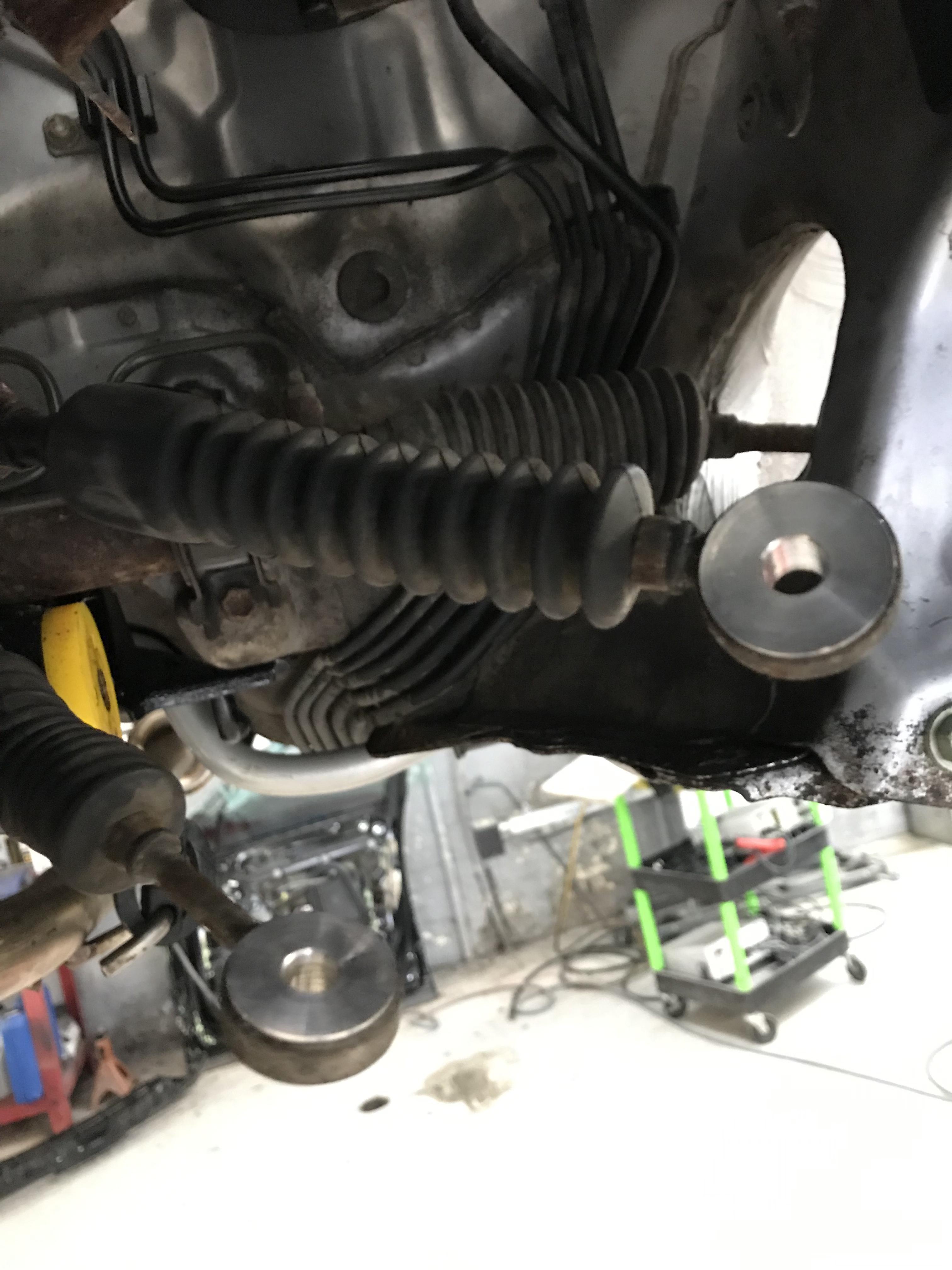

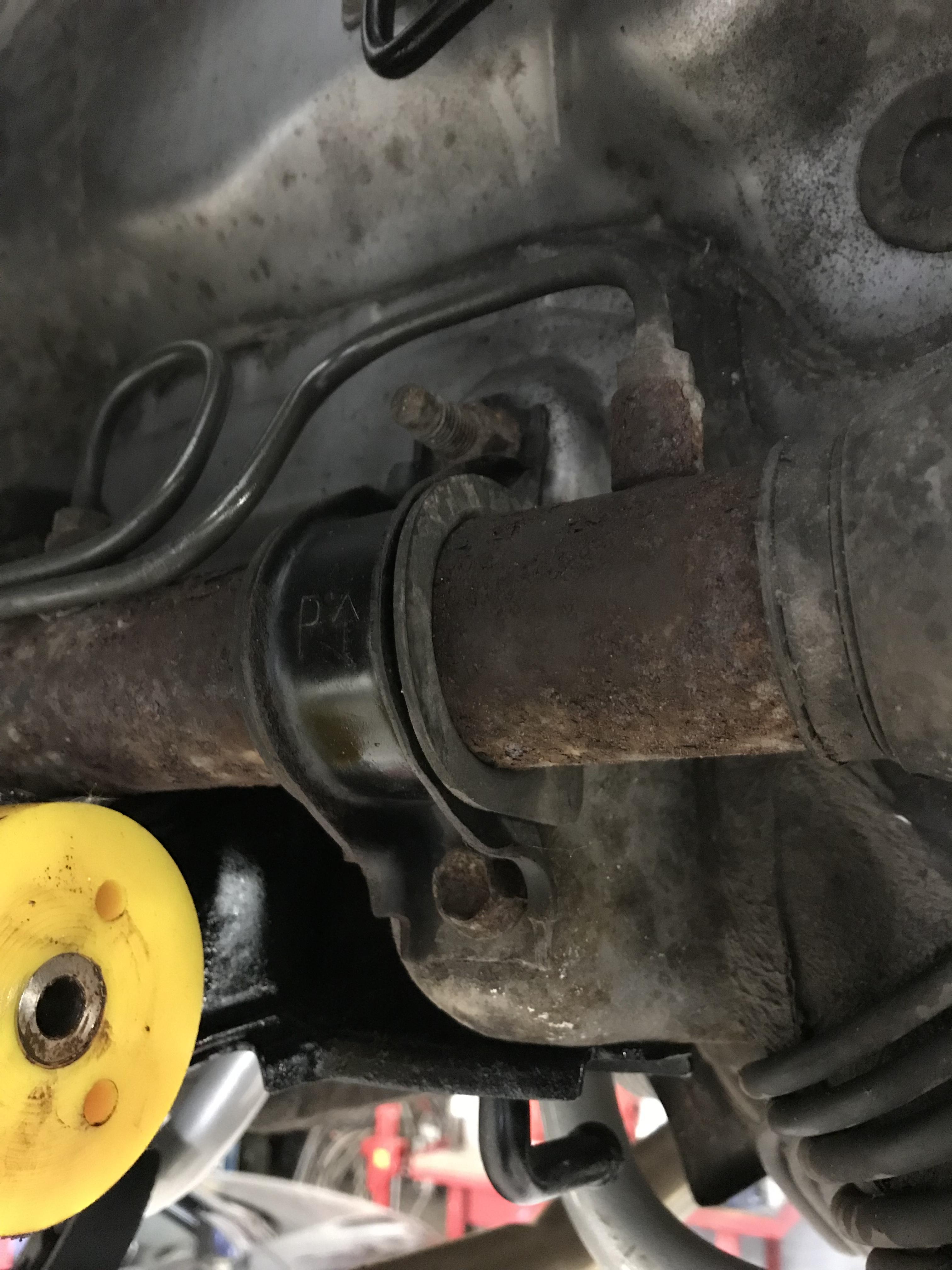

stevie82 Posted August 3, 2019 Author Posted August 3, 2019 Also fitted the power flex rack d bushes I’ve had for a while too Quote

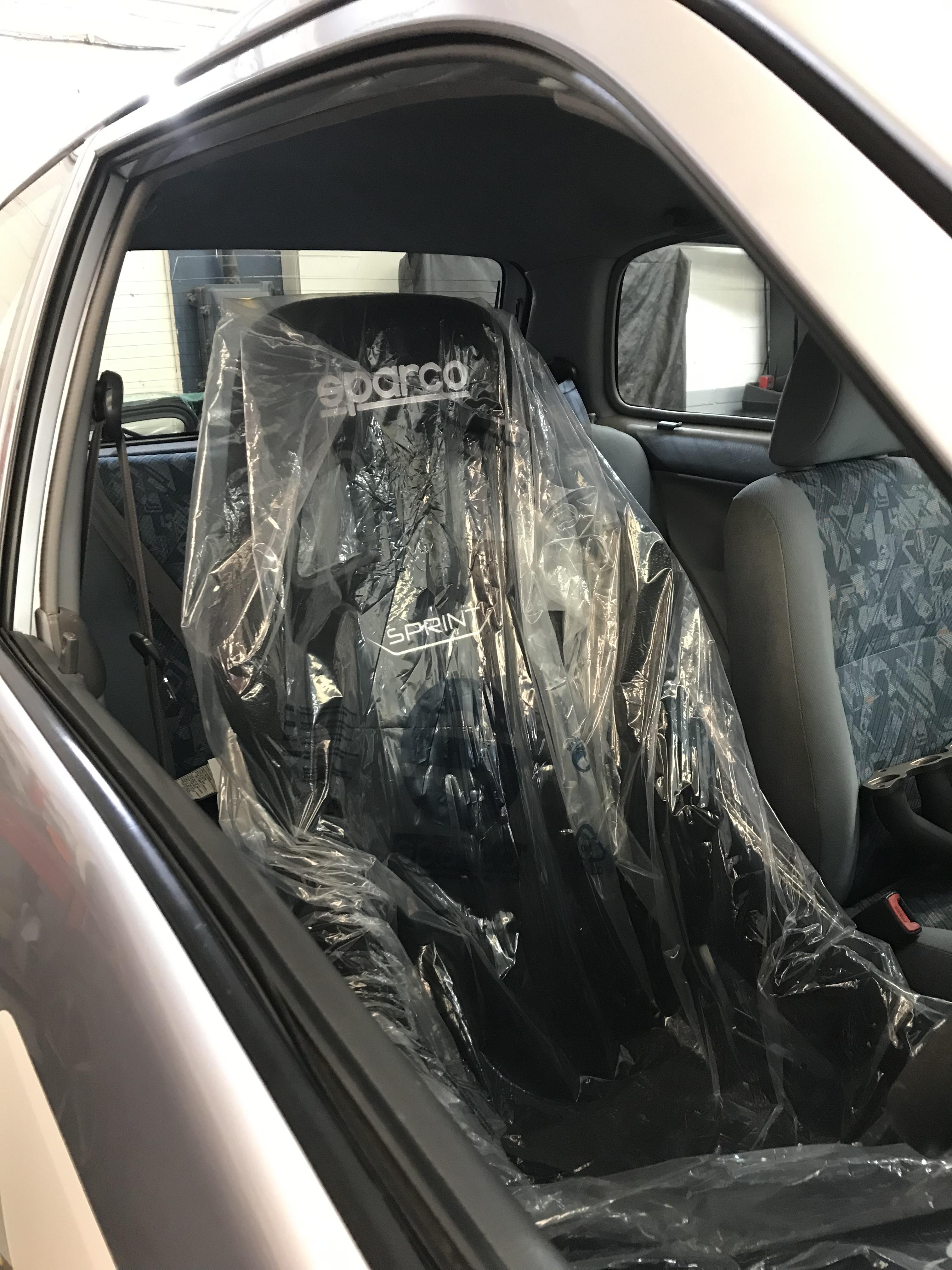

stevie82 Posted August 3, 2019 Author Posted August 3, 2019 All back together just need to fill gearbox with but ran out of time so will do it Monday and report back how it drivesand one with the seat fitted that’s all till next week, all comments welcome Quote

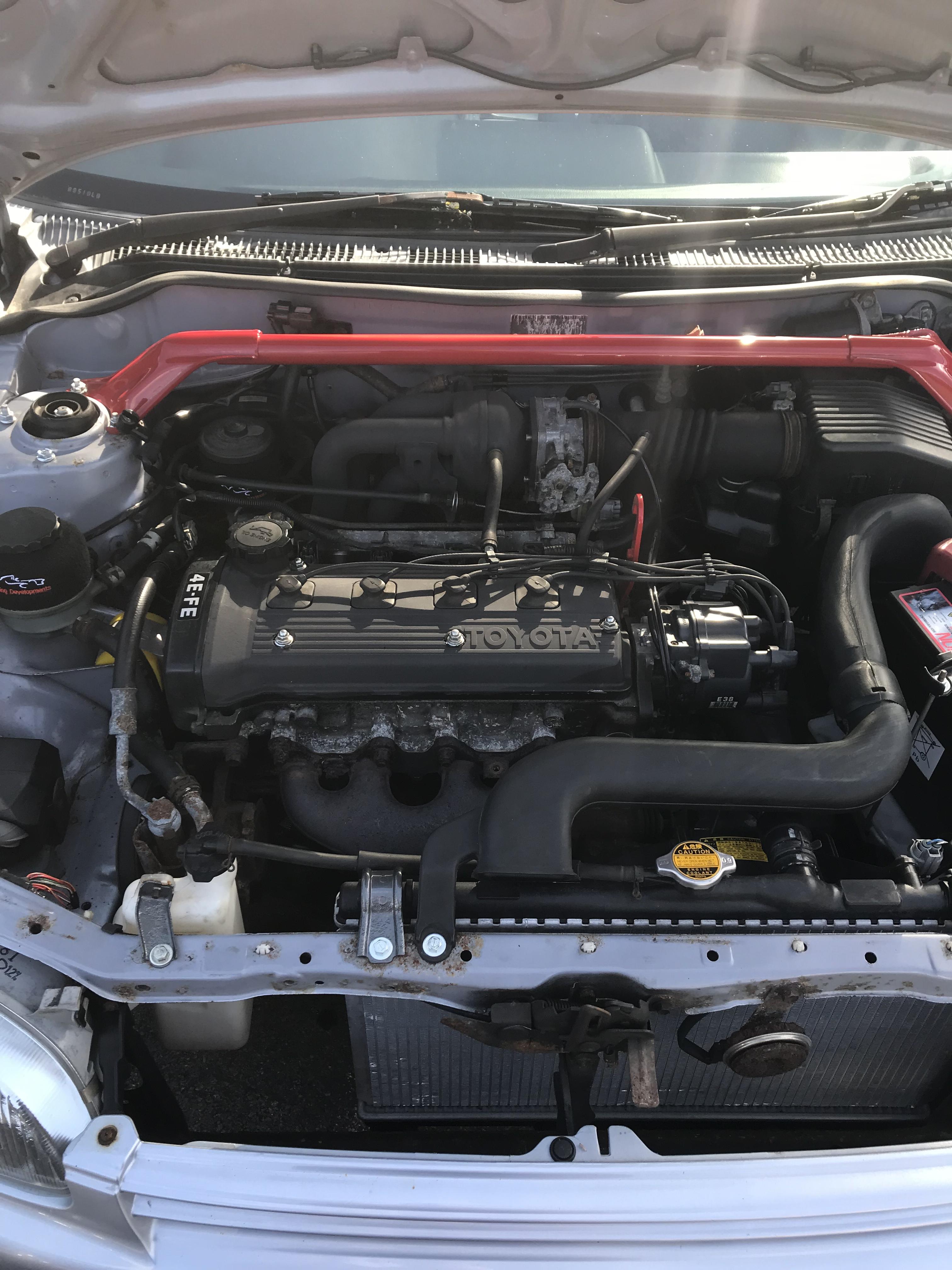

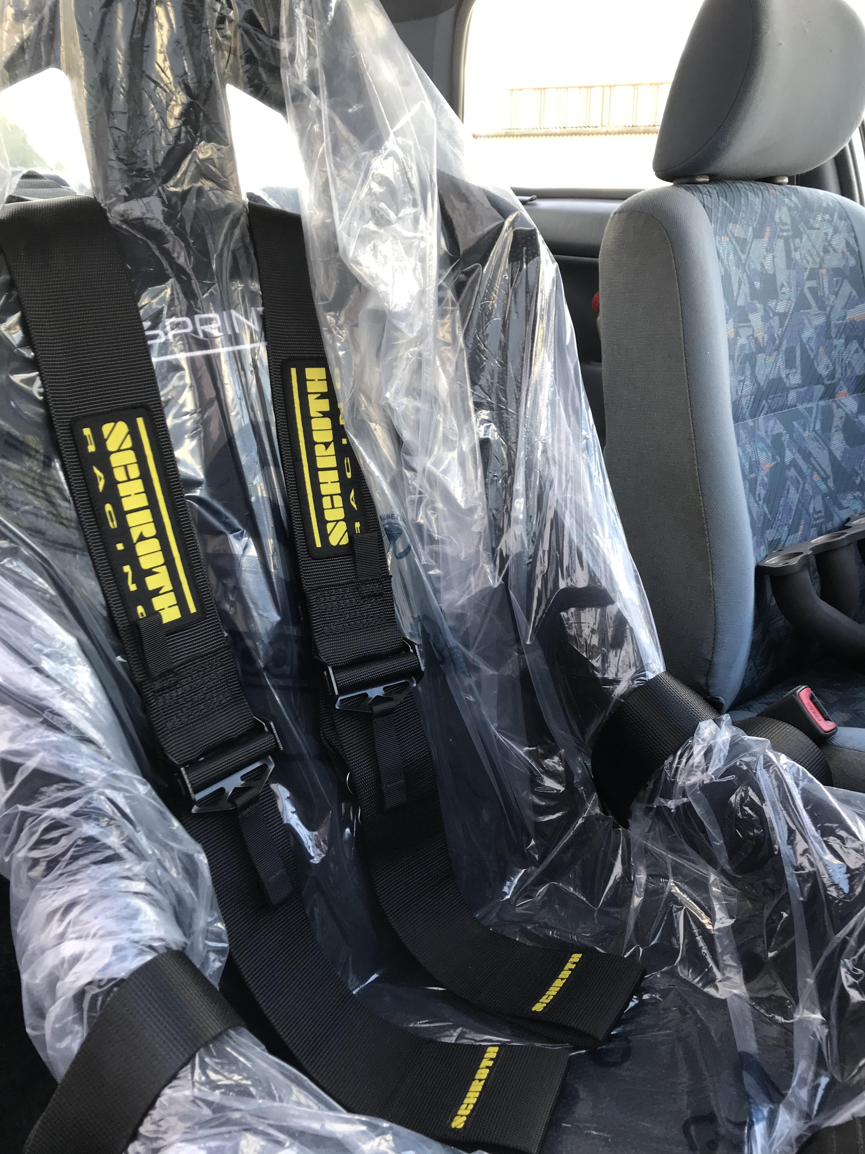

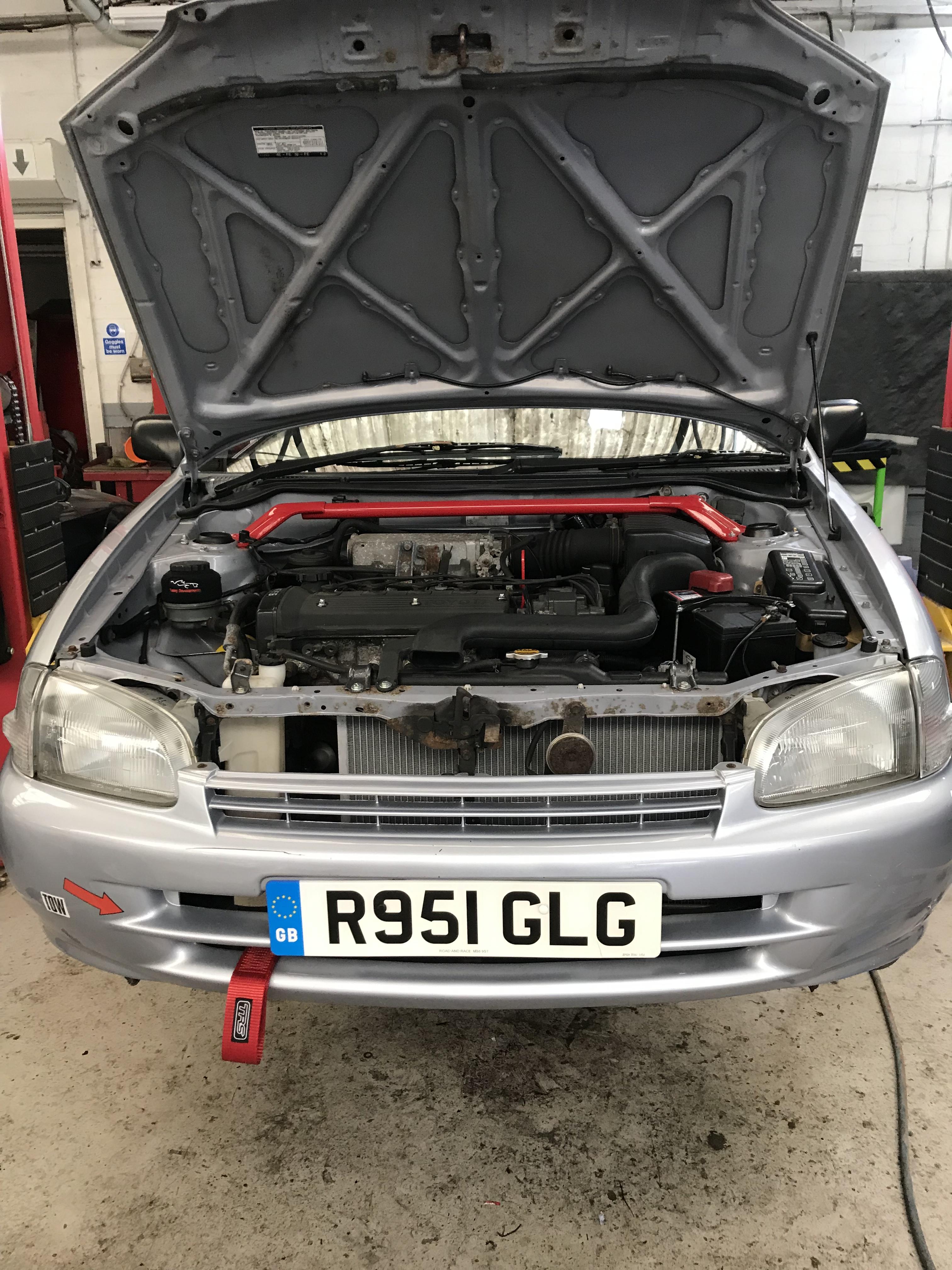

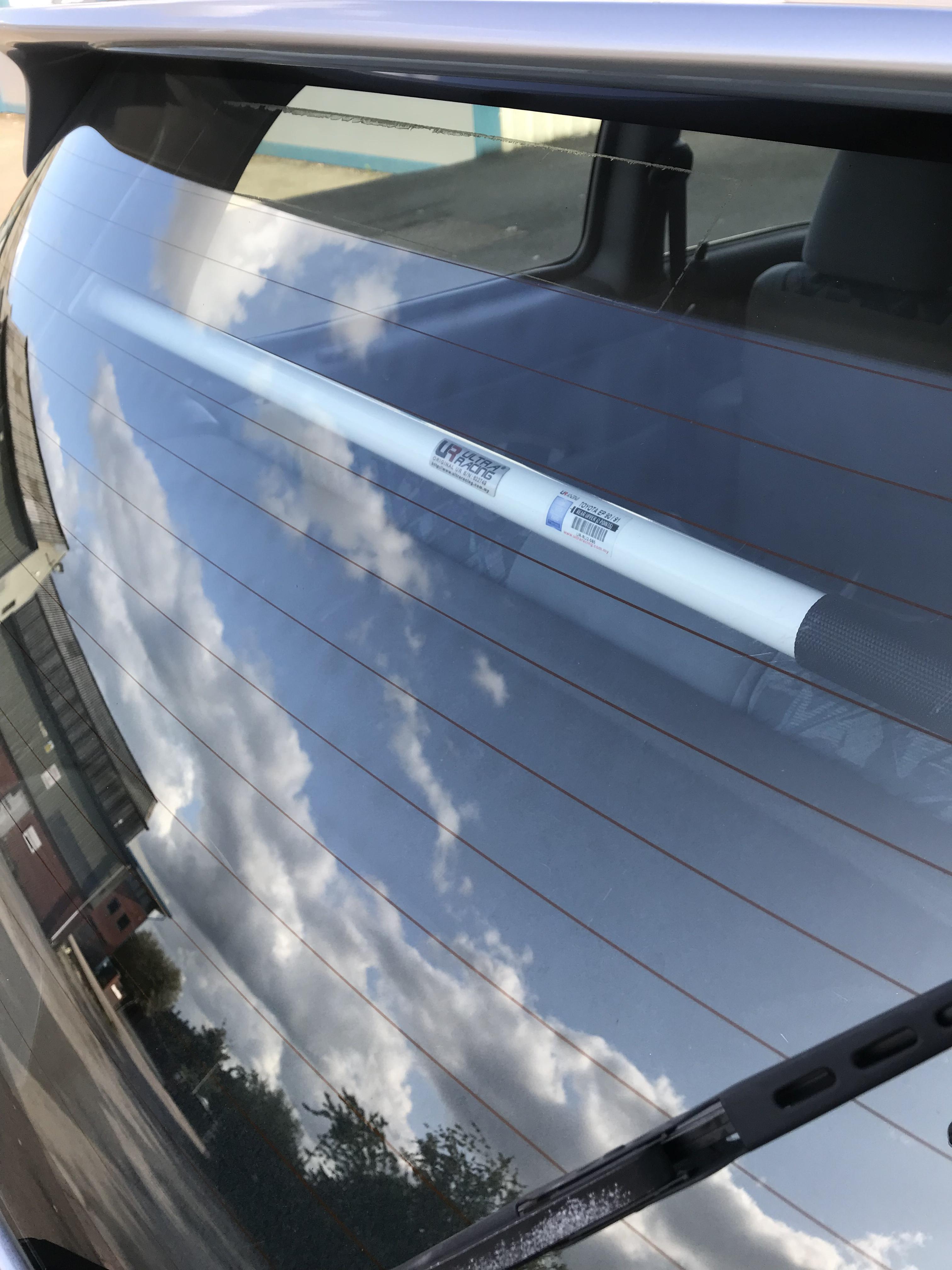

stevie82 Posted August 5, 2019 Author Posted August 5, 2019 C pillar bar turned up today so got it fitted along with my belt, inlet gaskets also turned up too ( was like Christmas morning) so need to get the inlet done Quote
akyakapotter Posted August 5, 2019 Posted August 5, 2019 Looking good dude is that's your harness was attached to the cpillar bar if so that's really not a good idea. Quote
stevie82 Posted August 5, 2019 Author Posted August 5, 2019 It’s just a mock up, it will be bolted with eyelets through the floor with support plates Quote
maerijn Posted August 6, 2019 Posted August 6, 2019 12 hours ago, stevie82 said: It’s just a mock up, it will be bolted with eyelets through the floor with support plates bolting it down to the floor is not a good idea either, in a crash it will rip through the seat and crush you down. You need to add a bar behind the seat at shoulder height Quote
stevie82 Posted August 6, 2019 Author Posted August 6, 2019 It’s for time attack, what I’m using is perfectly safe and if the plate I’m using rips through the floor it would be the least of my problems. ideally I would mount it to a cage but it’s not having one and doesn’t need one to compete in the class it will be running in but thanks for the concern Quote
stevie82 Posted August 24, 2019 Author Posted August 24, 2019 (edited) Finally got round to fitting the Corolla inlet, just got brakes to fettle then it’s off to the Dyno for a laugh !!! Edited August 27, 2019 by stevie82 Quote

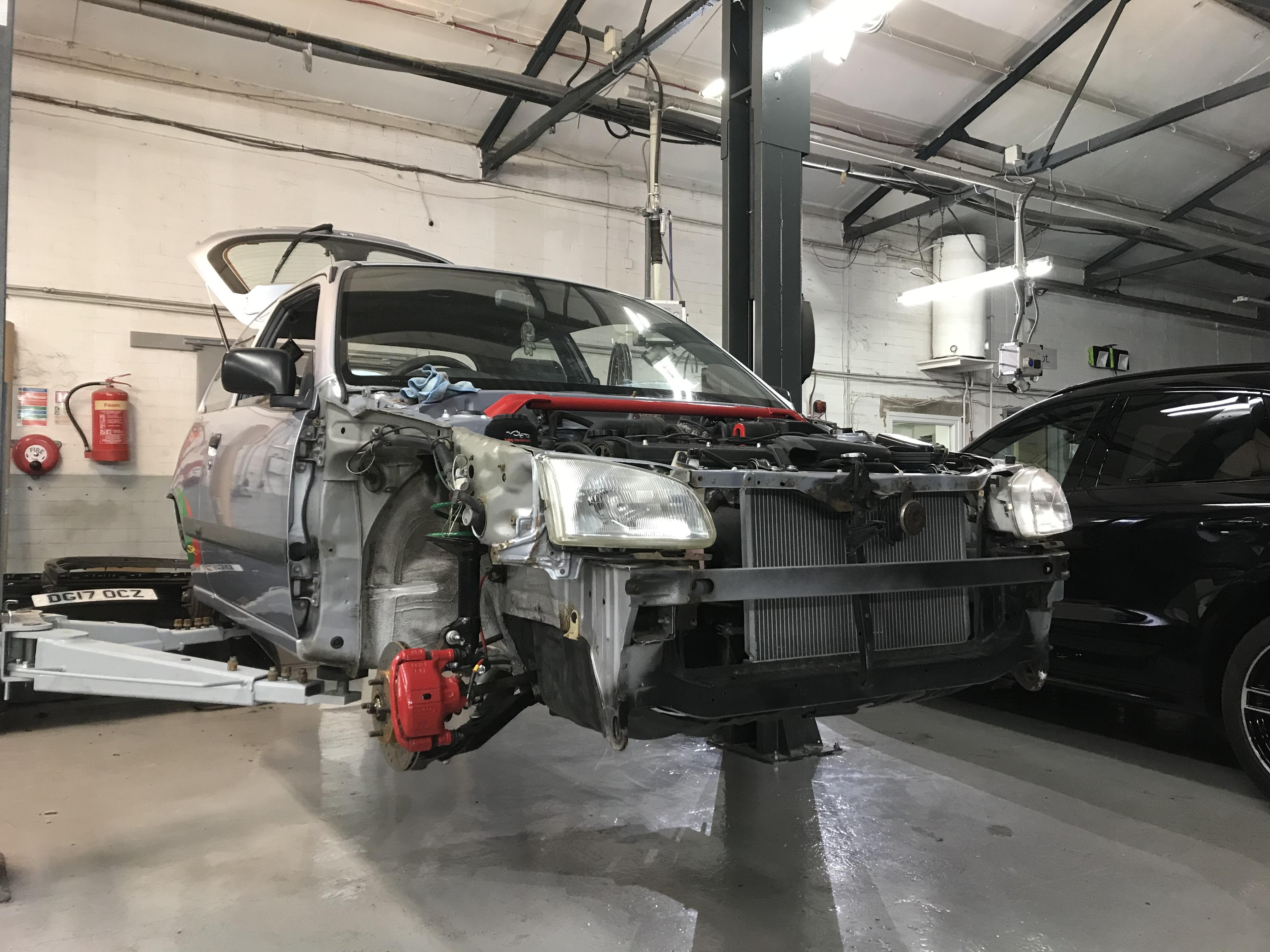

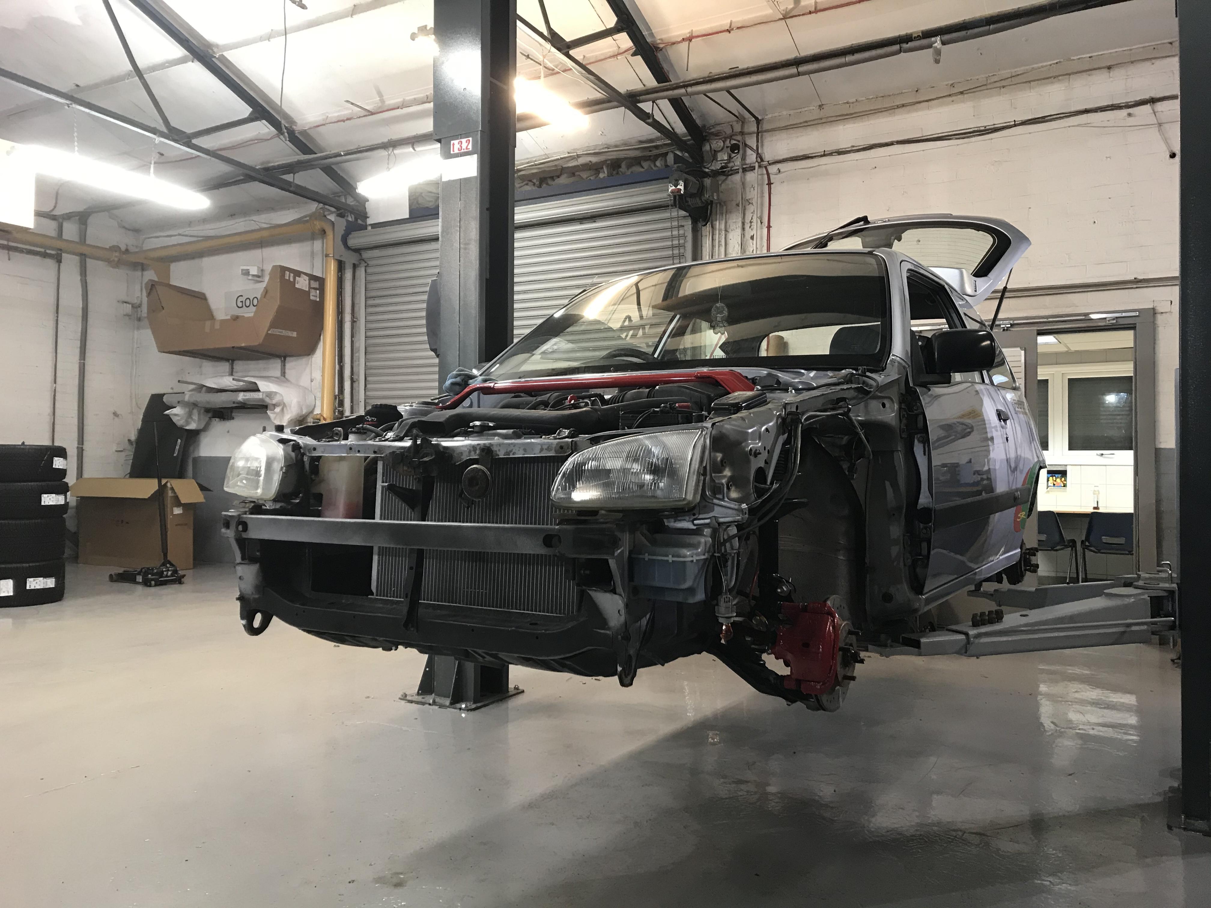

stevie82 Posted January 1, 2020 Author Posted January 1, 2020 Not been on for a while and work on the sr has slowed a little but it will definitely be ready for this years tss. I’ve decided to change the bonnet and drivers wing due to damage from previous owners and change the bumpers as I don’t like the smoothed ones that are on it now Quote
stevie82 Posted January 1, 2020 Author Posted January 1, 2020 I have managed to do some jobs though Quote

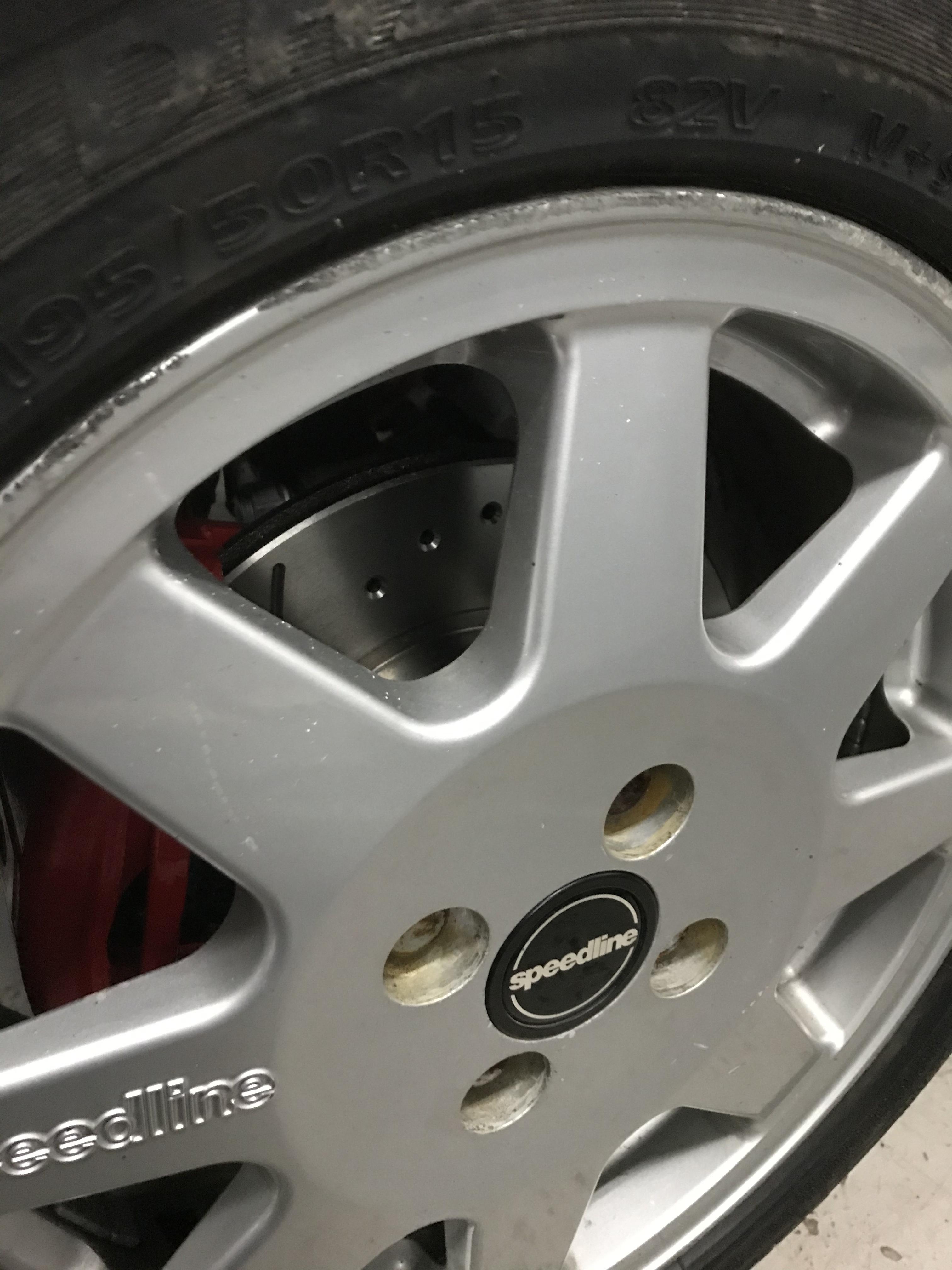

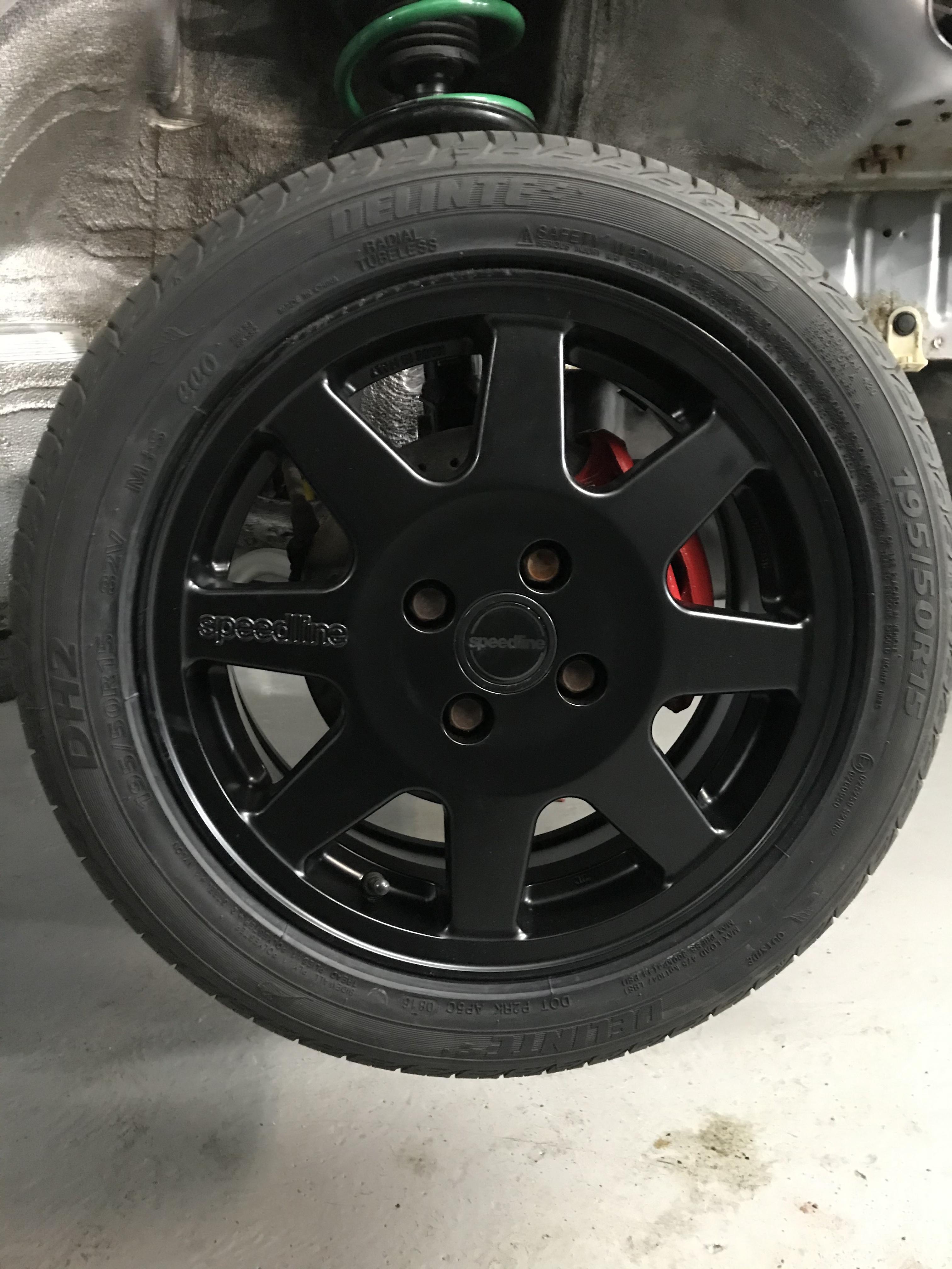

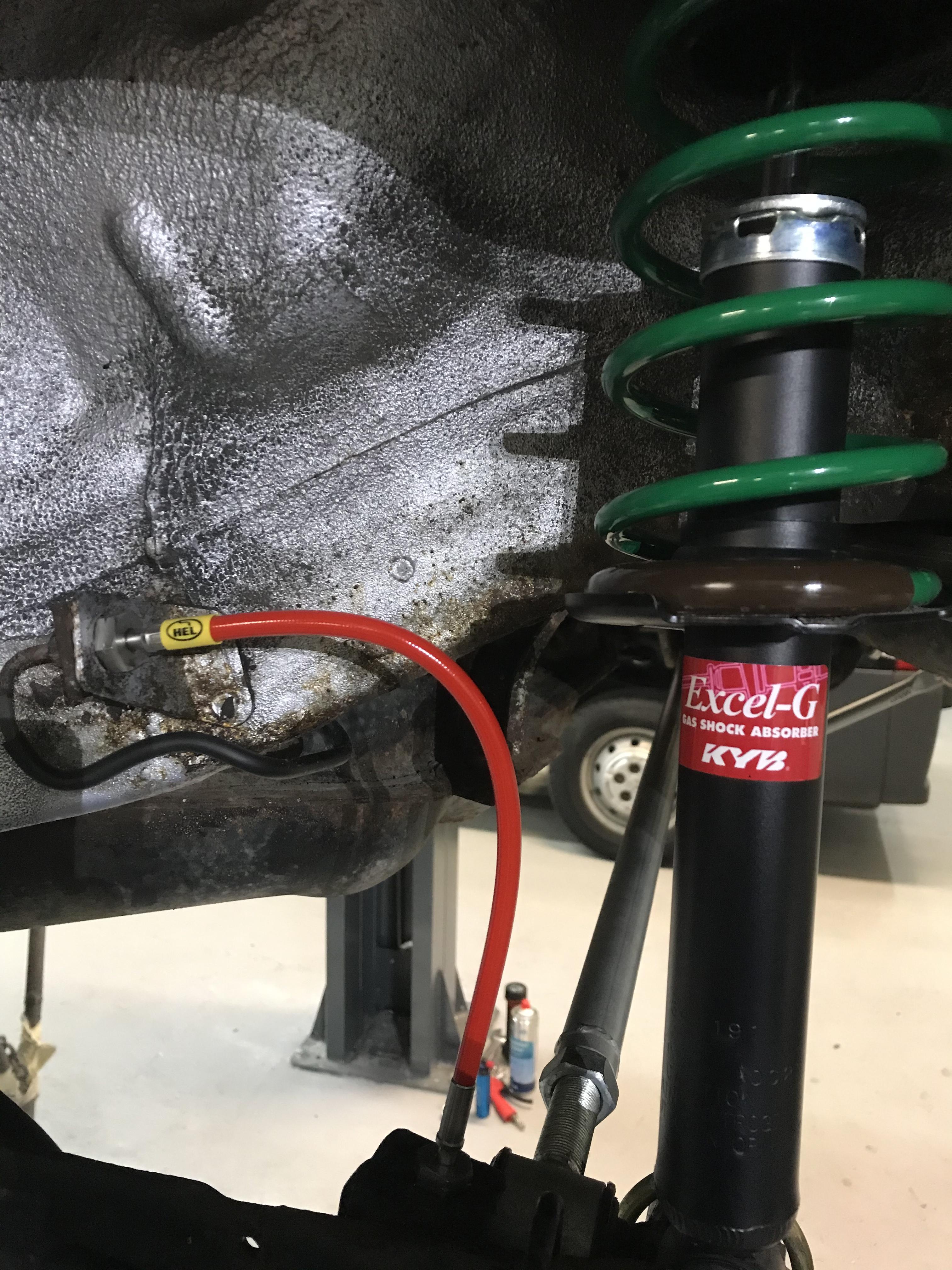

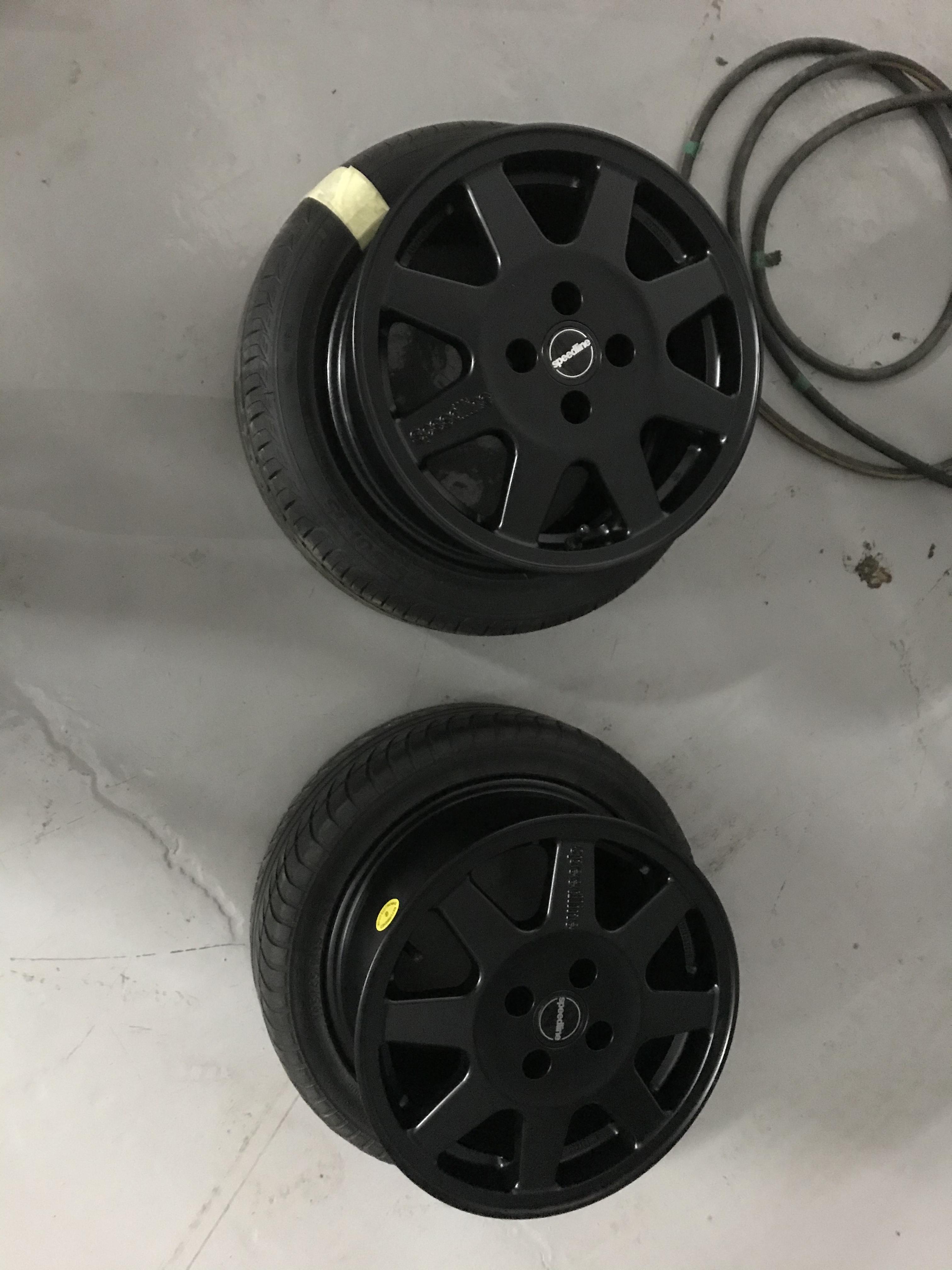

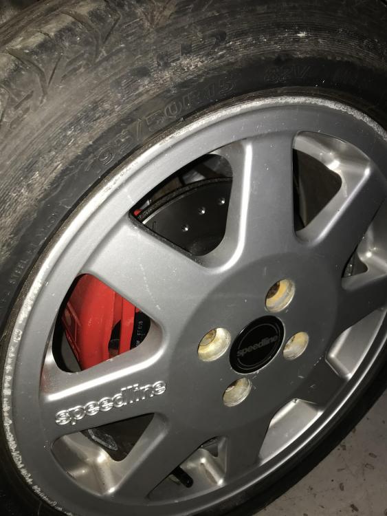

stevie82 Posted January 1, 2020 Author Posted January 1, 2020 Finall got front brakes done too and wheels are away for refurb Quote

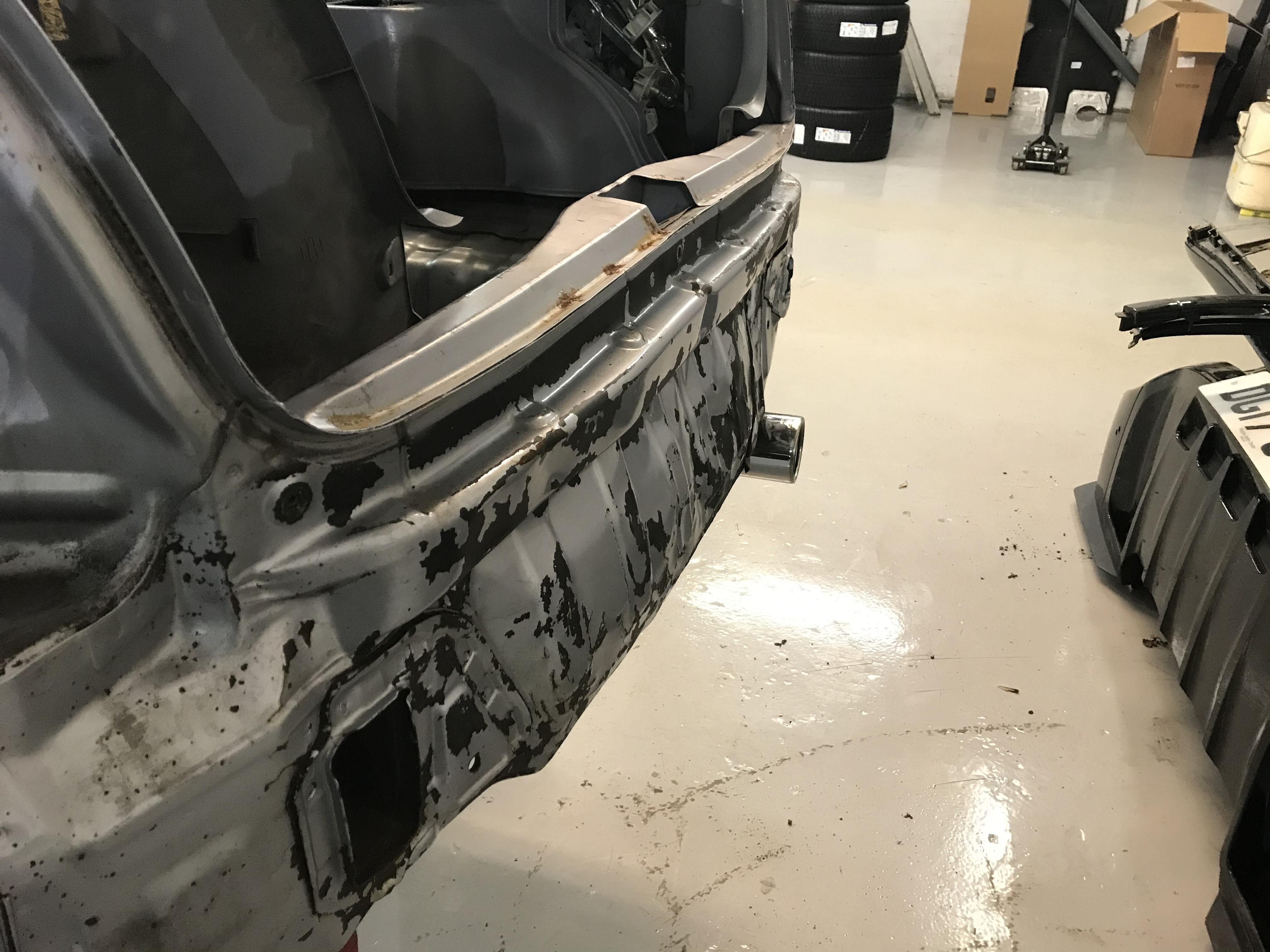

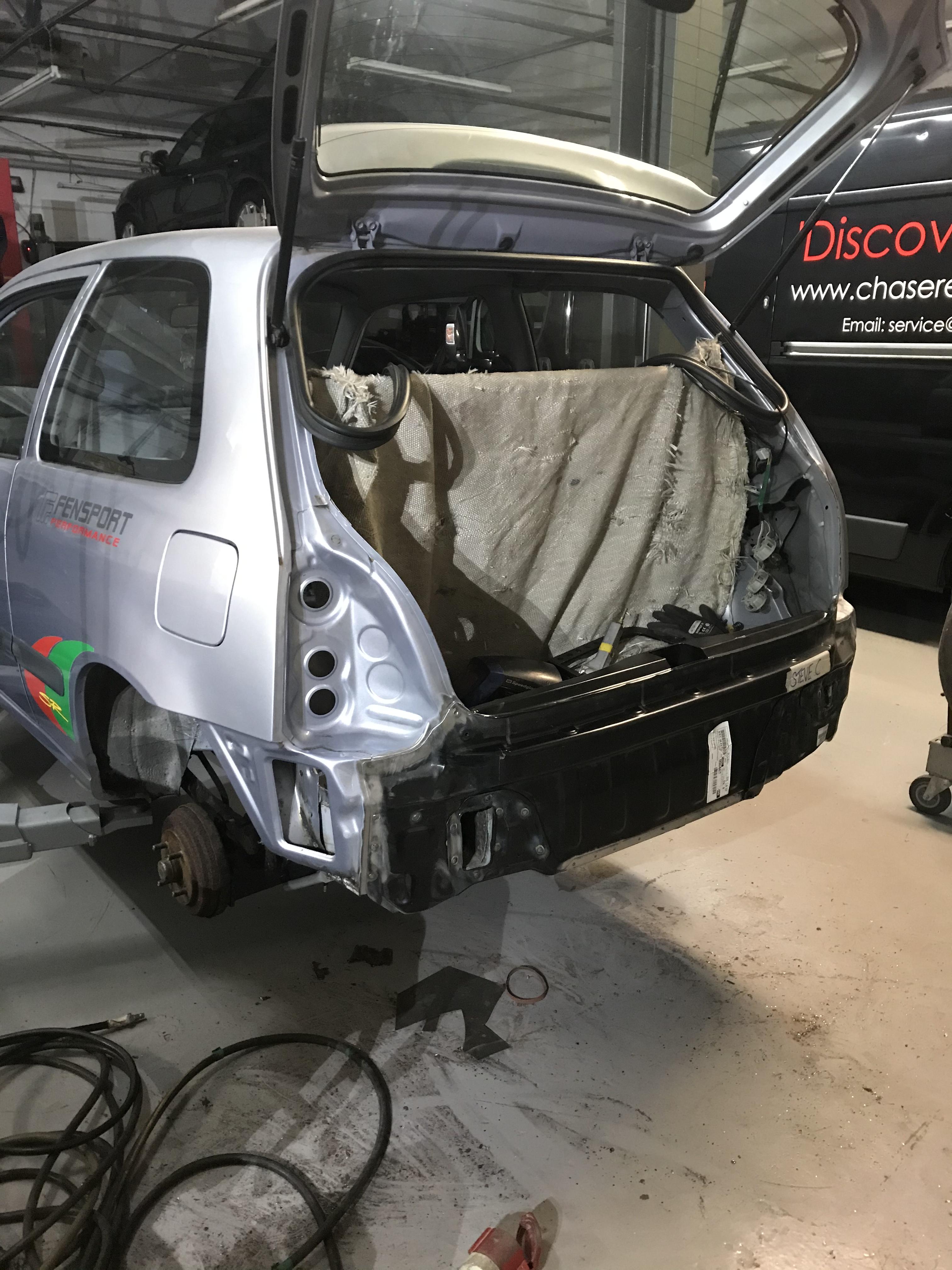

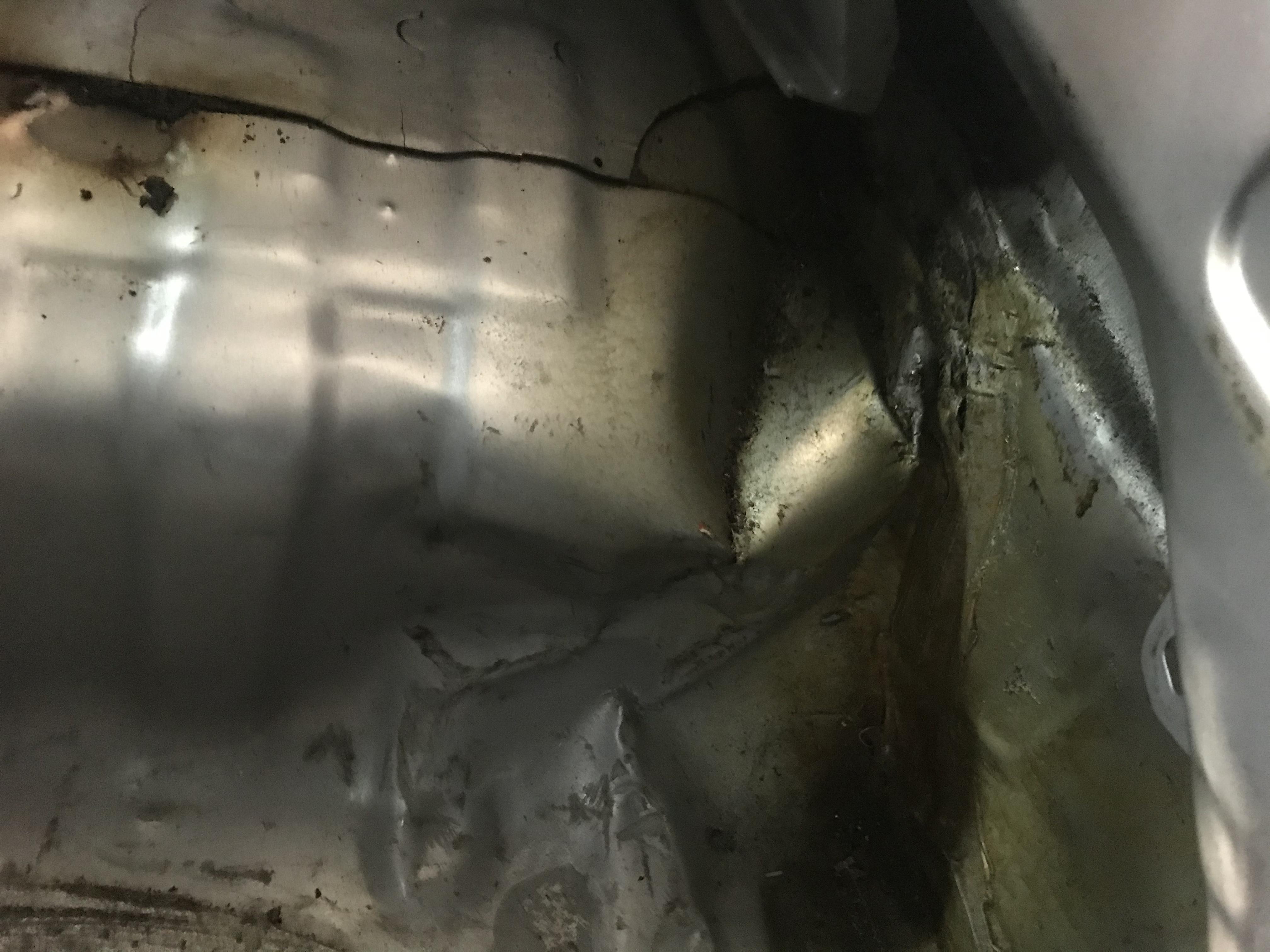

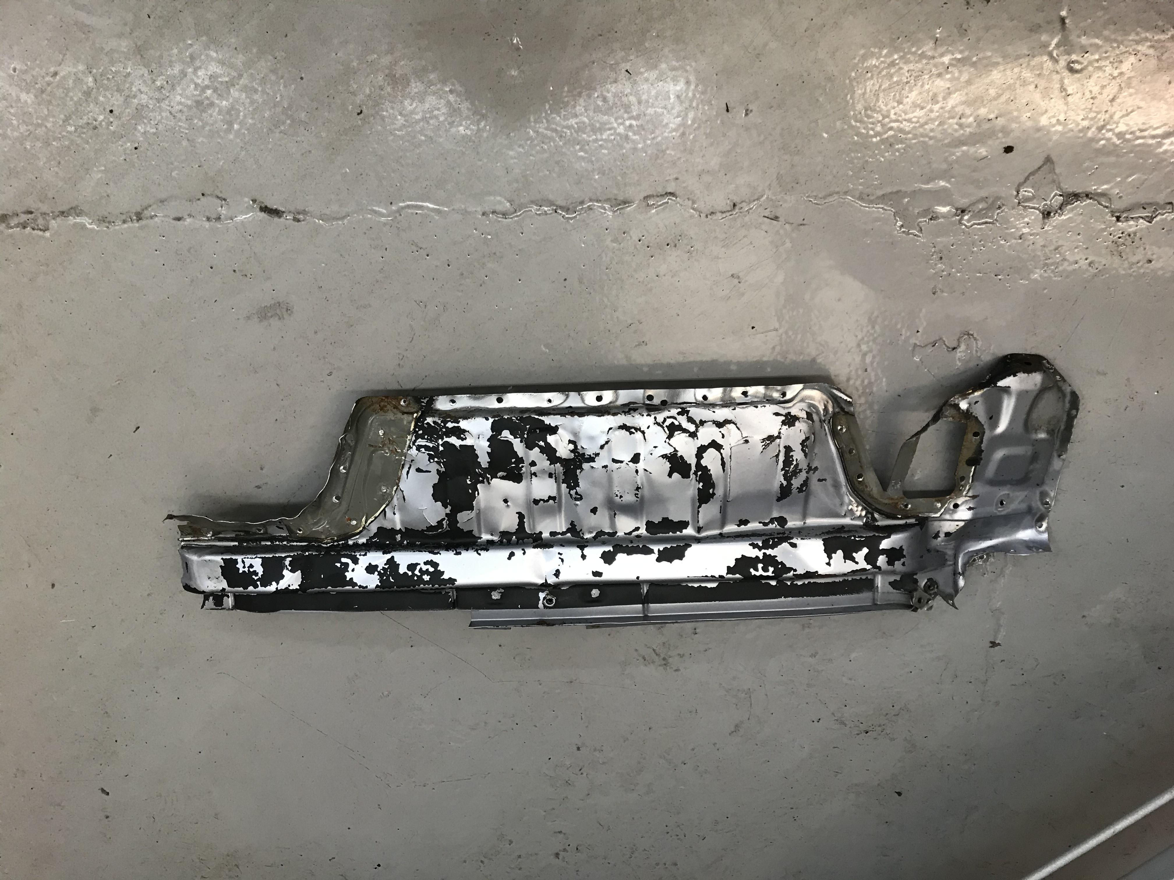

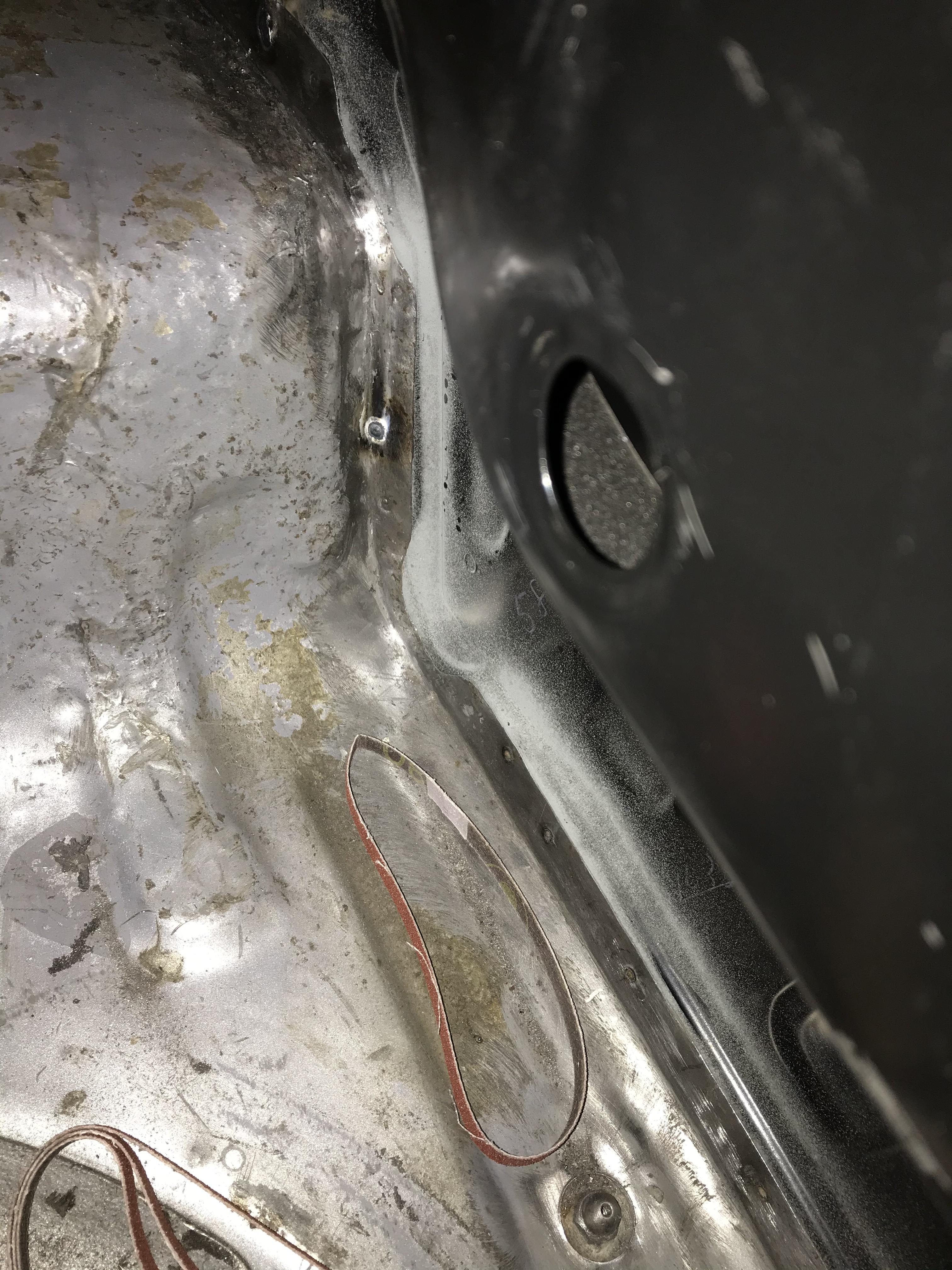

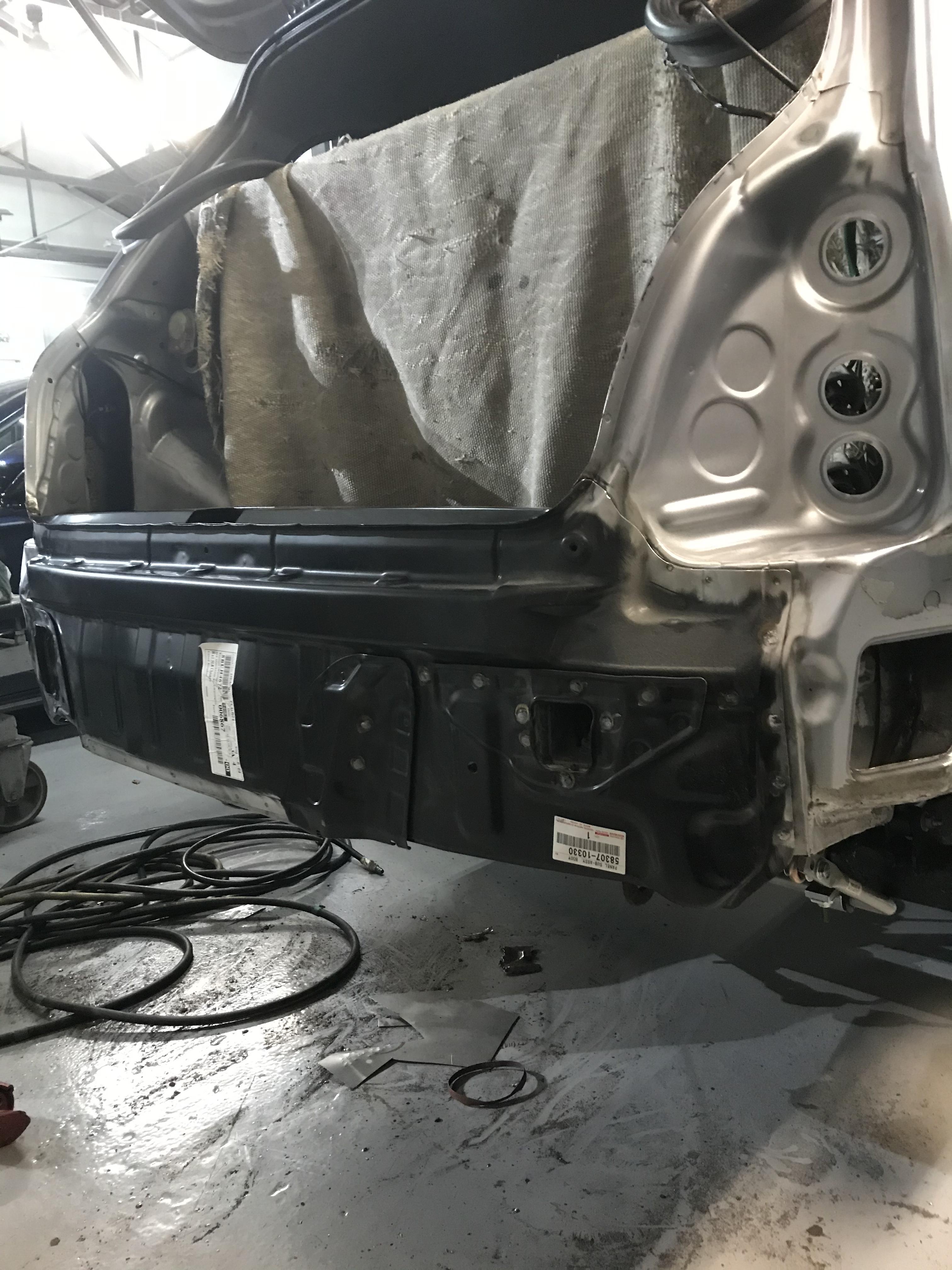

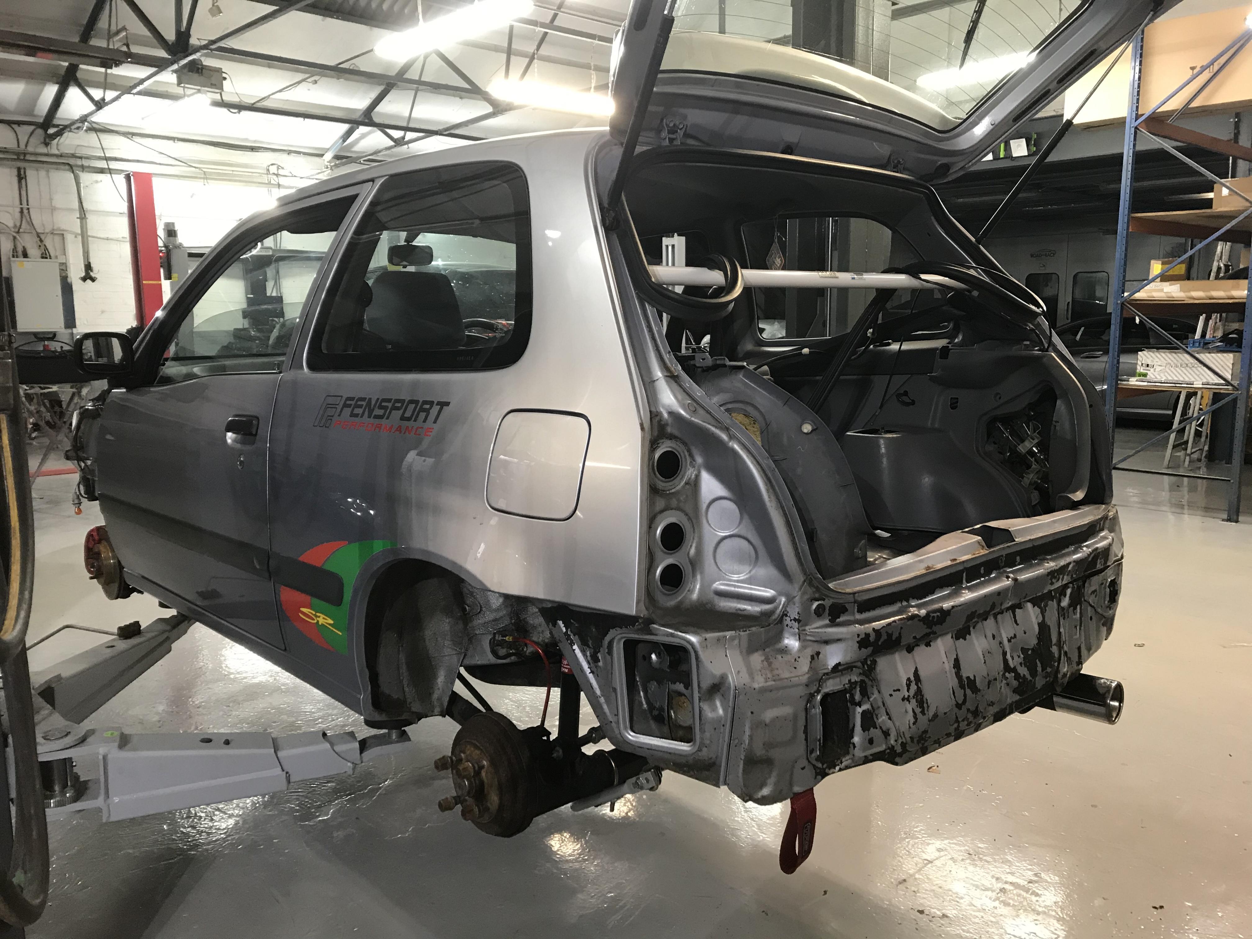

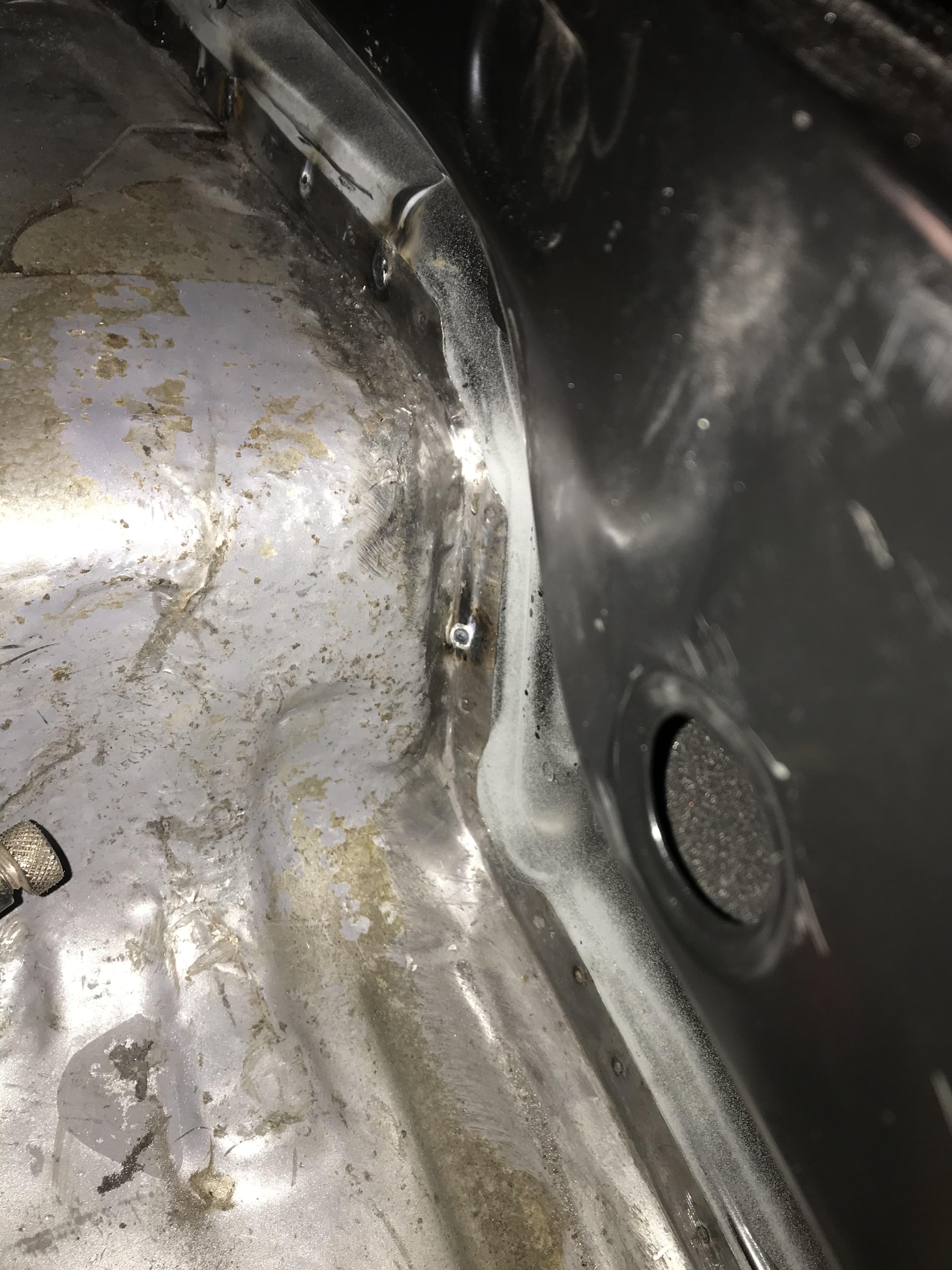

stevie82 Posted January 9, 2020 Author Posted January 9, 2020 I knew the car had been involved in a rear end shunt at some point of its life as I noticed the boot floor was creased when I went to view the car so was prepared to fix it properly..... even though the back panel was £240 from Toyota 😱 Quote
stevie82 Posted January 9, 2020 Author Posted January 9, 2020 All pulled out plenished and lined up with new back panel spot welded in 😀 Quote
