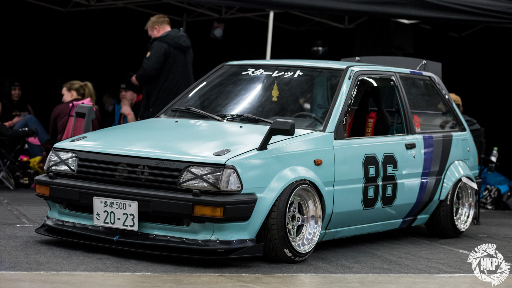

whitestar Posted October 16, 2017 Author Posted October 16, 2017 (edited) Hi again! Almost a year has passed and all the photos have disappeared. This is my EP70 from yesterday. Edited October 16, 2017 by whitestar Quote
Teun Posted October 18, 2017 Posted October 18, 2017 On 16-10-2017 22:55:28, whitestar said: Hi again! Almost a year has passed and all the photos have disappeared. This is my EP70 from yesterday. Sick! What are the specs of the wheels? Quote
whitestar Posted October 18, 2017 Author Posted October 18, 2017 They're 14x9.5" at front and 14x10" at back. All are ET15, but rear has 5mm spacers to clear the beam and front has 3mm spacers to clear the brakes. Quote
