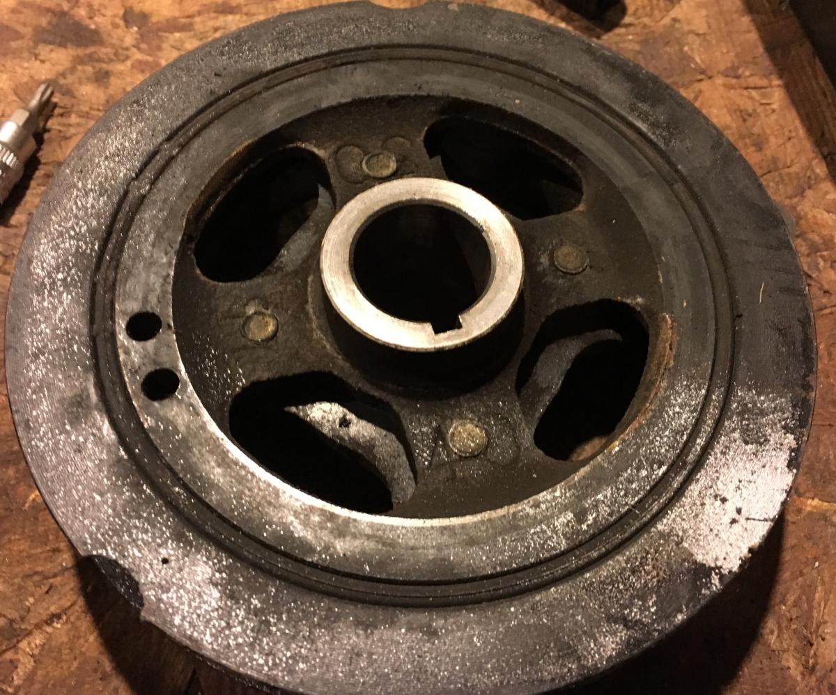

Can you use a FE crank pulley on an FTE engine
  On 11/27/2016 at 11:06 PM, Starlet__SR said:
Mixed opinions on this. Me personally would stick with the FTE pulley as it's dampened.
Have a read of this
http://www.atiracing.com/products/dampers/damper_dinan.htm
Dampened that's what I was looking for.
Read through that, sounds a bit worrying but just heard of people doing it before with no problems
  On 11/27/2016 at 11:06 PM, gorganl2000 said:
i've used the 4efe crank on both a 4efte and 5efte with no problems over a number of years
Well that's good to hear. Would save me getting and replacing it with an FTE one

  On 11/28/2016 at 11:53 PM, gorganl2000 said:
plus it seems like a few persons have added turbos to their n/a 4efe---maybe some run the engine as is with the 4efe crank pulley
Seems to be done quite often in that case.
A bit off topic here, but I take it the advantages are minimal of running a lighter (4efe) pulley as compared to the heavier (4efte) pulley ?
Link to post
Share on other sites
You would not see any gains no, but the thing I like is because I'm running electric power steering I could remove the outer part of the pully as I dont need it 👍😀
