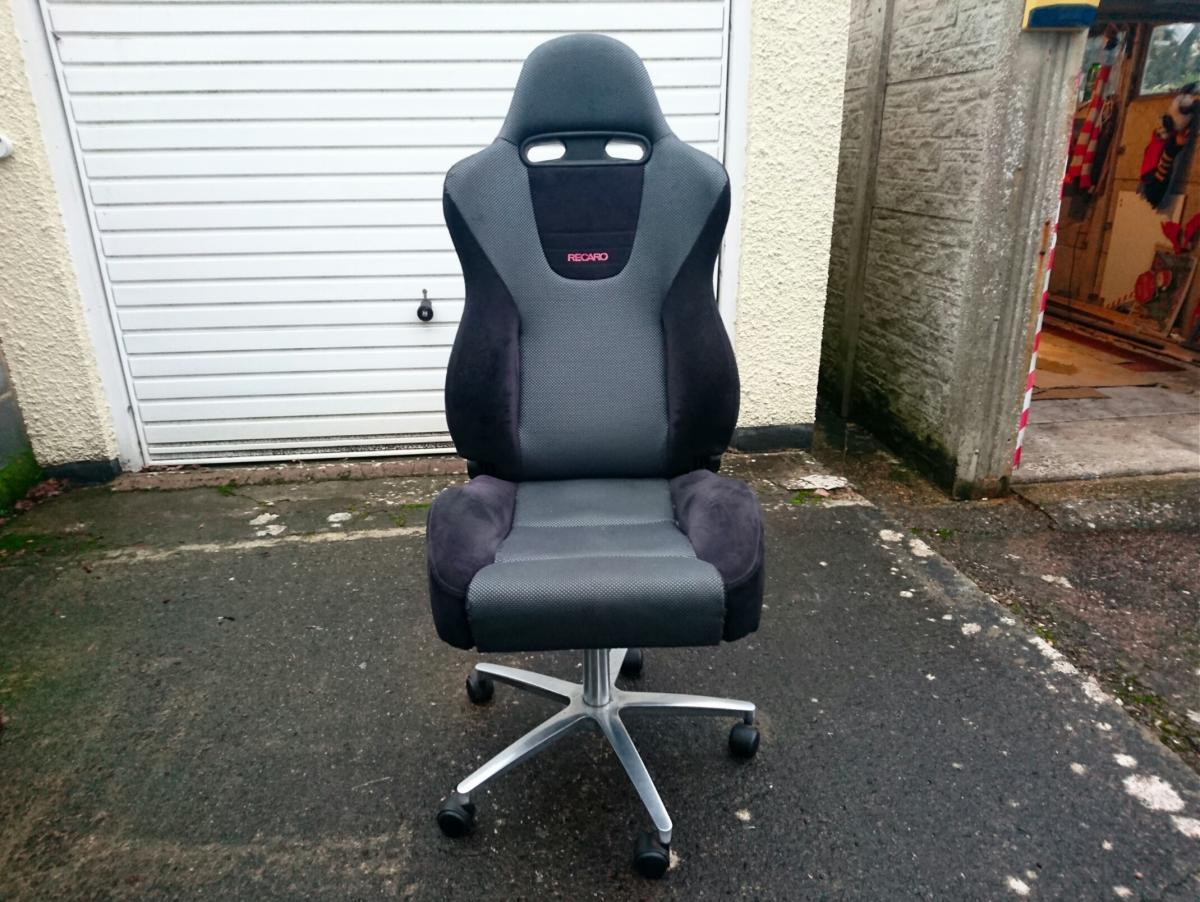

morgey Posted December 16, 2016 Share Posted December 16, 2016 Going to add a 3d printed cup/beer holder and borrow some arm rests off an old chair from work lol 👌P.s yeah the rooms a mess. Quote Link to post Share on other sites
StuDoc 72 Posted December 16, 2016 Share Posted December 16, 2016 I had a similar chair in my old work for break times. Made from a recaro out an old ford and some metal box tubing that I cut and bolted together to make a frame. Quote Link to post Share on other sites
morgey Posted December 16, 2016 Author Share Posted December 16, 2016 I had some old angle laying about i made this frame from. Im going to swap the seat in my starlet onto this so i have a better one in my car. Quote Link to post Share on other sites
StuDoc 72 Posted December 16, 2016 Share Posted December 16, 2016 Haha when I seen it I thought god thats a starlet recaro should that be in a house. Cracking all the same mate very jealous. Quote Link to post Share on other sites
morgey Posted December 16, 2016 Author Share Posted December 16, 2016 Now I've got it i can keep changing it out for different ones 😂 Quote Link to post Share on other sites
akyakapotter Posted December 16, 2016 Share Posted December 16, 2016 I need to do this with the recaro in my na need a decent chair for work. Quote Link to post Share on other sites
morgey Posted December 16, 2016 Author Share Posted December 16, 2016 Doo it its pretty simple to do! Quote Link to post Share on other sites
akyakapotter Posted December 16, 2016 Share Posted December 16, 2016 Doo it its pretty simple to do!What did you use I have a crap office chair I can butcher. Quote Link to post Share on other sites
morgey Posted December 16, 2016 Author Share Posted December 16, 2016 I just Gutted an old office chair and its just made up of 4 bits of 1-2mm angle that was floating around the factory2x450mm for the cross bars2x300mm for the front to back runnersThe recaro pitchings are 405mm apartAnd using the front hole as a datum the 2nd hole is 25mm back and the rear one is 260mm from the front one. (Google a diagram for the pitchings)You could easily just use some 30x5mm flat bar or something similar if you dont have angle floating about Quote Link to post Share on other sites

Cammy R Posted December 19, 2016 Share Posted December 19, 2016 My seat at work, one scooby seat and a old office chair and I had everything I needed Quote Link to post Share on other sites
akyakapotter Posted January 17, 2017 Share Posted January 17, 2017 Here is my addition Quote Link to post Share on other sites
morgey Posted January 17, 2017 Author Share Posted January 17, 2017 Nice. Whats that from, Looks like an accord seat? Quote Link to post Share on other sites
akyakapotter Posted January 17, 2017 Share Posted January 17, 2017 Nice. Whats that from, Looks like an accord seat?Was sold to me an an evo recaro few years back need to redo it with box section at some point but will do for now Quote Link to post Share on other sites
