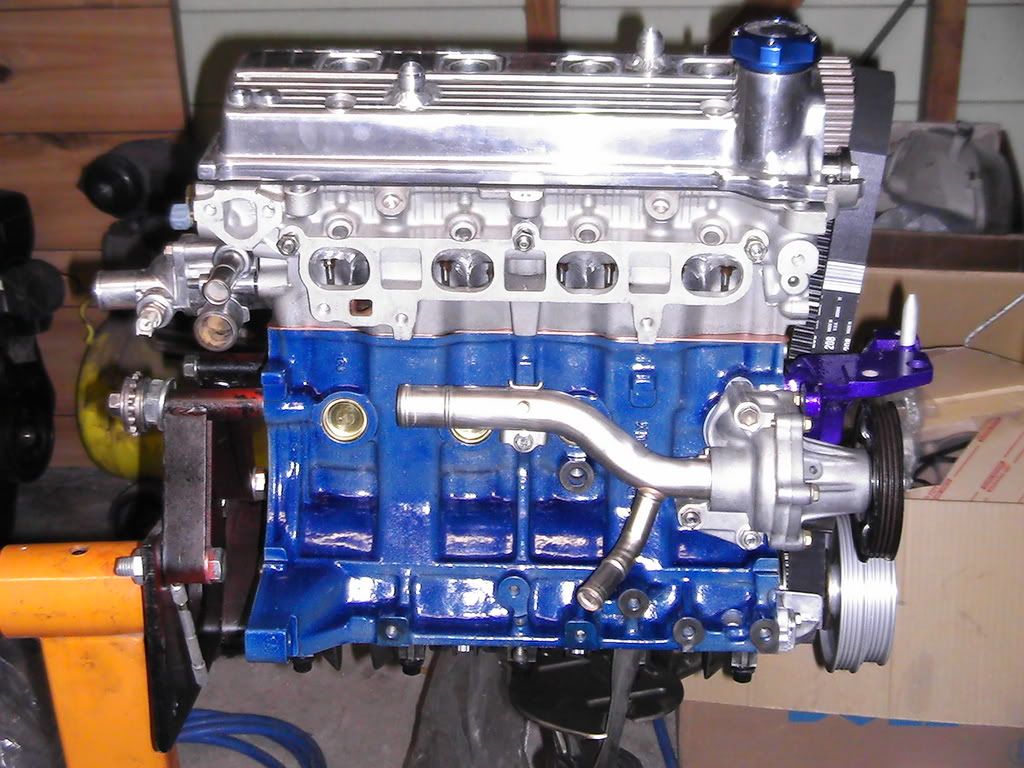

Sparky Posted July 28, 2008 Posted July 28, 2008 even your cock looks gogeous lolI agree, I mean about the block Quote
Starlet_GT3582R Posted July 28, 2008 Author Posted July 28, 2008 even your block looks gorgeous lol I agree, I mean about the block Thanks guys... here is another teaser, but thats it untill i get the rest of my shit togeather.. Cheers Cain D. Quote

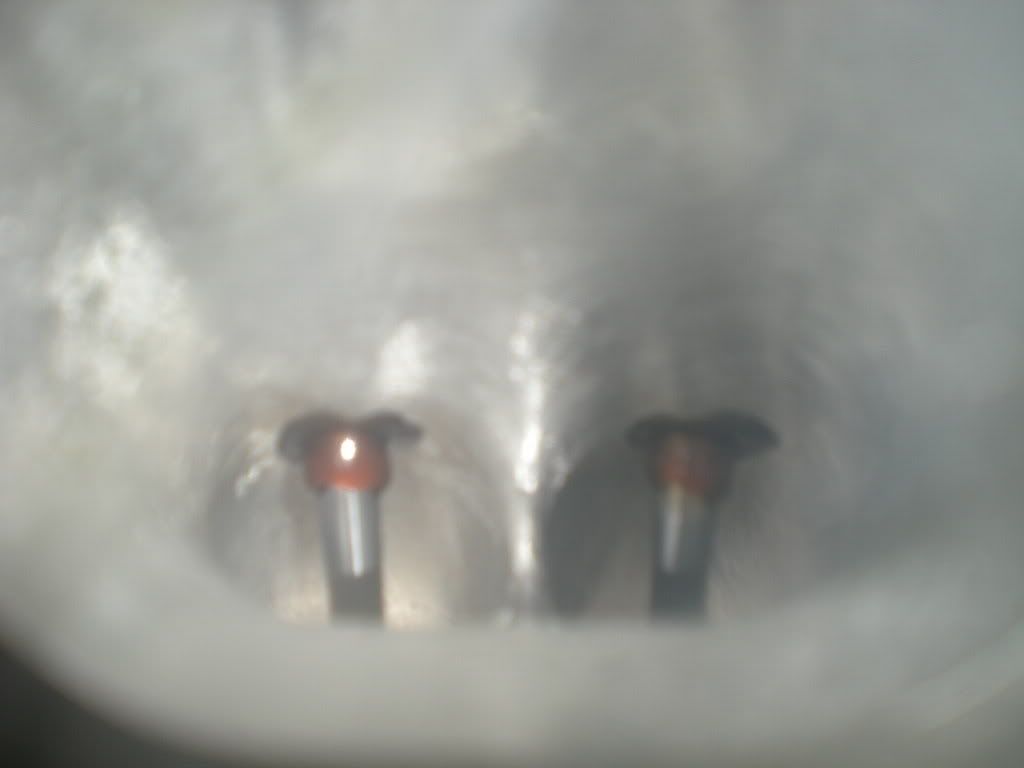

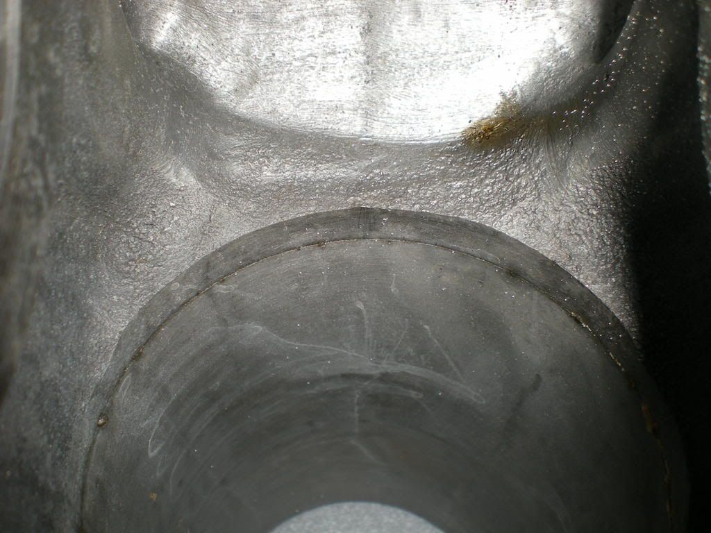

Starlet_GT3582R Posted July 30, 2008 Author Posted July 30, 2008 here is my head, with my stainless valves and O'ringing.The reason for O'ringing my head instead of my block is that my block is sleeved with chromoly sleeves, and because of the limited amount of room between the cilinders i could not fit O'rings around them, because it will push the top of the sleeve into the cilinder.Here is my CNC port job (not verry good picture as i took it through the plastic).Cheers Cain D Quote

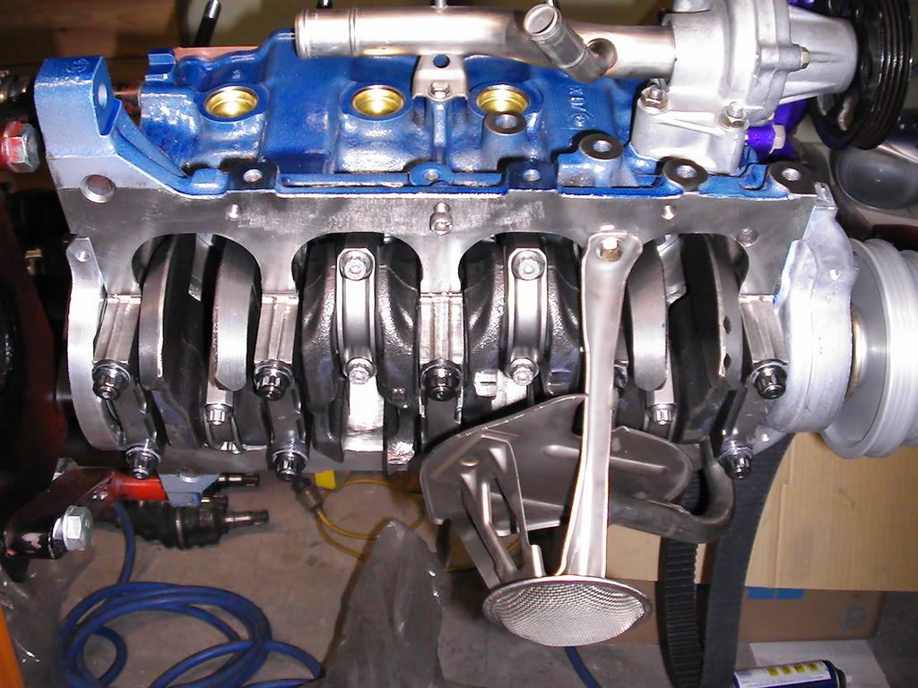

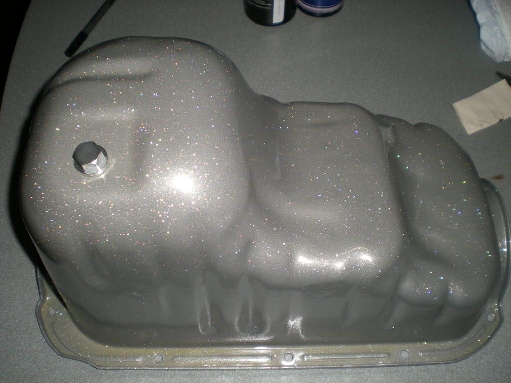

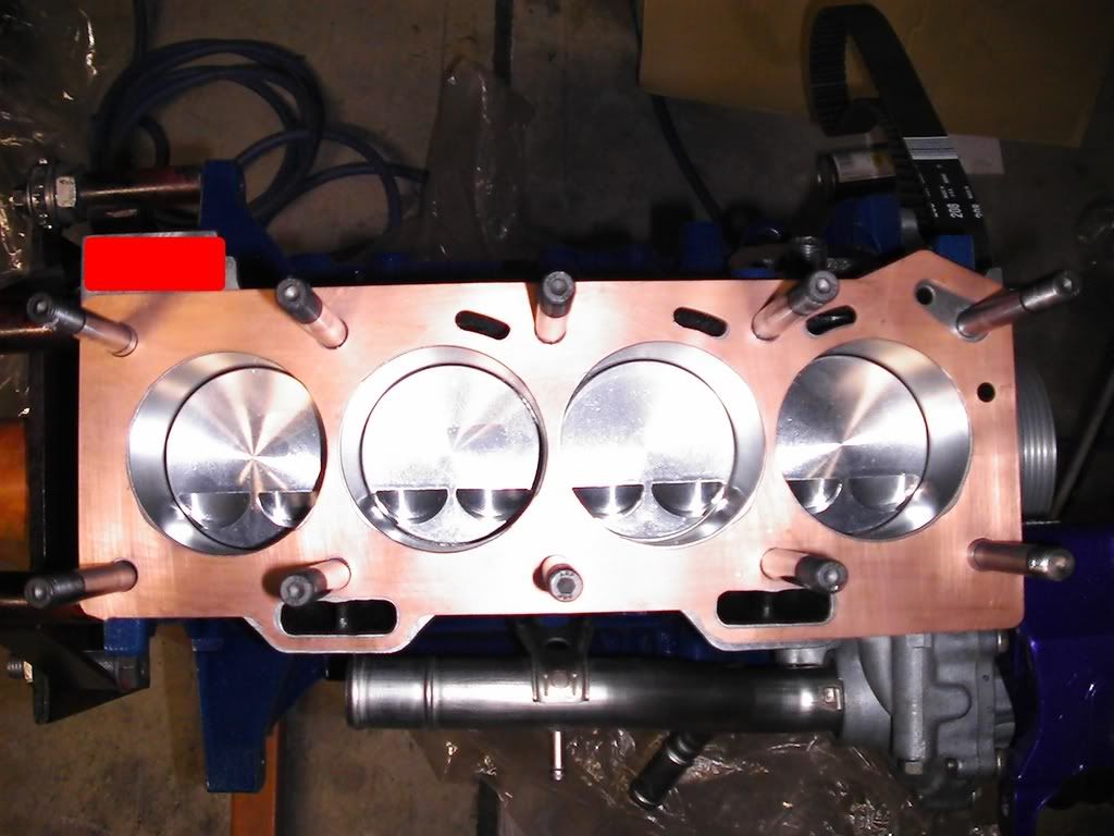

Starlet_GT3582R Posted August 8, 2008 Author Posted August 8, 2008 Well i have some realy good news my block is finished, i had to get some over size dowles put in the block so the head would not twist under boost & welsh plugs are all in, got my new JE pistons today, now im putting it all back togeather . ill post up some picts verry soon of the completed motor. but here is a picture of my sump ;) ;) its not just any sump the inside has been teflon coated.Cheers Cain D. Quote

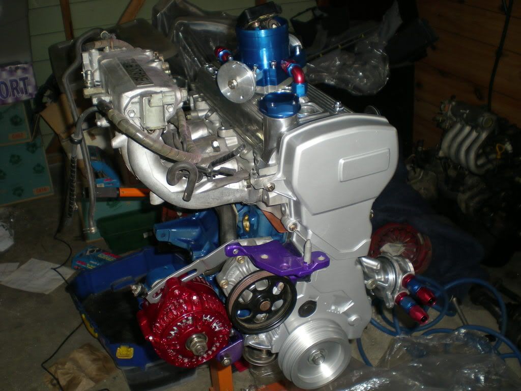

Starlet_GT3582R Posted September 7, 2008 Author Posted September 7, 2008 always worth waiting for the updates as you no they are going to be big ;)Hey gents, bit of an update...Dash guage podMotor, disregard inlet plenum and exhaust manifold... just doing some mesurements. note me throttle body on the rocker cover, she be massive ...Rebuilt DizzyWont need cap or rotor button as im using a MSD DIS-4 HO, so it will be capped of wit a polished alloy cover.Cheers Cain D. Quote
BenV Posted September 7, 2008 Posted September 7, 2008 top work as always man, cant be long now can it? Quote
Sparky Posted September 7, 2008 Posted September 7, 2008 WOW the engine is together so cant be long now ;)Looks amazing mate Quote
