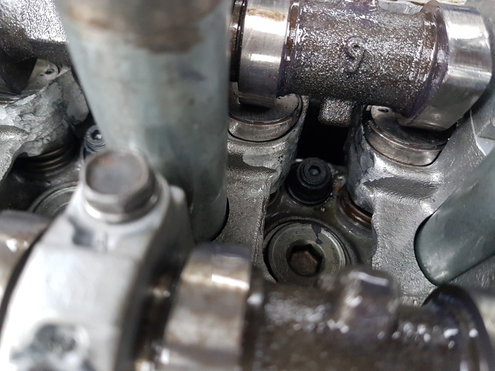

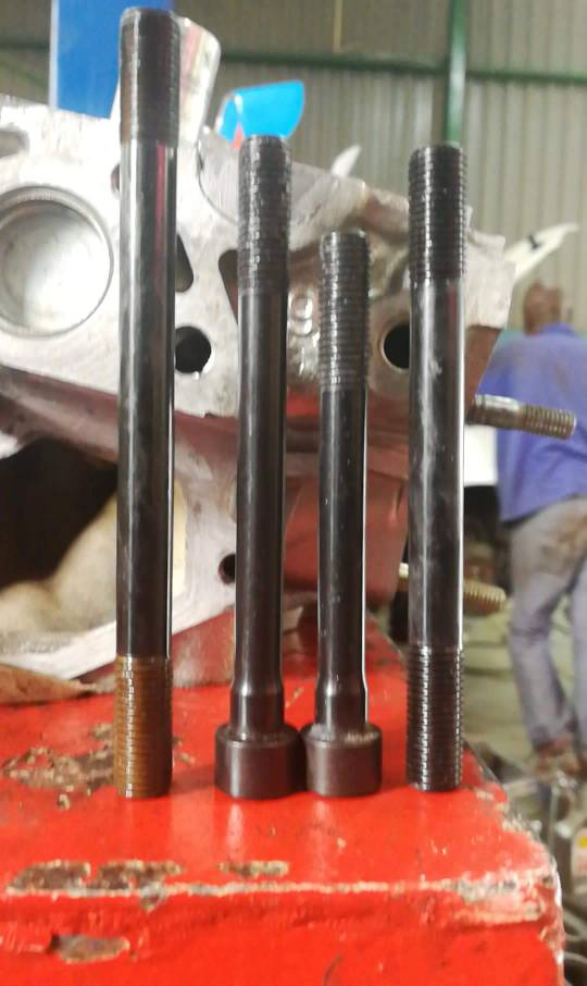

Faiyaz.123 Posted January 22, 2018 Author Posted January 22, 2018 (edited) On 1/20/2018, 4:11:15, 5e colin said: Yes head drilling out can all be don't diy use your pillar drill Tape up the dec face use gaffa it's strong get yourself a drill and tap guide for m10 get 1 you can bold down to be precise When head gets installed you will find our where 1 needs grinding a bit to clear stuff Simple job with correct tools Ok so I'm running Into a few problems have a look at the pics and advise 1st pic is what I purchased 2nd pic as you can see the problem 3rd pic is the old bolt in the middle compared to the studs on the sides. That doesn' look like an Mm difference Please help Edited January 22, 2018 by Faiyaz.123 Quote
5e colin Posted January 22, 2018 Posted January 22, 2018 Ya there's longer an shorter You need to drill or grind out the section to pas the nut treu Pay attention to when cams installed The OEM bolts is m9 the new m10 Quote
maddox710 Posted January 22, 2018 Posted January 22, 2018 They are obviously not made for the 4e hence why a machine shop has to modify the block and head Quote
Faiyaz.123 Posted January 22, 2018 Author Posted January 22, 2018 Ok this looks better. How deep to I go into the block ? Quote

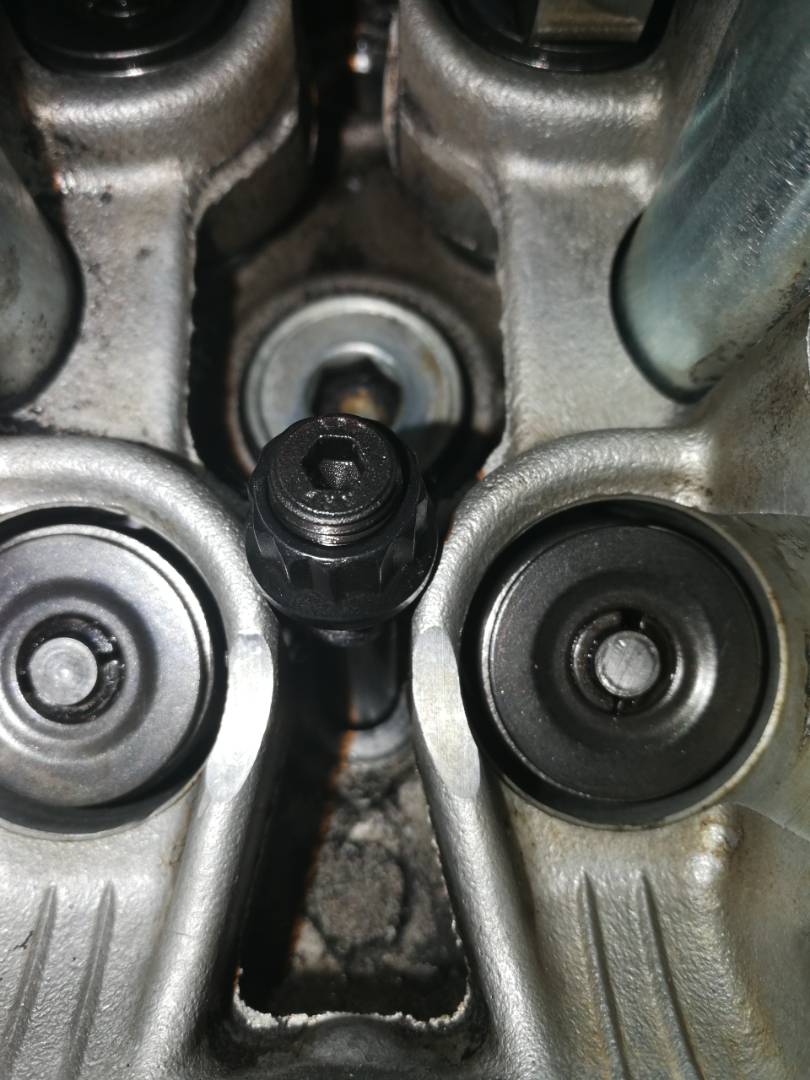

Faiyaz.123 Posted February 6, 2018 Author Posted February 6, 2018 On 1/23/2018, 7:27:51, maddox710 said: Whats wrong with arp head bolts? On 1/23/2018, 1:50:23, 5e colin said: studs are always better to clamp a headgasket down you get more even clamping force with studs then over bolts ( as they stretch unevenly ) Exactly what happen .the bolts when taken out , had a look and were stretched unevenly . On 1/23/2018, 2:43:49, maddox710 said: Guarantee 99% of glanza owners will never come anywhere near the lifting point of arp head bolts I'm sure they are more but if you say 99% then I'm part of that 1% On 1/23/2018, 3:32:42, daniel_g said: Big Faiyaz up there thought he might! The car did. So maybe I need to explain a little more .car was last tuned at 1.5 bar boost with eth mix pushed 414bhp. When I got the car back it just wasn't feeling right .So we decided to tune through a tuner in Russia with team viewer .and immediately with the tuning progress the car felt much better and as we went up to 1.8 bar. We felt a jerk .upon inspection we realised the headgasket is fine and the head actually started lifting off causing a little water oil mixture . Hence new gasket and studs. Hope that clears minds . Now I need more help please lol . We managed to get the studs in .but realising the longer studs not clearing the cam .we used the old spacers and made the holes a tad bigger for the stud to go through . Will post a pic by tomorrow what I mean. Any idea? On 1/22/2018, 10:47:23, 5e colin said: Ya there's longer an shorter You need to drill or grind out the section to pas the nut treu Pay attention to when cams installed The OEM bolts is m9 the new m10 When u say pay attention to when cams installed what do you mean ? Quote

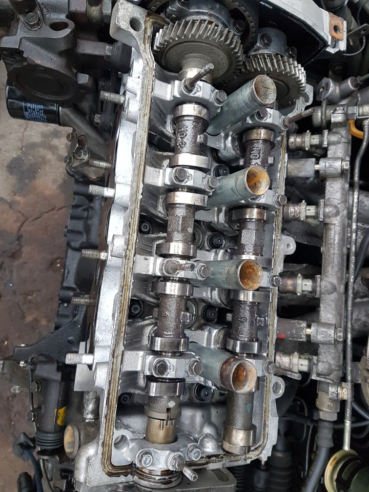

daniel_g Posted February 8, 2018 Posted February 8, 2018 Only other pic i have dude. Mine are nowhere near the cams. Quote
5e colin Posted February 9, 2018 Posted February 9, 2018 16 hours ago, Faiyaz.123 said: Any help? Pay attention if the timing cogs arnt touching the studs there close to it Quote
gorganl2000 Posted February 9, 2018 Posted February 9, 2018 On 2/6/2018, 4:42:17, Faiyaz.123 said: Now I need more help please lol . We managed to get the studs in .but realising the longer studs not clearing the cam .we used the old spacers and made the holes a tad bigger for the stud to go through . Will post a pic by tomorrow what I mean. Any idea? by any chance do you have them installed incorrectly?----long studs on short side and vice versa? Quote
Faiyaz.123 Posted February 14, 2018 Author Posted February 14, 2018 On 2/9/2018, 11:38:17, 5e colin said: Pay attention if the timing cogs arnt touching the studs there close to it That' exactly what happened . Seems like the engineer hit a blunder .But managed to get them in .then into another problem .one of the bolts at 40nm just spins round .which means again the engineer has tapped it to big so advised to tap and install a helicoil. Quote
