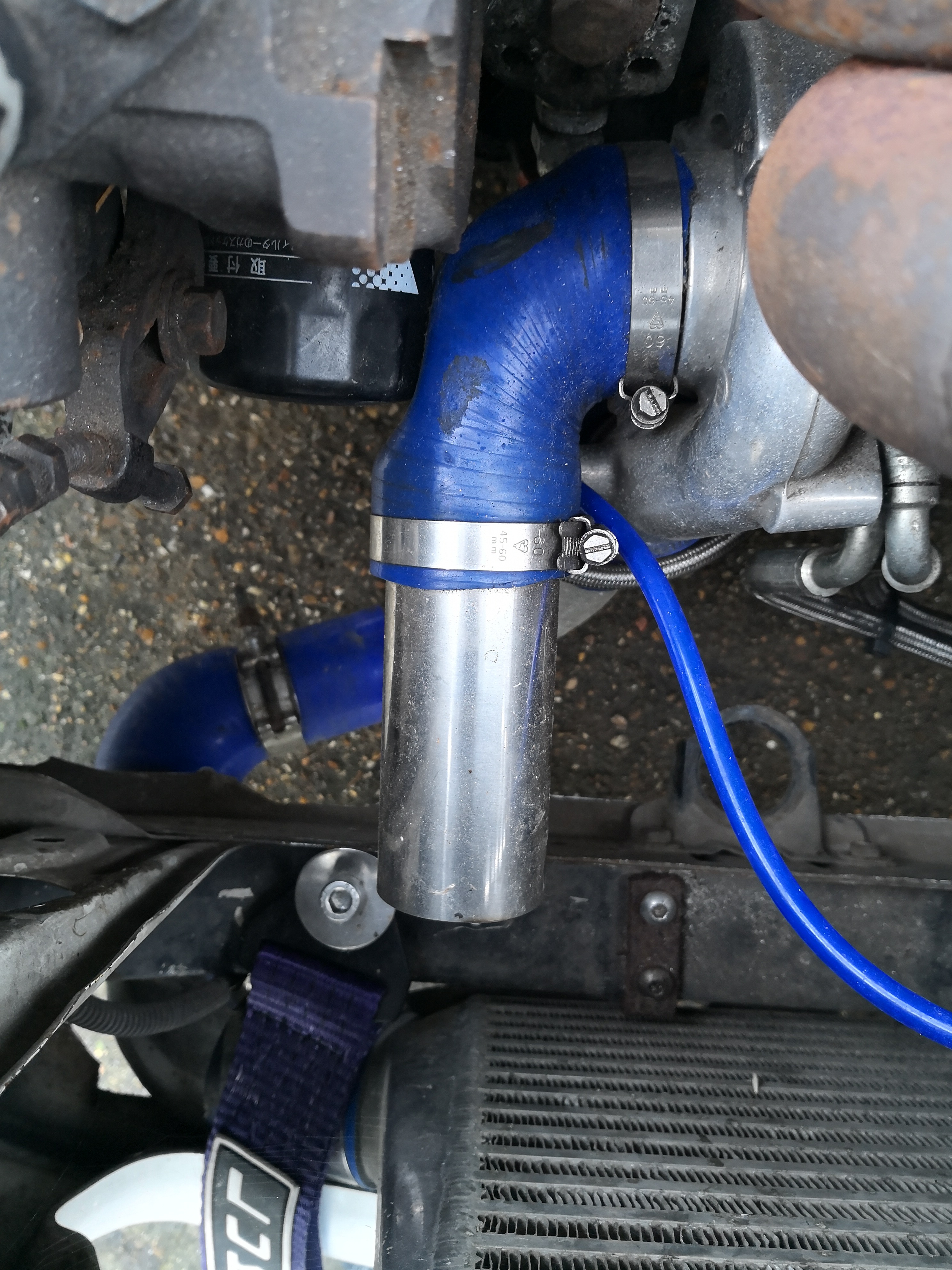

Kate Posted February 15, 2018 Author Posted February 15, 2018 Hey, so I will go for an air filter but the pipe I have is just under 50mm and I need a mushroom filter for it to fit. Thing is 50mm is so small I'm struggling to find one to fit. Here is a pic of where it is. Needs to be a mushroom as there is not much room between end of pipe and front mount. Quote
gorganl2000 Posted February 15, 2018 Posted February 15, 2018 i had the same issue a while back. i ended up getting a 90 degree bend/elbow to convert from 2.25" to 2.5", then used a 2.5" pipe (instead of the 50mm pipe you have there) and fitted a small 2.5" mushroom filter....just trim the pipe length to suit the space/filter accordingly....i reiterate, make sure the mushroom filter is the small type as the big mushroom filters may not fit (limited space) https://www.ebay.com/itm/2-5-MUSHROOM-STYLE-HIGH-FLOW-AIR-FILTER-WASHABLE-RACING-COMPACT-INTAKE-BLUE/272912904293?hash=item3f8ae07065:g:2wsAAOSwNkJaBkyQ&vxp=mtr something like that Quote
Kate Posted February 15, 2018 Author Posted February 15, 2018 Yes that is what I was thinking. I'm spending a day working on the car Saturday with a friend so will order everything Saturday and send the other filter back if needs be x Quote
gorganl2000 Posted February 15, 2018 Posted February 15, 2018 np...hope you get it sorted would send a picture from my phone, but unfortunately i'm not a paid member Quote
