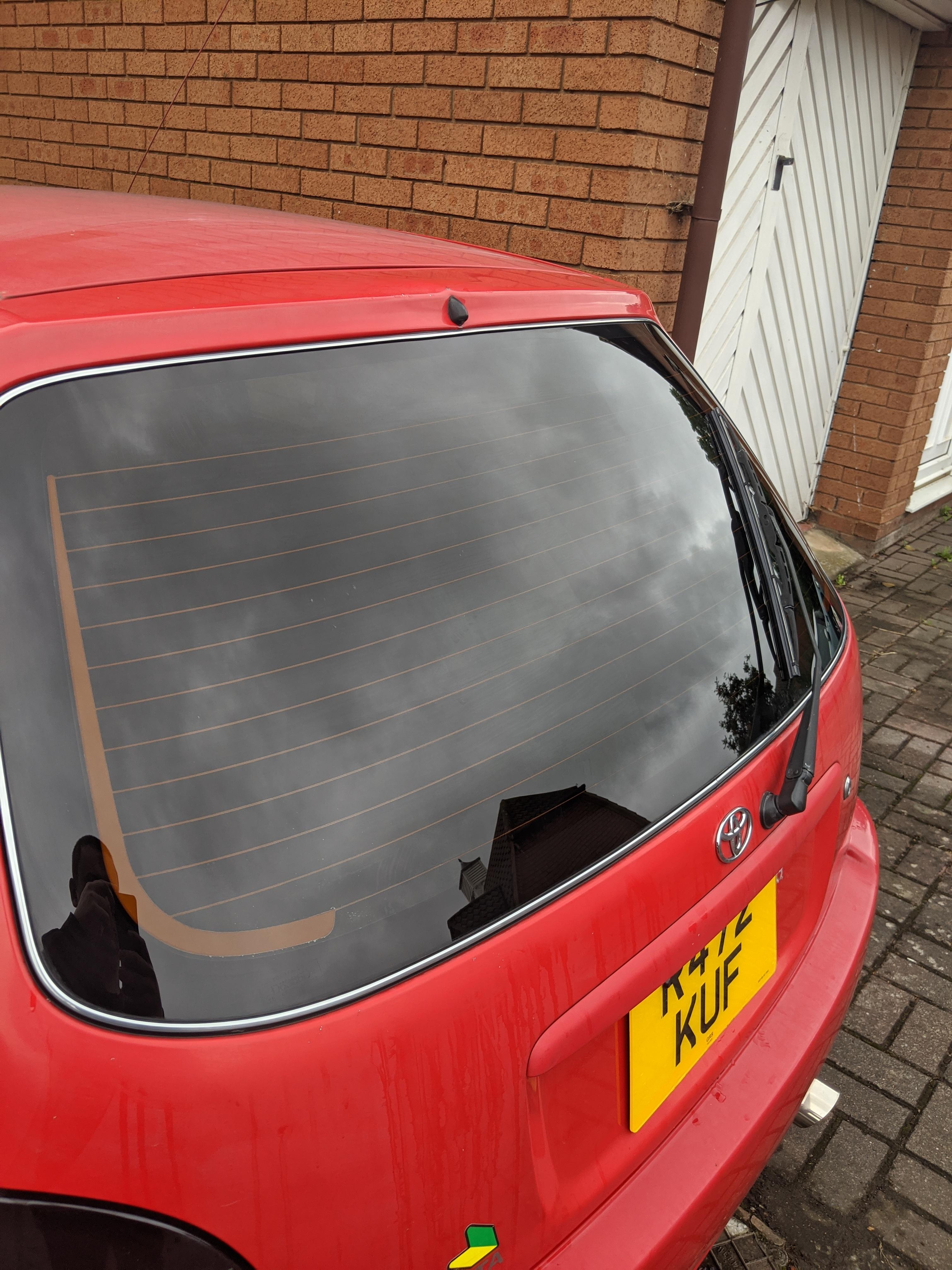

Keviano27 Posted July 13, 2020 Author Share Posted July 13, 2020 Past few weeks I've been asking for prices to get bits painted, the bootlid had a silver spoiler and a glanza plate surround fitted but was painted poorly, it had a tiny bubble of rust around the wiper arm to which I wanted fixing. A mate gave me a new bootlid which was red so fitted it and got the window tinted, the old bootlid got stripped and the bits off it will be painted soon. The car itself was so badly faded I wanted it sorted badly. Got my mate who done the old starlet and he worked his magic yet again! Going back next week to finish the rest off and get my new GT seats cleaned and all! 😎 Quote Link to post Share on other sites

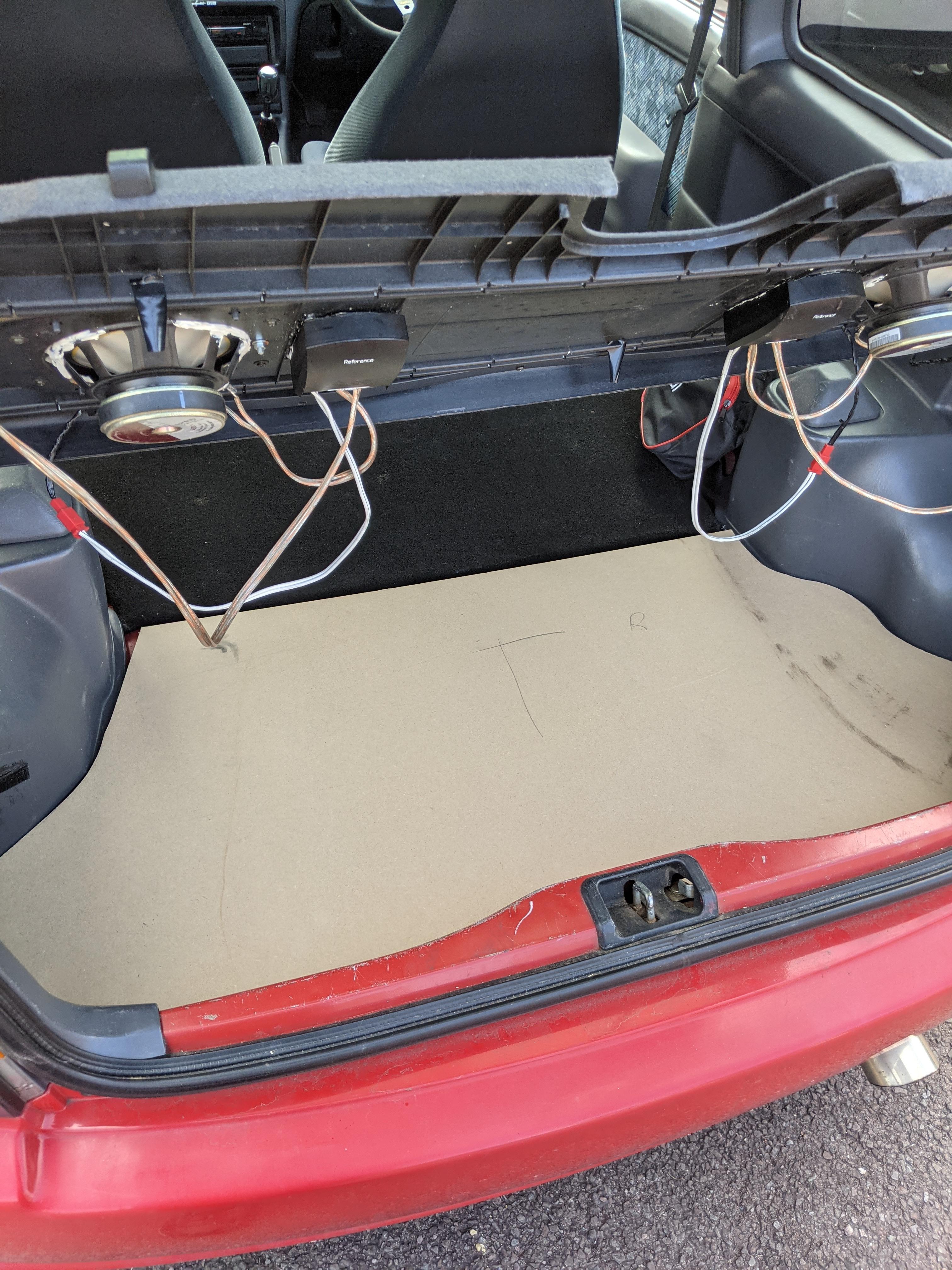

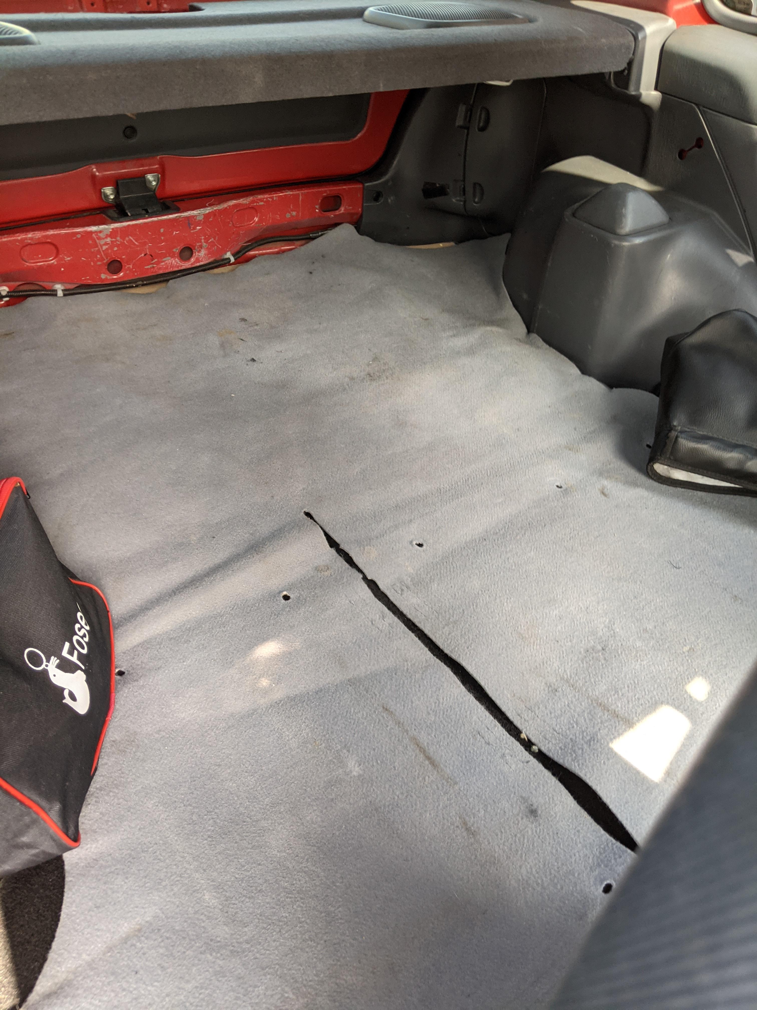

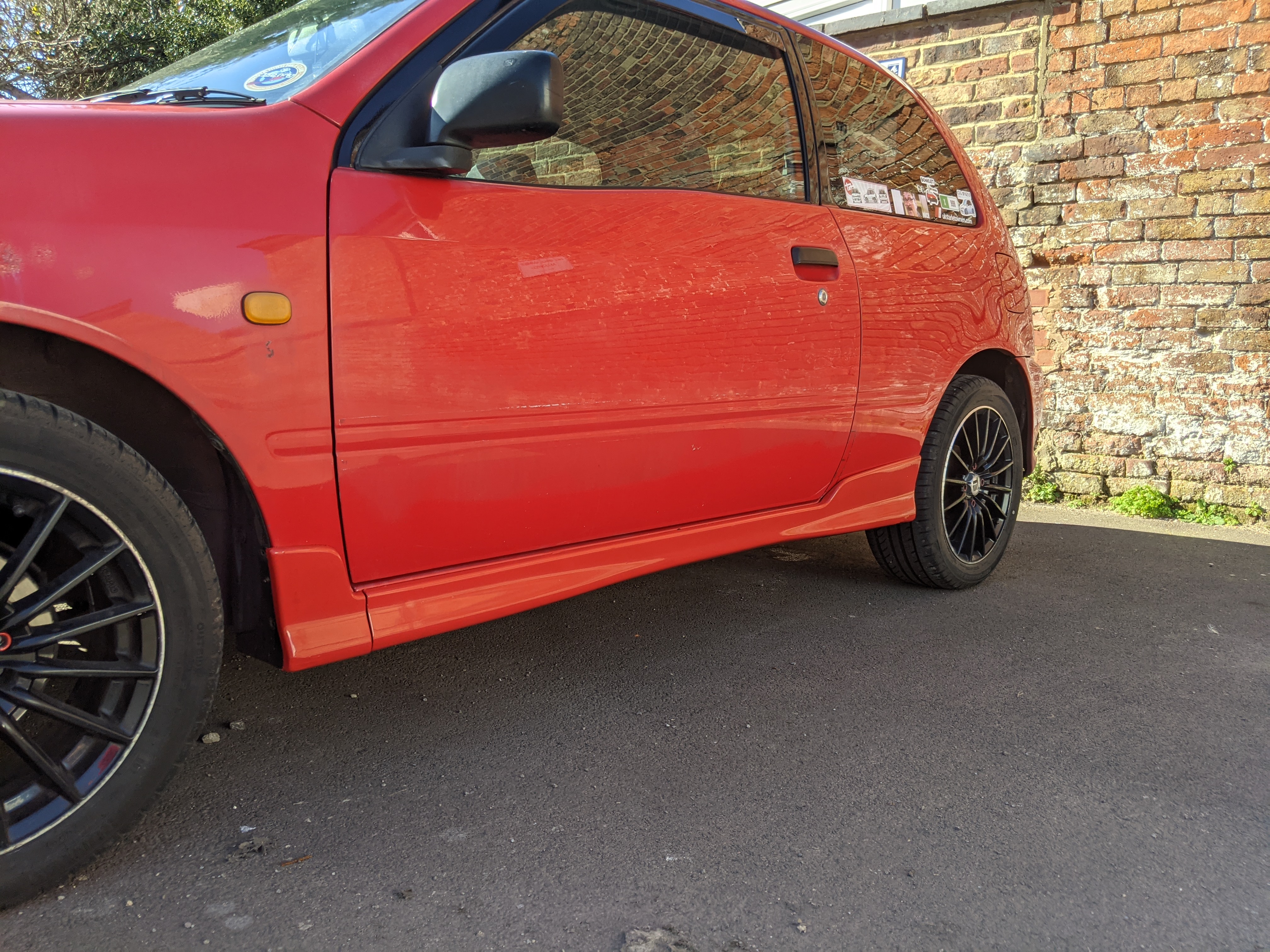

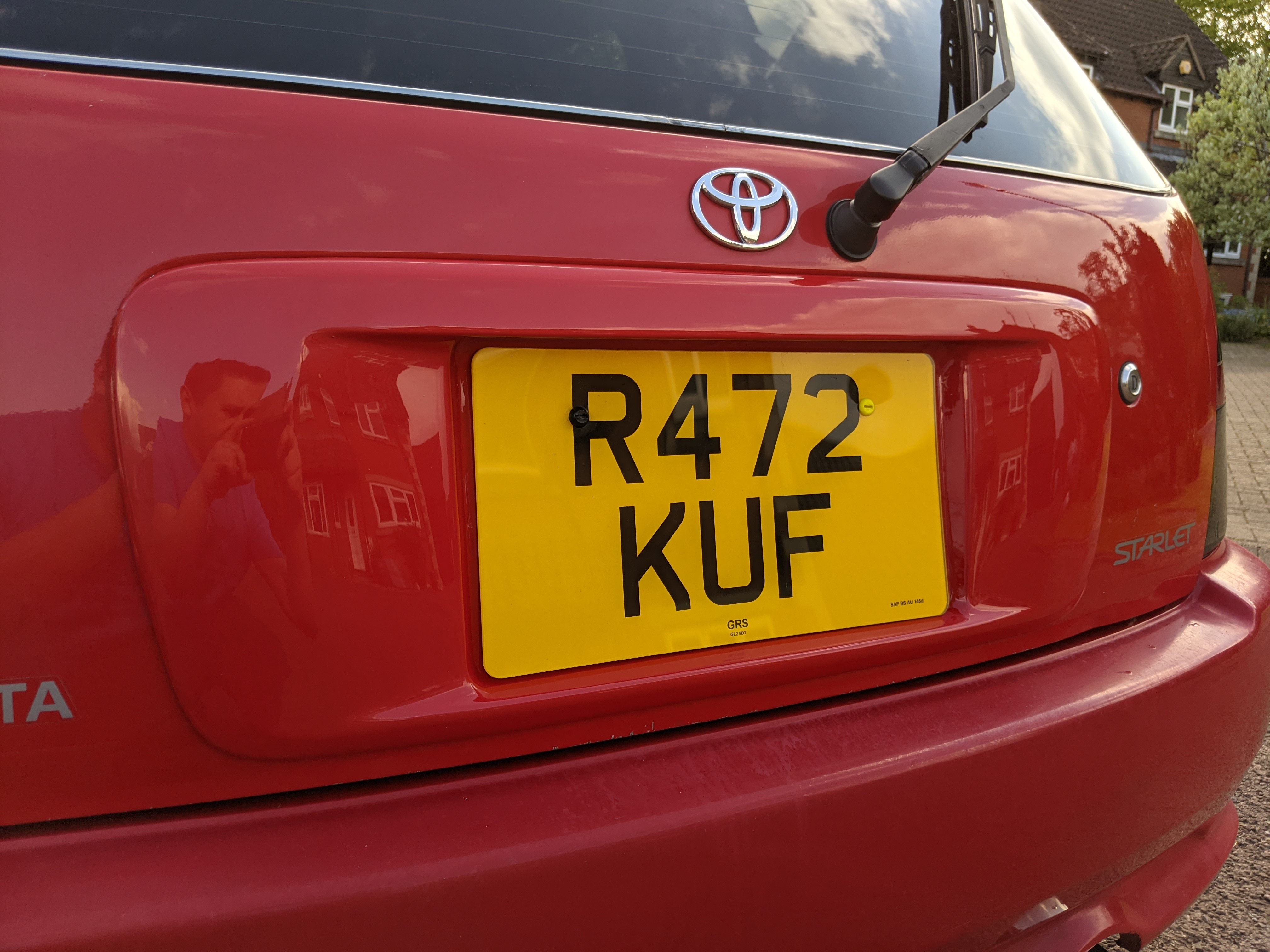

Keviano27 Posted May 10, 2021 Author Share Posted May 10, 2021 Really should update this more 😅 The car has been getting some love recently with a few parts finally painted and fitted. Got the sideskirts wrapped and fitted, last time I used just sealant but this time I just screwed them in and abit of sealant to keep the water out. Plate surround repainted and fitted And the spoiler also done at the same time and fitted. Wanted the lights covered cause like last time it's something different. Even tho it's a Glanza rep that's been done a million times 😂 Bought a piece of MDF from B&Q and cut a rough shape to cover the boot for abit of a false floor. It's not perfect but it don't rattle and it's a good fit. Plus once you chuck the boot carpet on it, it's nice and tidy. So this is currently how the car sits. Combe is just under 3 weeks away so wanted it all these exterior parts done by then. The clutch has started to slip tho so I'm tackling that this weekend so another update won't be ages again! Quote Link to post Share on other sites

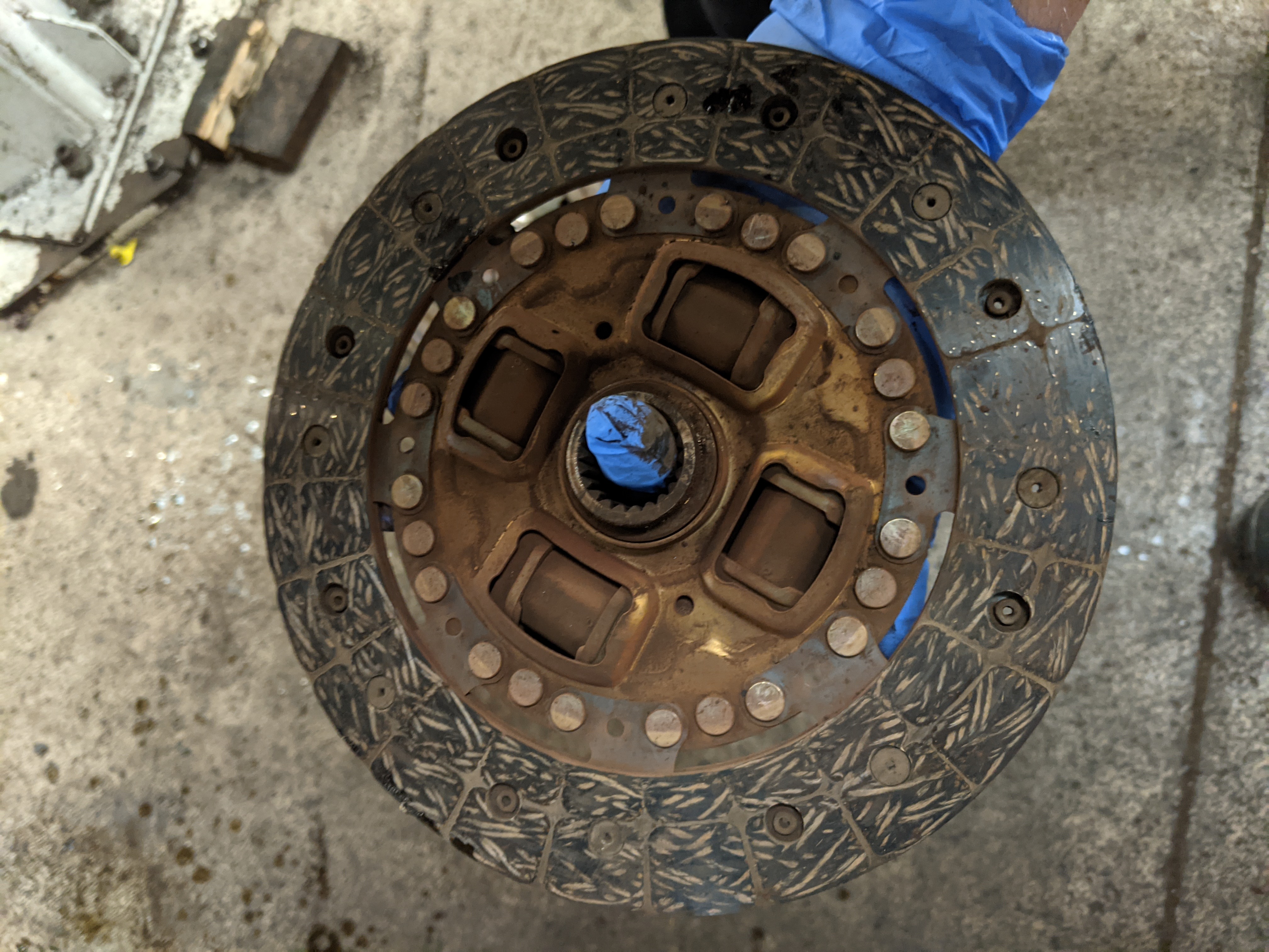

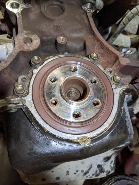

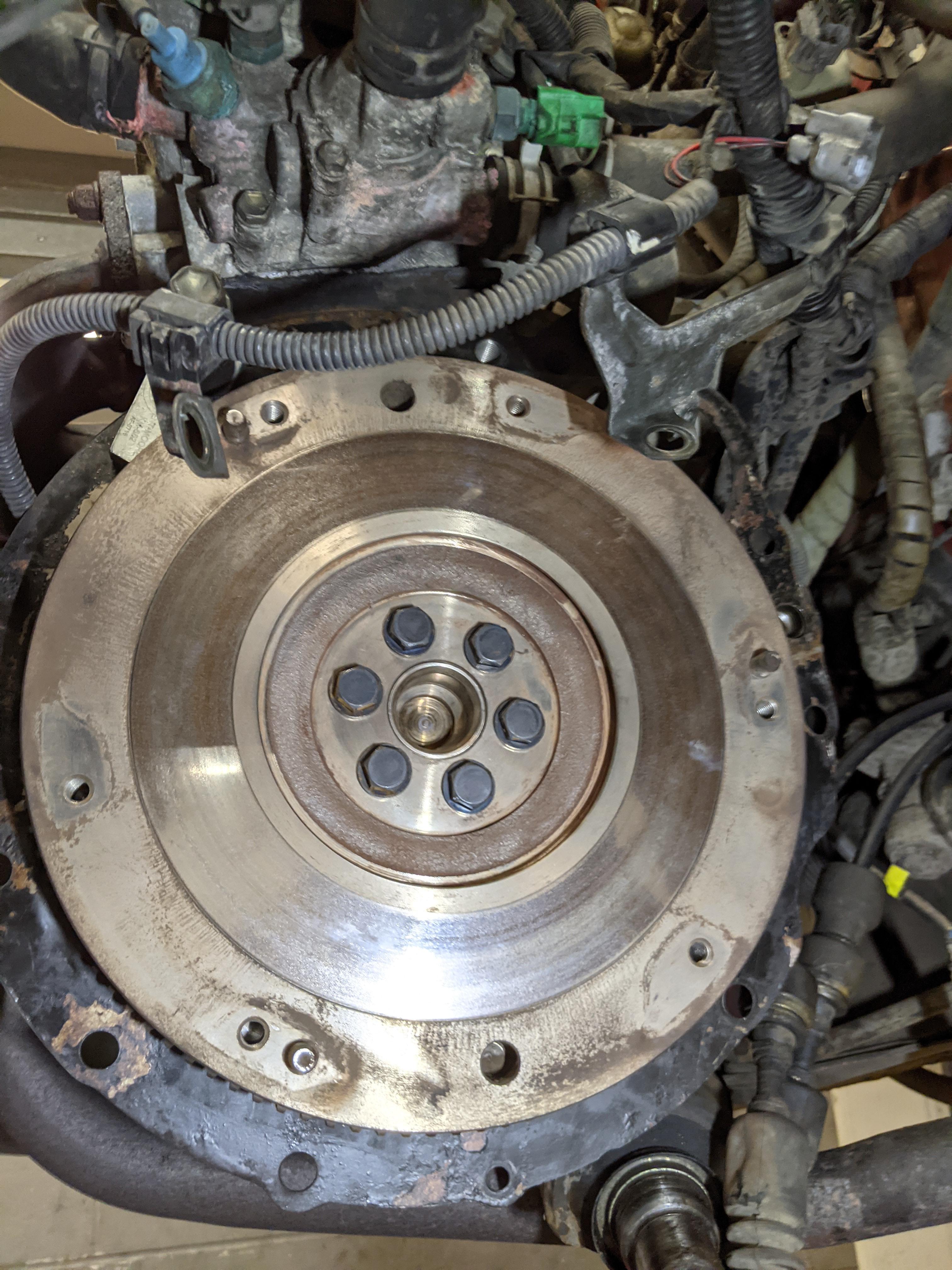

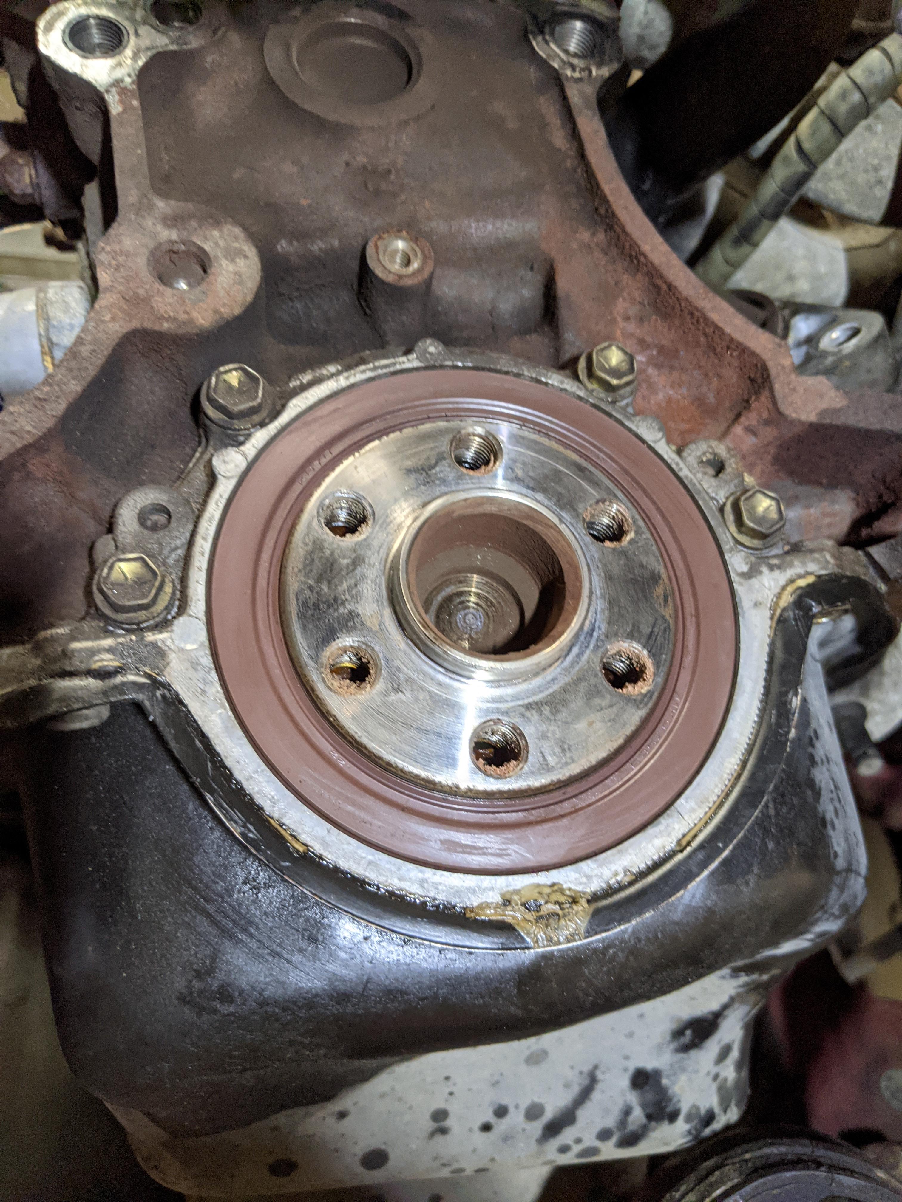

Keviano27 Posted May 15, 2021 Author Share Posted May 15, 2021 (edited) Got the new clutch fitted this morning on my day off, took me and a mate 5 hours in and out, would've been quicker if it wasn't for the speedo cable! Clutch had seen better days I'd say! The main seal was leaking so I replaced that too, new flywheel bolts fitted aswell. First time I've done a clutch on a starlet and it wasn't a bad job, few fiddly bolts and that speedo cable, that was the hardest parts really. If anyone ever needs help changing one here's a brief 'How to'. I probably missed out something but the main info is there. Drain the oils (Don't need to drain the engine oil but I was replacing the main seal) Remove Battery Air filter housing off (3 bolts) Slave off (2 bolts) Gear Linkage off and moved out the way (2 pins, 2 washers and 2 clamps) Speedo cable off (Take off the cluster itself - Small hands needed for this cause it's very fiddly. We left it attached to the box in the end) Lower ball joint off the lower arm (3 bolts) Driveshaft/ Hub nut (we only removed the passenger side driveshaft cause it was easier) And a few ground bolts, ones for brackets and a sensor on the gearbox itself (grey coloured on mine, right on the top you can't miss it) Driveshaft out Remove all the bell housing bolts (5) and Cover plate bolts (3) Gearbox and Rear mount off (We undid the gearbox mount which was 2 on the chassis and 3 on the box, Rear mount was 1 bolt to take off, the bracket for the mount was left on the gearbox) Give the gearbox and good old jiggle and be patient and it should come off easy enough. Give it a good clean inside and put your new clutch, bearing and pressure plate on and do the job again in reverse! Torque Settings needed are: Flywheel bolts - 90 Nm/88 Nm Clutch pressure plate bolts - 19 Nm Hub/Driveshaft Nut - 216 Nm Hopefully that helps someone, not the best how to but it's better then nothing! Combe next Saturday so the car is all sorted for that now, quick wash on Friday and that'll be it! Edited May 22, 2021 by Keviano27 Quote Link to post Share on other sites
