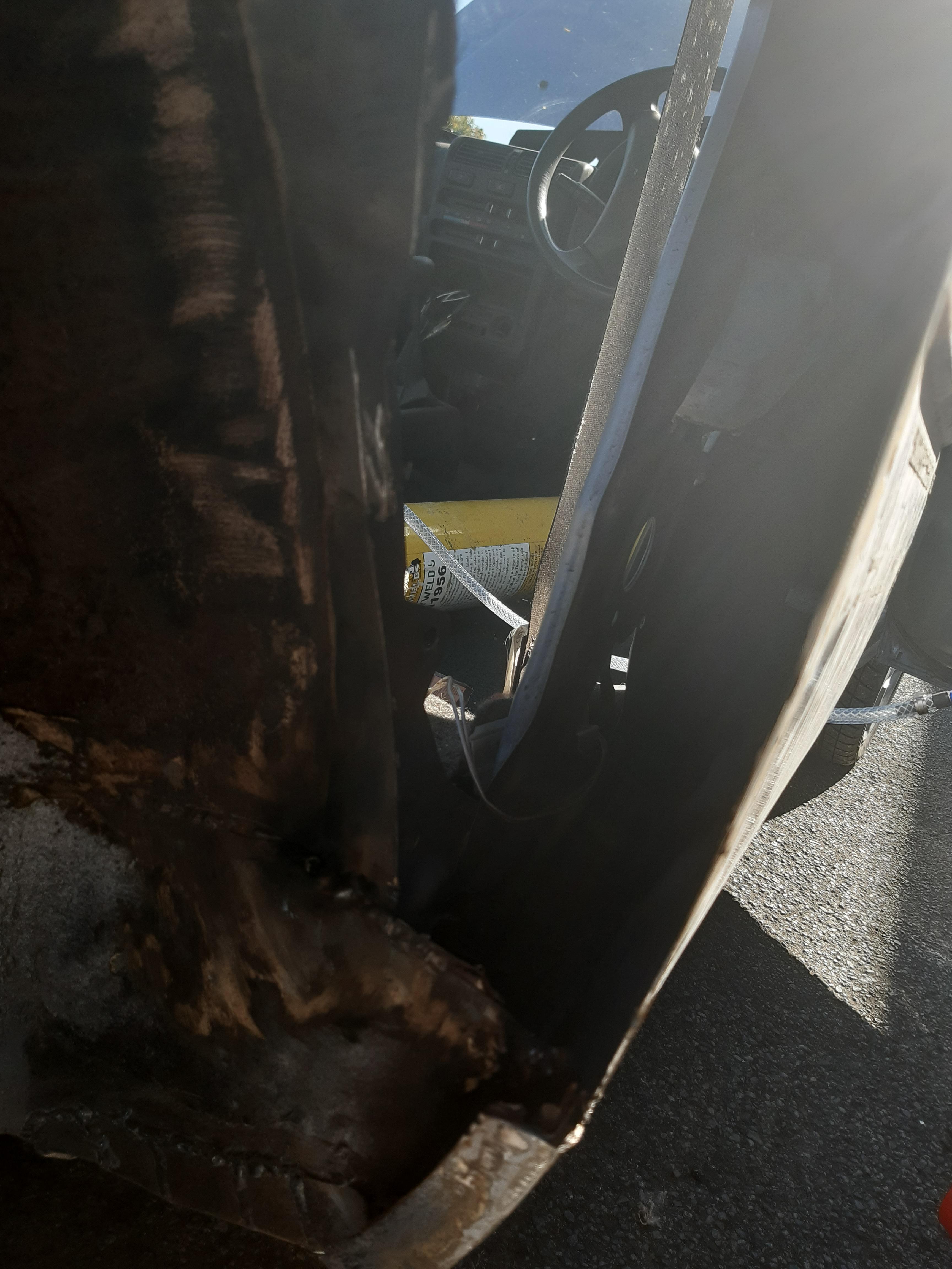

Nice one, thanks. I'll have to put this idea on hold for the time being as I've got loads of other work to do on he car, mainly welding so I can it tested.
Cheers Andy
Edited by AndyH64
Photos added
